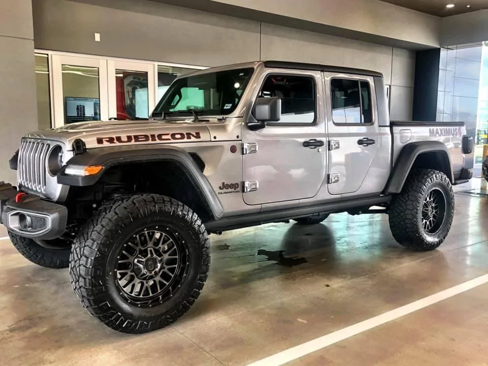

Has anyone installed this kit yet? I am looking at adding this and 37/13.5/18or20 Ridge Grapplers on the Rubi. Is it worth the extra $$ for all the extra arms. I would like to see pictures of this setup if anyone has some. Thanks!

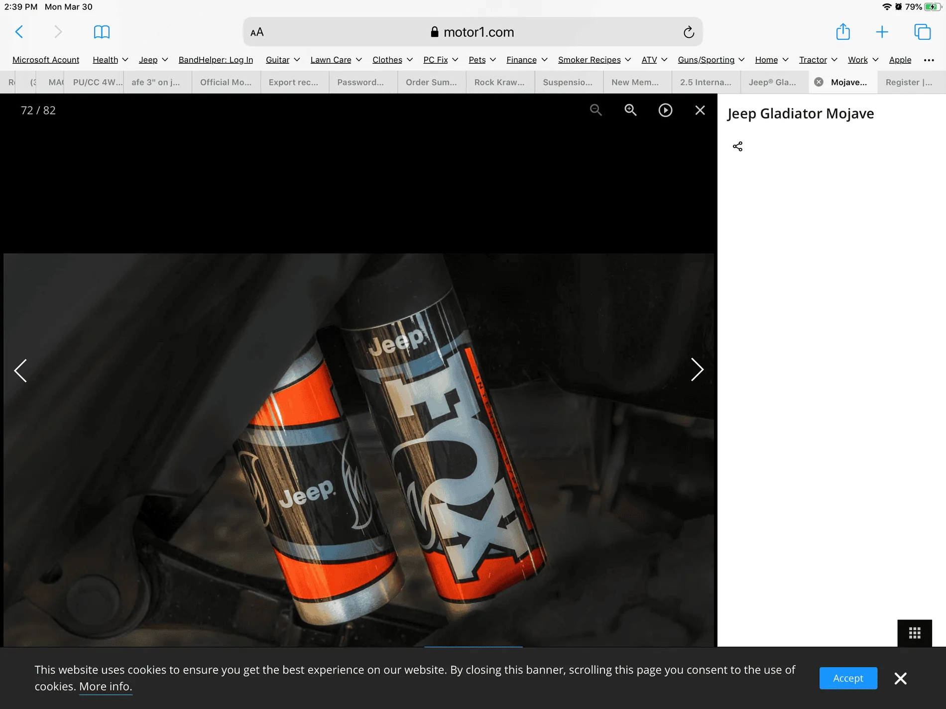

As far as the ride goes, I have no complaints so far other than the Rancho’s are limited in their adjustment and I have not tested them under towing conditions or with a heavy load. They will get me by and do for now. I just contacted Fox again today and requested why I can’t get the 2.5’s in a Piggy Back or even remote like the fronts they have but valved for the rear. Waiting for good explanation. They do make a 2.0 but it does not have the DSC. Now here’s a fun one I popped to em. Jeep is working on a new edition of the JT coming soon called “MOJAVE” and guess what kind of shocks they have on it? Yup, FOX 2.5’s with internal bypass and DSC front and rear.
https://www.motor1.com/photo/4751205/jeep-gladiator-mojave/
Photo of the rear shown here.
I emailed the Fox service department and they know nothing about it. Hmmmmm.
The Mojave is also hinted at on the Jeep website and you can subscribe to be emailed about updates on it’s arrival.
https://www.jeep.com/limited-editions/2020/gladiator/mojave.html
AND THERE’S A LINK TO IT ON FOX’S WEBSITE!!!!! LOL!
https://www.ridefox.com/subhome.php...adiator+JT&year=2020&position=ALL#truckshocks
Fox don’t know??? Really? WTF?
