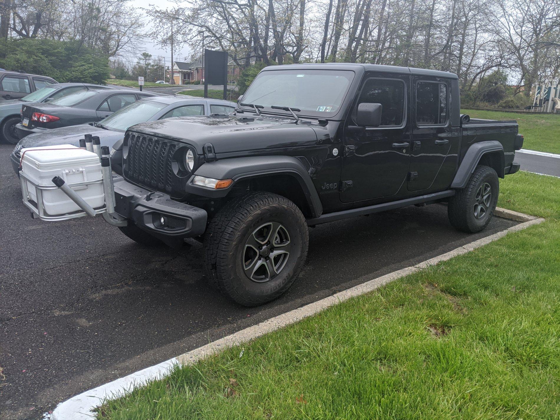

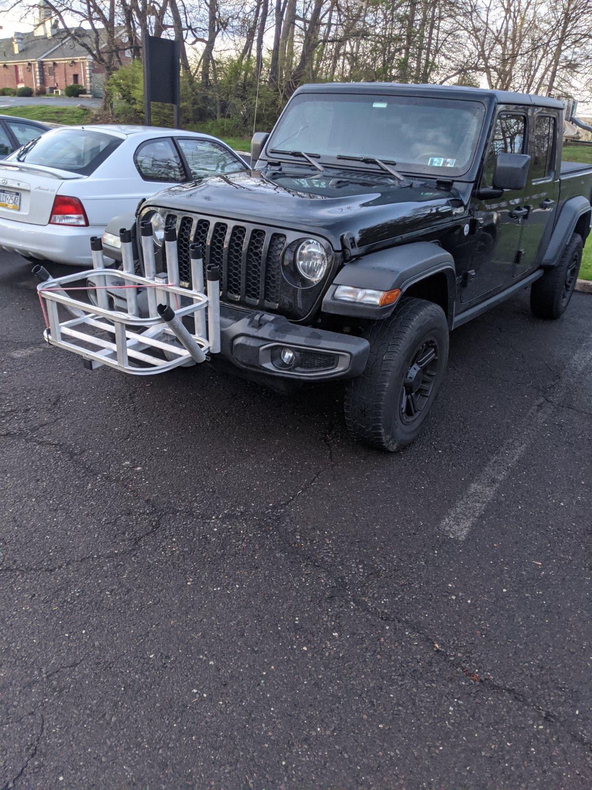

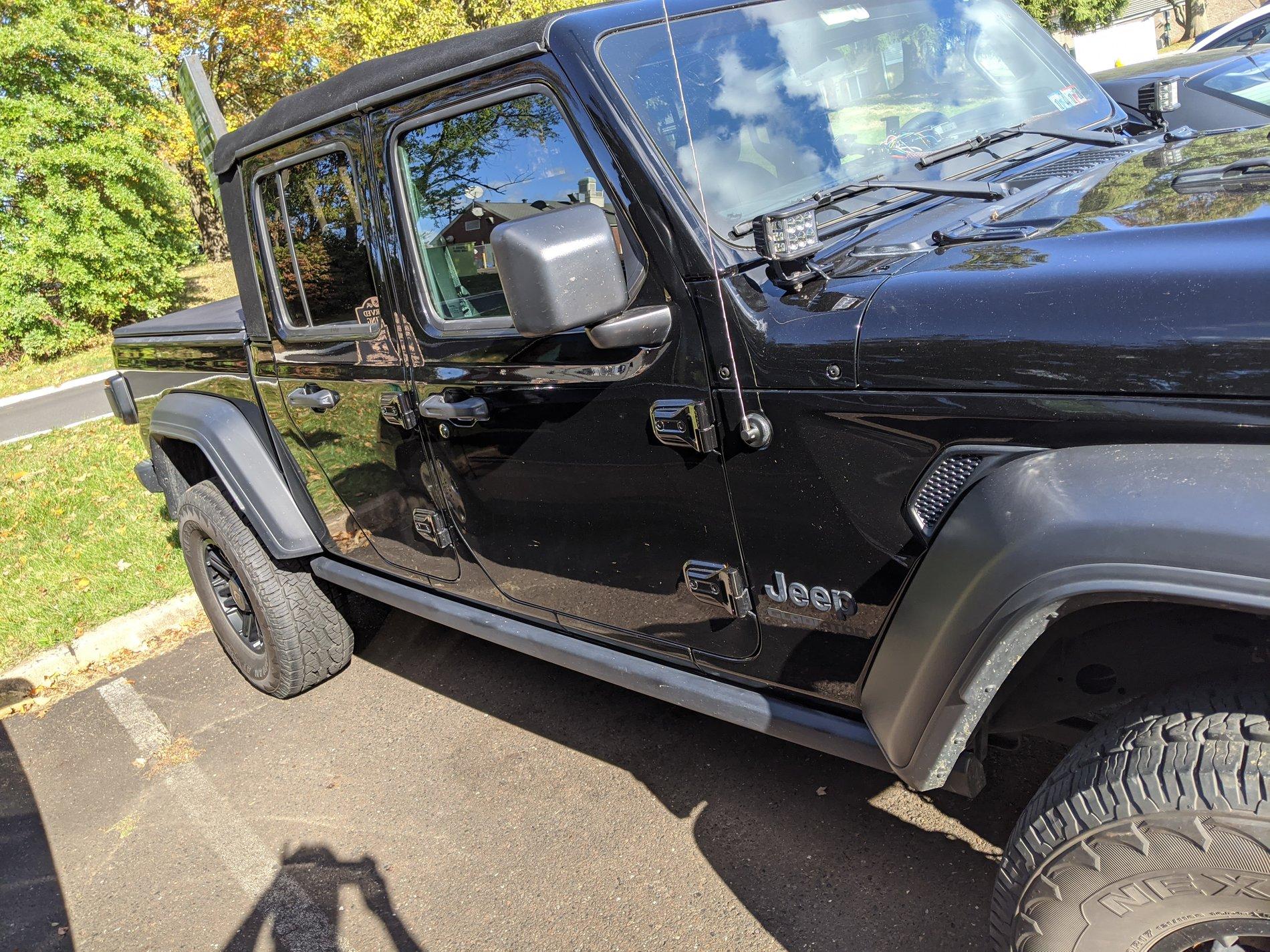

Thanks Tampa. Got the kit installed last night. Found a few videos for other budget boost kits on YouTube. One video did not include removing the rear track bar, it's a real pain if you don't and makes it difficult to get the rear axle low enough to slide the springs in.
My before pictures are sport s suspension with 255/75/17 underneath. My after pictures I swapped in a Rubicon suspension plus the budget boost with 315/70/17. Should give you an accurate representation of what your Rubicon will look like with 35. Not the greatest pictures, by the time Mike it came in at 4 p.m. last night I just wanted to get it on so I rushed and forgot to take a good shot.

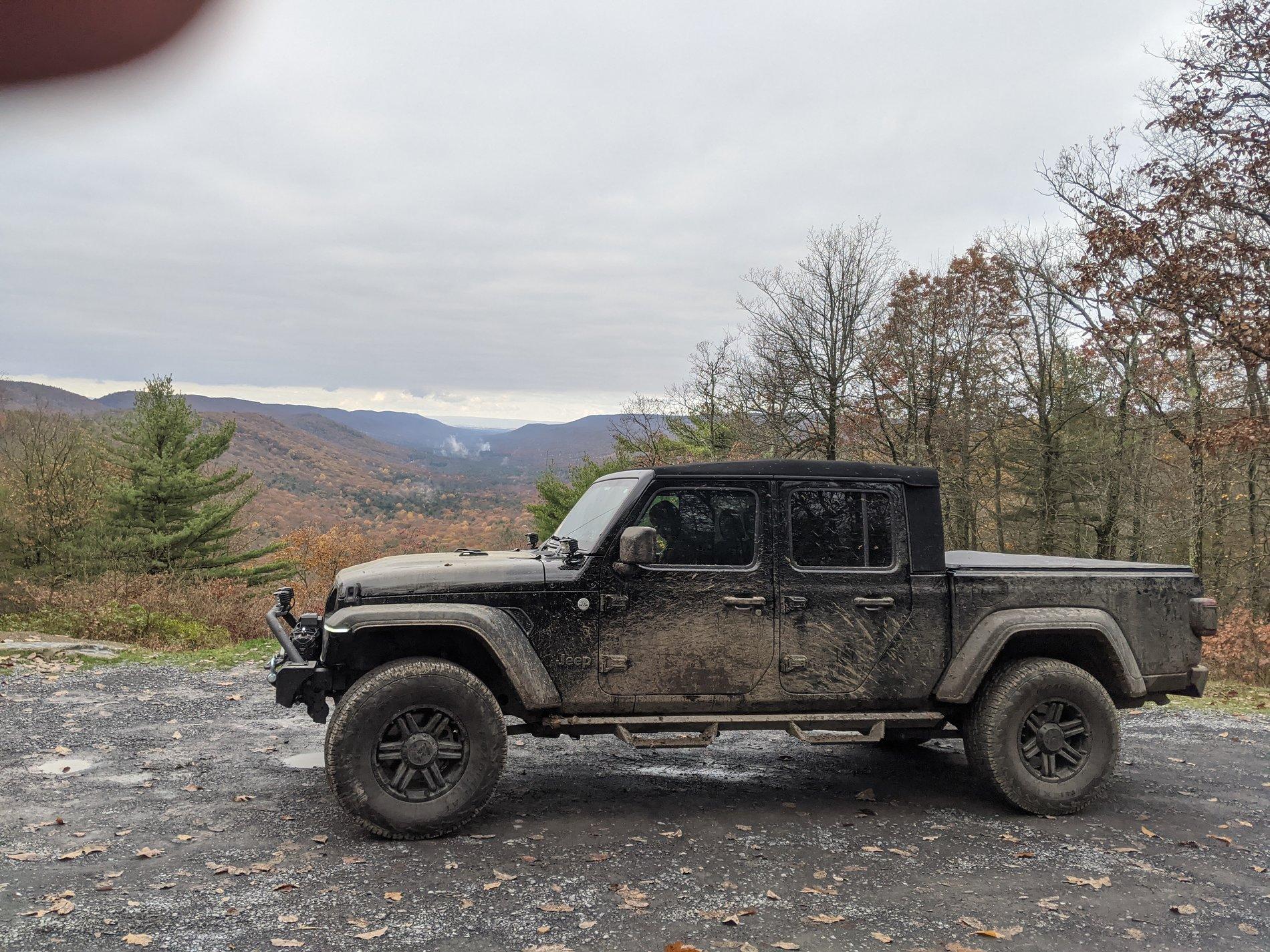

So I reinstalled my rear max tow springs, but I maintained the front rubicon spring and all 4 fox shocks. But I had it off-road in the mountains of PA this week, beat it up pretty good (to the point that I need a ball joint). But I still love the kit. Only reason I'll ever change it out is to go to 37s. Happy with the stance even after adding steel front/rear bumpers and a winch. Ride is good, height is good. I'd still recommend this to anyone. 8k miles and still happy.
