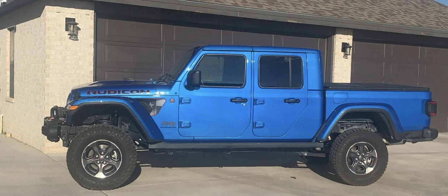

so once all the components were onI out the wheels on and took my first look at it. With 3” of loft up front and none in the back at this point my friend made the comment “it looks like a puma ready to pounce”.
