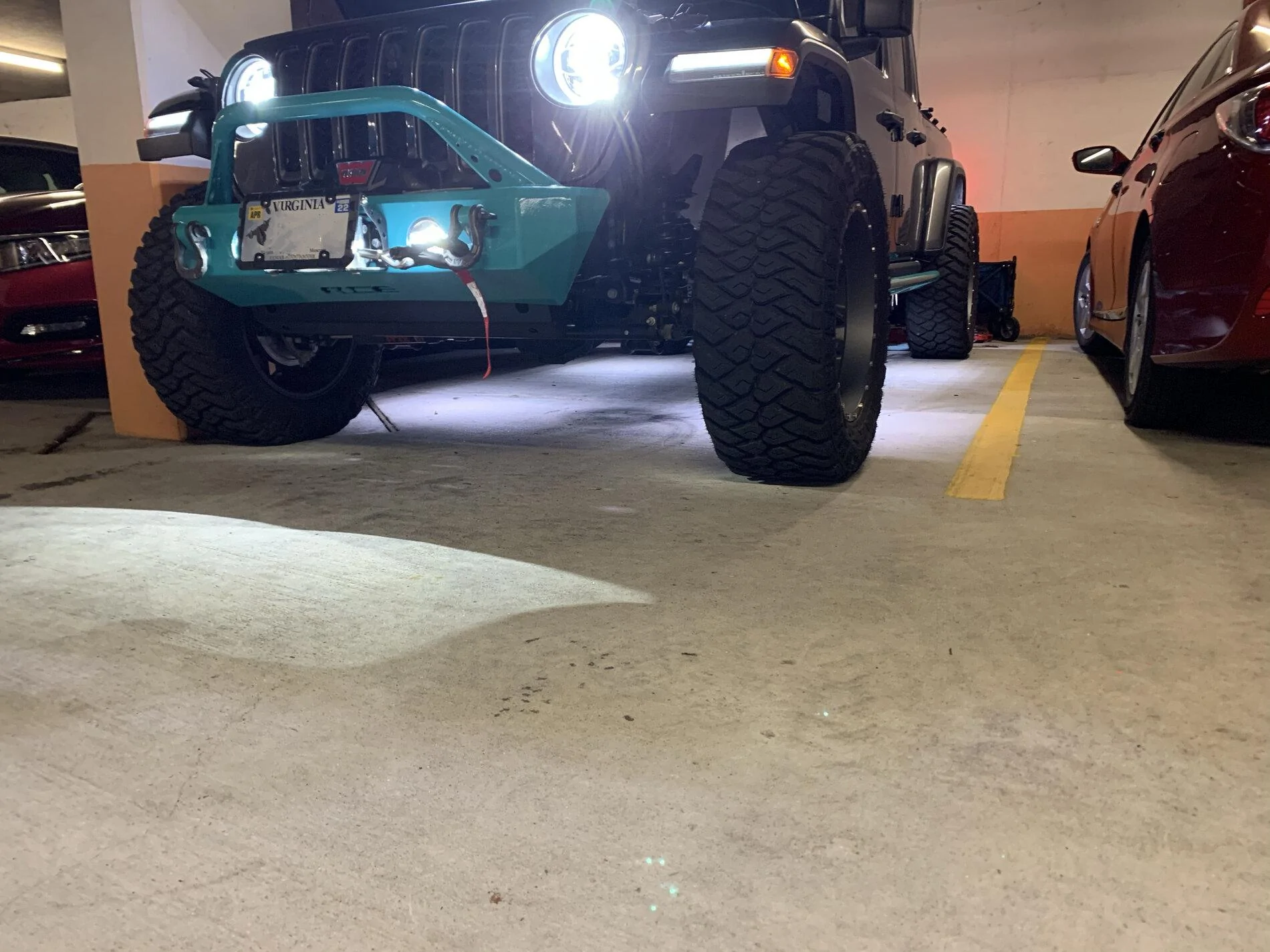

I agree with LostWoods. This is what you get if you mount using the rock rail mounting holes to illuminated between your tires.
I’ve been considering adding another pair just behind the bumpers, but honestly I use my rock lights more for lighting up my work area when I play with the truck than for getting unstuck :)
You’ll notice that’s 6 lights. I put two inside the rear wheel well, and they are less than effective :/

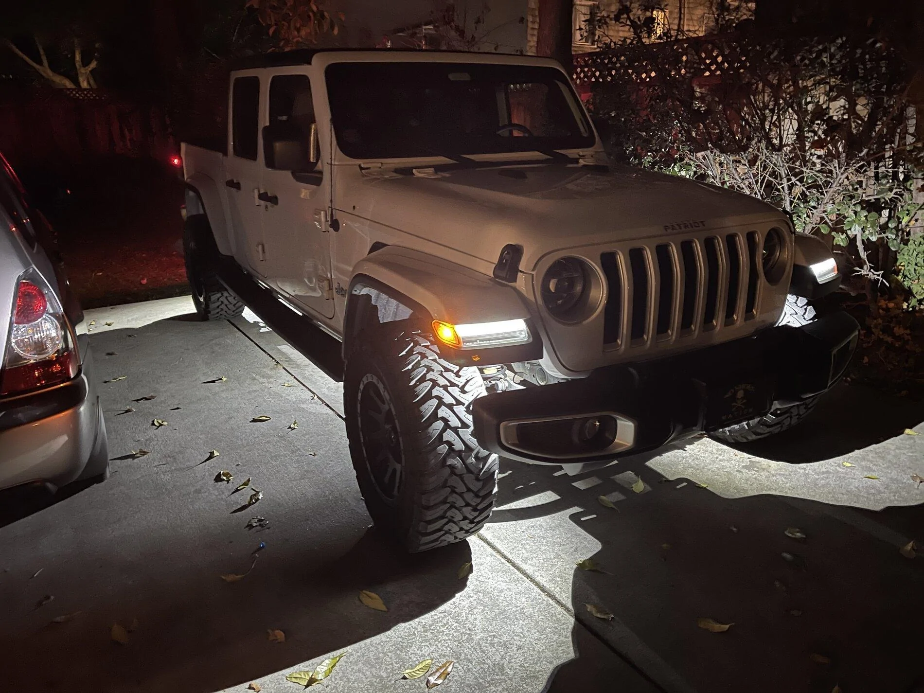

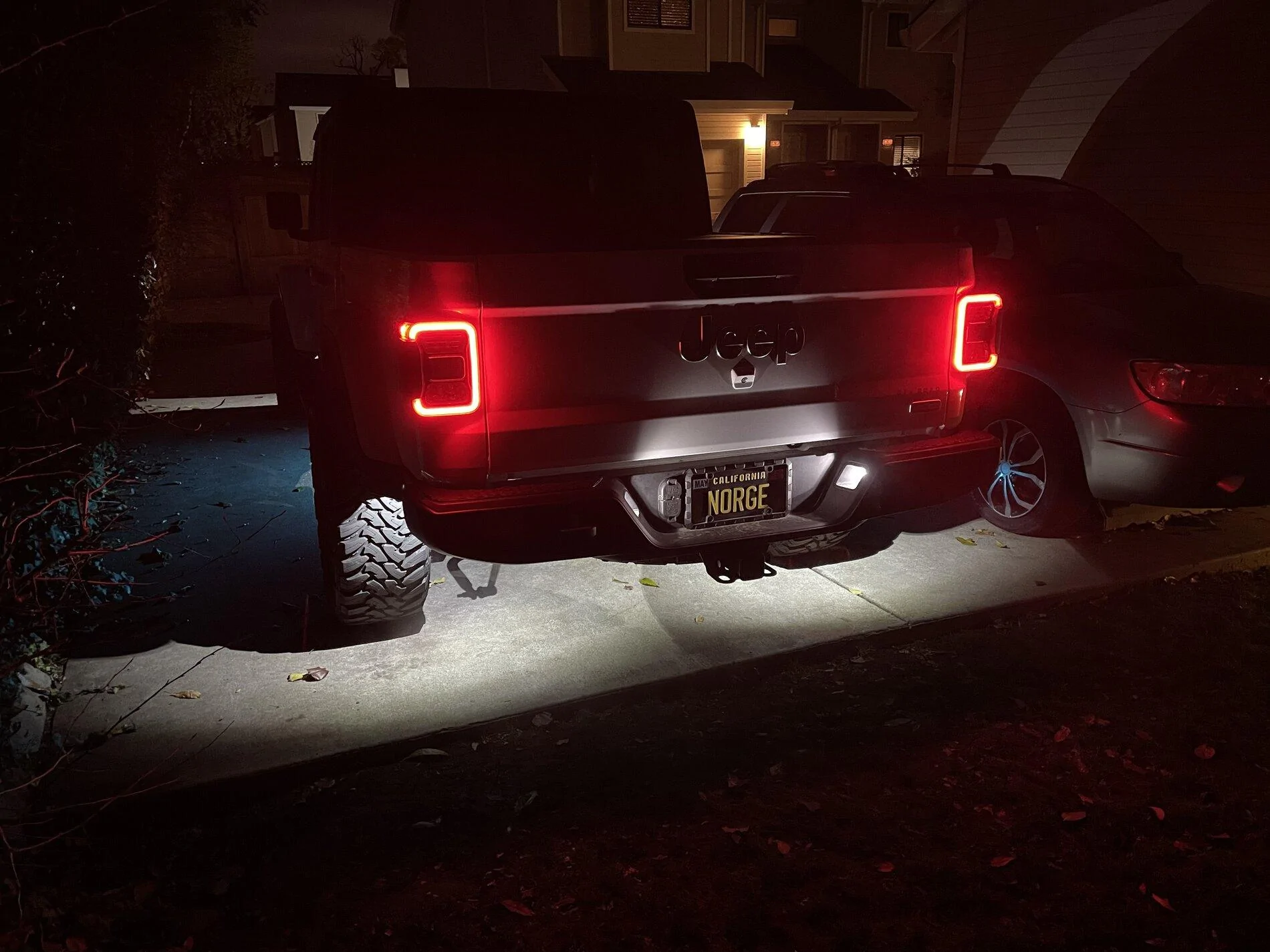

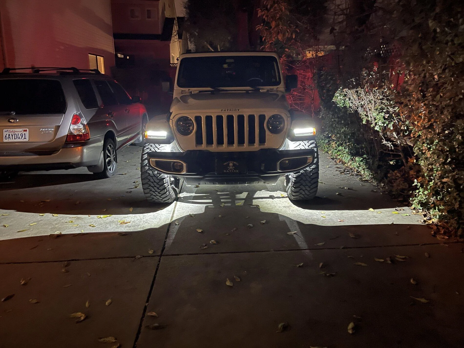

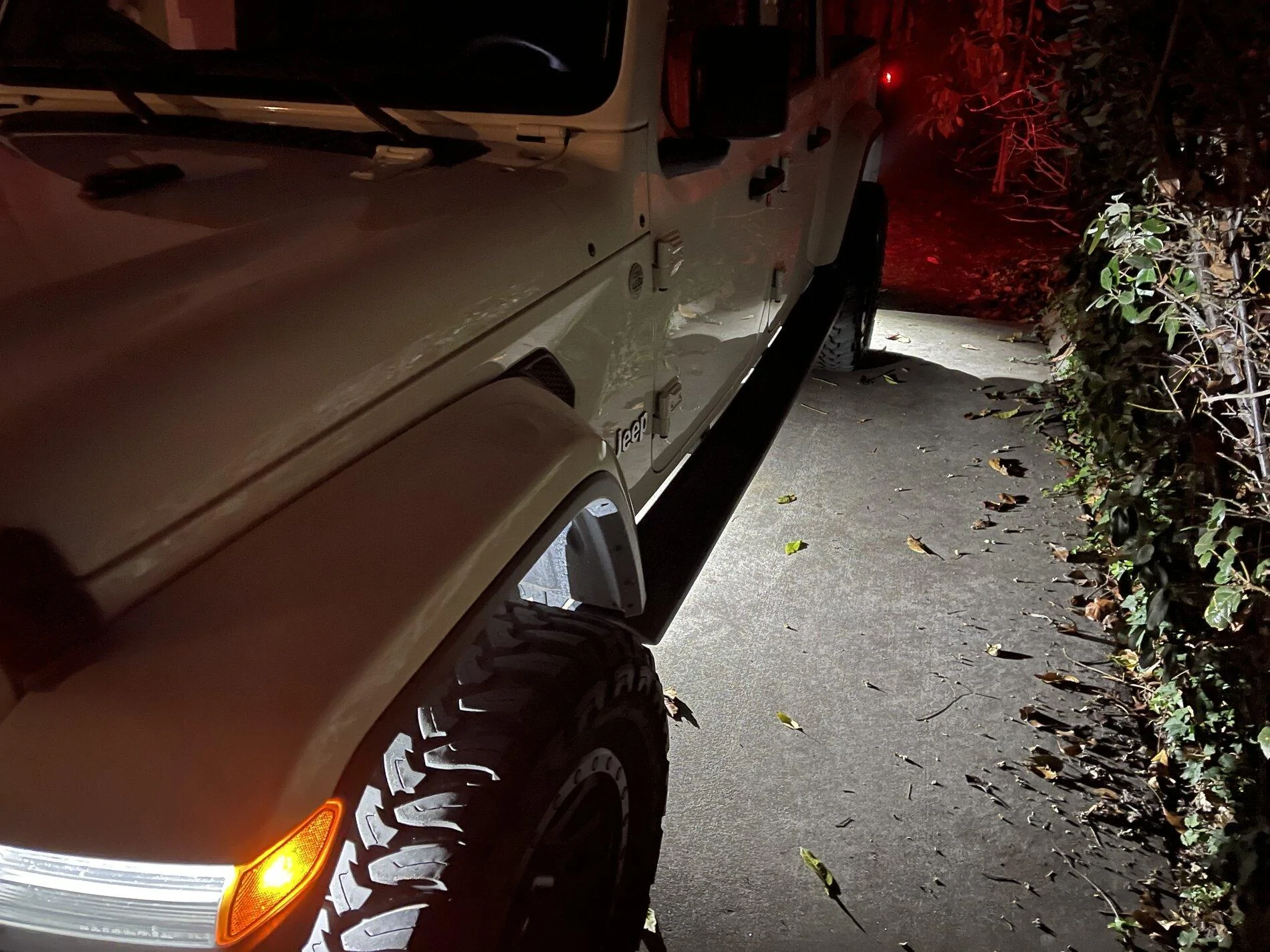

I used six two in the very front wheel well as far as you can go., angled back. Two behind the rear wheel well, there is a bracket back there on both sides, facing forward. Two on either side of the middle pointing opposite side of vehicle. Round bar I used hose clamps drilled out with bolts facing out. Here is the light it gives off. Rock lights are Pro Comp
