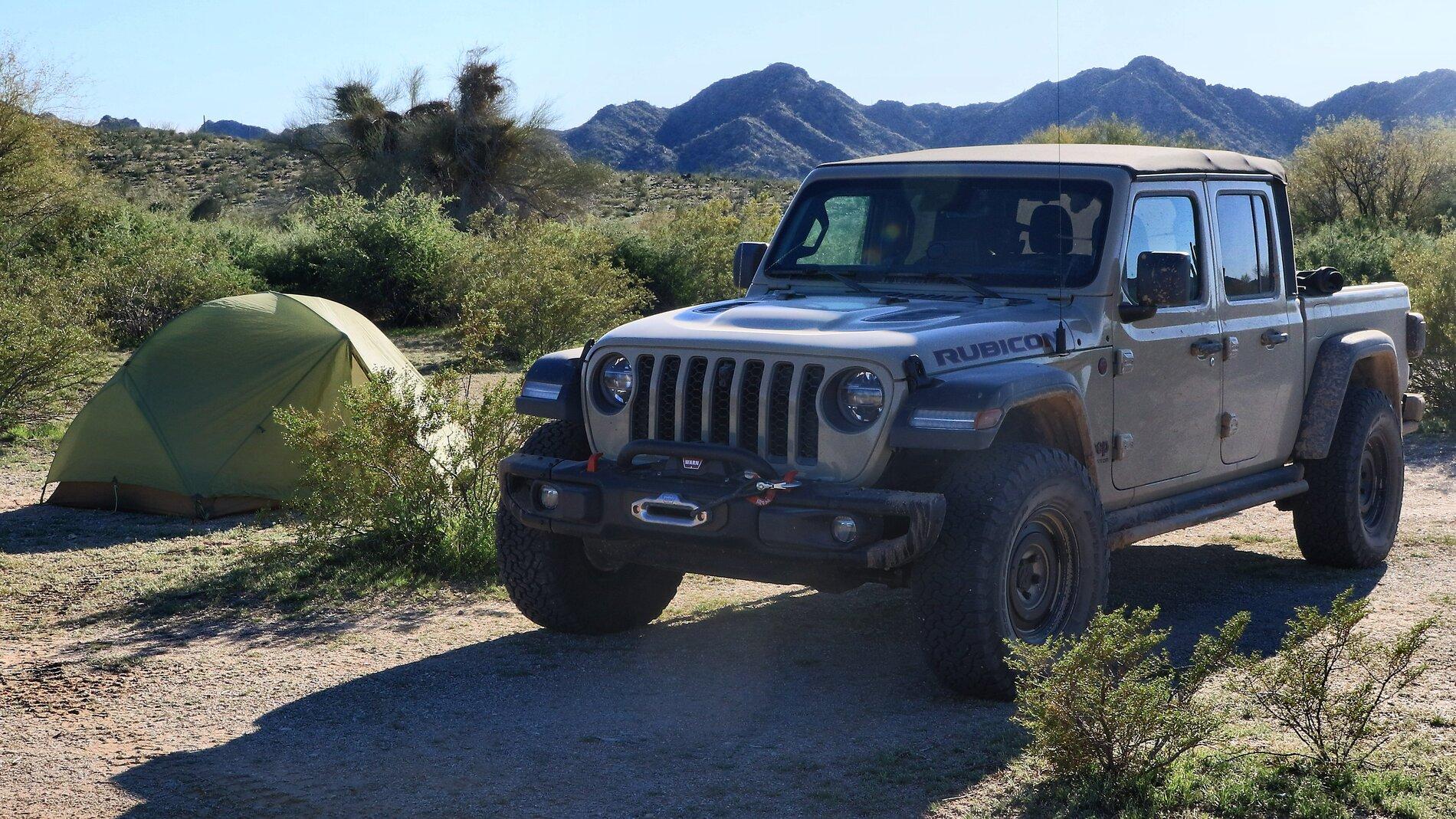

Ace Engineering rock rails are compatible with the OEM Rubi rock rails, which I'm assuming is what someone has called "rock protection sill guards". They serve me well as a step..
Jeep Gladiator Rock Rail Step add ons El Camino del Diablo Feb 20, 7_5968, Mark's Papago Well Cam
