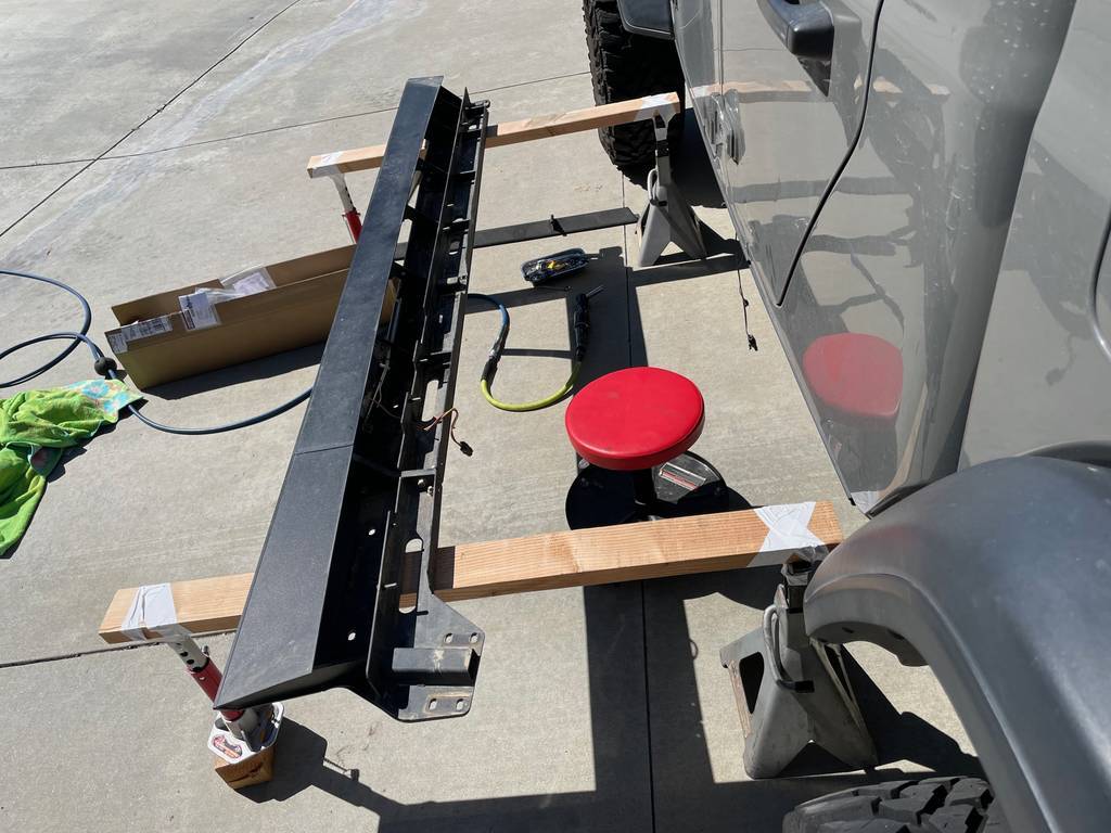

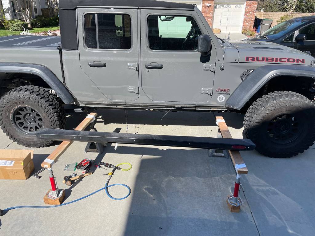

lol... I have the additional Armor on my RSE sliders, so, my sliders are super heavy. Mine have been banged around a lot, so, I use Scaffolding to service them myself. I just rebuilt the passenger side (old rebuild kit I had in the garage with a gas shock); and I just found out about the spring upgrade, so, I did that on the drivers side without taking off the sliders.
For the Scaffolding, get 4 jack stands and two 4 foot 2x4s and use duck tape to secure them to the jack stands. You do not have to loosen the big body bolts, only loosen the bolts that hook up to the body mounts. Adjust the scaffolding to the perfect height and slide the sliders out. Get a stool and sit between the steps and the truck. This will give you the right orientation to work on the rebuild kit, ie. motor, arms, etc... You will easily be able to move the sliders closer and farther from the truck so, you can hook them up electrically and test them before remounting... You can also tilt the sliders on the side, so, it is easier to work on them. With the scafolding at the right height, it is much, much, much easier to slide the sliders on and off, test them, and rebuild them. Here is a pic.
Jeep Gladiator ROCK SLIDE ENGINEERING 3RD GEN STEP SLIDER KIT or other alternatives. u7vSFr
I also have the extra armor. My friend and I just man handled them off. Wasn't super fun. Your idea is much better.

I've been using an ATV jack since I work alone an have done a few install for clients where no scratches are acceptable.
