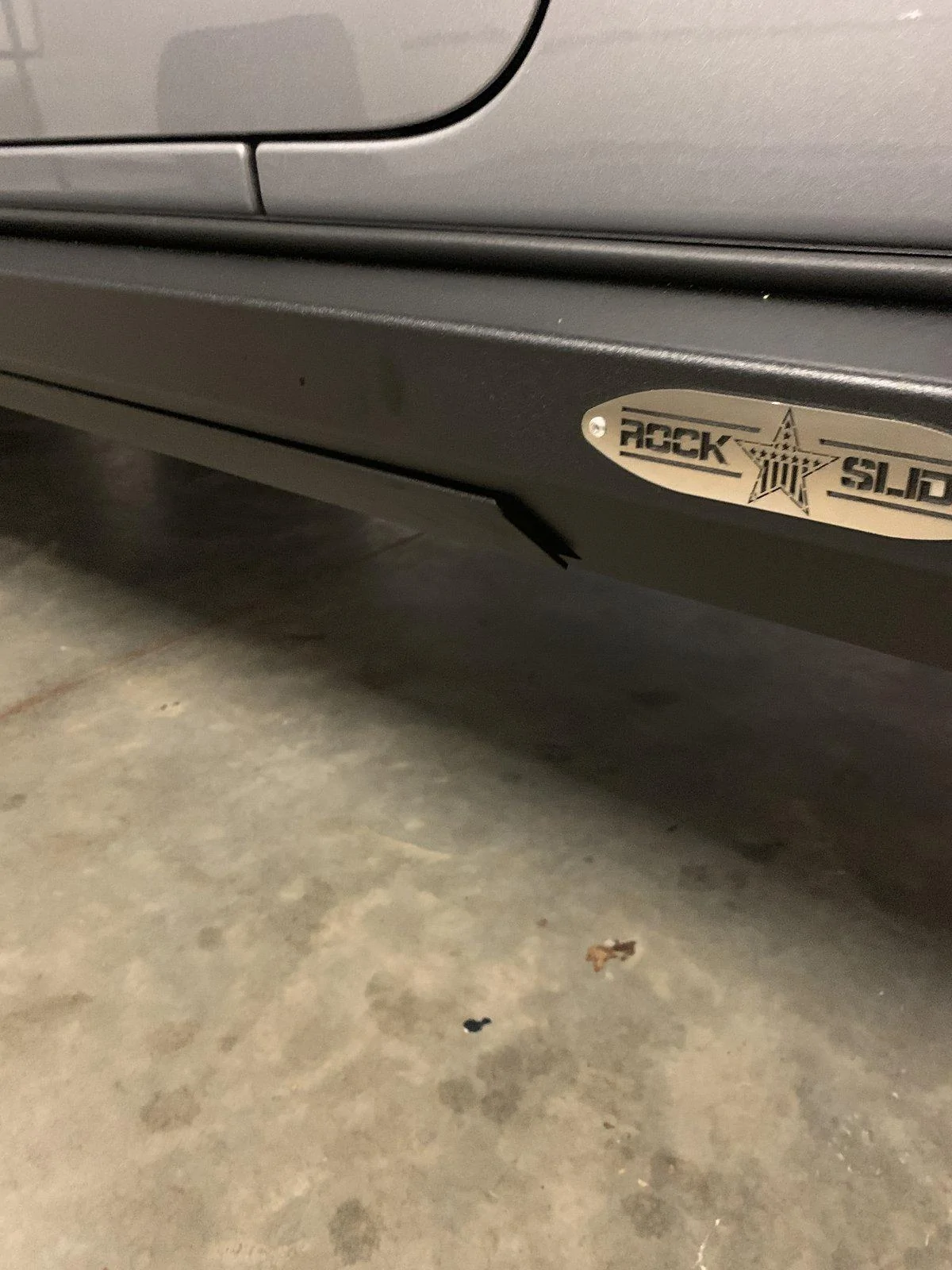

I had my RSE step sliders installed by my dealership and one of the steps doesn’t fully retract as shown. I asked the dealership mechanic and he said he has seen this on at least one side for all the other 4 installs he’s done and he doesn’t know how to adjust. Does anyone know if you can adjust the step or is this a warranty issue? I emailed support at RSE thurs and haven’t heard back from them. Also no one answers their phone either.

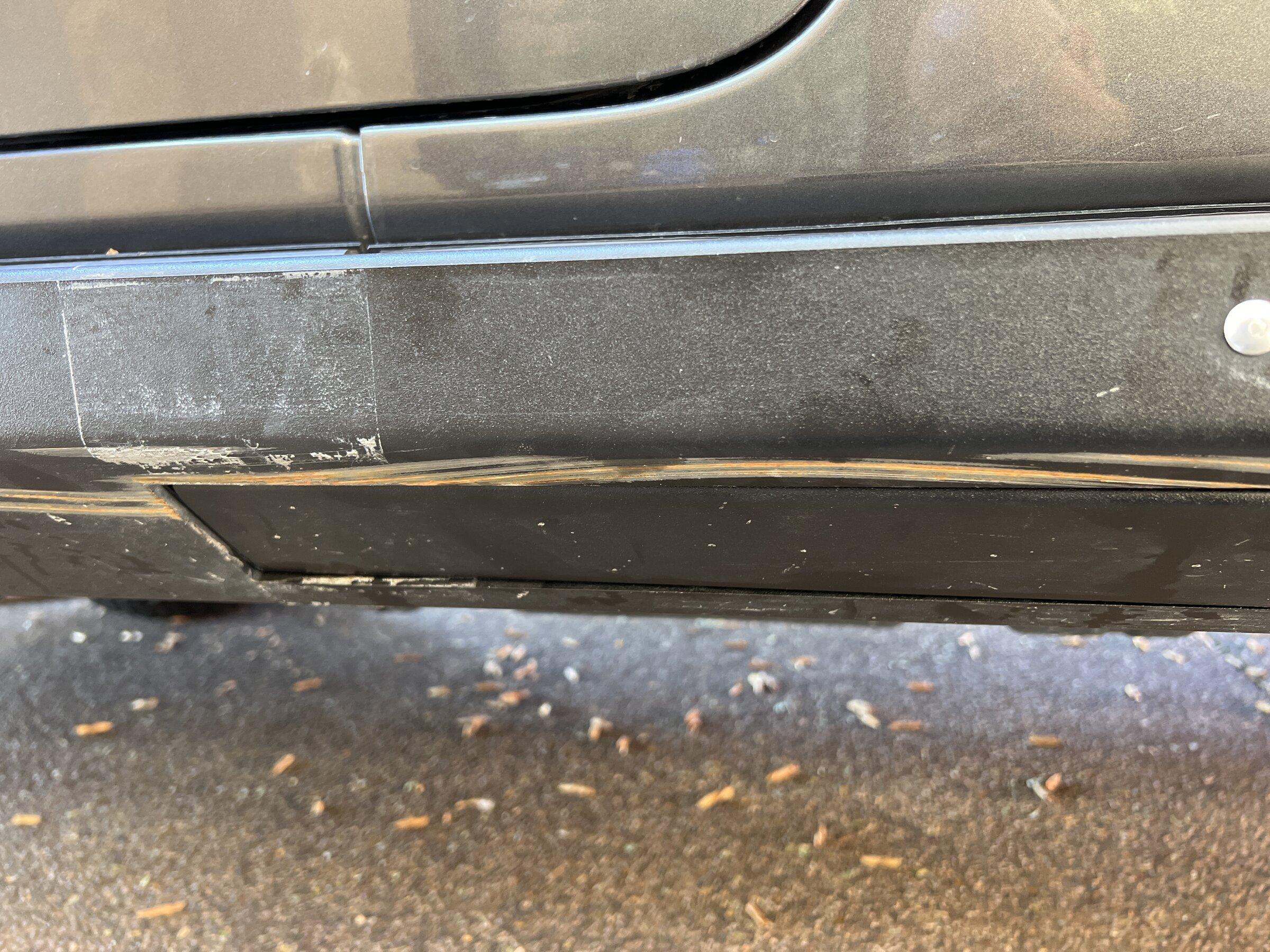

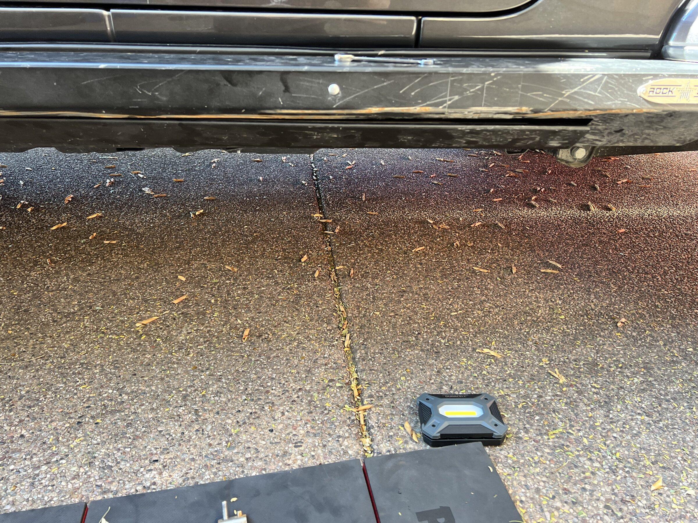

Hi, I'm bringing back this thread. It looks like my passenger step is not retracting all the way. I've lubed the crap out of them. Does any have any pics of the adjustment process. I'm assuming this is done with the steps closed? I don't want to take them off to do this lol. I think a lot of us have these steps and will need to do this at some point.

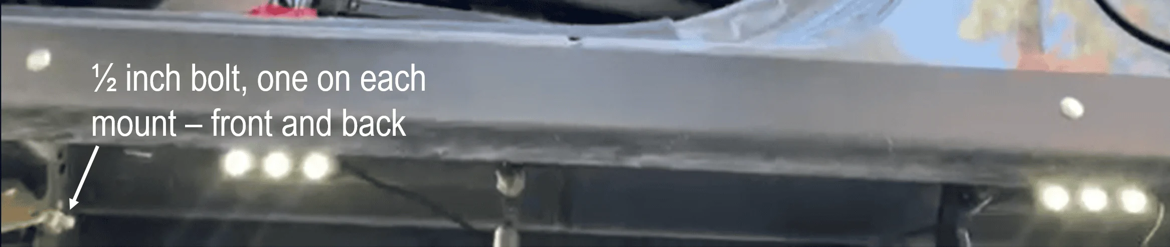

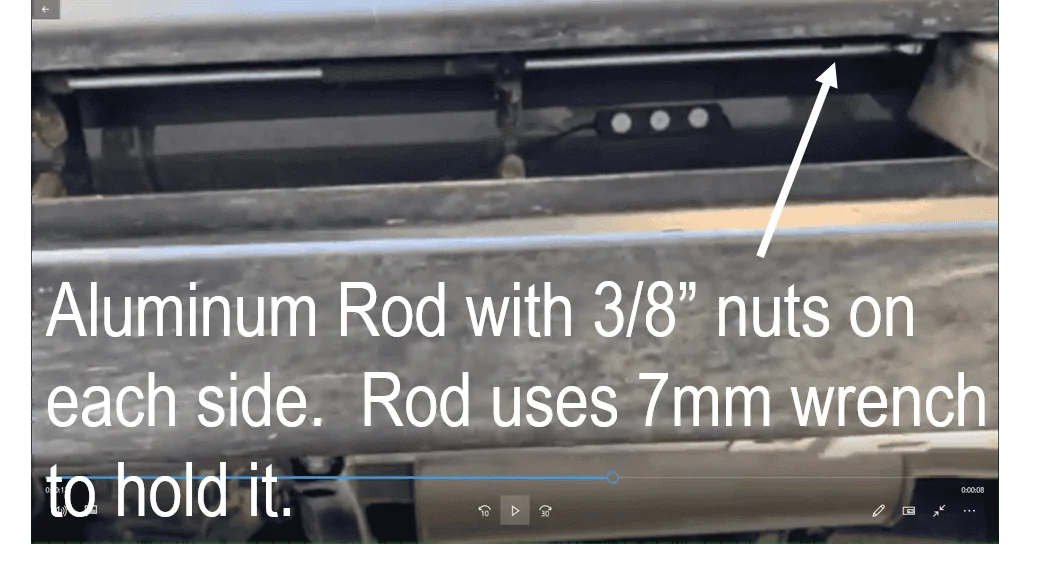

On the gen 2, the aluminum rod wrench size is 7mm, and the nut size is 3/8". You want to turn that rod slightly until you get it parallel. Just extract the steps and look from underneath, you will see the long aluminum rod. Also, if your step is hitting the platform on the way in, which keeps the step from fully retracting, you can loosen the 1/2" mount screws inside the platform (can be seen from underneath when the steps are down), and pull the whole assembly a little down or up - depending on where your clearance issue is. In addition, as you bang up your Platform sliders and they bend, especially if you do not have the armor, you can grind the step itself a little on the edges to make sure they go in and out smoothly without banging the platform. Bottom-line, retract the steps and make sure there is clearance all around on the platform. Any clearance issues, will cause banging and stop the retraction. In the end, replacing a step is not expensive, so, any grinding I do on the step itself, not the platform.
