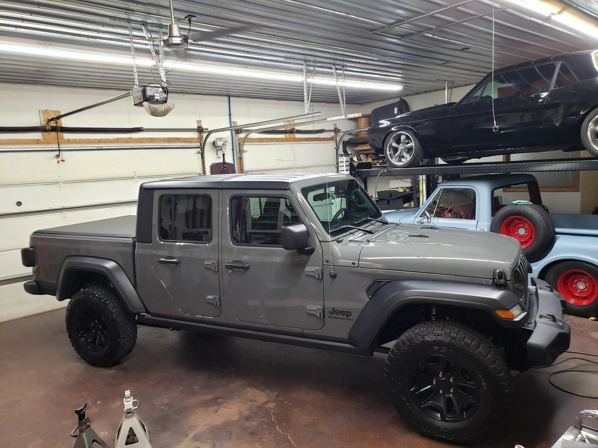

My first new vehicle and I was able to order it, very exciting. I wanted to build something that was capable, well rounded, and still enjoyable to daily drive. Here's my order list:
Hardtop
6MT
Sting Gray
Tow Package
Cold Weather Package
7" Touch Screen

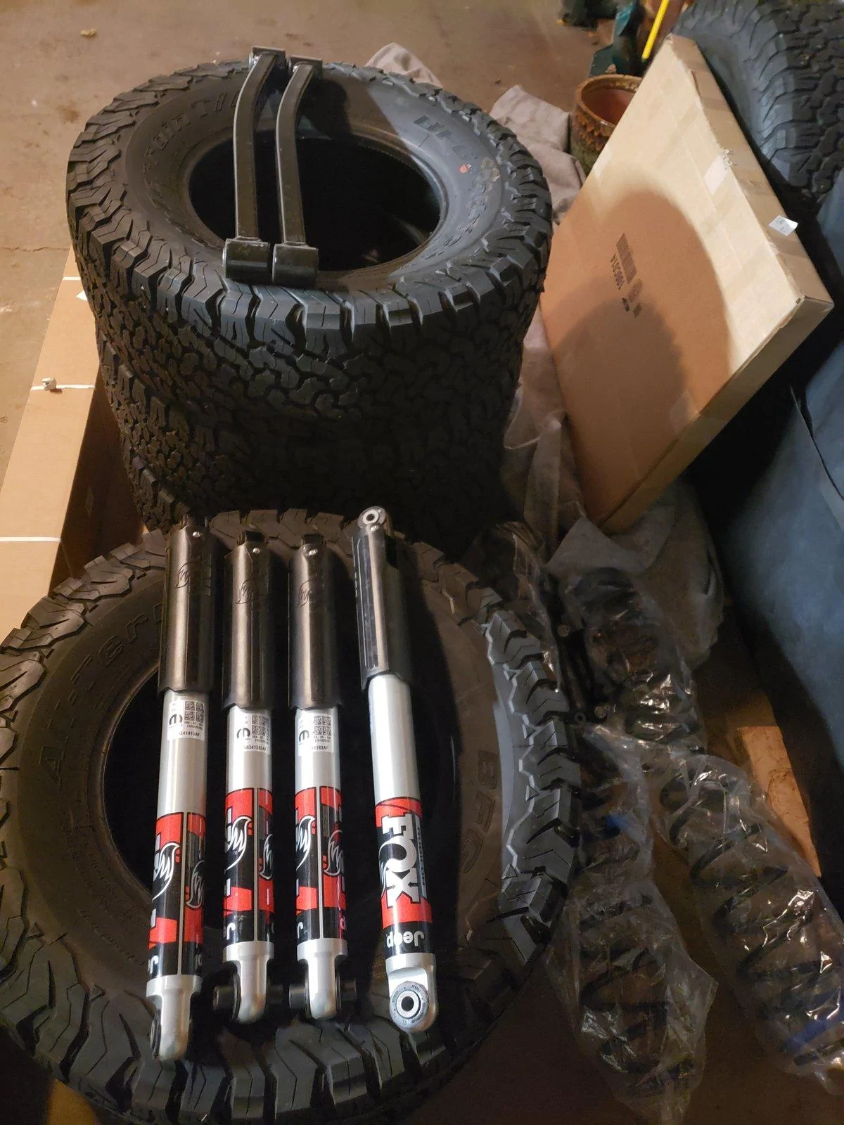

I had 10 weeks to sit and think about all the mods I wanted to do so here's what my garage looked like prior to my JTs arrival

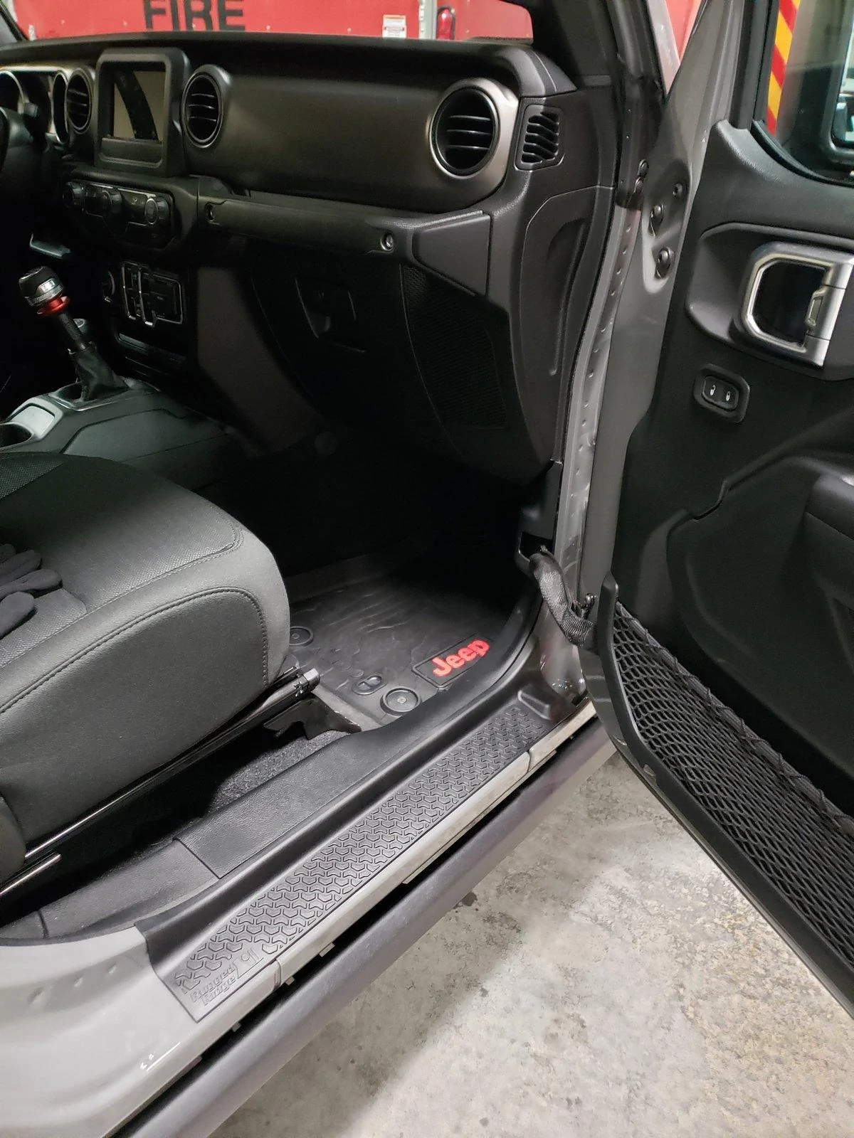

Some smaller mods to clean up the look for me. Removed all badges except for the JEEP on the tailgate, replaced the trail rated badge with a black version, and a shorter black antenna. Added door sills and the Jeep slush mats as well

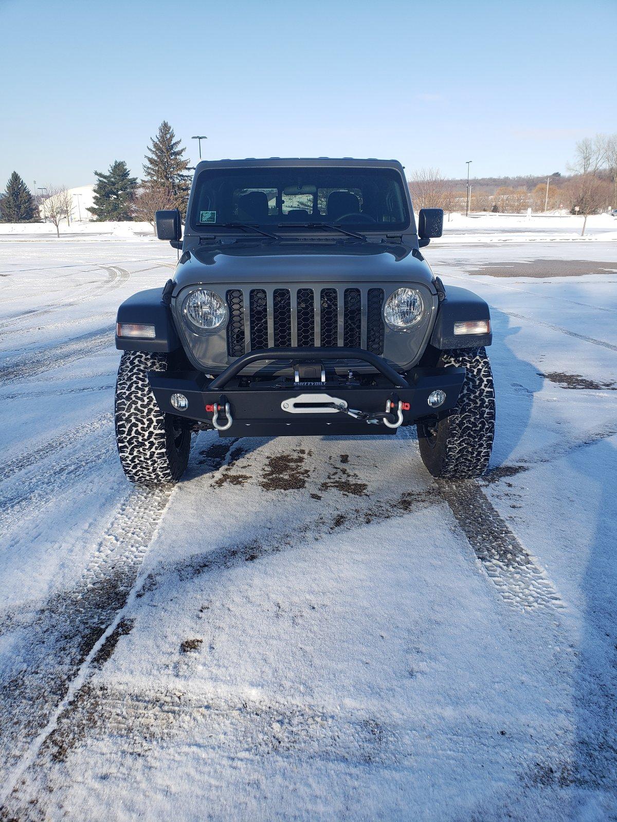

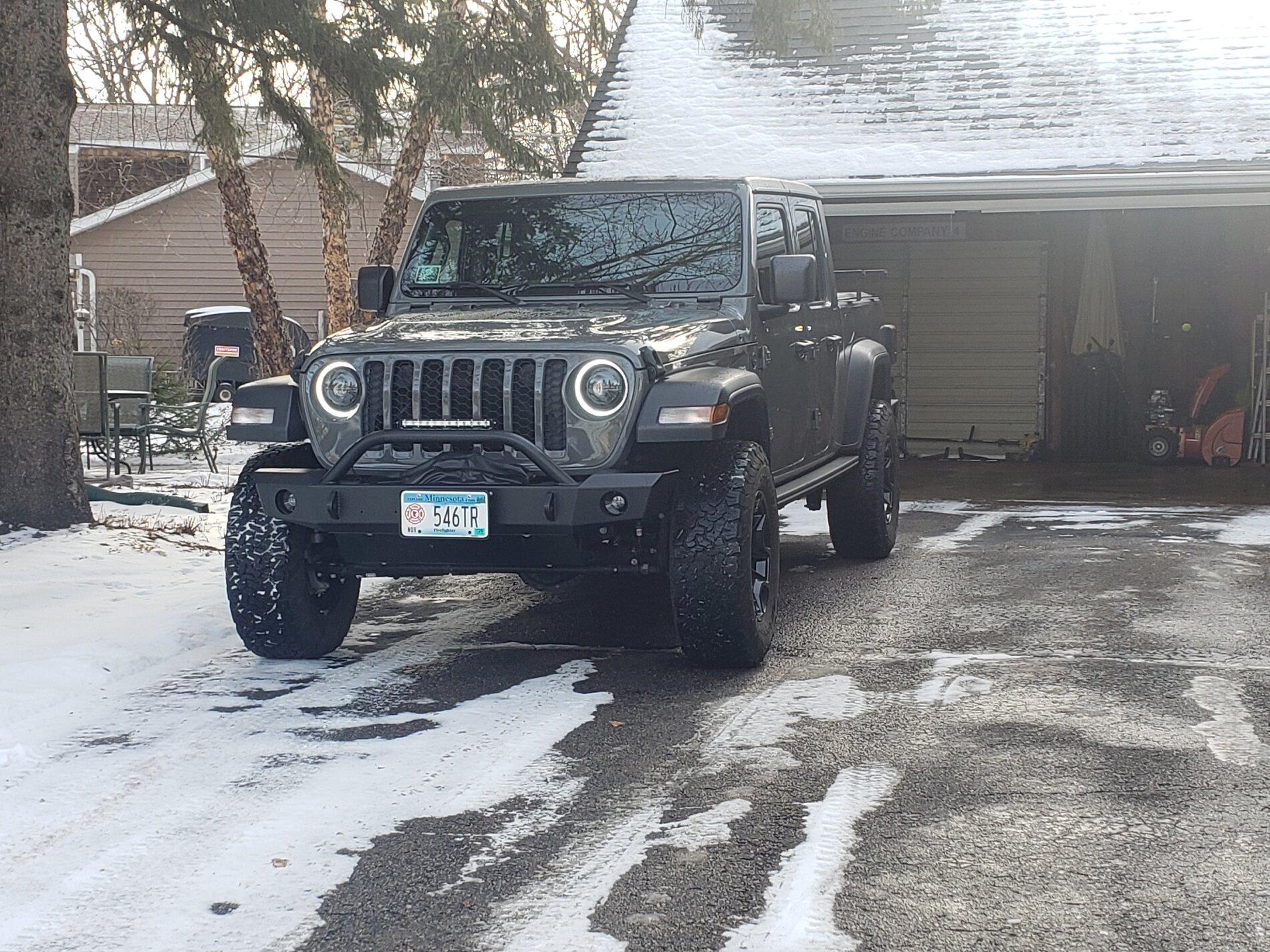

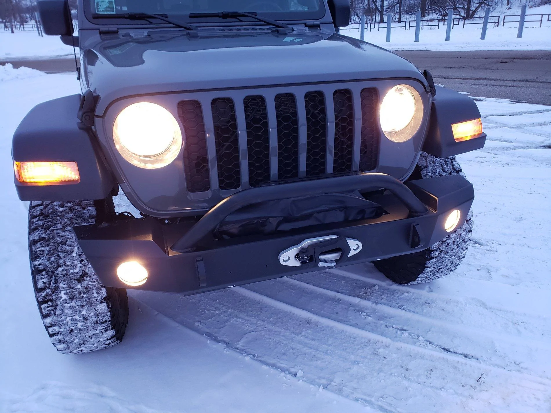

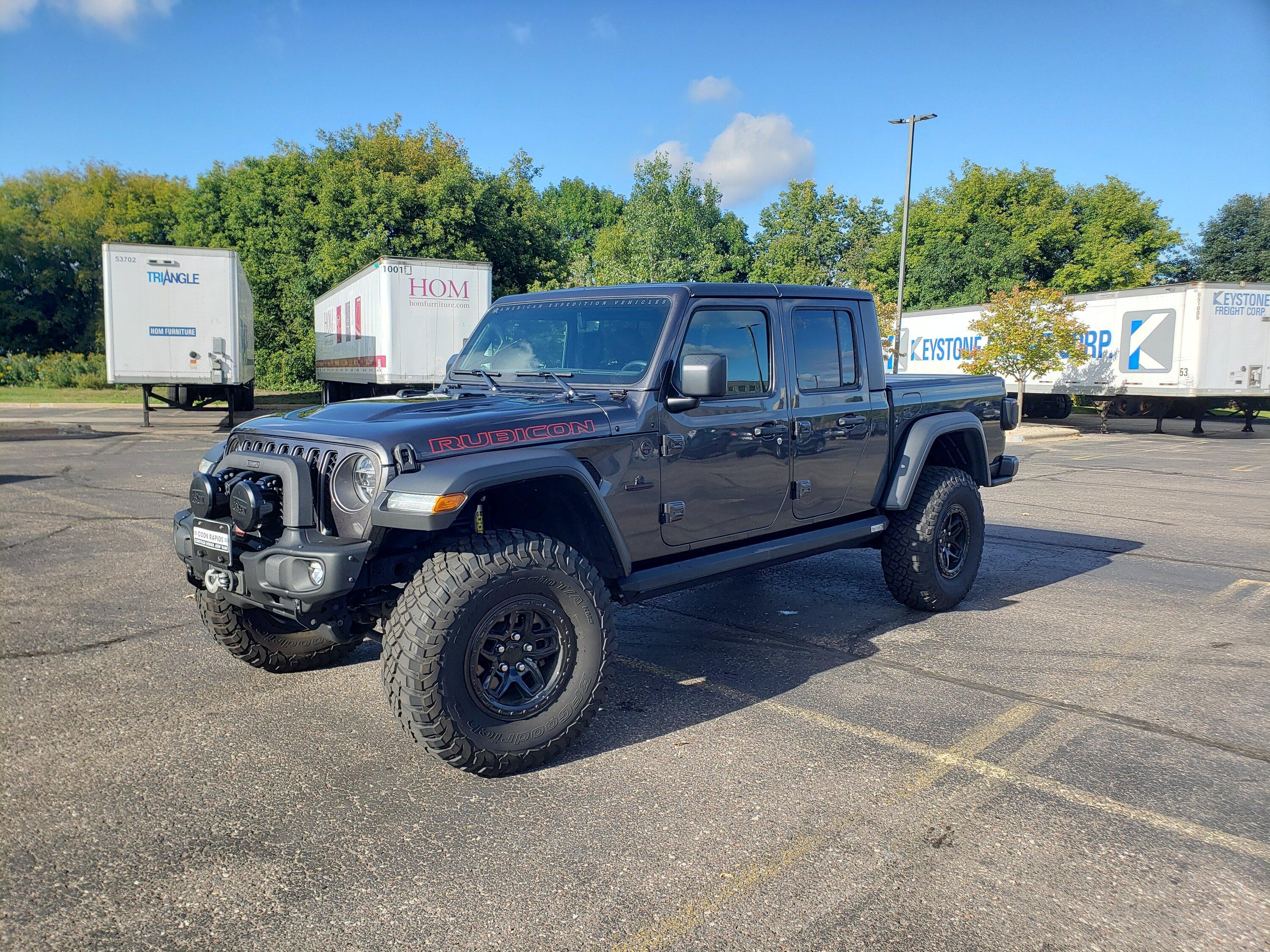

Next up was adding a LOD signature series bumper and winch. Went with LOD because the weight was decent (72 lbs), it doesnt stick out very far, hidden winch, and it's subtle looking. Winch is Smittybilt X20 w/ synthetic line. Front end lost about .5"

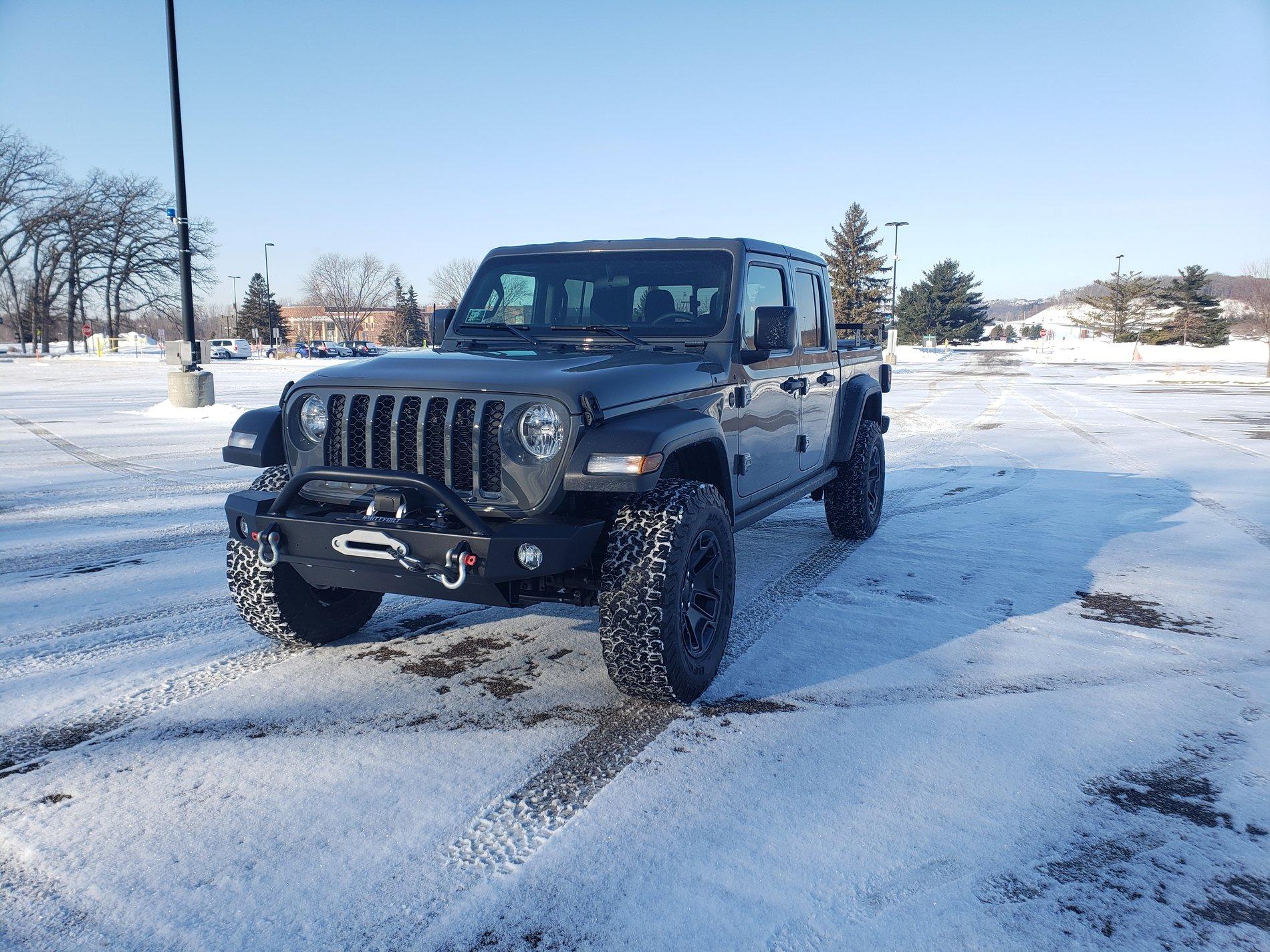

Wanted to clean up the front end and lift the front end up back to stock height. So, I installed a smittybilt flat hook (removed D rings) and Teraflex 1" spacers up front. I decided on a small spacer after talking to Synergy suspension. Until I add bigger tires (35s or bigger) the amount of bump stop I would have to run with longer springs would limit my up travel. So their recommendation was a coil spacer, easy enough. At this time I also added JKS quick disconnects to the swaybar.

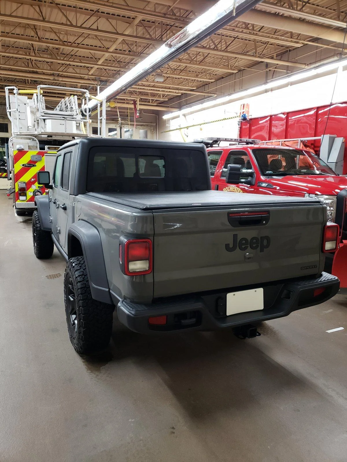

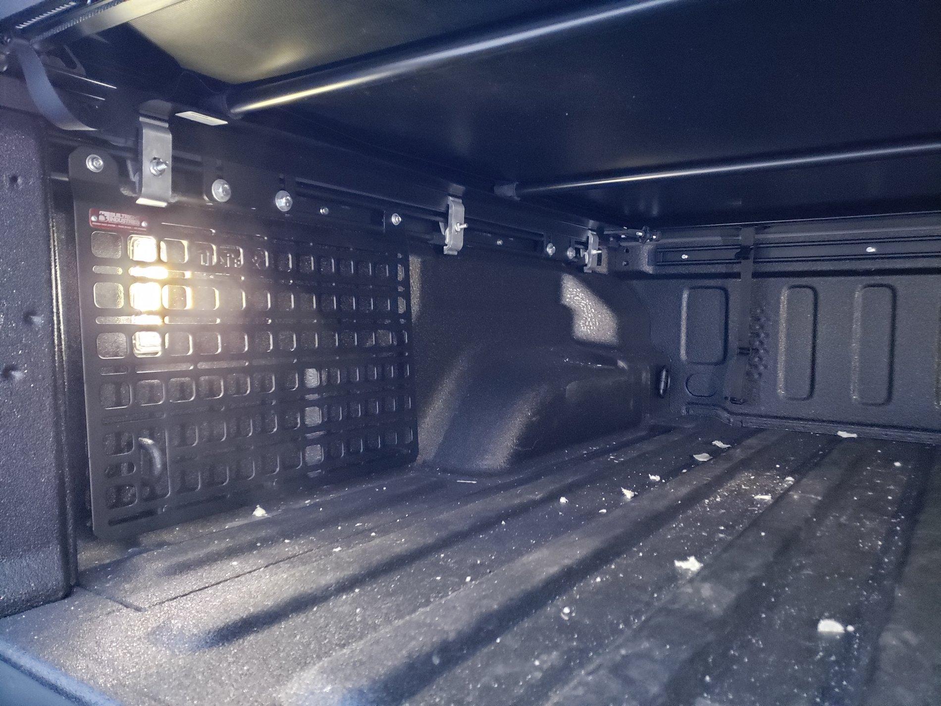

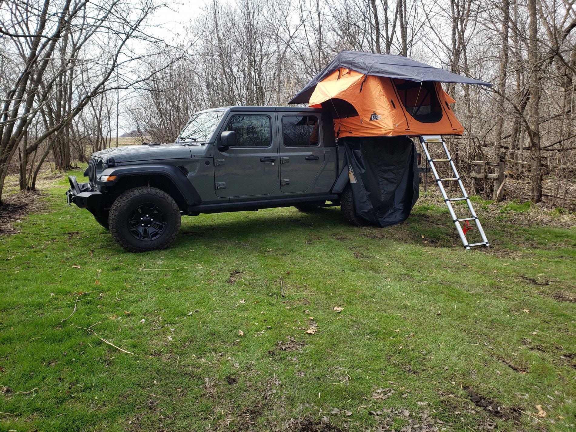

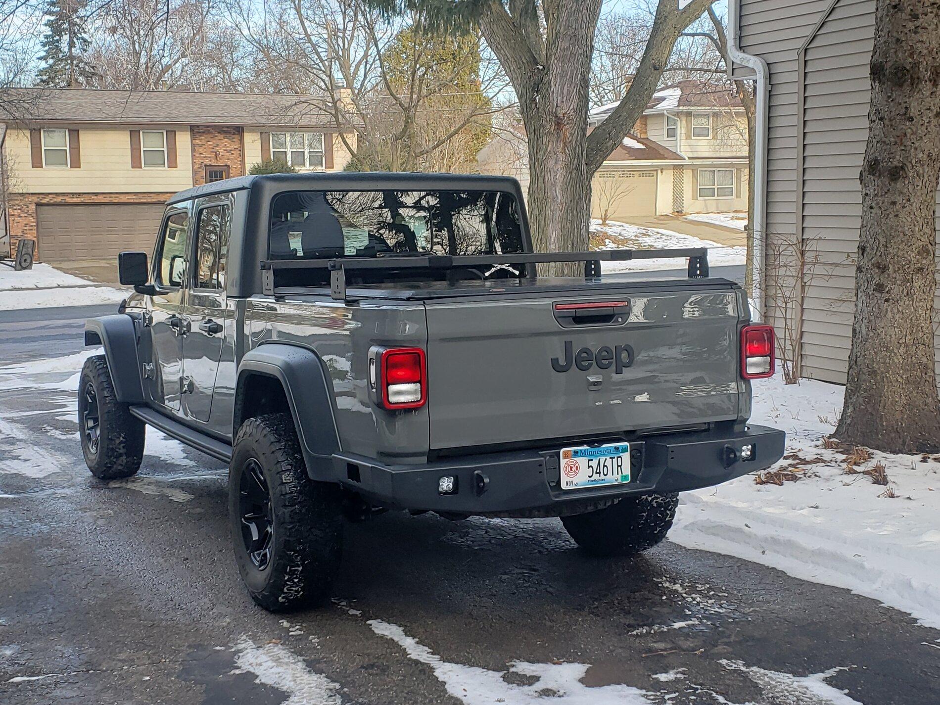

The bed is one of the most important aspects of this build. I use the bed a lot for house projects and want to be able to utilize it for camping. I mixed a hodgepodge of parts to make it right for me. First, I got the bed Line-x'd and added the built right trail rail system. From there I bolted Voodoo engineering uprights to the trail rail system and then reinstalled my tonneau to the trail system. I ended up having to strip the foam from the rail sides and installing some thicker foam cutting out the area around the upright to get a proper seal. Then I added the crossmembers to the uprights. Lastly, I added a Molle panel from builtright.
The idea was to be able easily remove the crossmembers when I need access to the bed, have the rack tall enough to roll the tonneau, and be able to mount my roof top tent below the roof line. It worked about as well as I could've hoped for.

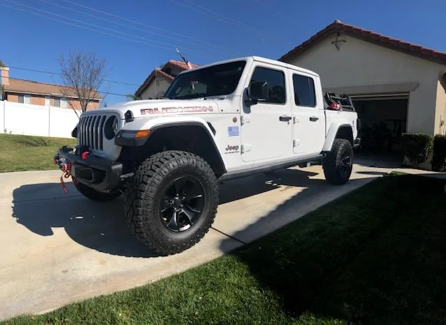

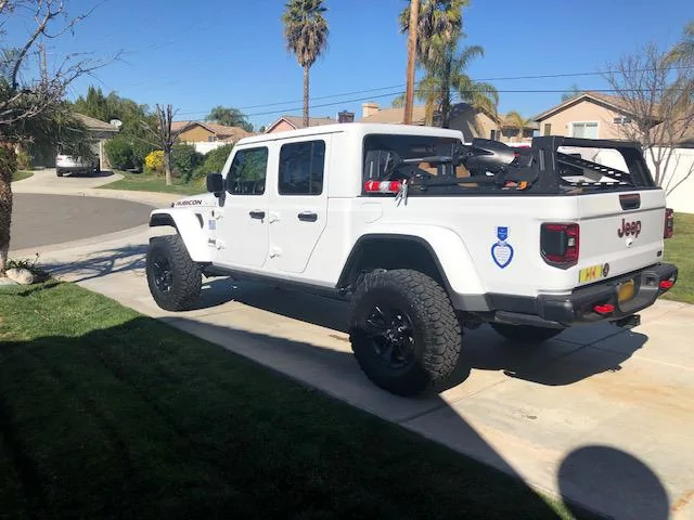

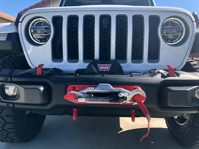

Yeah, I did the math on the LE, JT and decided it was the most cost effective since a built would cost more in the long run. But it was a difficult choice because of the initial price. You've put a lot of thought into it and going about it in a pragmatic way and it looks like you know what you're doing. I can certainly appreciate that.
Not happy with an unfinished wench install on mine and will address it this weekend. I'll post fresh pics when it's done.

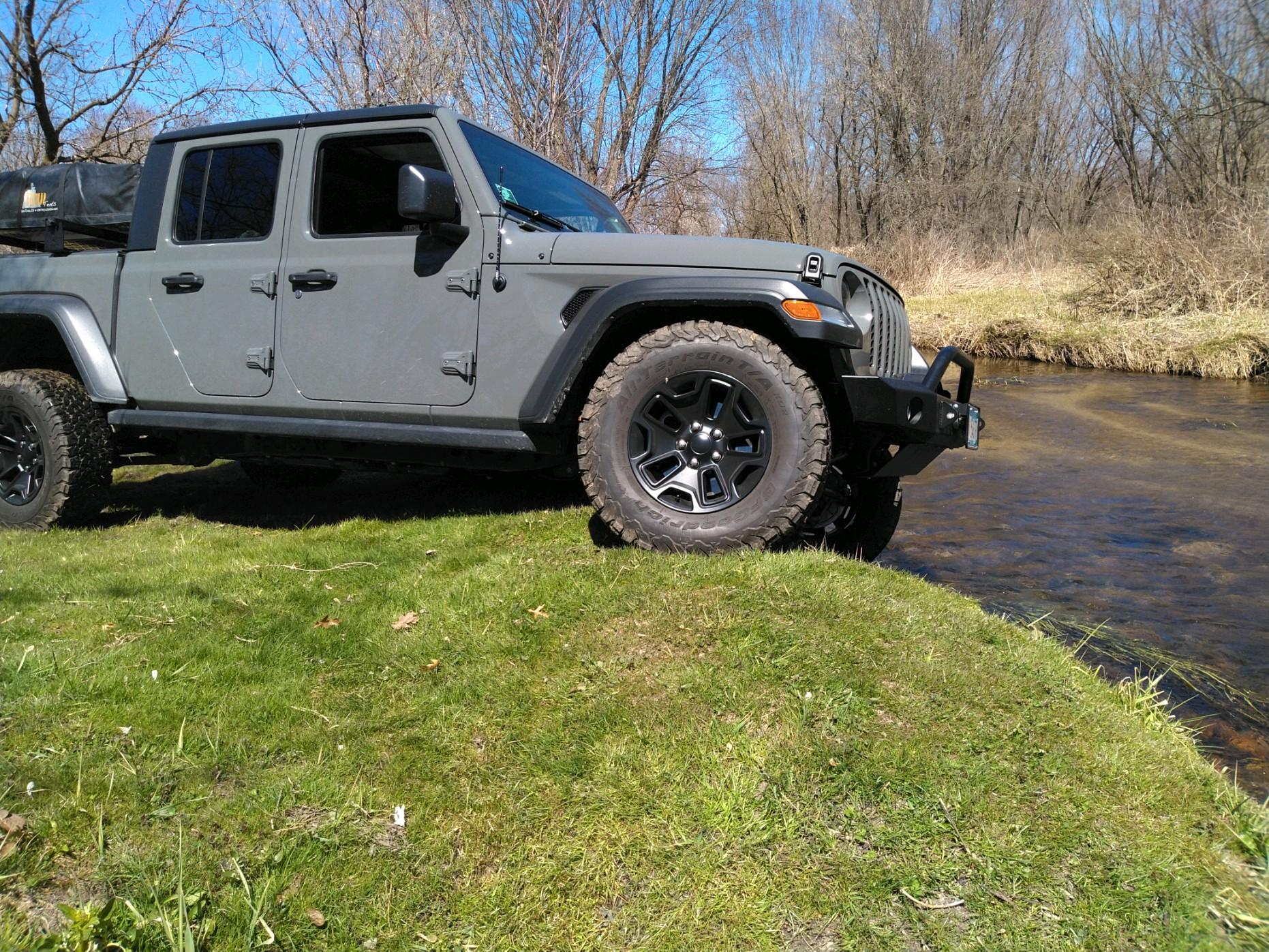

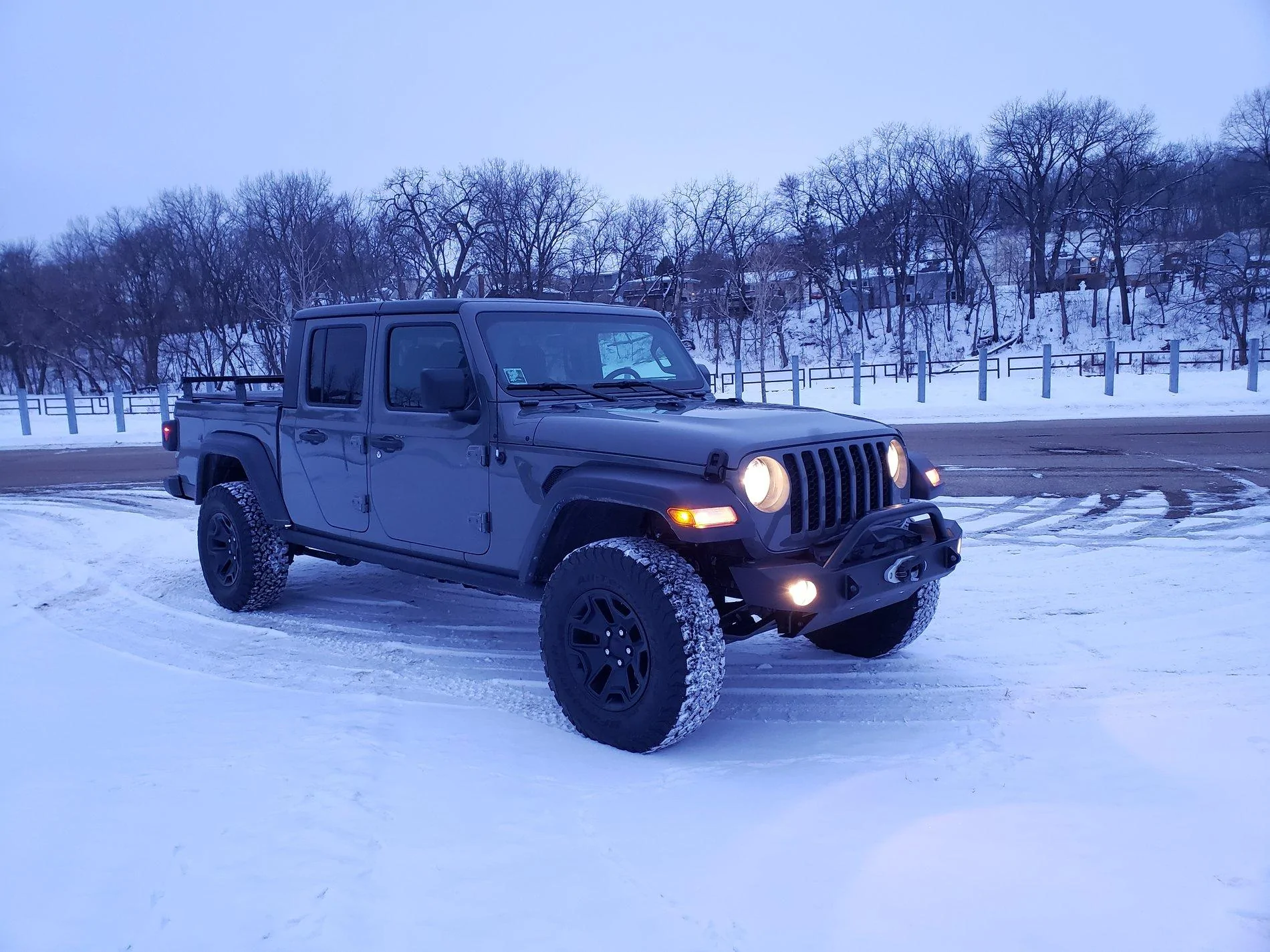

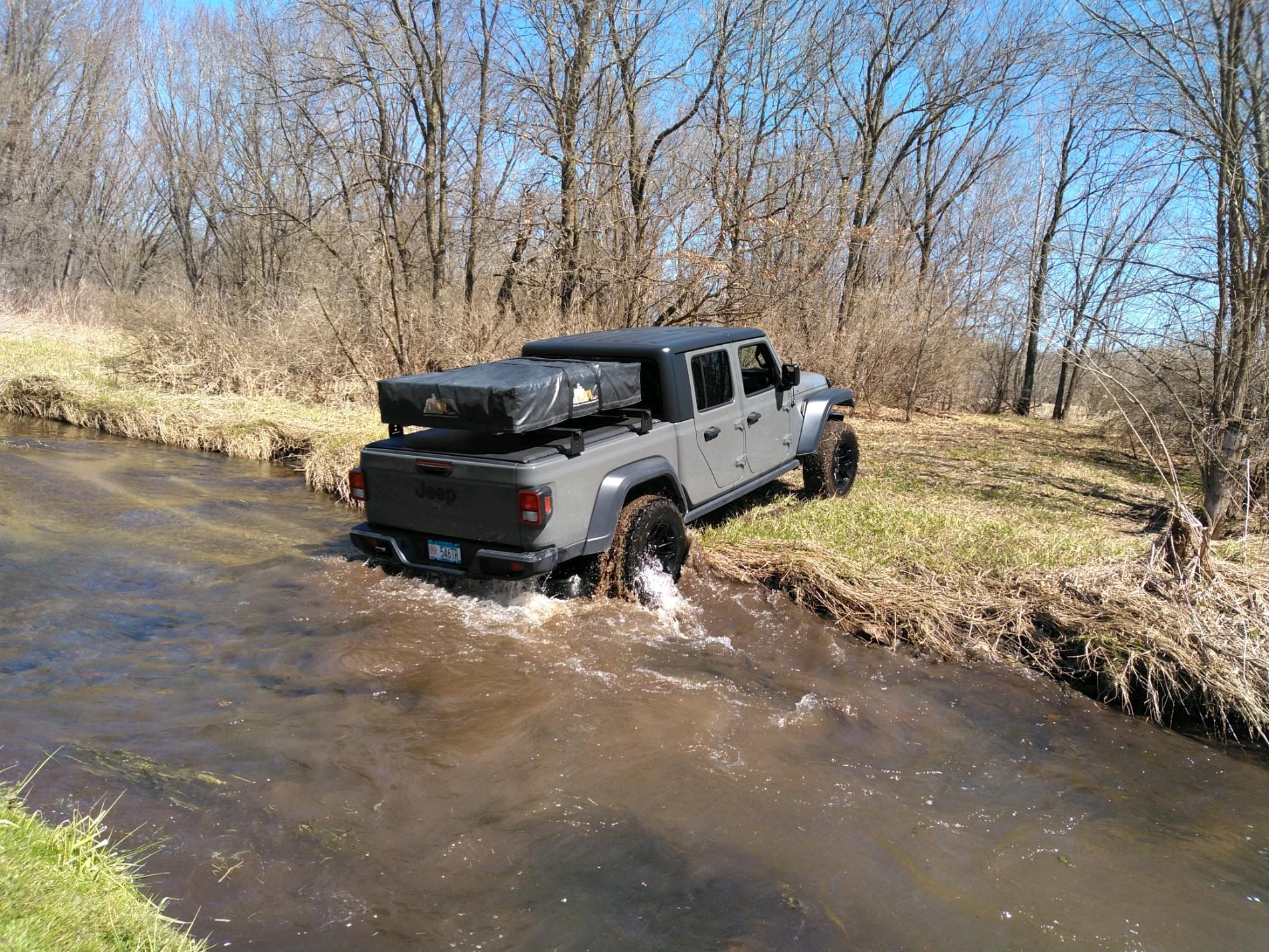

Kinda forgot I had this thread. No major changes, JKS swaybar discos installed and utilized to cross a stream after camping.
