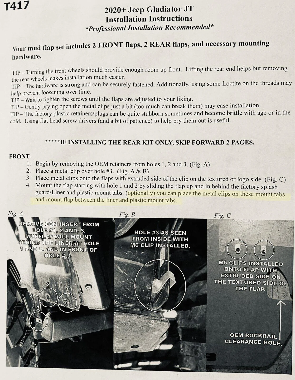

I definitely had a hard time with the install, the instructions contained references to things that I couldnā€™t make sense of (video helped quite a bit).
For the fronts, I remember the flaps did have to ā€œcurveā€ a bit in order to install correctly.
Also, on my Overland, I followed the ā€œoptionalā€ directions in step 4:
Jeep Gladiator Rokblokz phone number? Front flaps dont fit and I am not happy 679FCC47-B85D-4F45-B40E-69175B74067F
Those brass clipsā€”instead of attaching them to the flaps, I attached them to the plastic tabs that stuck down behind the plastic wheel well liner. Then, the thumb screws went through the liner, through the flaps, terminating in the brass clip which was mounted on the plastic tab from the vehicle (behind liner).
It all had to have a slight bend to make it work properly.
