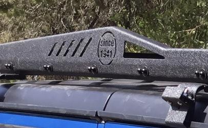

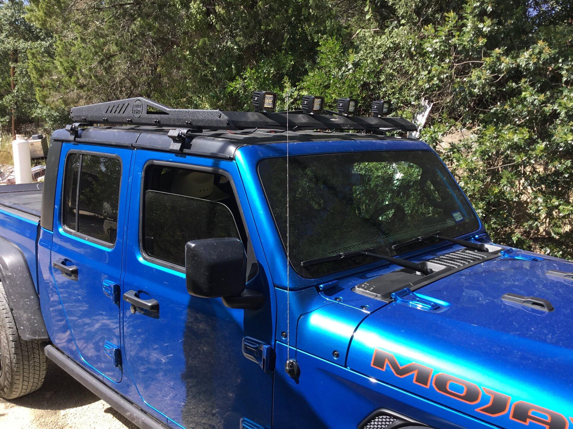

Anyone have the Hooke Road rack? It says bolt on, but it’s also no drill. They don’t show a picture of it on a JT though so tough to compare.
Have a tap on hand to chase the threads of welded nuts.
Have spare metric bolts on hand for the ones they short you.
The flat washers they provide are too wide to use on the cross bars.
Only one per cross bar per side can be installed.
Have fun on the corner support bolts as five are bunched too close to one another.
Do not tighten any bolts until all are started.
I messaged customer service but they did not respond.
Former ASE master tech so no, I started all the distorted welded nuts by hand.
On the up side it was only three that would not start without a tap.

Wow. I’m glad I asked thanks for the feed back. I haven’t decided what I’m going to do yet but this helps a lot. Sucks you had so many problems. It does look good on your rig for sure.

I drove it today for the first time.
Above 35 mph it starts to make too much noise.
I have a Hotheads head liner with the optional sound deadening strips .
My daughter told me to turn the radio
up…

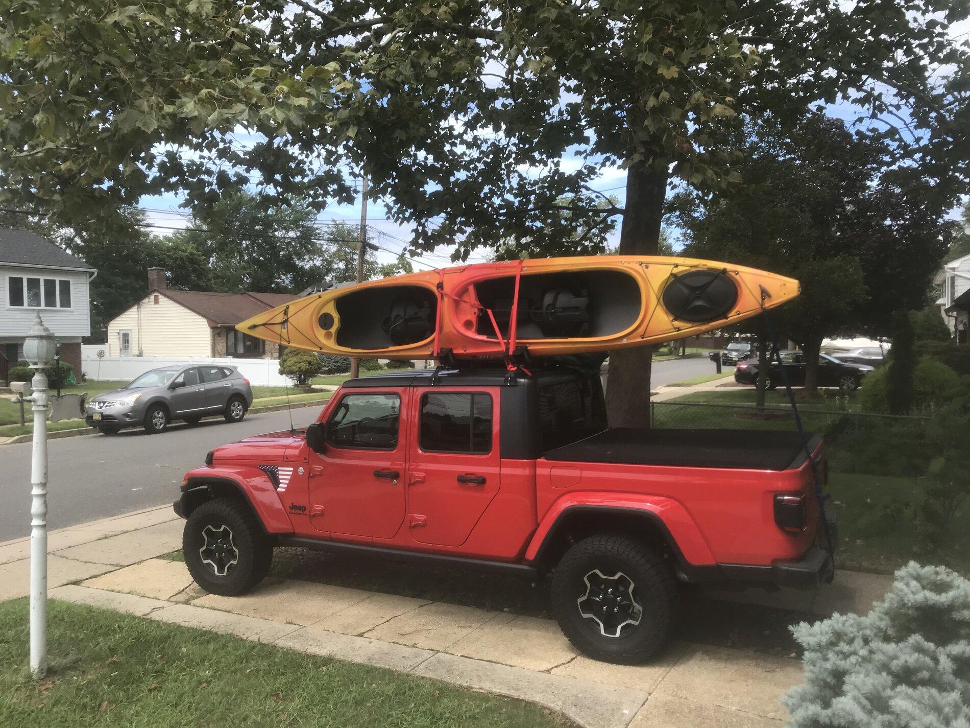

Exposed Racks work well for my kayaks.
Jeep Gladiator Roof Rack Search; easy on easy off, no drill? 44DC2FFC-E080-4E9C-8908-80EF59270DCA
Would you feel comfortable with this setup if you had another kayak that size up there? I have two kayaks that are 70-80 pounds each that would travel at highway speeds. They are 11 to 12 feet in length.
