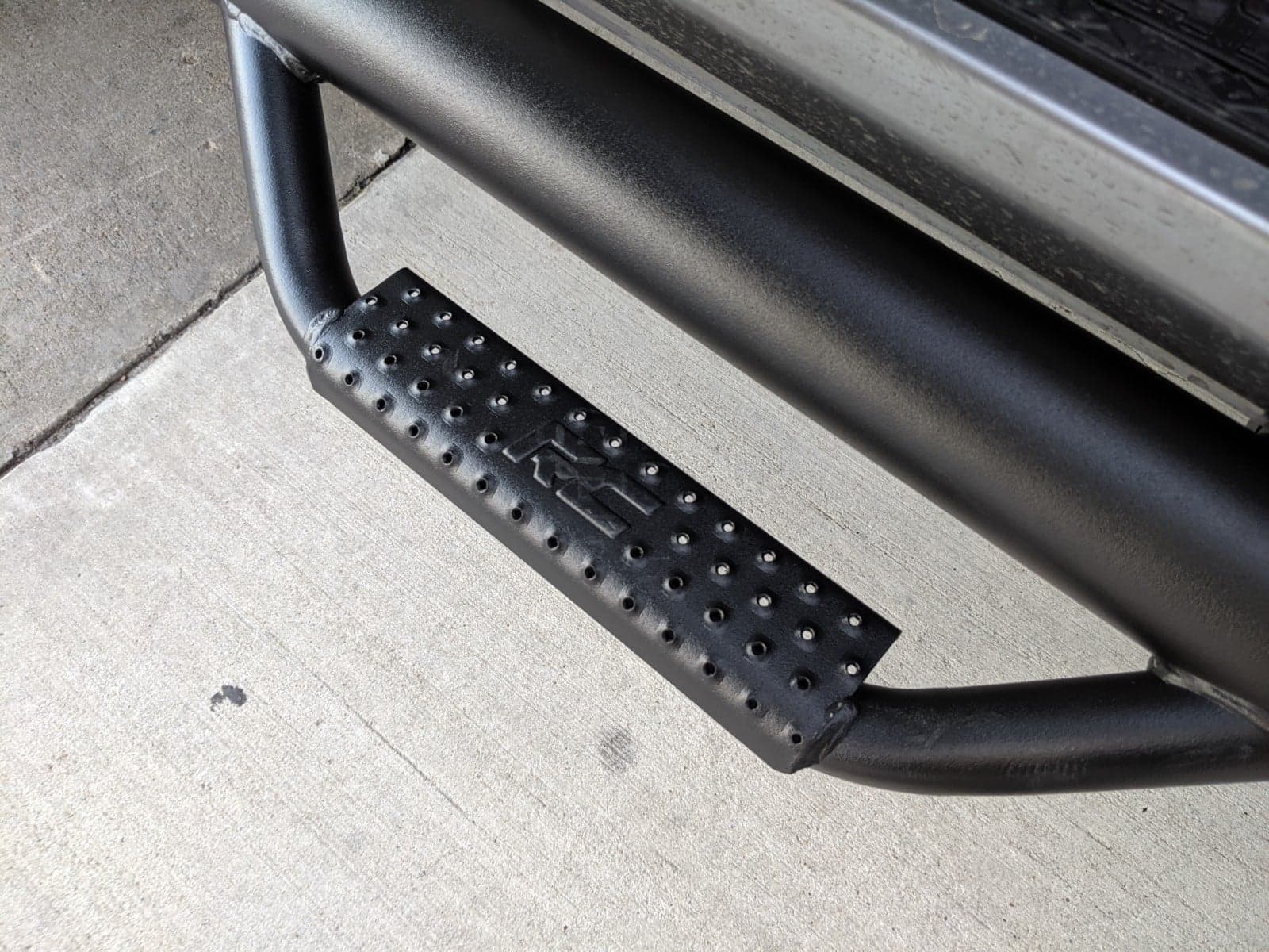

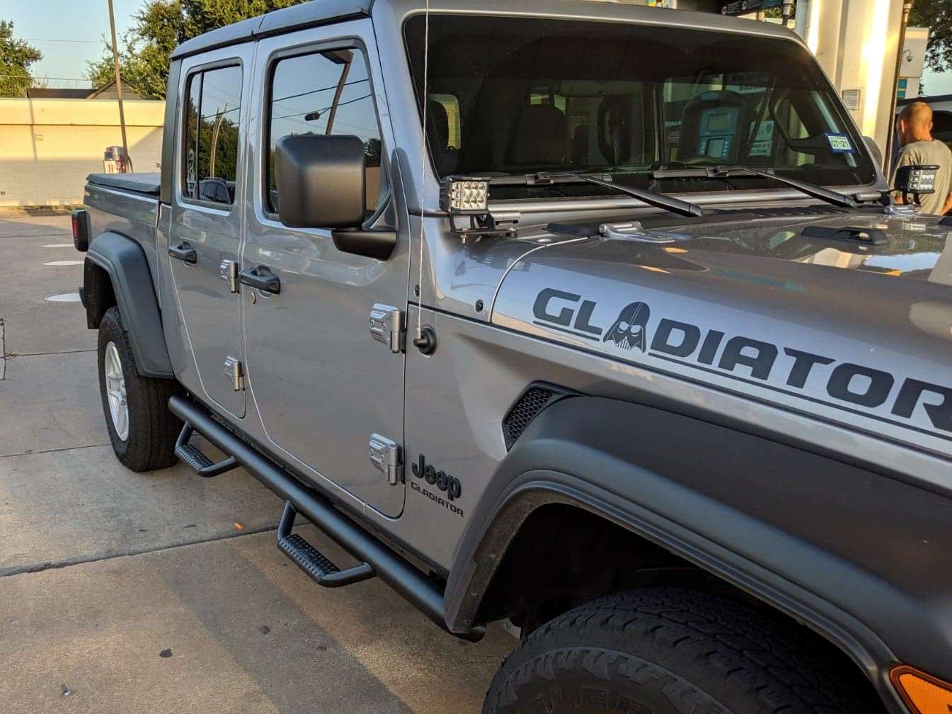

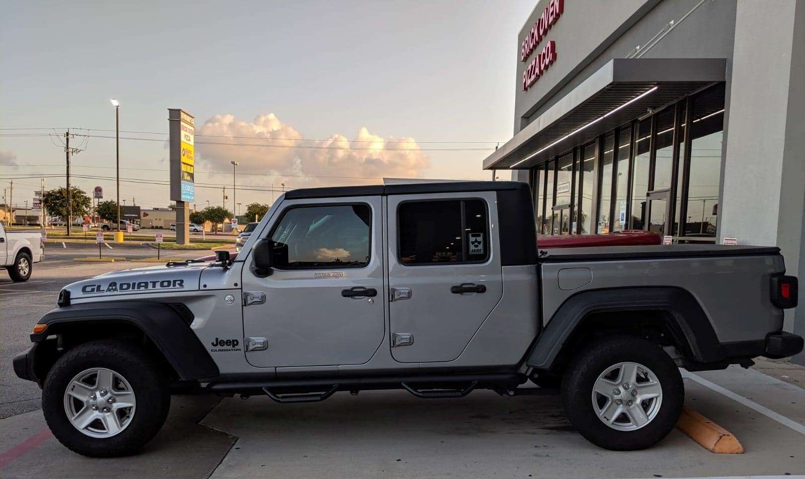

Installed a set of Rough Country Nerf Bars/Steps last night (literally in the night, haha). Bought them direct from Rough Country. They are the most reasonably priced ($349) bars I could find and Delivery was FAST!! They come well packaged. Fit and finish are very good on the set I received. Now, these DO NOT have capped ends, so if that's an issue, then you may want to look elsewhere.
If you go to their website you'll see a line about "Requires Minor Drilling", THEY DO NOT require any drilling. I verified this before buying by having the, send me a copy of the instructions and I chatted with them this morning and mentioned that they might want to correct that line.
All you need are 12mm and 13mm wrenches/sockets. I had these installed in less than 30 minutes in the dark and by myself. I'm very happy with the results.

Look like they come out away from body on the ends. JT has a contour to it that I think early makers are not doing.
