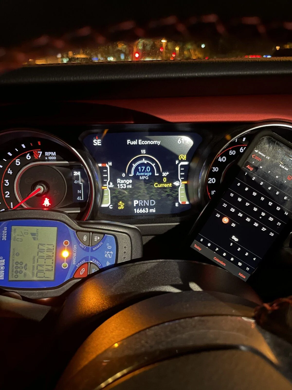

Hi guys, I have been having a bit of a frustrating problem. I have a 2020 gladiator rubicon 3.6 automatic, since I bought the vehicle (new from dealer) at 1200 miles or so I have been noticing a ridiculous vibration when stopped, this seems to be an intermittent issue but 9 times out of 10 I notice it. The vibration only seems to occur when the vehicle is on (obviously) whether it’s in park or drive and stopped at a light I get a pulsing vibration through the steering wheel there is no particular synchrony to the vibration and is always different. My RPM’s do not bounce. It seems to be worse when the AC is on than it is when it’s off. Vibration also occurs when I come to a stop at a light and my auto start stop shuts the vehicle off. As soon as I raise my foot off the break the vehicle starts back up and I get a consistent very rough vibration.
I am not certain if it’s related... however I have had 4.... 4 (P0300) errors on the truck the check engine does not light up however the “A!” Lights up. For those of you that do not know what that error is it’s a multiple cylinder misfire. This seems to be where the frustration comes in I have dropped off the two dealerships who have had the truck for over two weeks each. They seem to not be able to replicate the vibration (typical) they also stated there were no trouble codes saved in the history (no I did not clear them) two different dealers have had my Jeep for over a month now
Does anyone have ANY idea what this could be? Any suggestions? Anything helps and is much appreciated.
The "A!" symbol means the auto start/stop is disable because of a pending code or other disabling condition like the ESS battery low and not necessarily a misfire code. Your P0300 is a pending code and is what is tripping the A! to post. If it was a hard posting code, it would be setting the engine check light.
That is why your dealership is having problems because until it post a hard code and stores the history data, they have very little to go by.
I am having a similar but not exact problem in that I get occasional get the A! light stating the ESS is disabled but will only have a pending P0300 code but never posting. I have used JSCAN and checked the misfire count data and it post mainly to cylinder #4 having double digit misfires as the primary culprit. This only happens on a cold start and never on a hot start or idle .
I have changed spark plugs, swapped fuel injector and coils to different positions and problem for me remains with #4 cylinder misfire only on cold start for like 15 seconds and then is fine. It is also very random and I can go 1-2 weeks before having an event.
