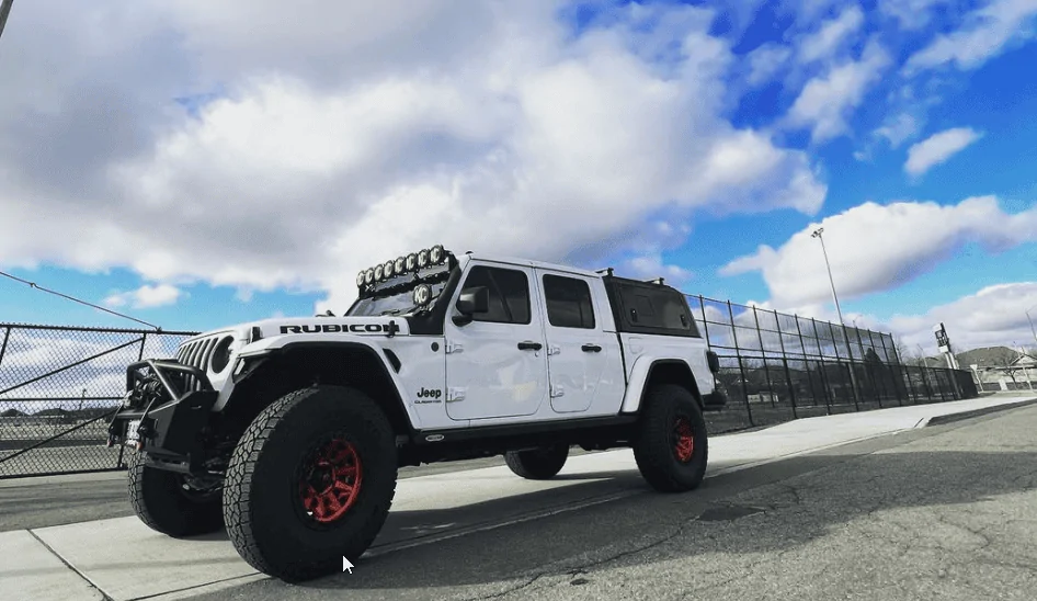

Gen 3 steps + skid plate kit..works great no regrets, buy once cry once as they say! Think they worked out the issues since Gen 1 steps came out, just make sure you lube them every so often.
