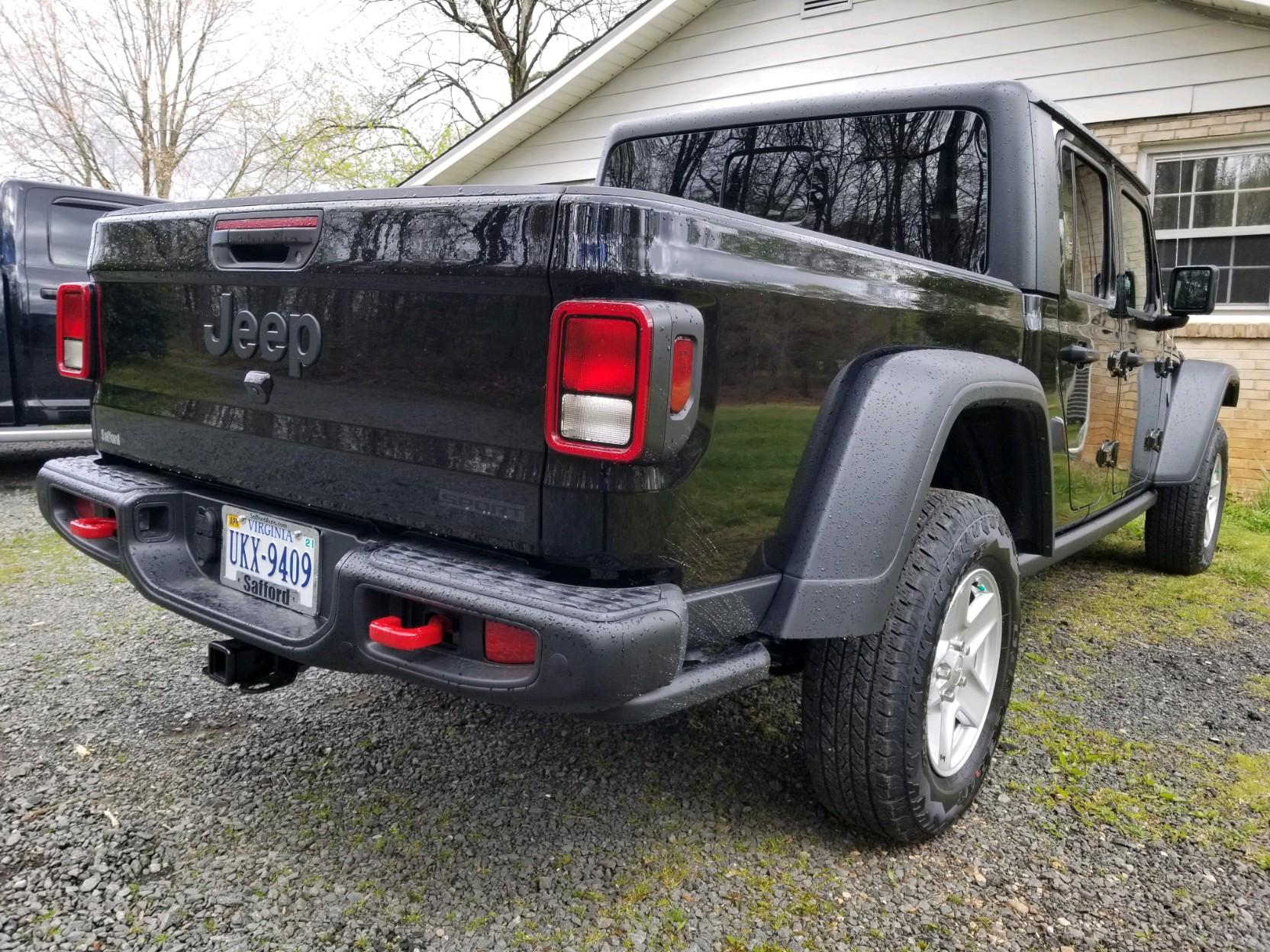

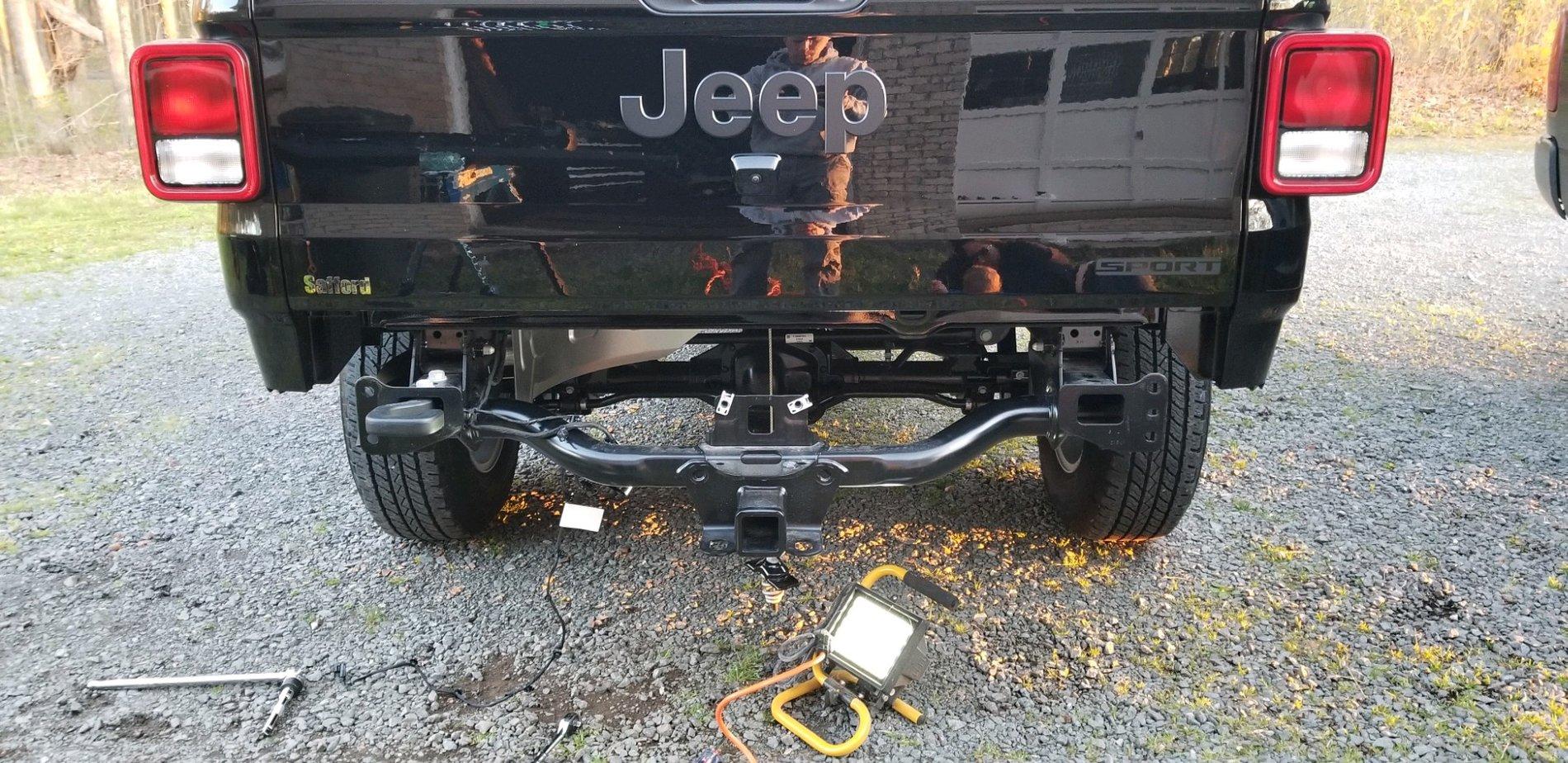

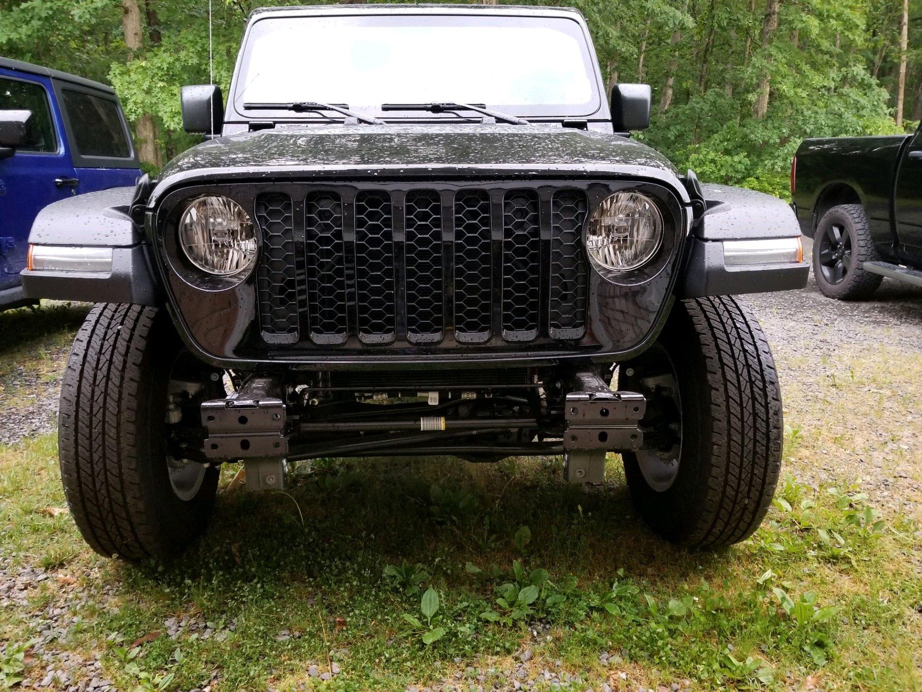

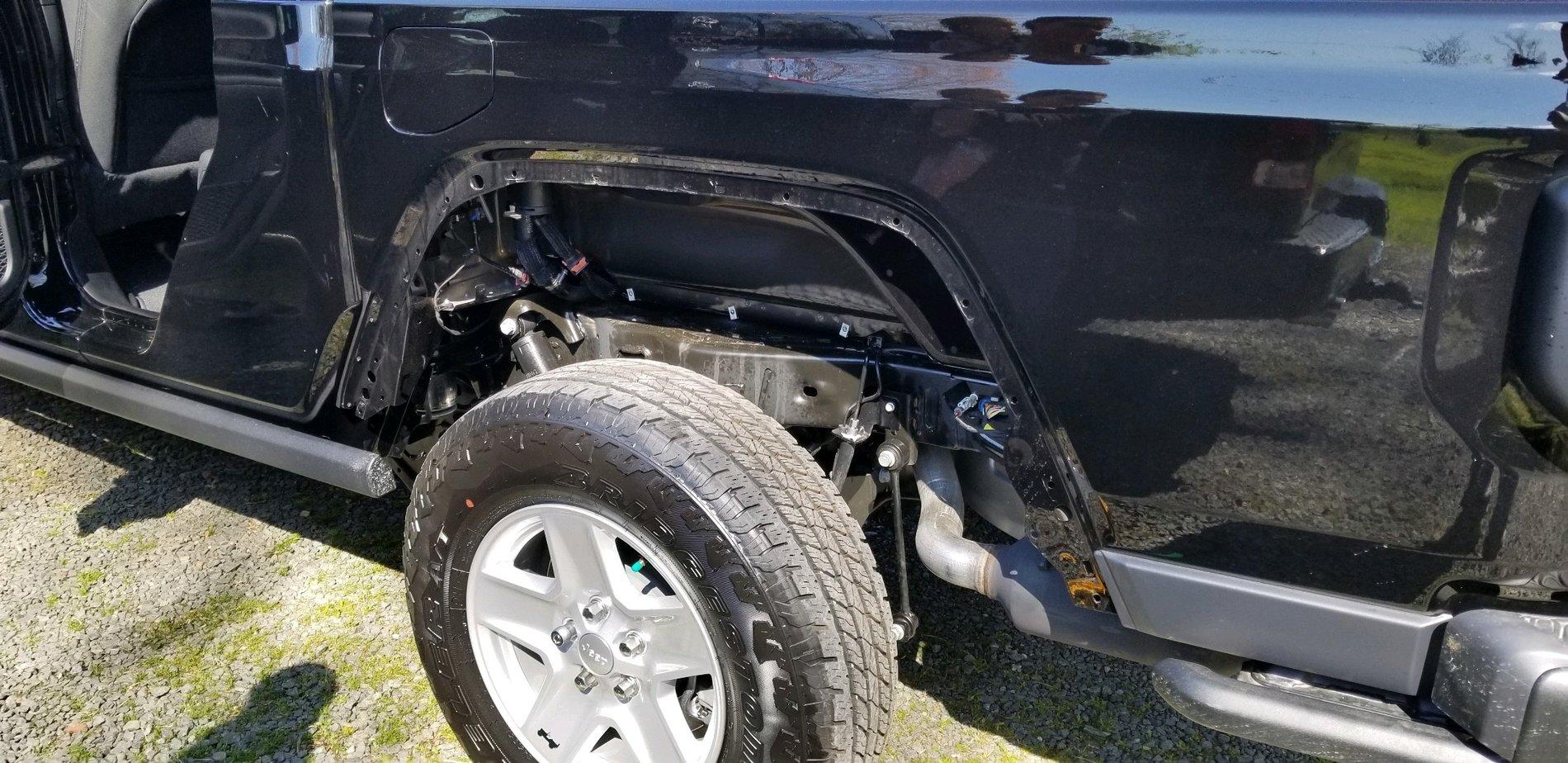

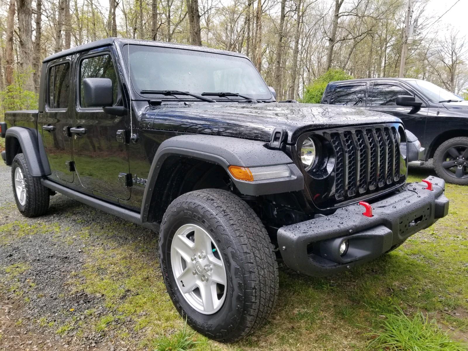

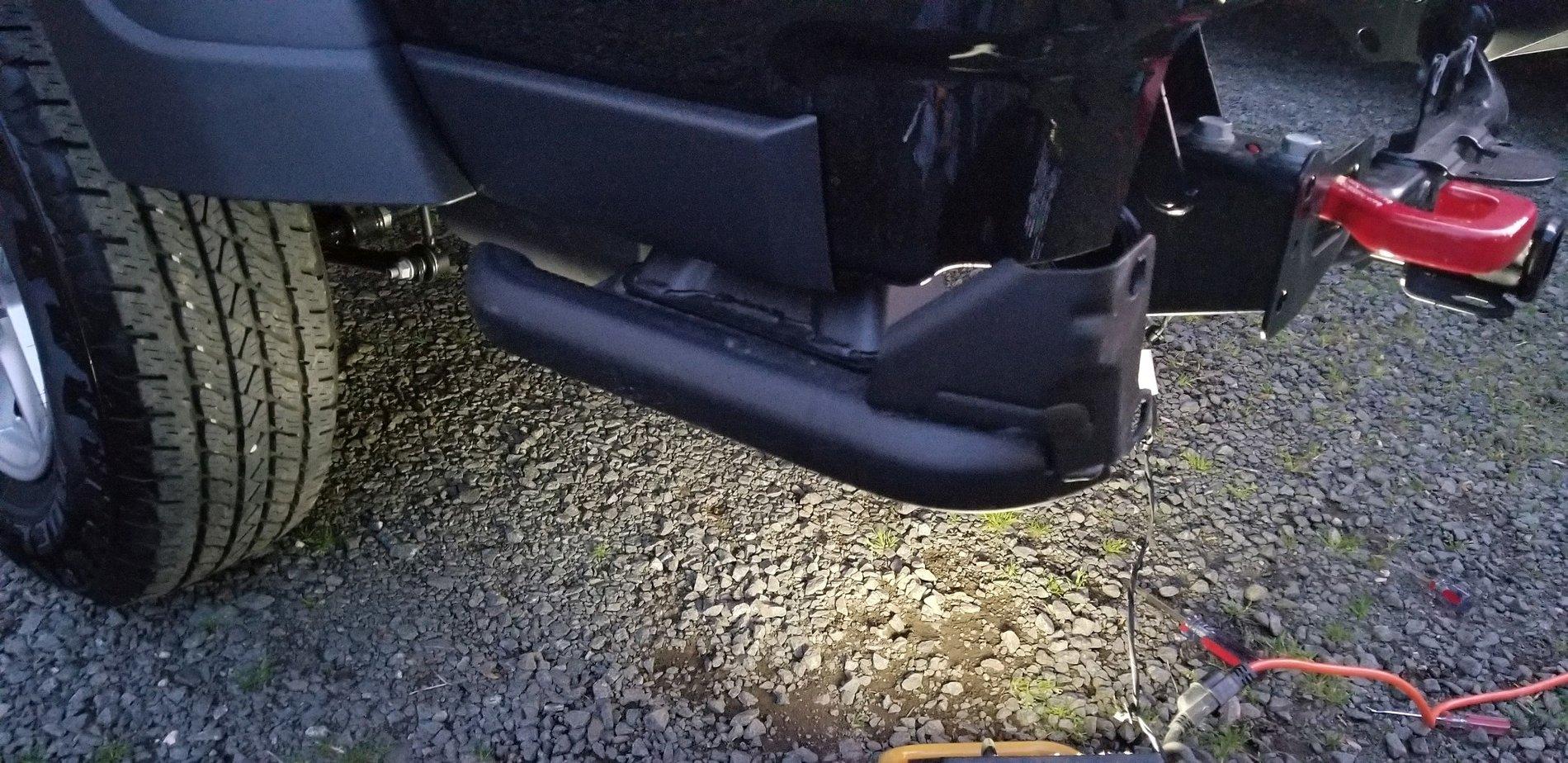

Rubicon rear bumper, rock rails cab and bed, fenders, winch bumper.

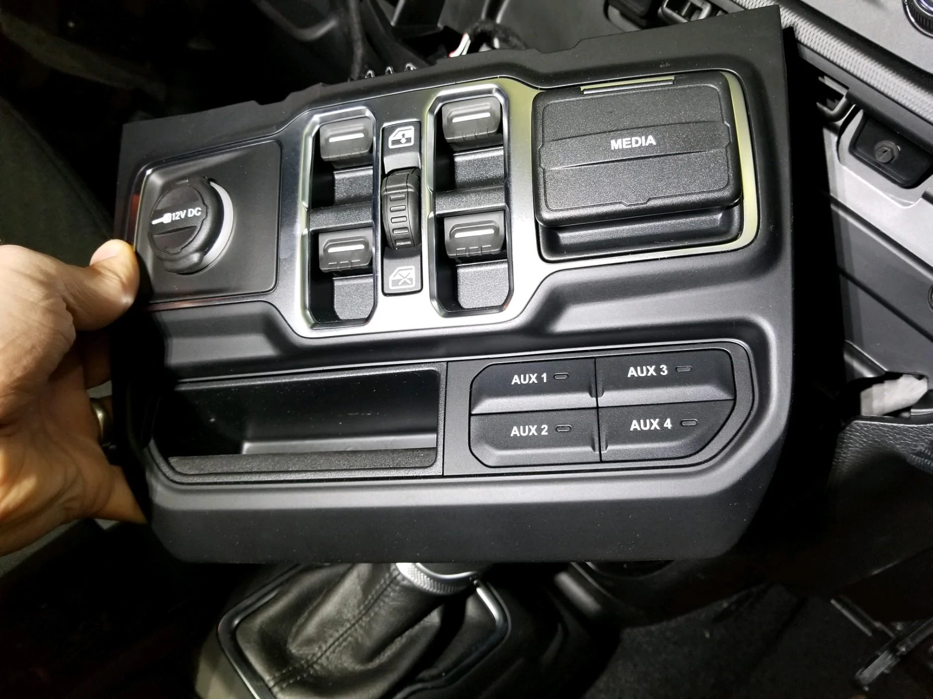

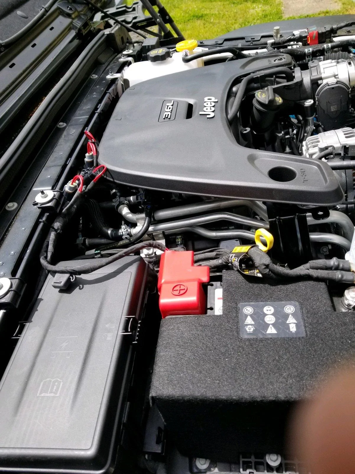

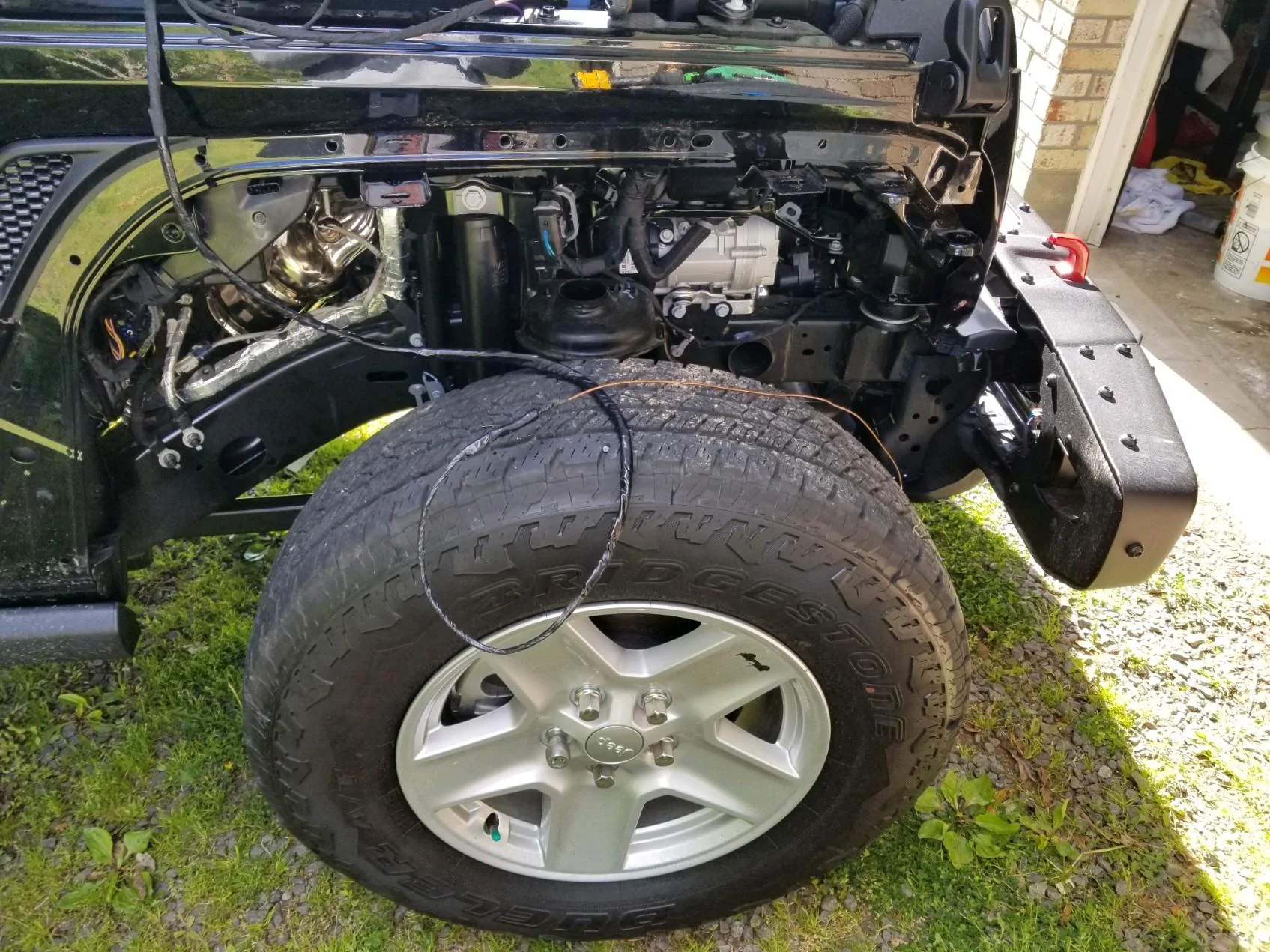

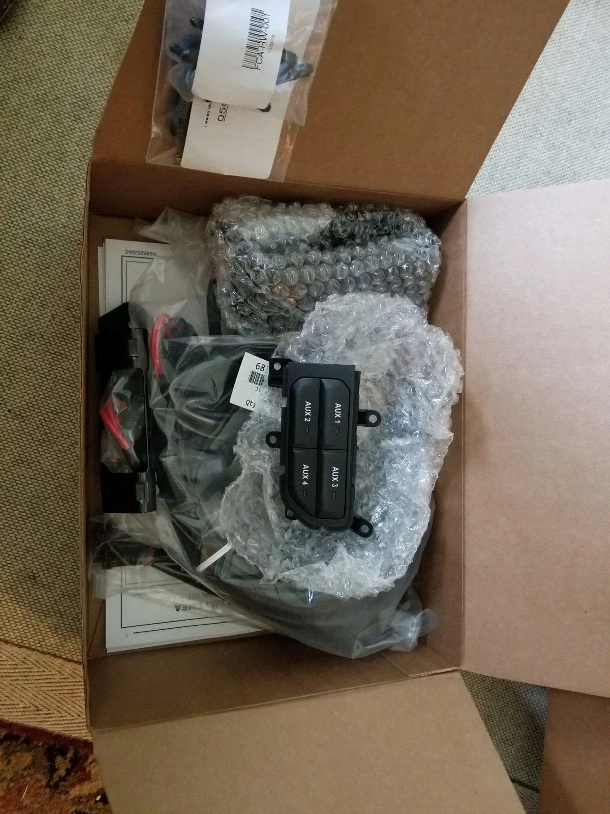

Installed the aux bank. Not a bad job but it is time consuming. Mopar's wiring directions were also wrong.

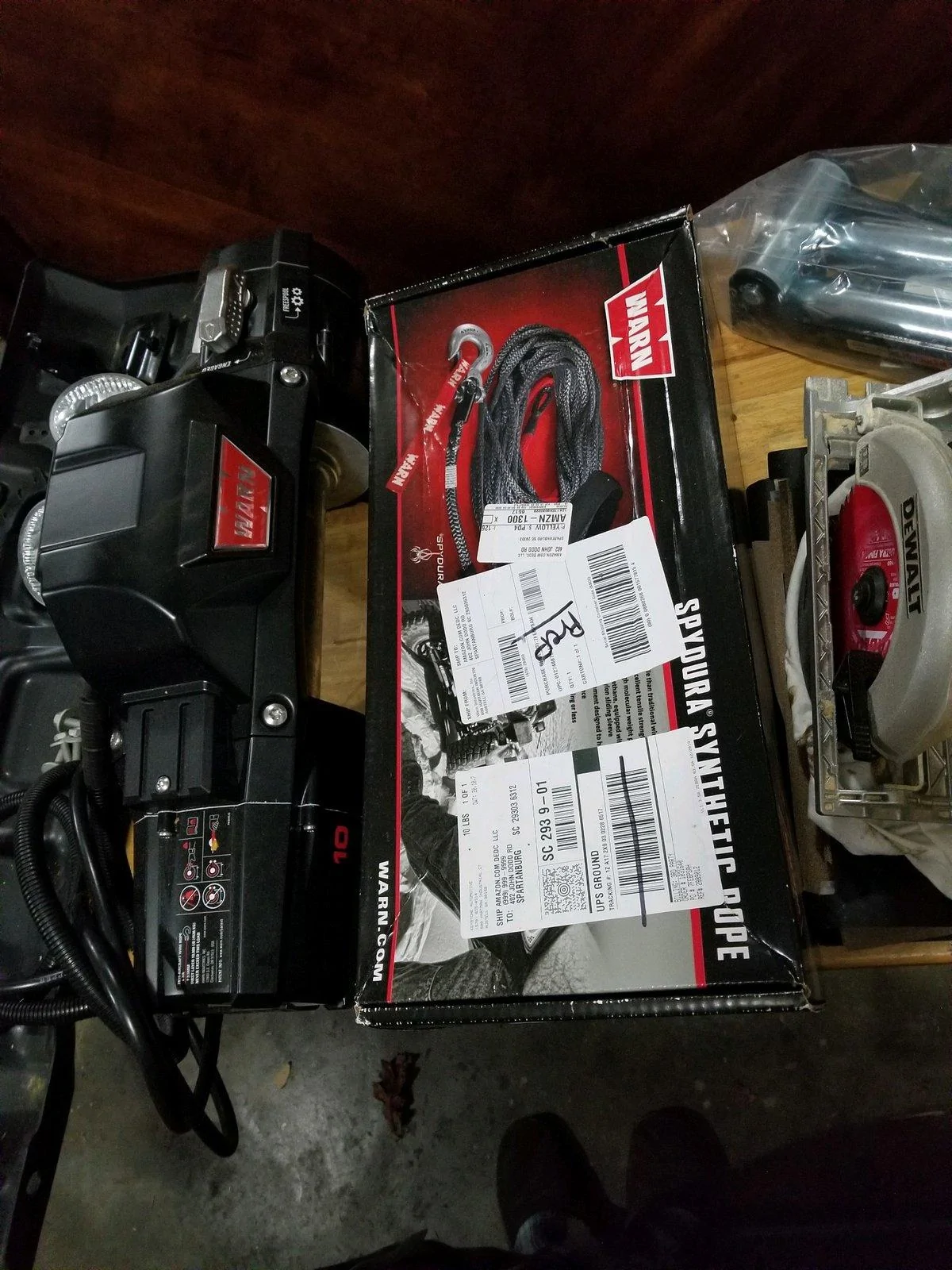

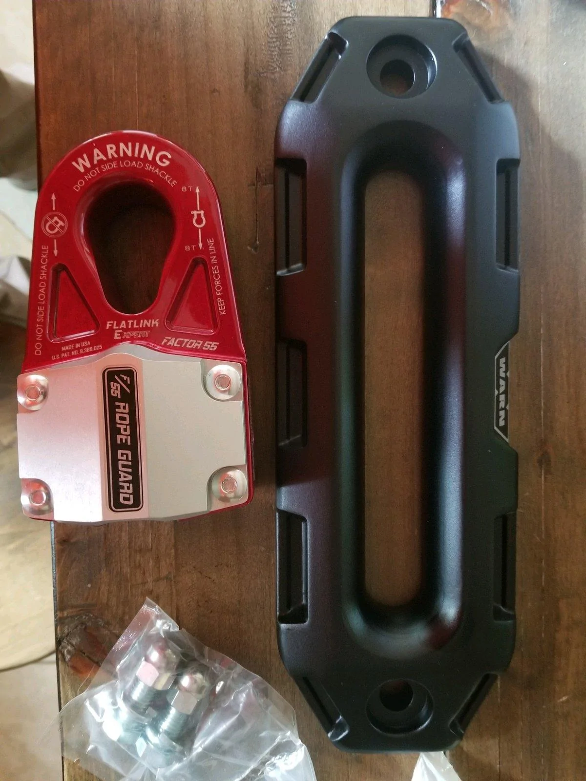

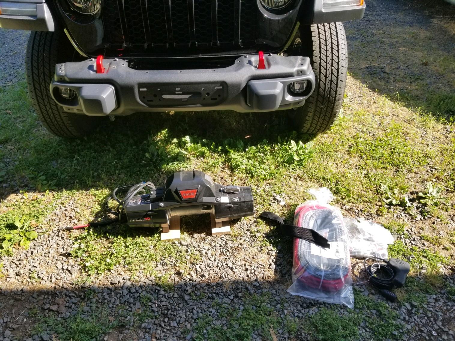

Picked up NIB Warn 10 off marketplace so the cost difference of swapping in the rope covered my fairlead and flatlink. Working on the install today. There is no room and everything is a PITA. If I would've known It would be like this, I might've picked a different combo. Winch plate is Mopar.

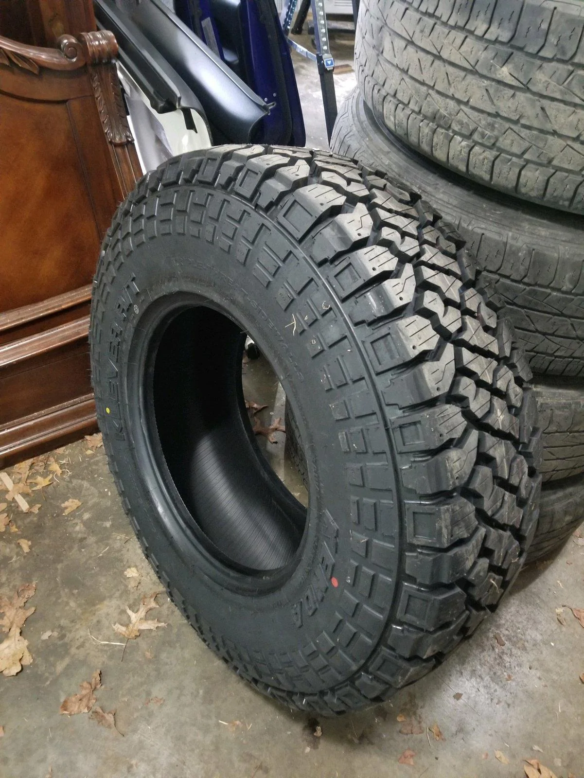

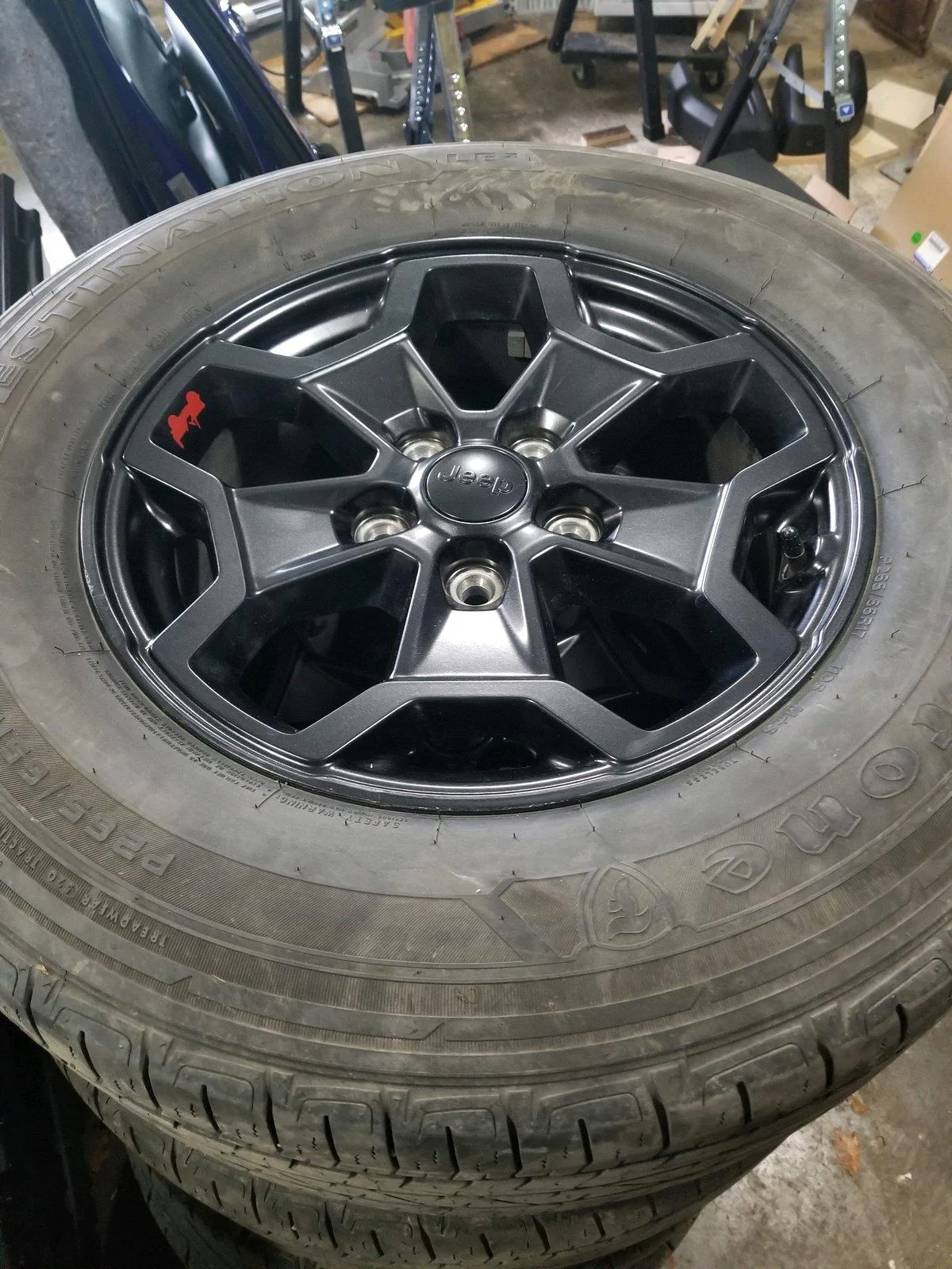

LE wheels. Tires are 35x10.5R17 Kenda Klevers. I wanted a taller, skinnier and saw some guys on here preaching about them and I was sold. I just about got someones patigonias off the delivery truck too. Good thing I caught the guy. Someone around here would've been sad.
Any tips for removing the fenders? Run into any problems?
Do it as few times as possible haha. The backs can be taken off pretty easily. Pry as many of the white keepers starting at the back as possible, especially down low. Give them a quick jerk straight out and they pop right off. If you're gonna do it, order some keepers first. You'll break a few. The fronts are more stubborn. You can't really pry them out (from the back). Get the ones you can reach. Work the front and the back of the fender and go with the side that lets go. Don't get frustrated and beat the shat out of it. You'll break the back lower fender webbing......I did. Just glued it and it's fine. I did find it a lot easier to remove the fender/liner to do the aux bank and it eliminates a couple steps.

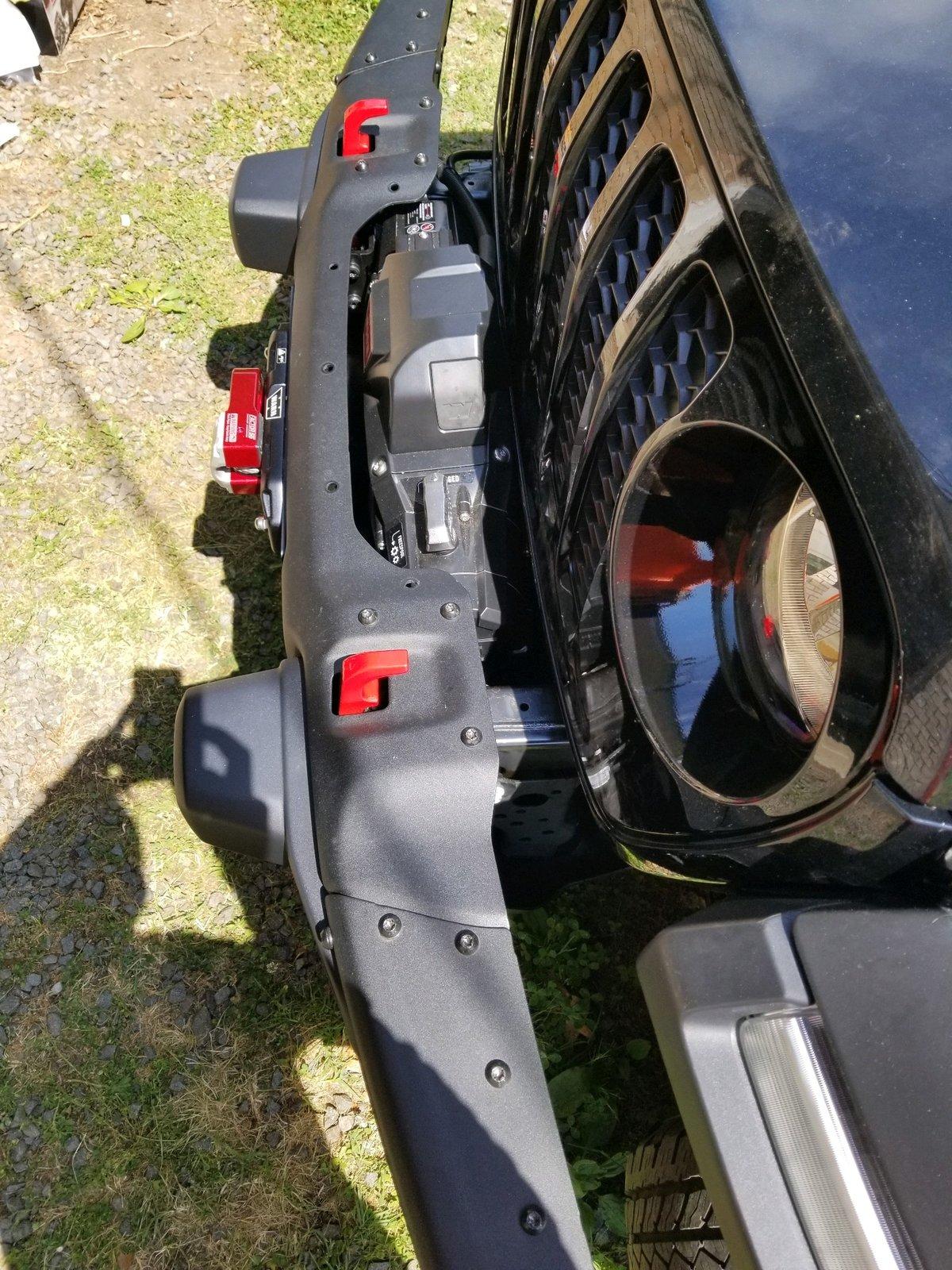

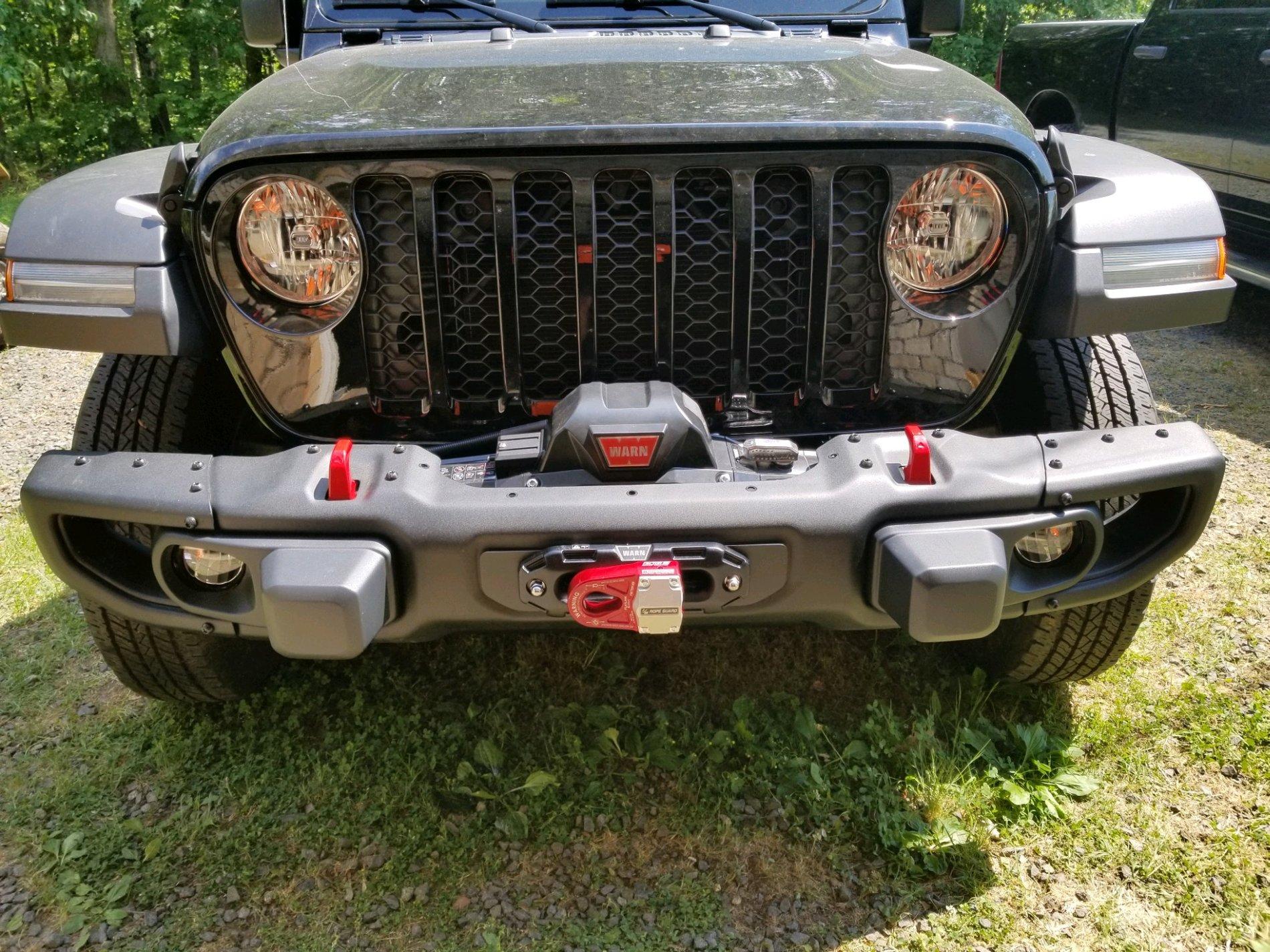

Finished the install today. Now to sift through the messy garage and find the bolts for the top of the bumper. Still need to decide on a license plate holder. This is my first winch install and there's a lot I'm learning along the way. It isn't wireless (that's what I'd like though) and I haven't wired it to the cabin. I've seen a few of these setups on the forum and it looks a lot better with a bar over the top so I suppose I'll have to figure out what height I want.
