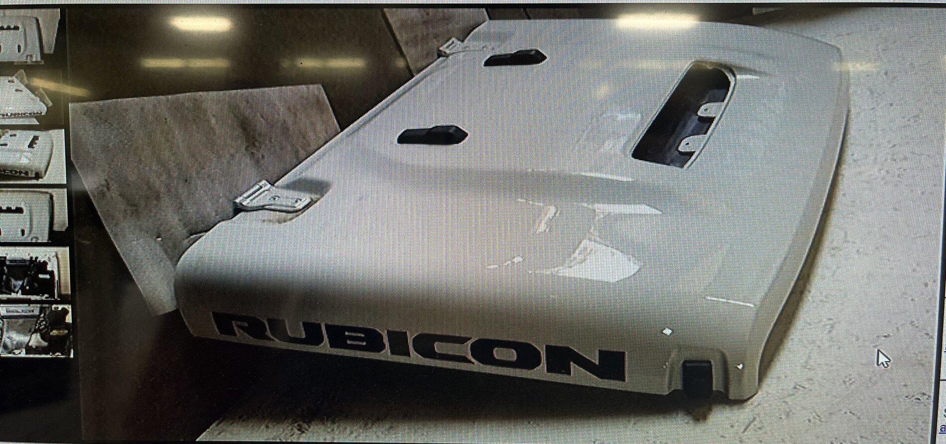

Rubicon 392 hood going on my JT DZL

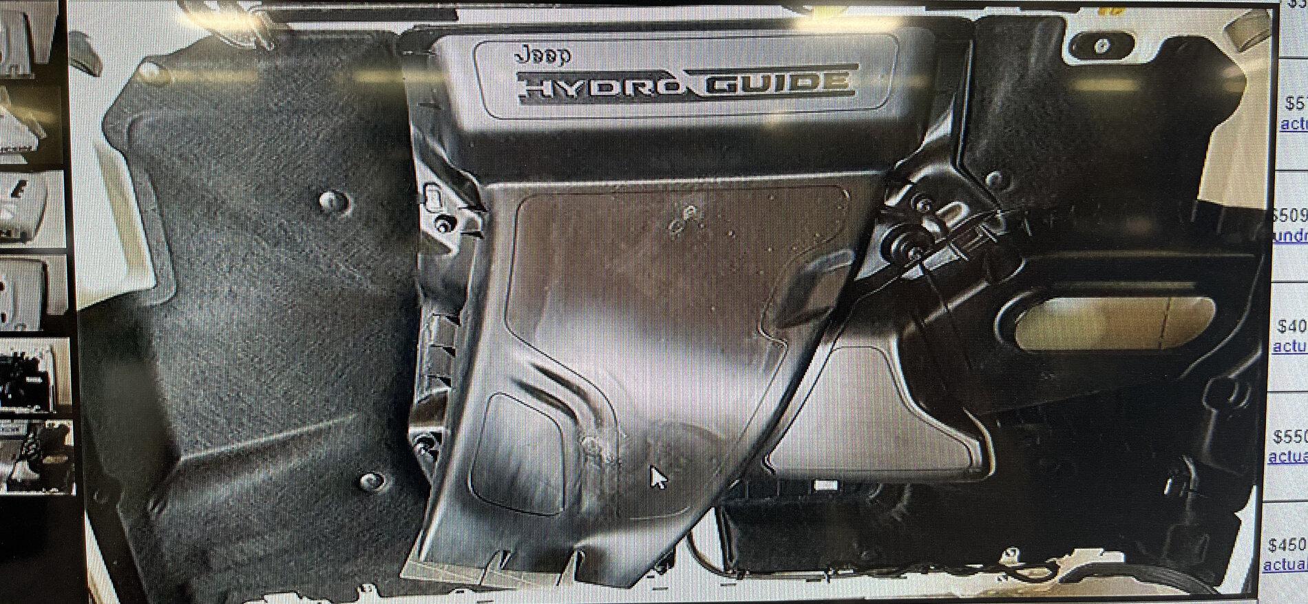

They look the same. Hard to tell with the underside blocked. I wonder if you can get just the hydroguide
You can yes but cost is $600++ and it dumps on the driver side so the functional intake would be useless on a gas engine JT
Are you going to try and make it functional for your EcoDiesel?
The air intake on the 3.6 is on the passenger side. Wouldn't you want water dumped on the driver side, away from the air intake, batteries, and fuse box?
My gladiator is a diesel so my intake is on the driver side

I spent time at my dealer looking over a 392 Wrangler to see what is involved in putting the HydroGuide on my hood, I feel I could fairly easily make it cold air function on a 3.6, the actual throttle body is very close to same location, although I just want a functional hood scoop, to get some air through engine compartment and out. Only thing I could not confirm it the mounting studs or nuts are the same for both hoods, guess check of part number should show that. That is awesome you got the hood!....Jack
All of the intake parts alone run $600-700 ?

Yes, I heard that, I already have the Mopar CAI and like it, I might just look over the parts list and get a couple of the pieces I need to get air into engine compartment or I’ll go with modifying the removable rear of Mojave scoop grill, and fabricate a thin stainless plenum to divert the air. Dealer said the hood was crazy heavy with Hydroguide, but I pointed out it is a steel hood did not feel that much heavier.

It's a interesting project, take plenty of photos, I plan to open up my Rubicon hood vents help give the hot engine bay air another path to escape.
