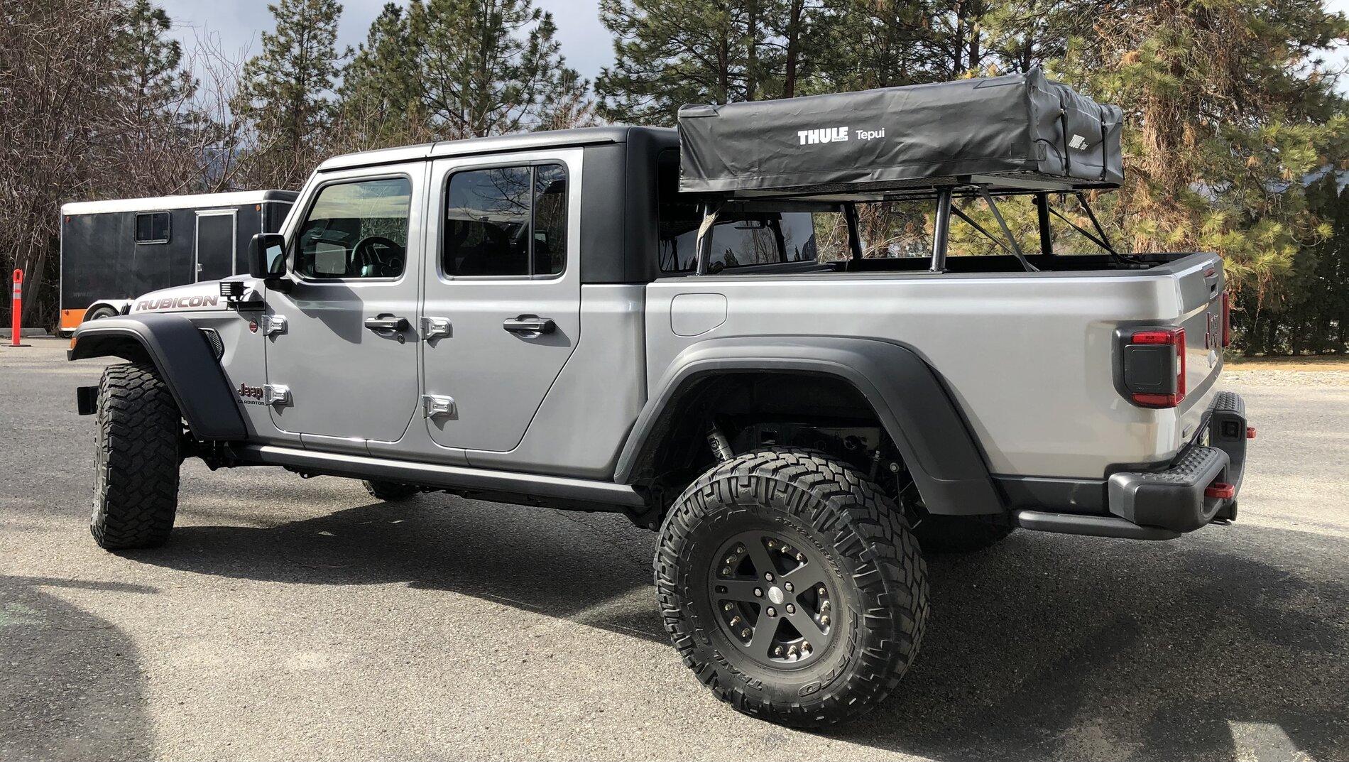

Diesel on 37s , i had an 09 rubi with 513s with these wheels and tires. This would eat it.
Jeep Gladiator Rubicon Diesel with 37s C6DFBD38-4550-442C-8A33-FE6BAB9A4A05
Stock drivetrain , i plan on doing all the same things i did before.

I would go same places. Do same things . Problem with the gladiators is how much the rear sticks out. Hitch touches on even the easiest of trails. Climb any gravel pile at natural angle of repose and youll see .
the diesel has torque at such low rpm its gonna make crawling the best thing ever.
going to a higher ratio is also a weaker gear smaller , smaller pinion less bite on the crown . I will try stock wholeheartedly before i let anyone put a wrench on my factory sealed diffs. I will report my findings mid july. Hehe .

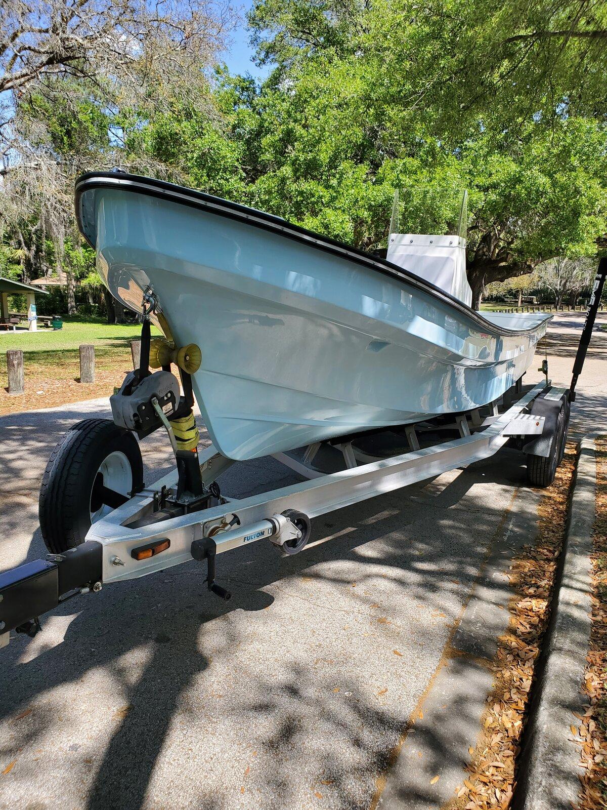

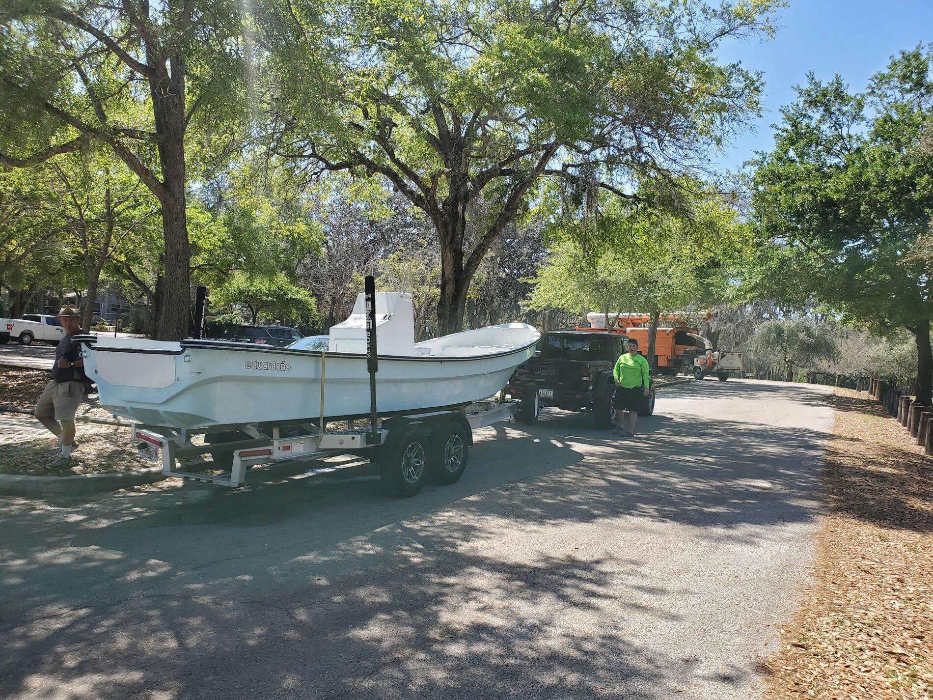

I've clocked a little over 9k miles on 37's and stock gears. The last 3k was a road trip from iowa to Florida for spring break, 2k with a 25' panga center console in tow.
Boat and trailer around 5k lbs with a big bow sticking up in the wind. It ran low to mid 70's in 7th gear most of the time (about 2000 rpms). Running into a head wind made a noticable difference and caused an occasional downshift to 6th. Fuel mileage sucked (right around 12 mpg) DEF fluid usage was more than I anticipated (about 3 gallons/1k miles). Not what I was hoping but definitely not a total disappointment either. After pulling with many gasser jeeps over the years I can tell you none of them could touch what this one did especially on 37's and stock gears.
As I dont pull a lot I still don't see a real NEED to regear. Daily driving is perfect with the 3.73's IMO. I personally think aerodynamics and wind resistance is the biggest thing holding back highway speed performance and fuel mileage.....well that and all the emissions bullshit. If they would let these things breath and exhale they would be so much more efficient.
That said, If I was pulling anything bigger/heavier with more wind resistance, and/or running at high altitude, on a regular basis I would regear probably only to 4.10's though. I think 4.56's would be over kill and require way too many rpms to run at highway speeds.
The mini van motor gets that with 37's not towing and most full size trucks would get similar or worse when towing that boat. So it really only sucks cause your accustomed to getting such good fuel mileage unloaded, but in the grand scheme of things its not bad at all imo.
