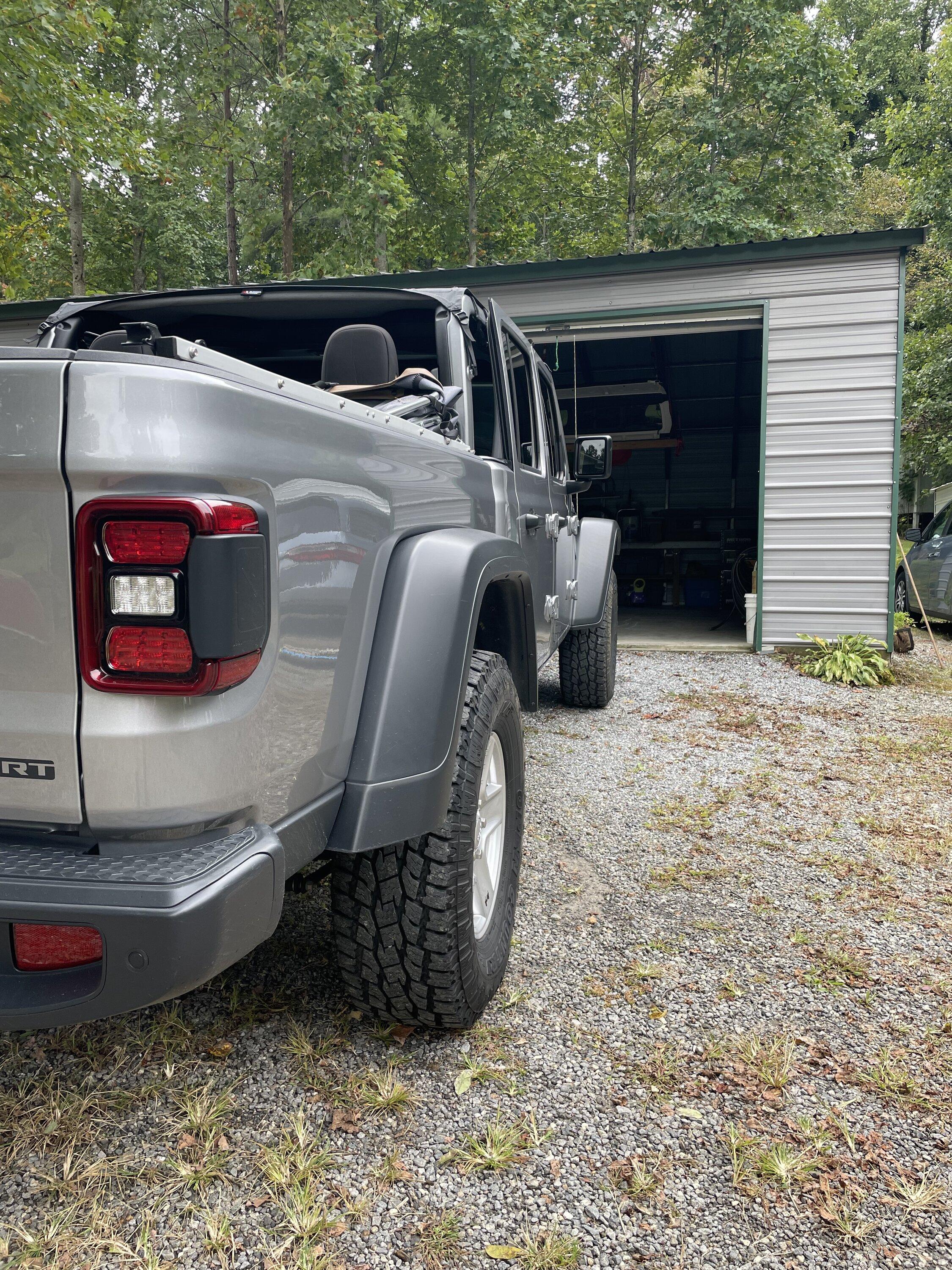

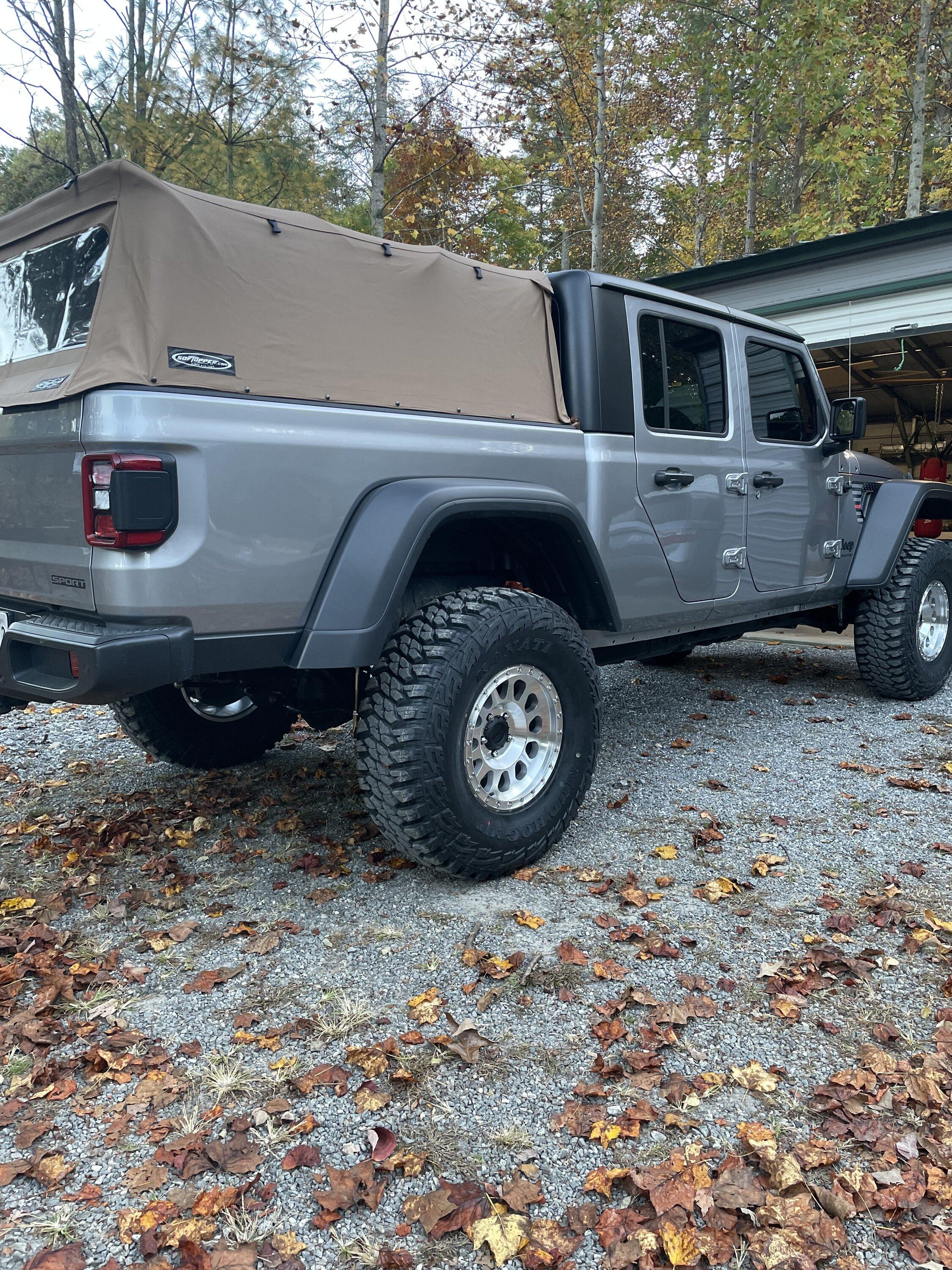

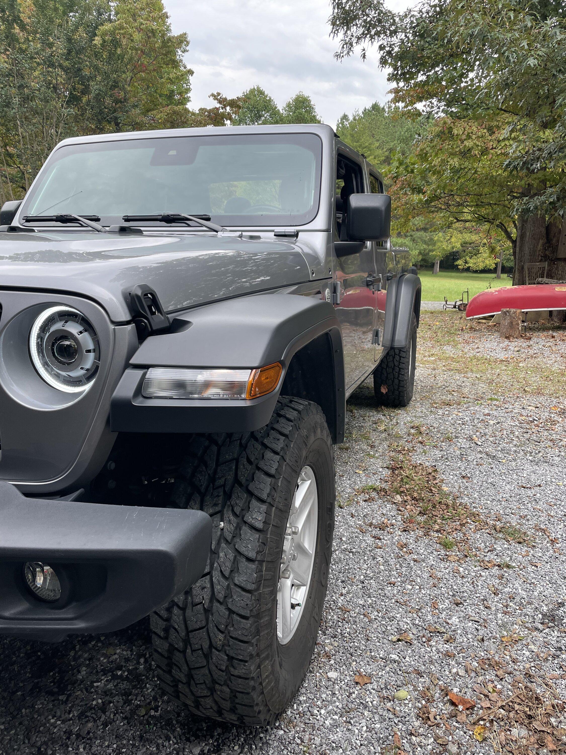

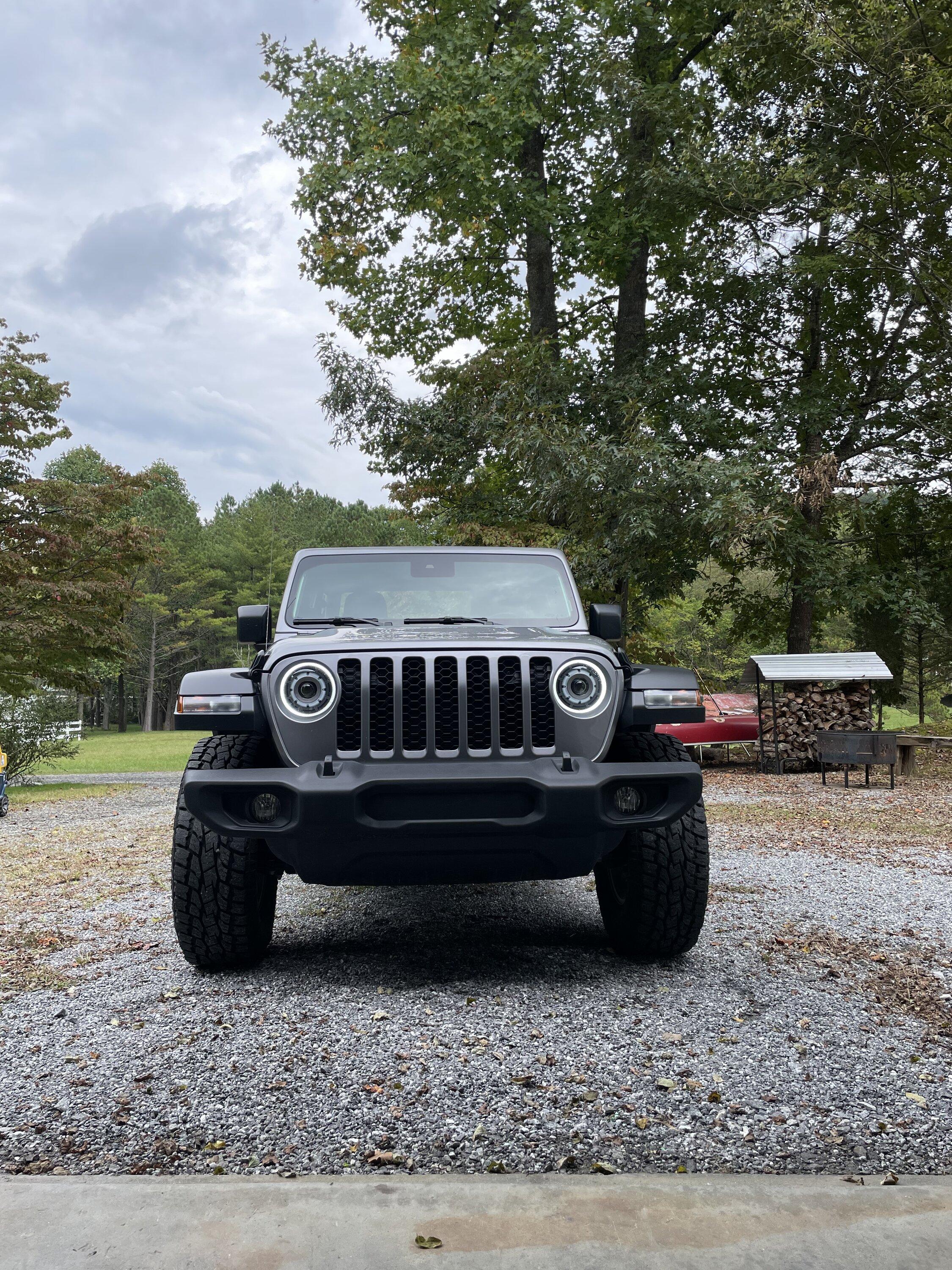

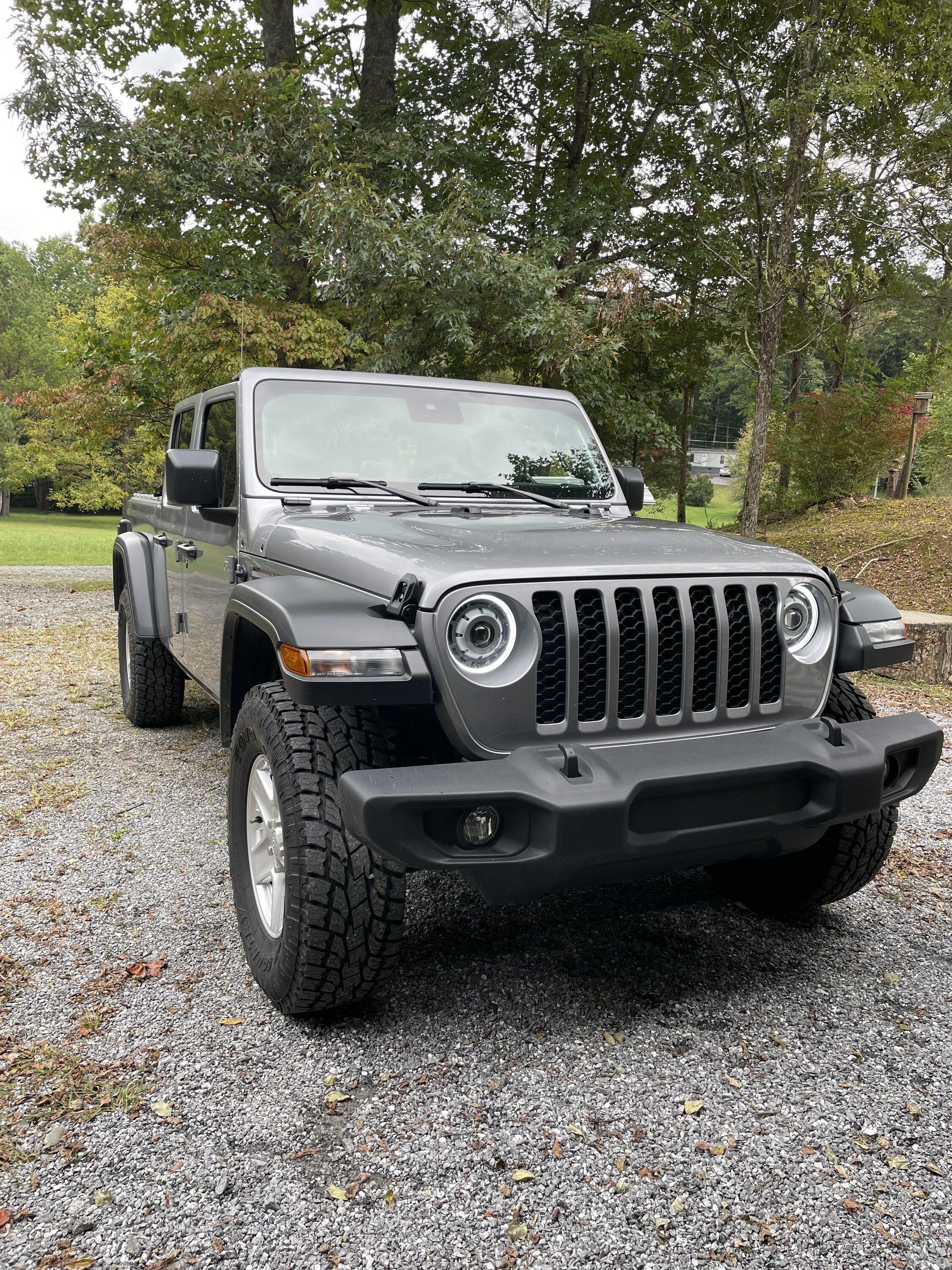

Mind sharing some pics?
Jeep Gladiator Rubicon fenders on sport s non max tow E9D18E05-B4CB-44CC-A321-BBDAE6F061FF
Jeep Gladiator Rubicon fenders on sport s non max tow A28768A0-8323-49F0-9E85-A3EA1AE8662A
Jeep Gladiator Rubicon fenders on sport s non max tow FB7B170F-8607-4785-8555-250F2FAEEC27
Jeep Gladiator Rubicon fenders on sport s non max tow 0F961916-7D91-4523-88DD-33AF2C2027E8
This is a sport non max tow with rubicon fenders and stock wheels with 285/75/17 open country’s.
new wheels are sitting in the garage with lift. Just waiting on tires.
