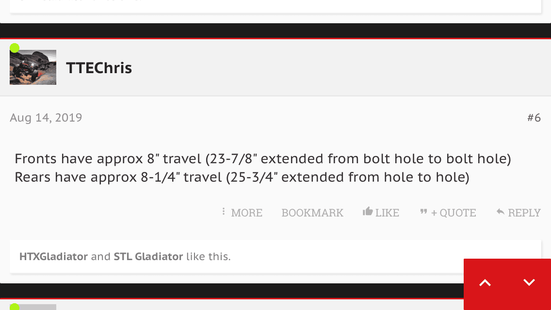

Per TTEChris a couple of months ago...

I thought the Rubicon suspension had 10” travel? The shocks would bottom out at only 8” travel?
My other question was could I use a 2” longer shock without lifting.

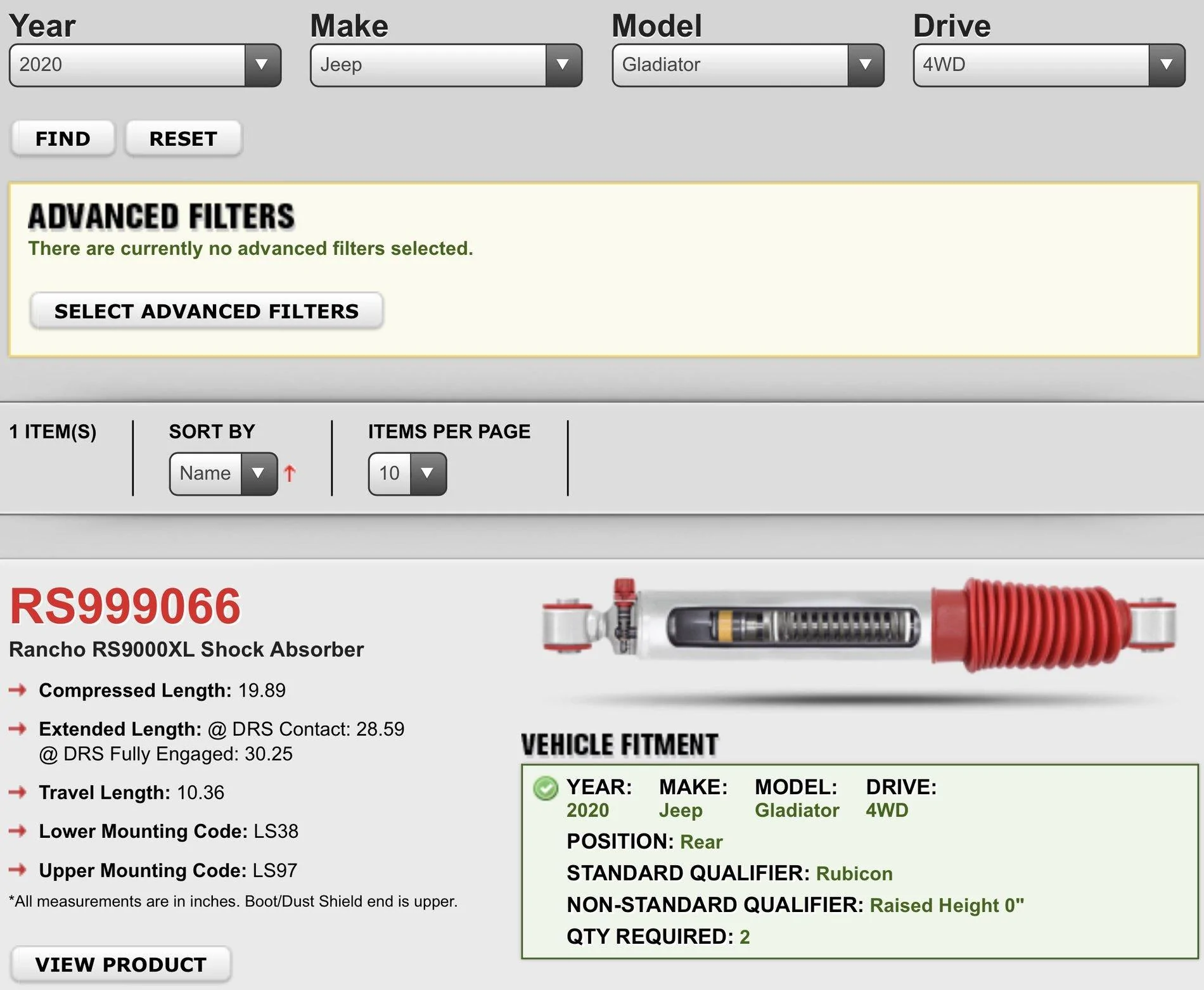

This screenshot might explain why I’m not certain on what length shocks to buy.
Rancho specs their rear shock at:
19.89 Compressed
30.25 Extended (DRS Engaged
10.36 Travel
I’m assuming their front replacements would be similar.

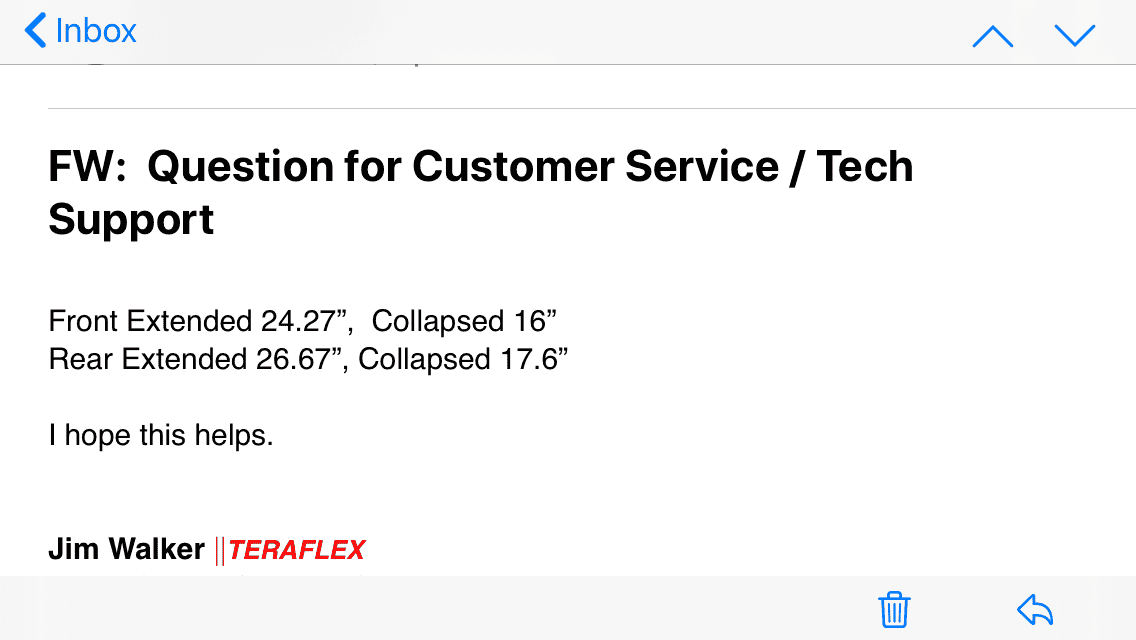

That appears (to me) to be appropriate for a 3” lift. Those might limit your up travel, but I can’t say for certain. Here are Teraflex specs on their 2-3.5” lift shocks:

The Rancho website is wrong or very misleading at saying “Raised Height “0””
I’ve emailed their “Gurus” and have gotten 3 different answers.

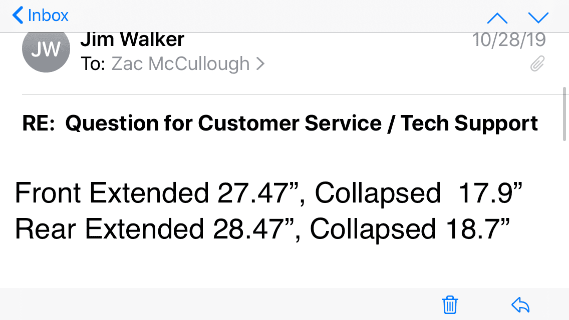

Here- I found a previous email from Teraflex with their 0-1.5” lift shock lengths. These should work for you.

I purchased a set of Rancho’s for the rear based on their catalog on their website (RS999066) but they are wrong in all specs and NOT at all for the Gladiator. I’ve let them know about the error but they still list them.
