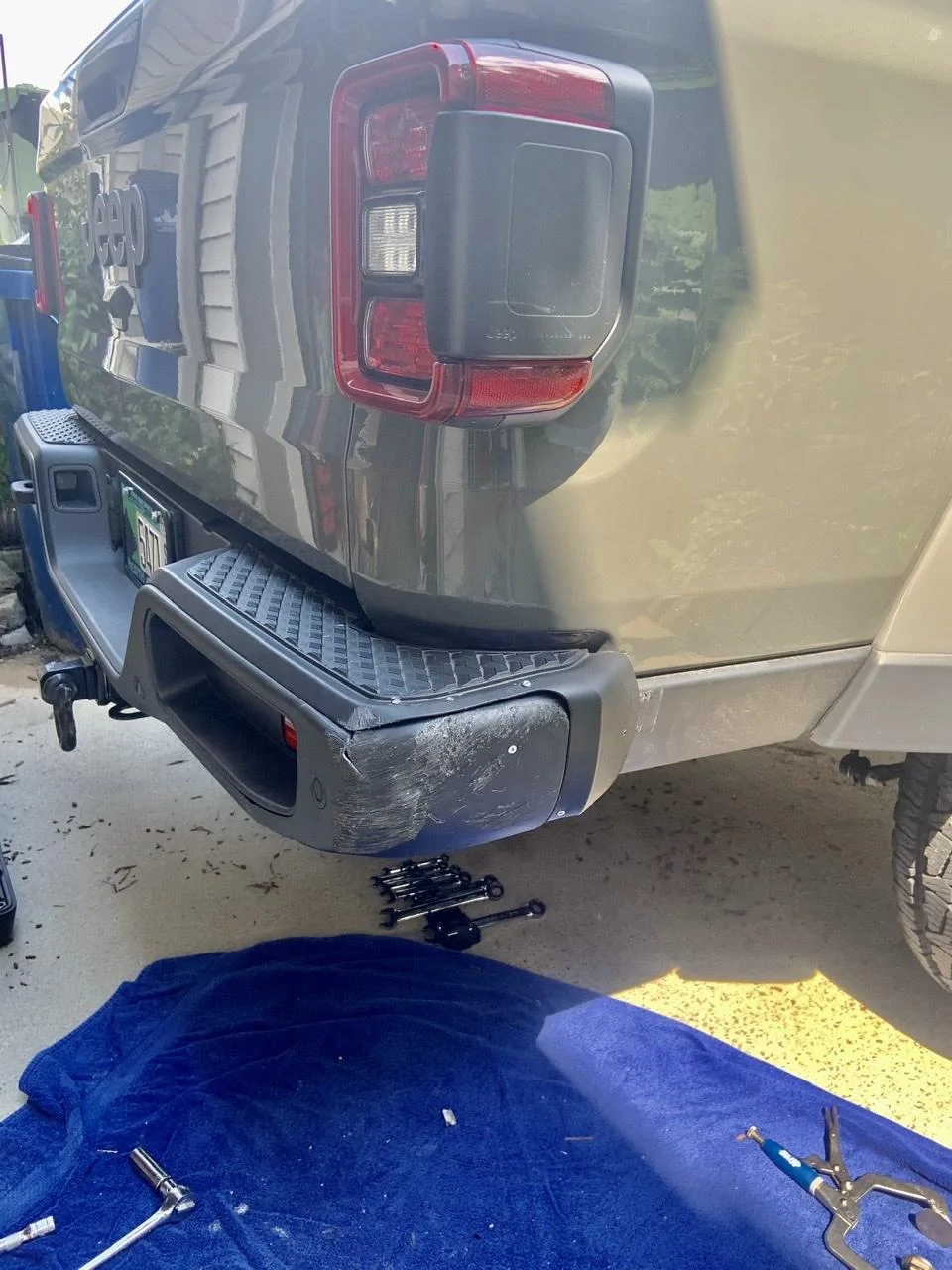

I remember discussion on this as I don’t have the Rubicon bed side guards, but I can’t find it anywhere by searching. Or do I have it backwards and there was discussion on adding the Rubicon side protection to a non Rubicon?

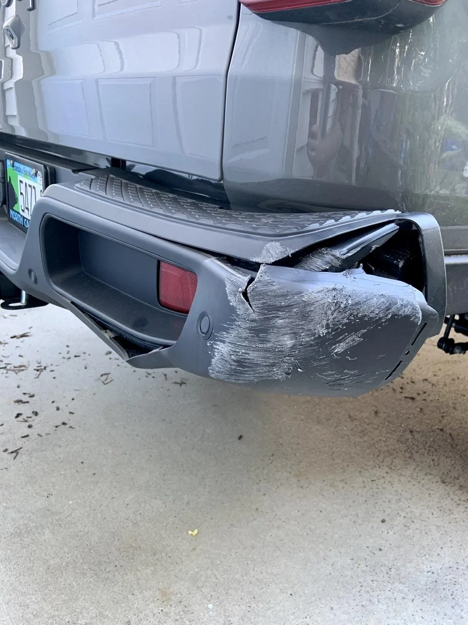

Does it bolt right on in place of my Overland bumper? I know they have the tow hooks and I can and will address that. Anything else need to be done? I’m double checking before I order a Rubicon steel rear bumper. There was an incident...
I patched it up a bit before I can install the new bumper. It should be steel anyway, it’s the first truck I’ve even owned without a steel rear bumper.

It is direct bolt on. There really isn’t anything you need to modify.

Good to know. Thank you for the response. Hopefully, it doesn’t look off without the Rubicon rear bumper skid/slider deal. I saw that the bumper has a cut out for it. I guess I’ll be getting that eventually.
