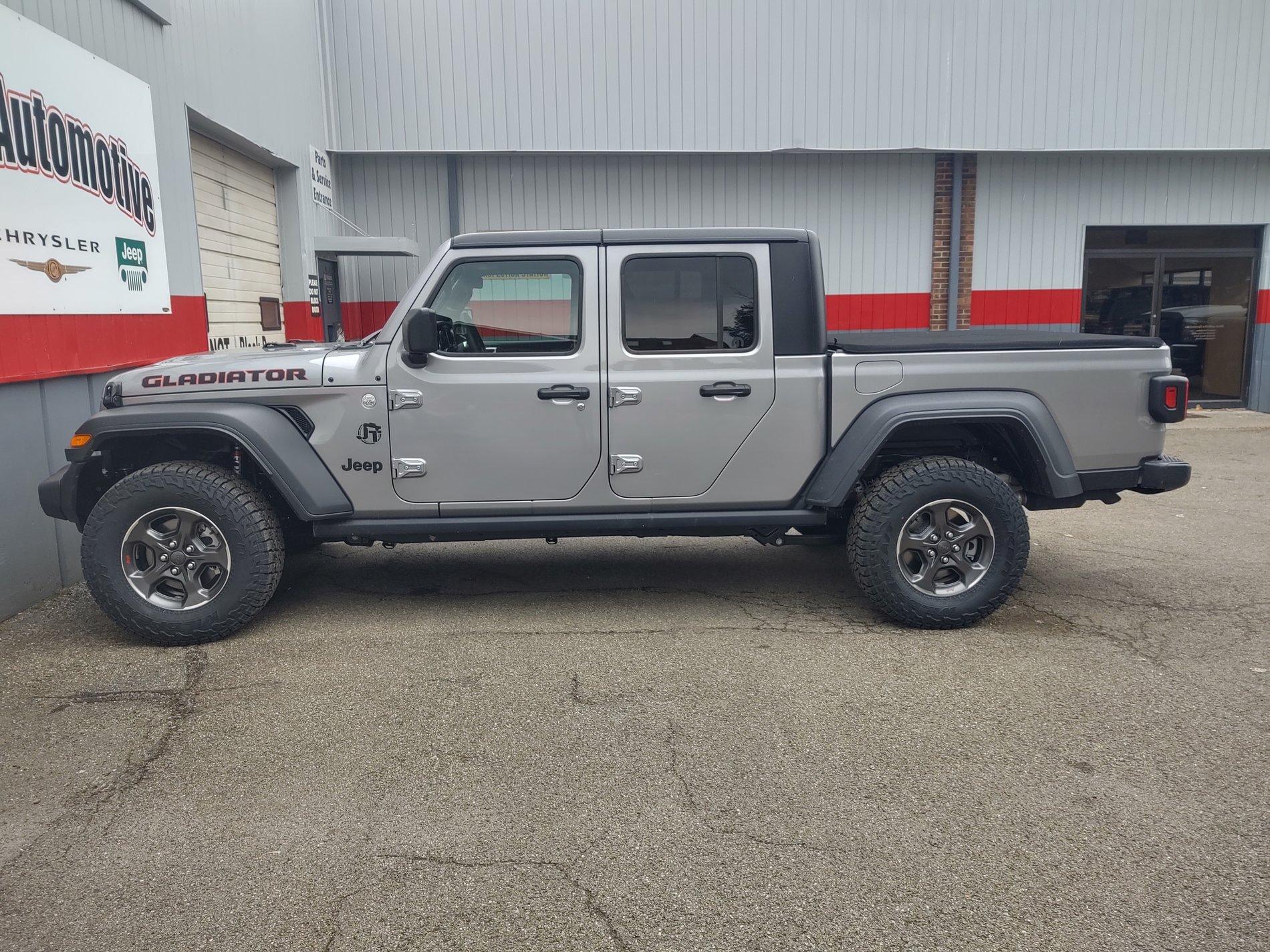

Ditto same here my sport s sits exactly at the same height as a gladiator now

Yep the Rubi sits a little taller the springs are a touch longer so it leveled it out pretty good, that and the wheels and tires make it look just right for my taste
