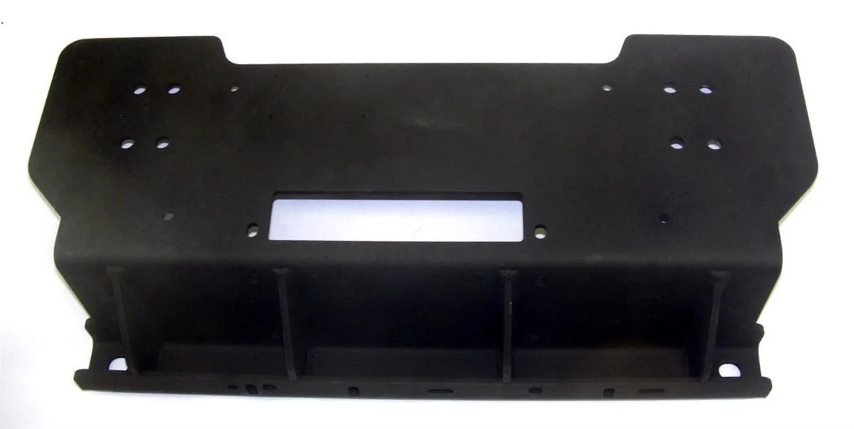

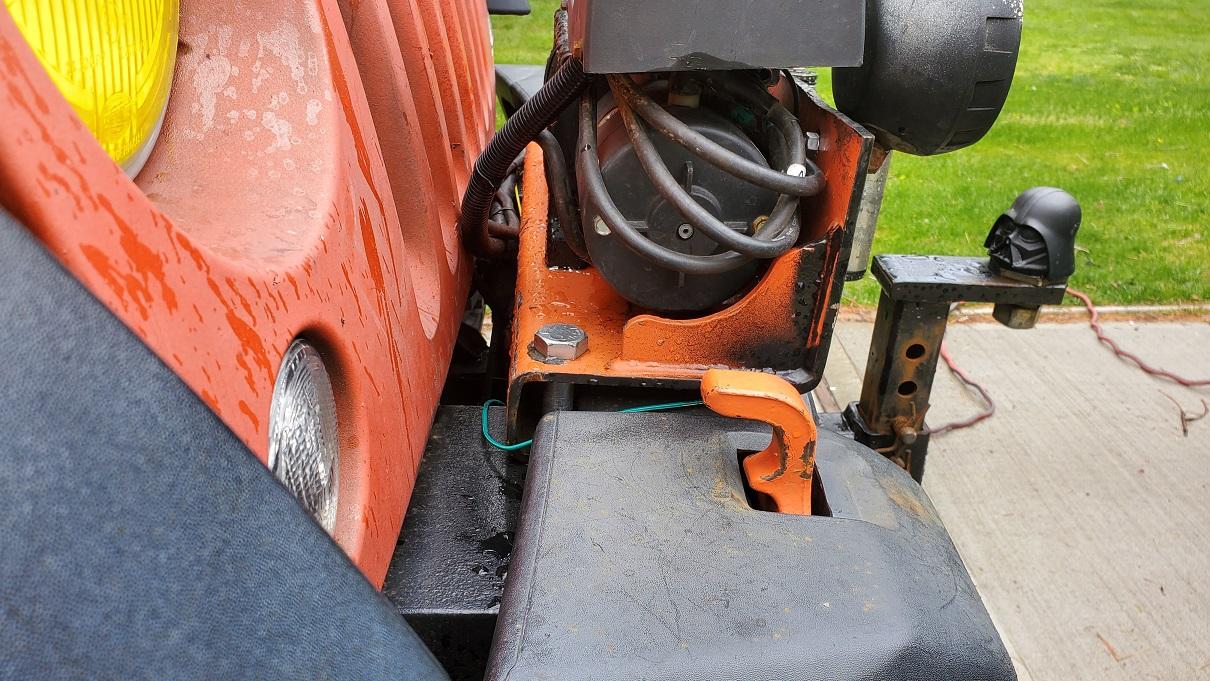

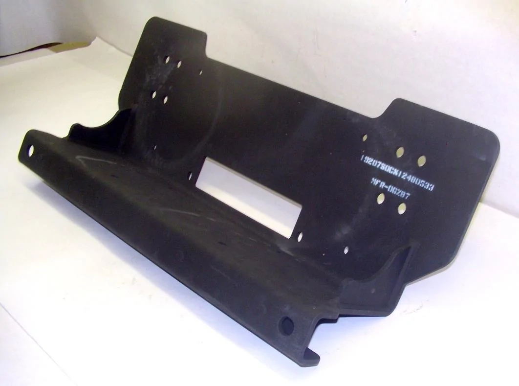

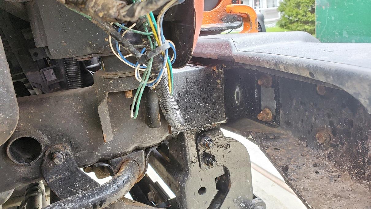

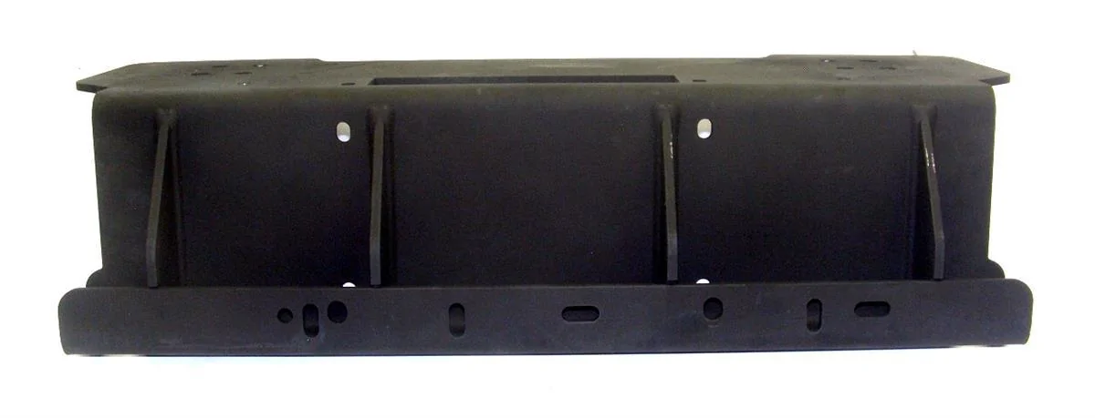

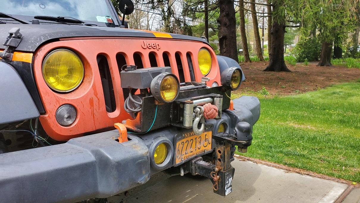

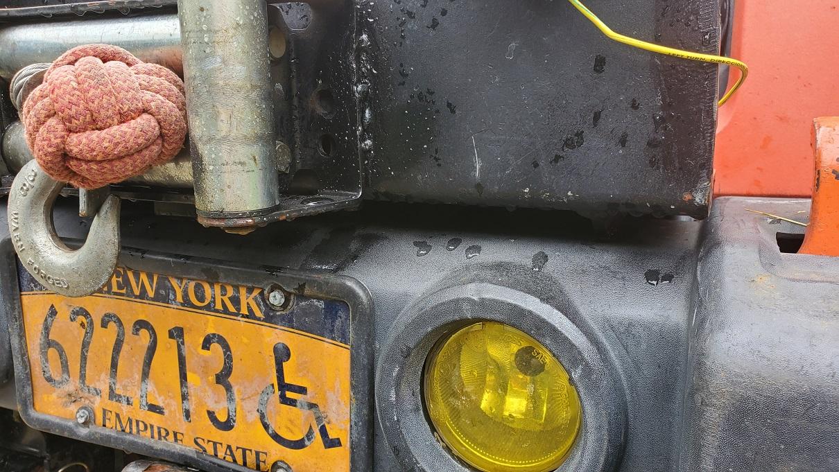

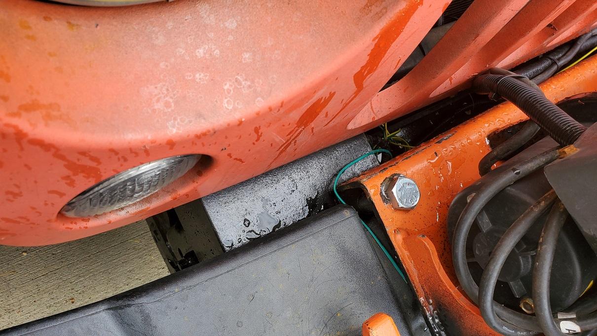

Now this is where I need to be a little careful. My winch came with a mount but totally the wrong mount, for an H1. I'm not a fan of giving up full use of my front hooks so I made a winch mount from two sections of angle steel. It's brutalist design for sure but the beauty is my winch plate unbolts with two 1" bolts from the top, nuts welded to the two angles. Lets me service things when I need the clearance and the design just clears the plastic bumper.

I have a front hitch and a winch basket and while it's great for the occasional tug job :devil: it's not sturdy enough for serious winching and it does nothing to help approach angle which is why I decided to go to a hard mount.
And in case anyone is wondering why a warn electric is hiding where a mile marker hydraulic should be, the MM HI10500 project has been stalled for a while waiting for a pump or more specifically the spare funds for the pump. Now we are just waiting on parts to arrive.
