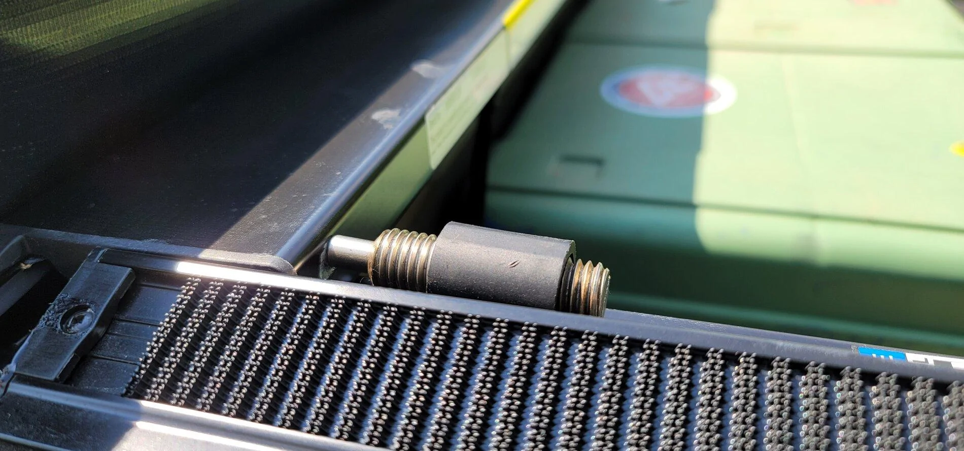

This is where I have mine set and it seems to be working for me. Now do you guys get water in tbe bed?
Jeep Gladiator Rugged Ridge soft rolling tonneau constantly unlatches at highway speeds 20210730_110235
Actually I don't get water in the bed when the cover is on... and working! :) My tension adjusters are much "looser" and it's still tight.

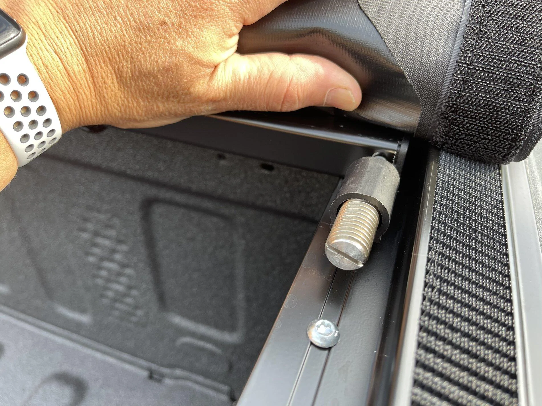

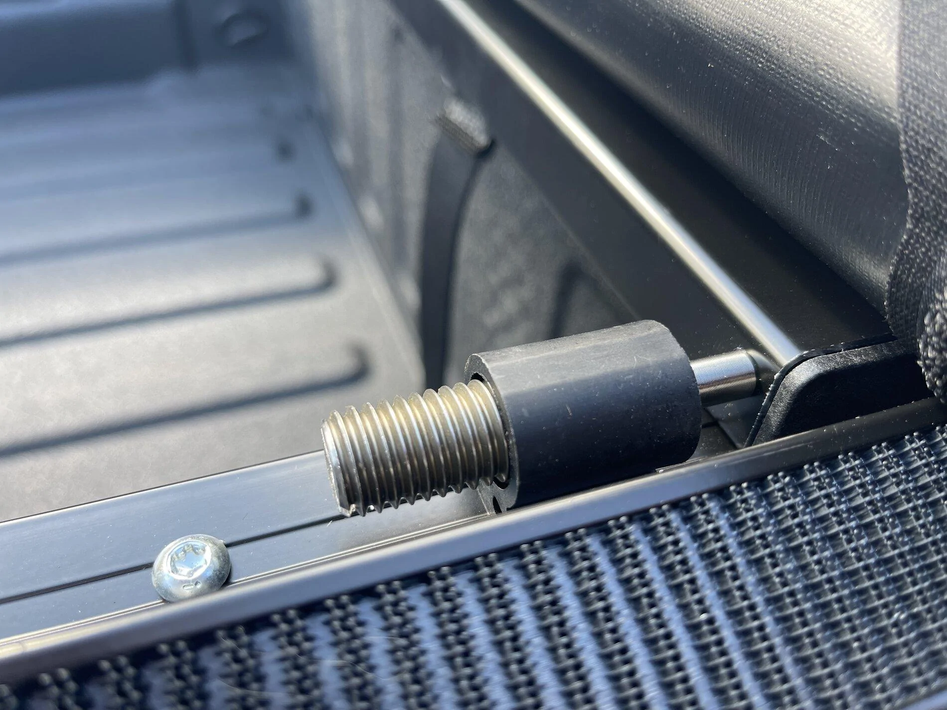

Also, the space between the bulkhead bar the holds cover and the rails is far less than mine. Following the instructions, it states to push the rails down and outward. Doing ensures the the rails are resting on the bed rails. Interesting. You can see the gap in the pictures I posted here. Thanks for posting this. You're bringing some things to light.
