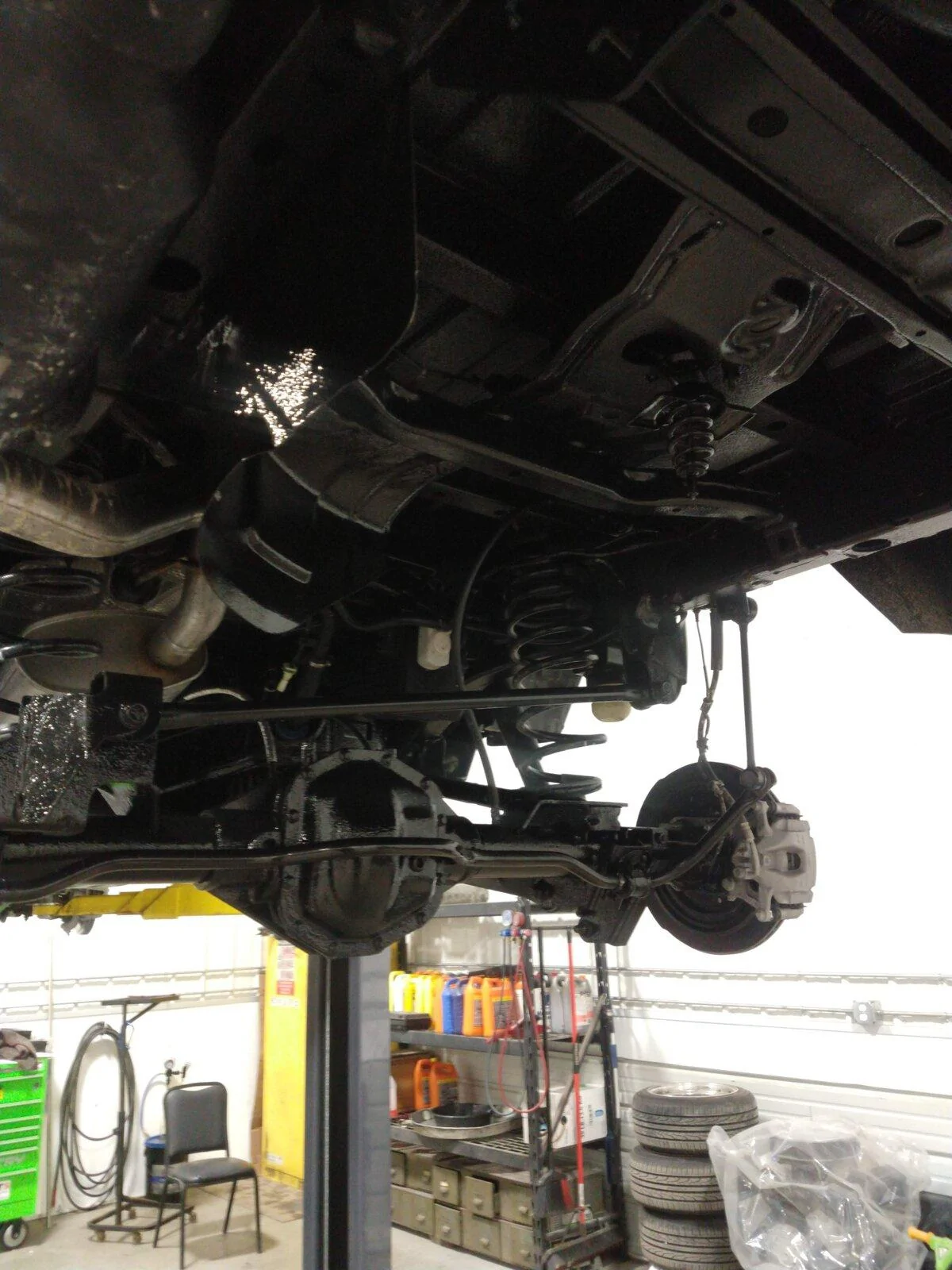

wool wax is good too. just do it up yourself if you can. I use a compressor and shutz gun to do do my stuff.
Sprayed my gladiator with this stuff as soon as I got it home and it seems to be holding up well. I purchased the wool wax spray gun to do my yearly touchups in the wheel wells.
