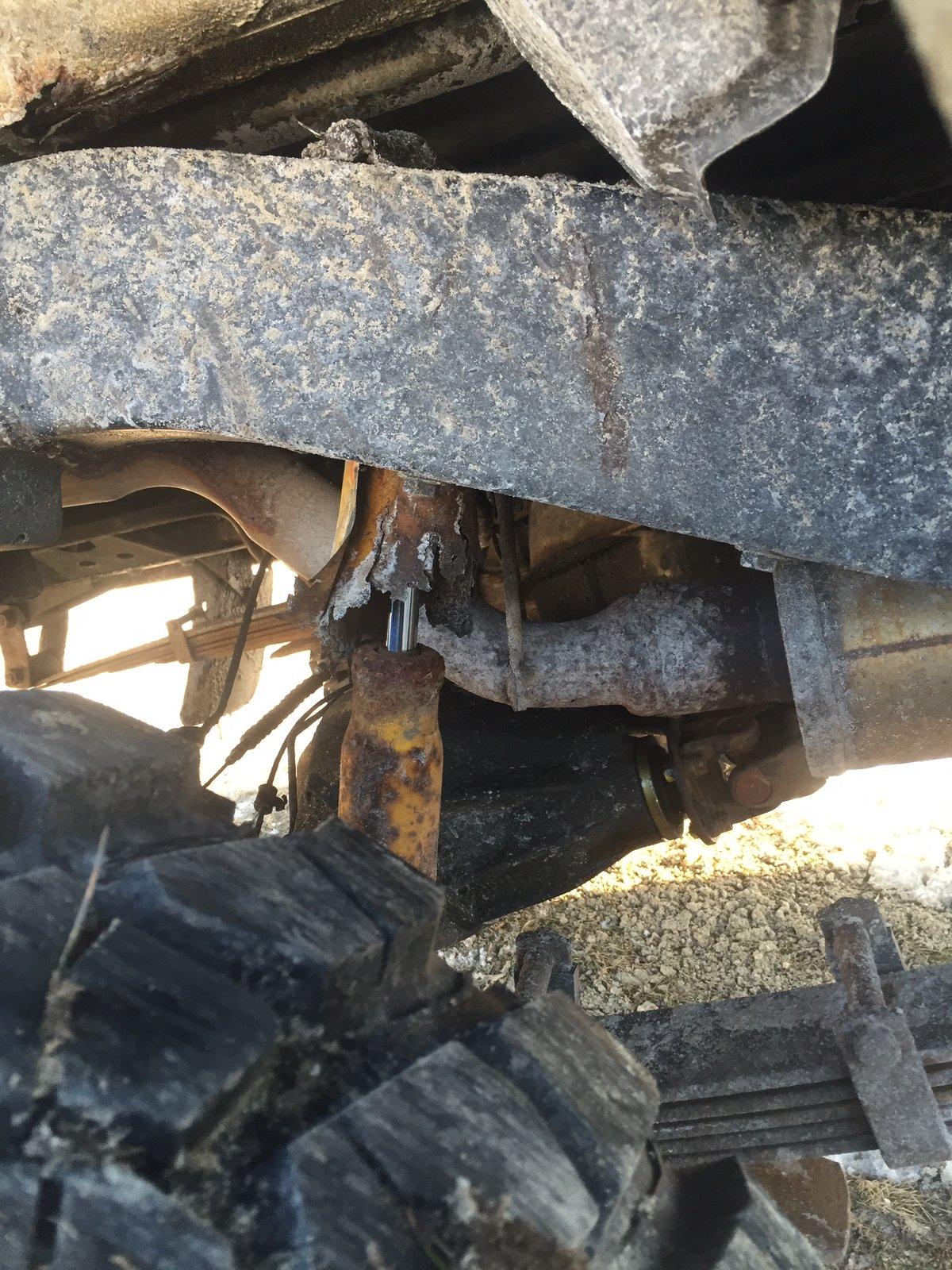

Oil spray can be put on all other parts unlike other coatings. Including suspension components. Picture of 7 year old OME nitrochargers on my old truck. New England roads ate them, but they still felt great.
