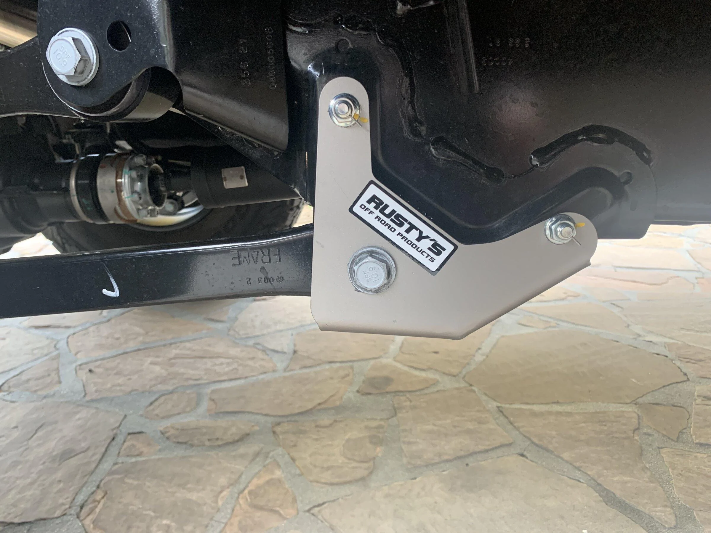

I just put on the rear frame side Rusty's. The drivers side was a pain as mentioned above - had to drill out one hole to make it fit. Also difficult to get a wrench on the small bolts to get them tight. safety wired them just in case they ever come loose. Look beefy and will test them a little this weekend. Going to order the Rockhard front frame side and have all the other rock hard lca sliders that I need to install

if you had put the bolts in from the outside, the flanged nuts would have held in place enough to get the bolts tightened up.

Tried that, but couldn't quite get it so gave up. They are just to keep the bracket from pivoting so it should be fine. Will watch those bolts when on the trail.

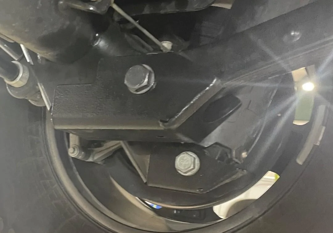

I can't comment on Rusty's but just installed the Rock Hard LCAs, rear shock mounts, and swaybar motor skids. They are very beefy and relatively easy installs. Great quality.
Jeep Gladiator Rusty's vs Rock Hard - frame side rear control arm skids IMG_5245
