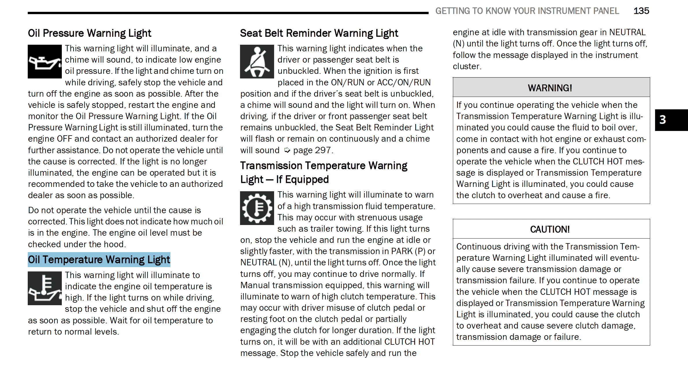

Even without towing, I get 224F oil temp driving on a slight uphill gradient for a few miles. So your oil temps of 230s while towing is not something to worry about with synthetc oil. Pentastar does run a little hotter than other trucks in my personal experience. And Ecodiesel runs hotter.
Not sure what the max safe temp for oil would be but on the JL Wrangler forums, some Jeepers even mentioned oil temps go into 240s without any issues.
If something is amiss, you will also see a warning.
From the manual - page 135.
