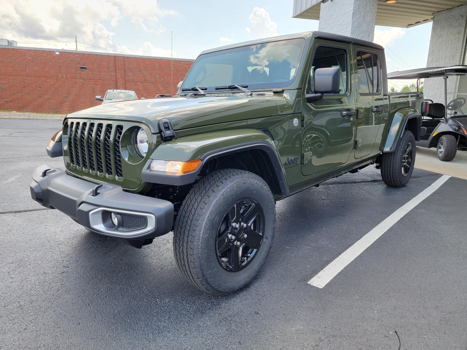

Vehicle was delivered July 12th from Gupton motors

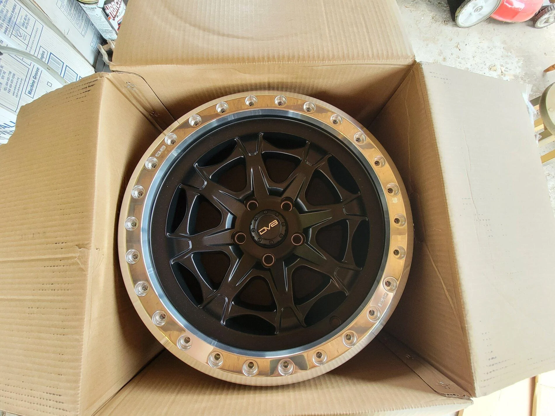

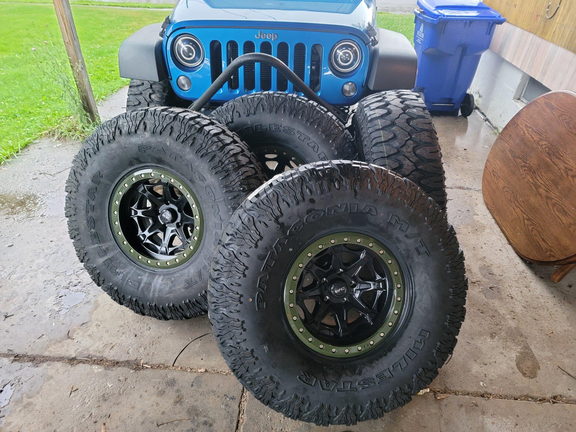

Started with DV8 Offroad beadlock wheels, the polished beadlock rings are nice but they would stand out too much
Jeep Gladiator Sarge Green Build Thread, 40s max tow... overland etc undefined - Imgur (2)

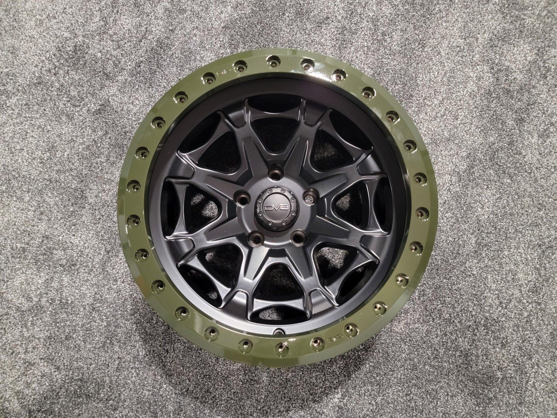

Had a local shop paint the beadlock ring to match the body color
Jeep Gladiator Sarge Green Build Thread, 40s max tow... overland etc undefined - Imgur (3)
40" Milestar patagonias showed up & started mounting wheels... This takes a while, beadlocks are very time consuming.
Jeep Gladiator Sarge Green Build Thread, 40s max tow... overland etc undefined - Imgur (4)
Jeep Gladiator Sarge Green Build Thread, 40s max tow... overland etc undefined - Imgur (5)

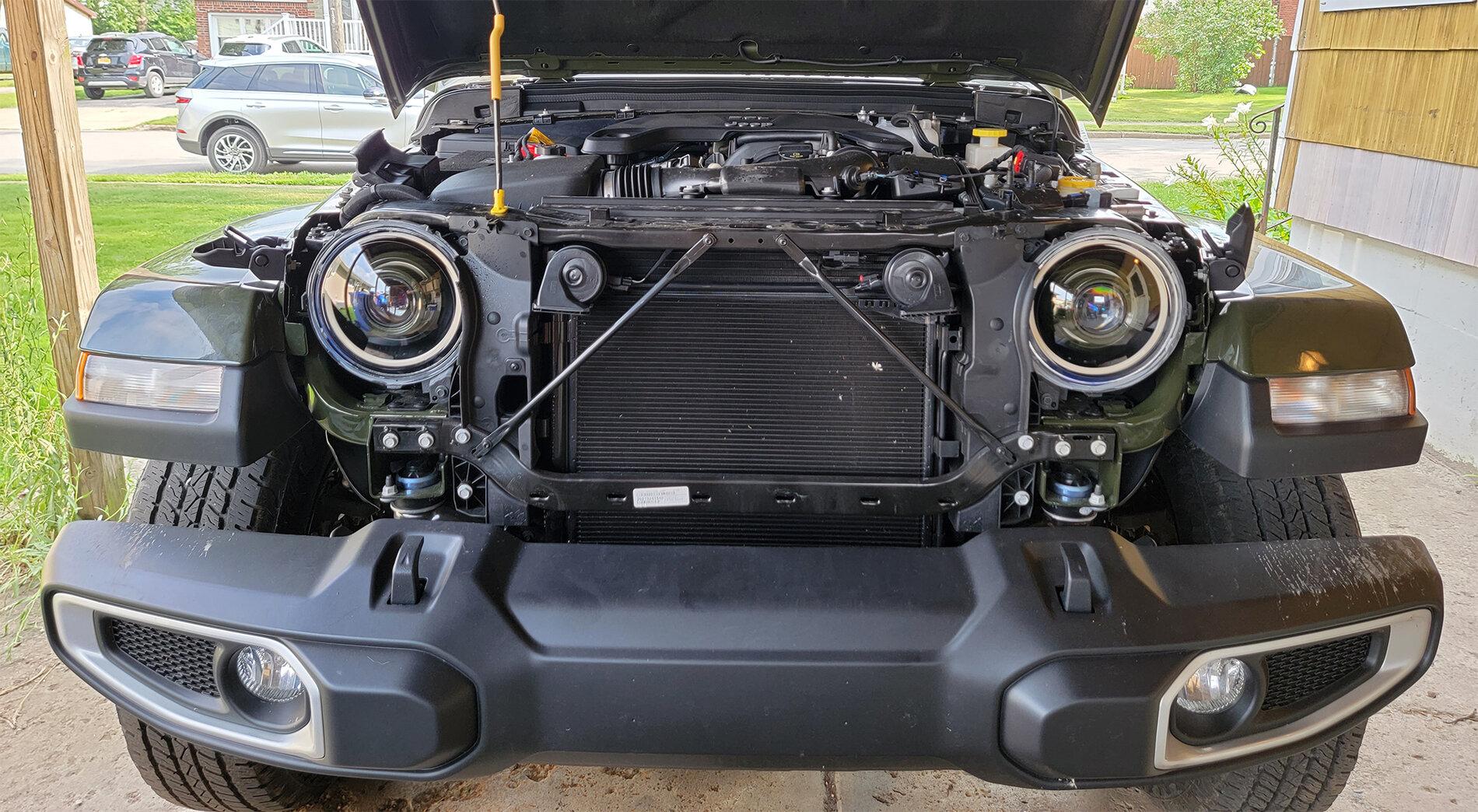

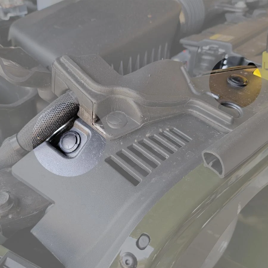

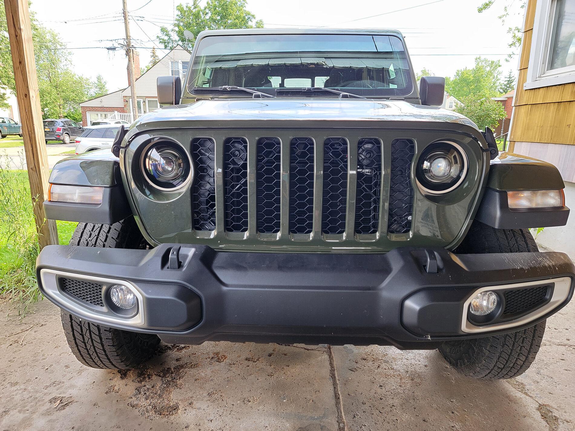

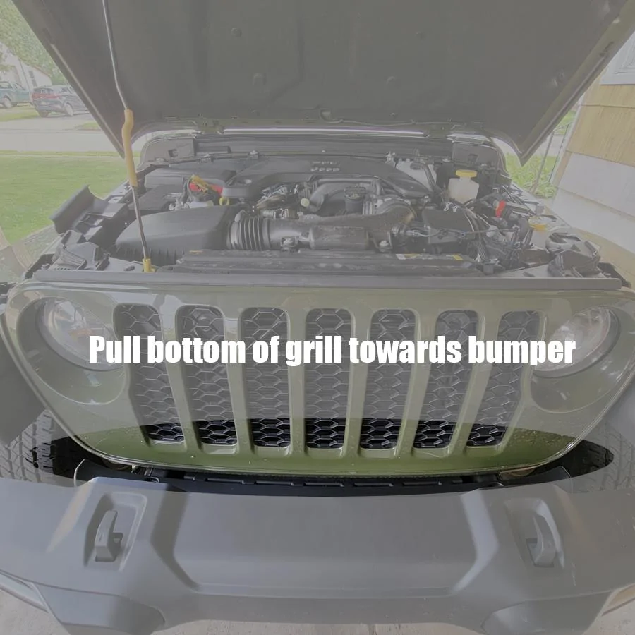

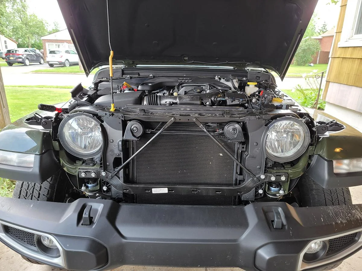

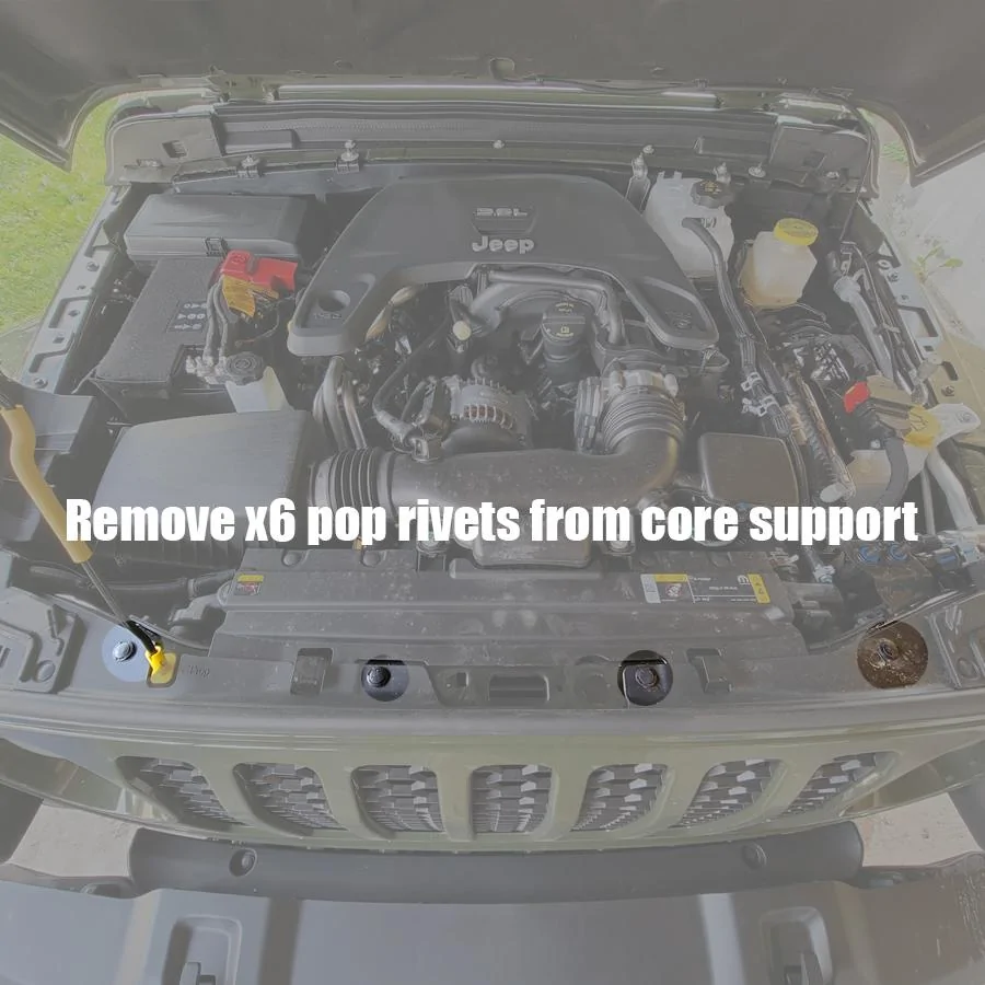

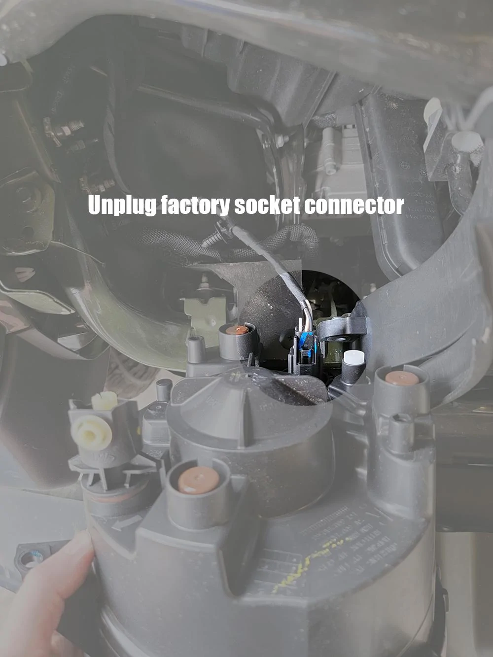

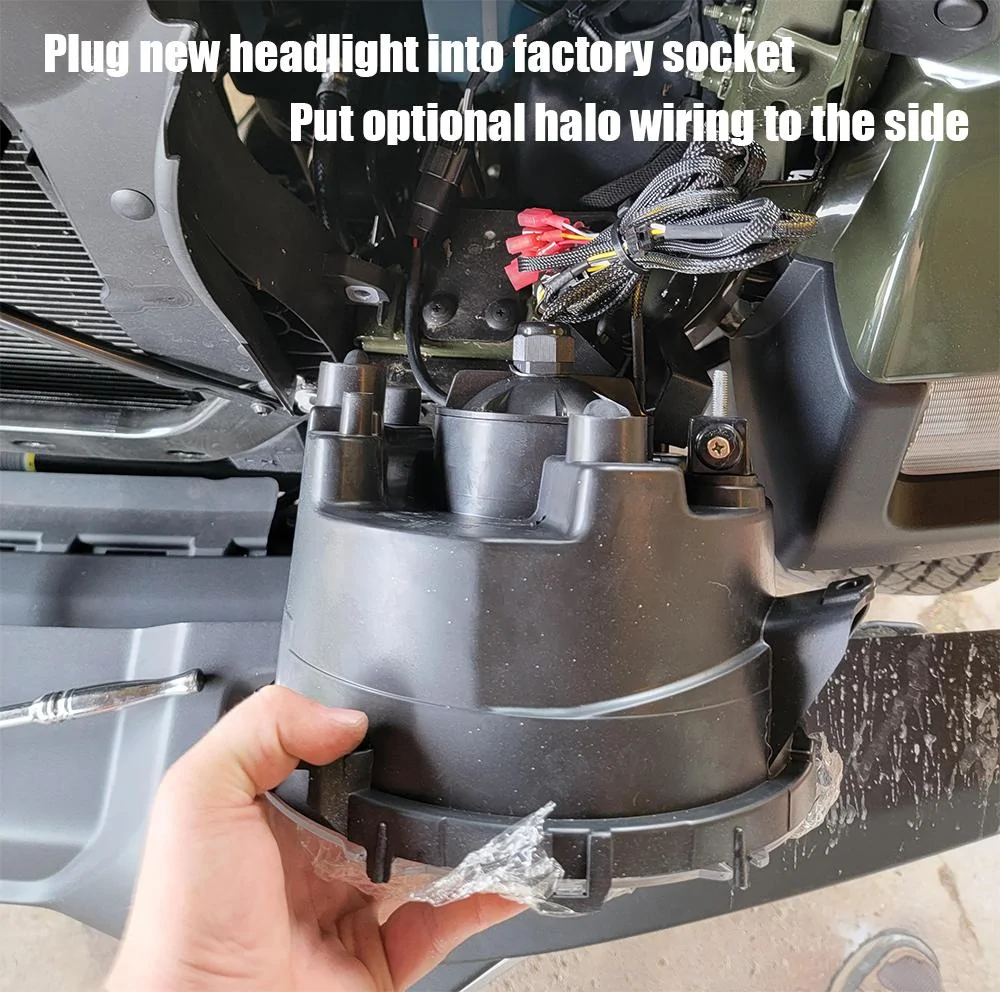

While i waited for the lift kit to arrive i started installing my headlights. These are HIDprojectors.com Expedition Series Bi-LED projector Headlights for the Gladiator / JL. Mine are heavily customized with paint & White / amber switch back halos.

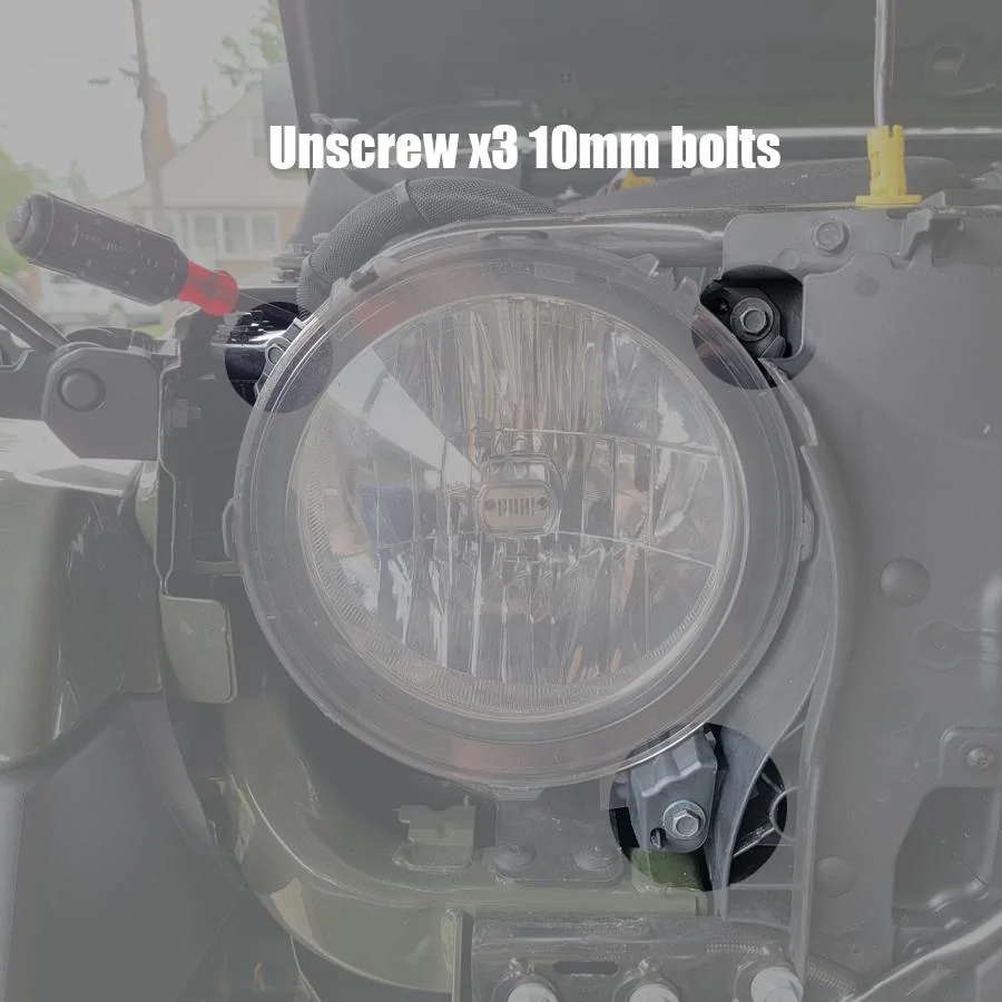

Here's a quick installation guide
Jeep Gladiator Sarge Green Build Thread, 40s max tow... overland etc 2.2
Jeep Gladiator Sarge Green Build Thread, 40s max tow... overland etc 1.1
Jeep Gladiator Sarge Green Build Thread, 40s max tow... overland etc 3.3
Jeep Gladiator Sarge Green Build Thread, 40s max tow... overland etc 4.4
Jeep Gladiator Sarge Green Build Thread, 40s max tow... overland etc 5.5
Jeep Gladiator Sarge Green Build Thread, 40s max tow... overland etc 6.6
The bundle of wires here are for my Halos, i will wire those up in the near future.
Jeep Gladiator Sarge Green Build Thread, 40s max tow... overland etc 8.8
Jeep Gladiator Sarge Green Build Thread, 40s max tow... overland etc 9.9
Put grill on in reverse and you're good to go.

Stock vs HIDprojectors.com Bi-LED projector Headlights
Jeep Gladiator Sarge Green Build Thread, 40s max tow... overland etc Output

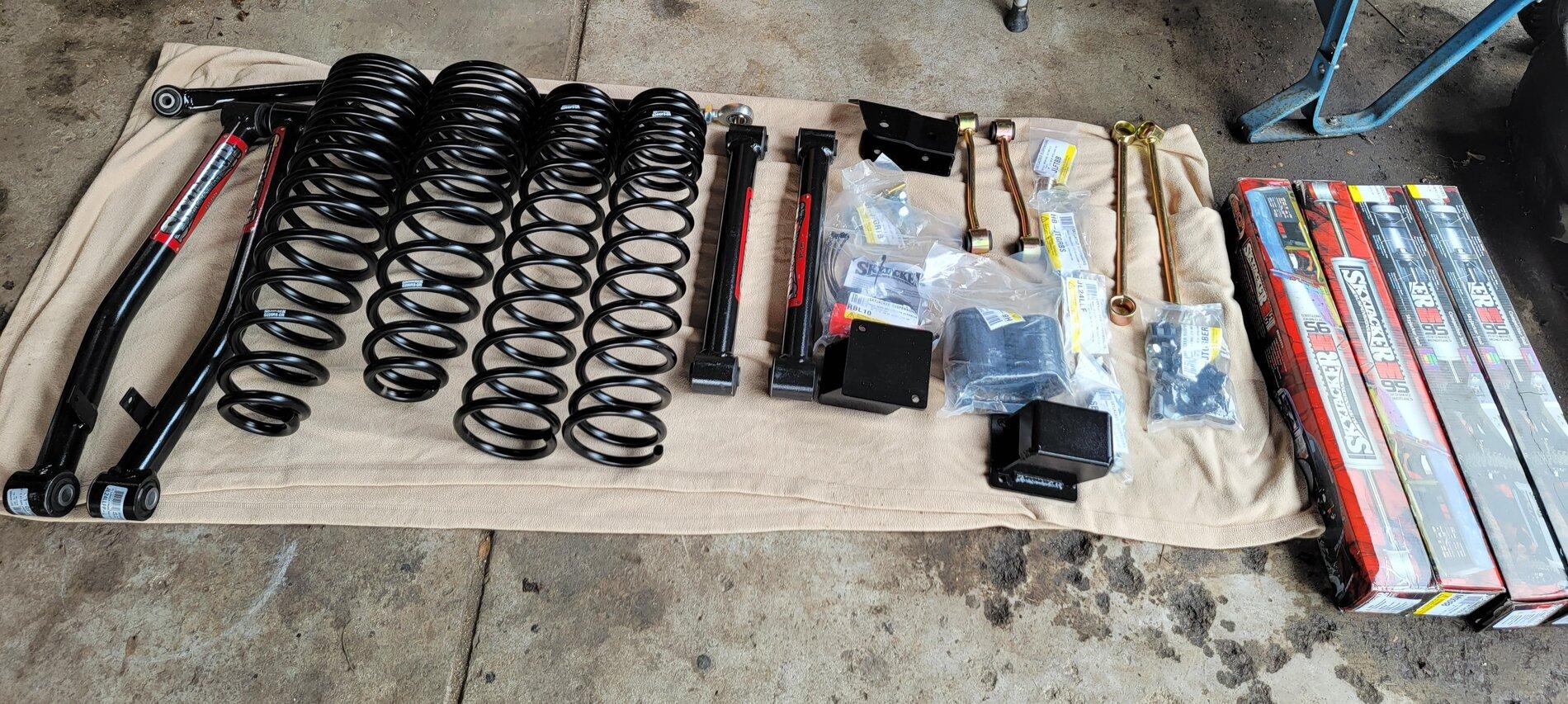

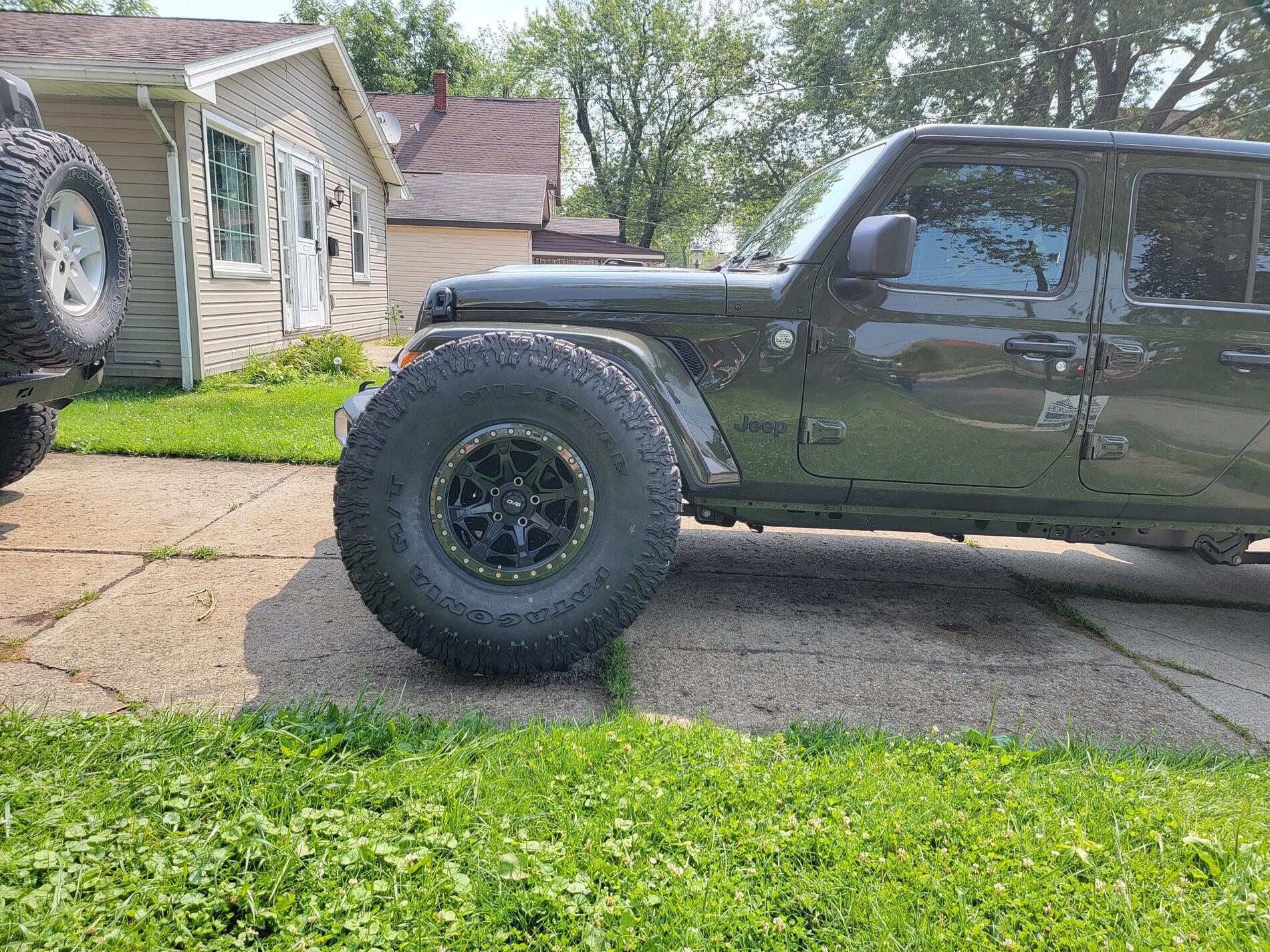

Moving forward, skyjacker 4.5" lift arrived a day early Part number is GM452KMLT and this kit was a breeze to install. Only two holes had to be drilled for the rear trackbar mount bracket.
Everything else is bolt in, it took me about 7 hours to do this in my driveway. Note the one spring is longer, this accounts for the gas tanks extra weight.
Jeep Gladiator Sarge Green Build Thread, 40s max tow... overland etc x227fGX - Imgur
40s vs stock lift height
Jeep Gladiator Sarge Green Build Thread, 40s max tow... overland etc undefined - Imgur (7)

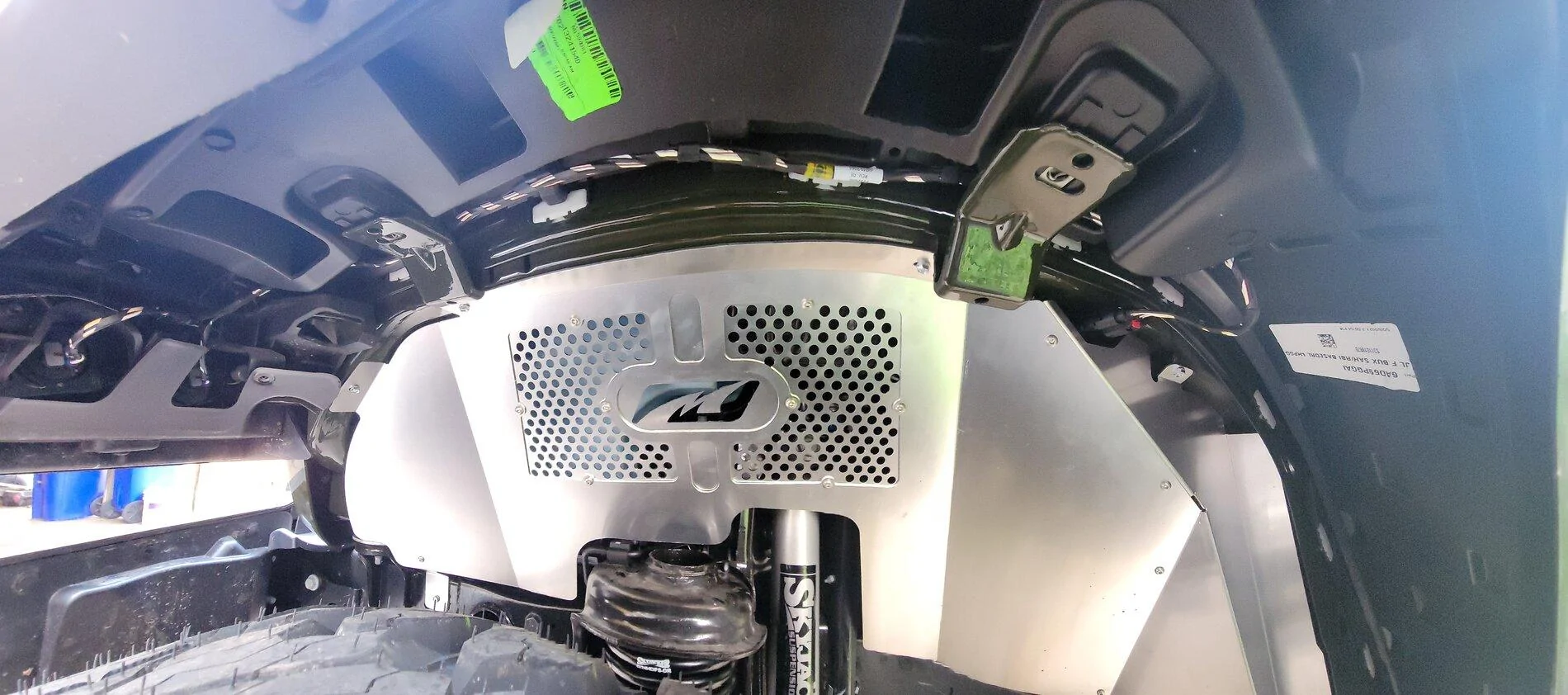

I forgot to take some pictures, but i have motobilt aluminum inner fender flares installed. The best time to do it is before the tires were mounted. Ripped out all of the factory plastics and put them in with self tapping screws & included hardware.
Jeep Gladiator Sarge Green Build Thread, 40s max tow... overland etc 20210719_170937

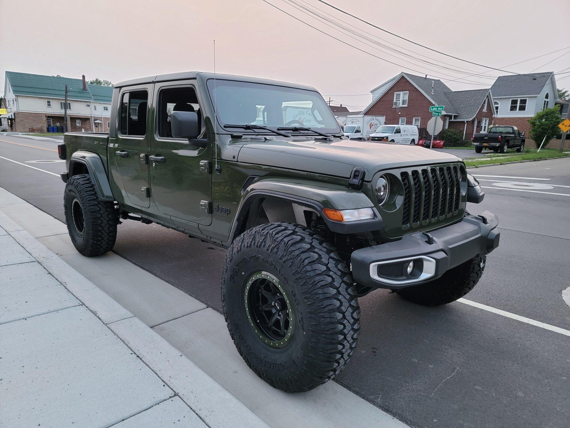

And here we are rolling on 40s, the max tow 4.10 gears do just fine with them. I did have to use a superchips flashcal that i bought from thejeephut.com to program the computer.
Jeep Gladiator Sarge Green Build Thread, 40s max tow... overland etc undefined - Imgur (9)
Jeep Gladiator Sarge Green Build Thread, 40s max tow... overland etc undefined - Imgur (8)

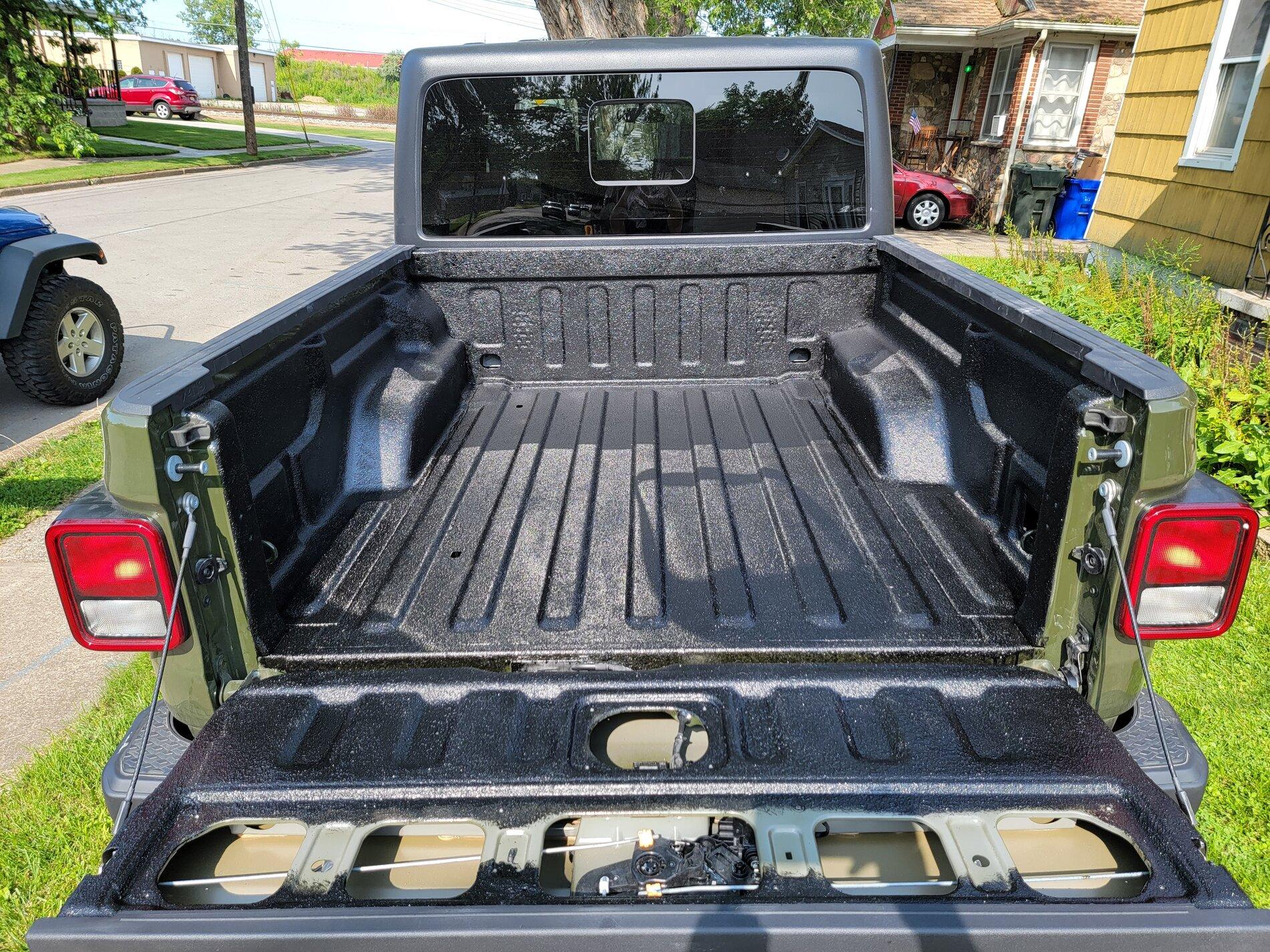

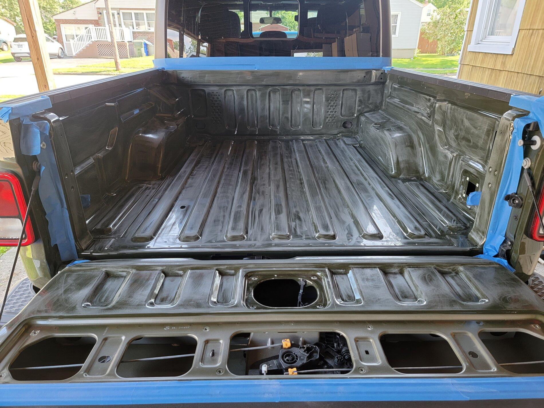

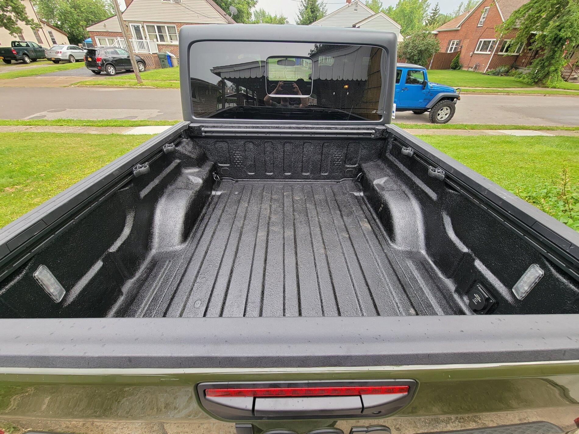

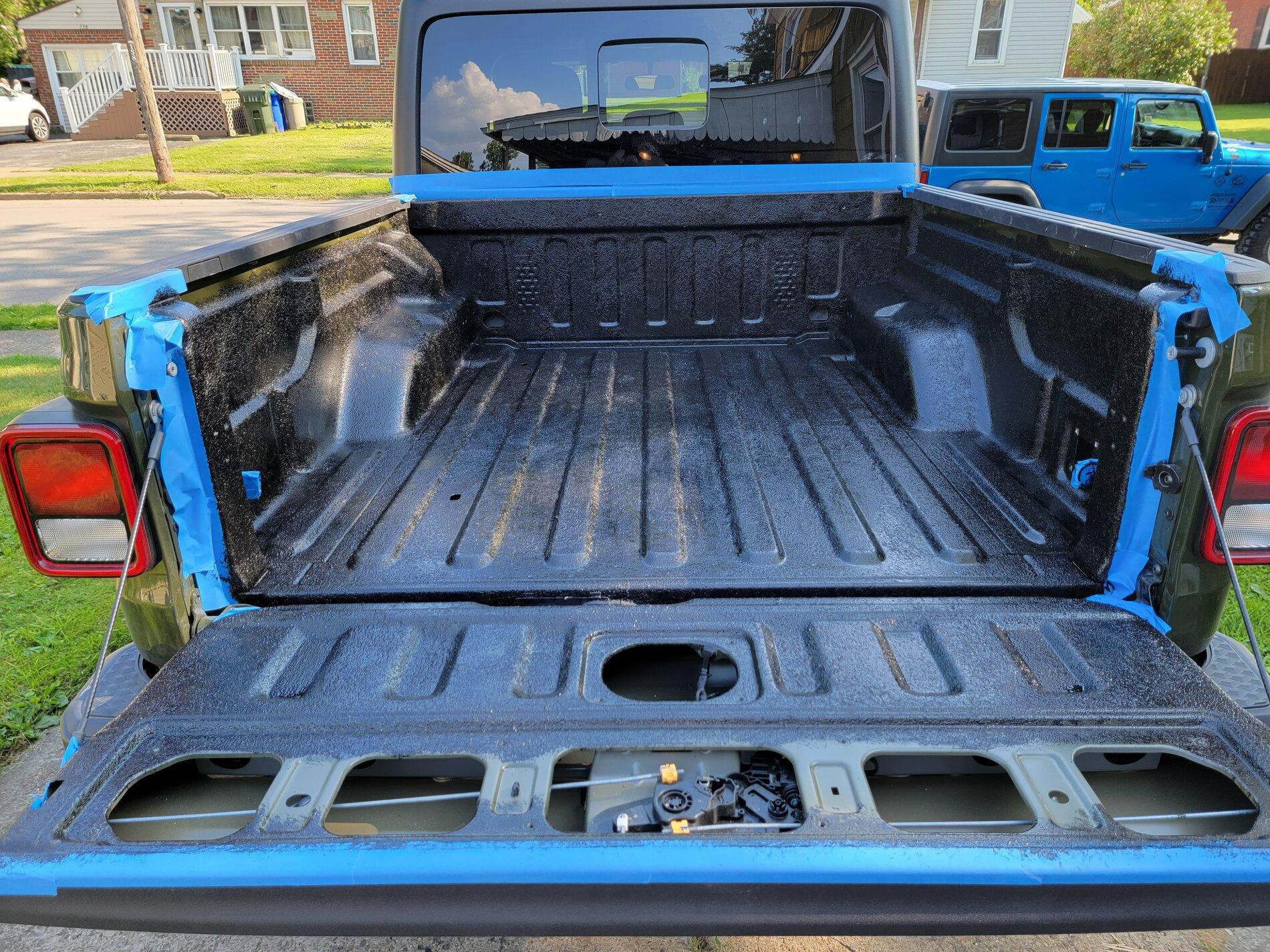

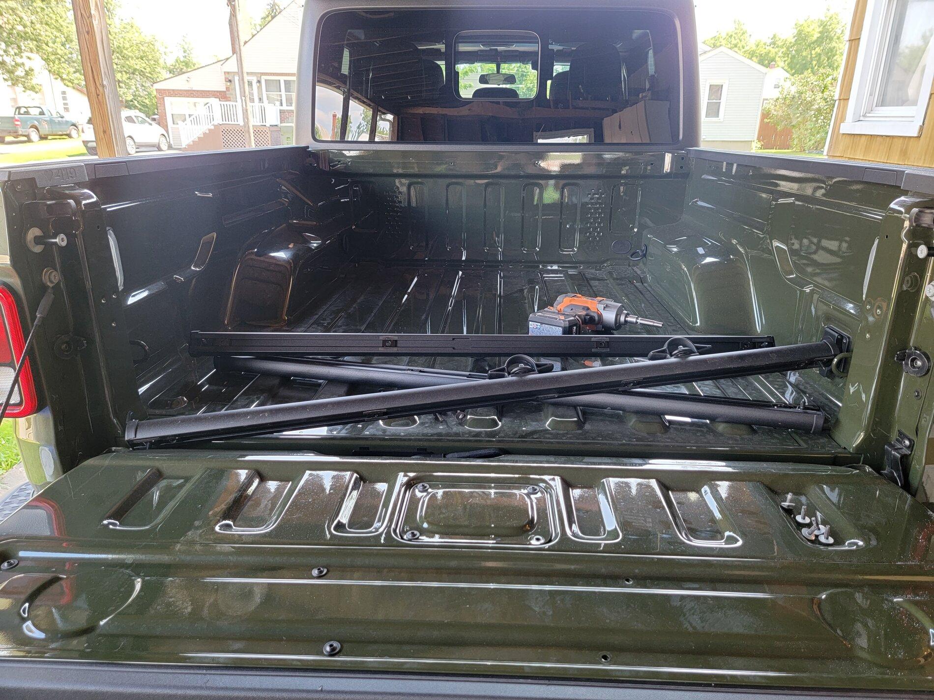

Started working on the bedliner, I've had very good luck with herculiner roll on over the years.
10mm bolts hold the trail rail system on, there's a few of them
you need a T30 for the two tailgate panels. and I believe it was a T15 for the inverter socket.
I dont remember what the hold downs were.. maybe T50?
Be careful when removing the bed LED lights they only come out one way. You need to depress a tab from the middle-top of the lense so the tab inside releases.
Jeep Gladiator Sarge Green Build Thread, 40s max tow... overland etc 20210723_152306
Next I took 100grit paper & sanded the paint off, you don't have to reach bare metal. Just enough to help the herculiner bite.
Once I was finished sanding I took a microfiber rag & some acetone to the entire bed.
Jeep Gladiator Sarge Green Build Thread, 40s max tow... overland etc 20210723_162137
I actually used a long handle brush and stippled the *entire* bed. I'll take a roller to it for the final coat.
Make sure you do multiple thin coats, if you paint it on too thick it will Crack and look like dried mud.
Jeep Gladiator Sarge Green Build Thread, 40s max tow... overland etc 20210723_172012
Going to let this cure out for 4hours and see if it's ready to stand on so I can finish the job, if not I'll let it sit overnight.

Not much going on today, final coat is on & it's curing in the sun. I hope to get the rails on later tonight.
Total cost was $60 and some of my time. Advance auto currently has a 20% off special for online - store pick up orders + I also had $20 off with my speed perks.
pretty good savings compared to line-x or factory installed spray on liner.

Alright got some more stuff done, bed cured out and I put the trail rail back in
Jeep Gladiator Sarge Green Build Thread, 40s max tow... overland etc 20210724_171656

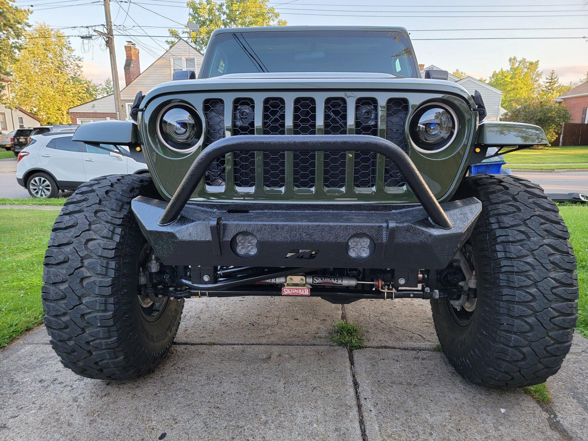

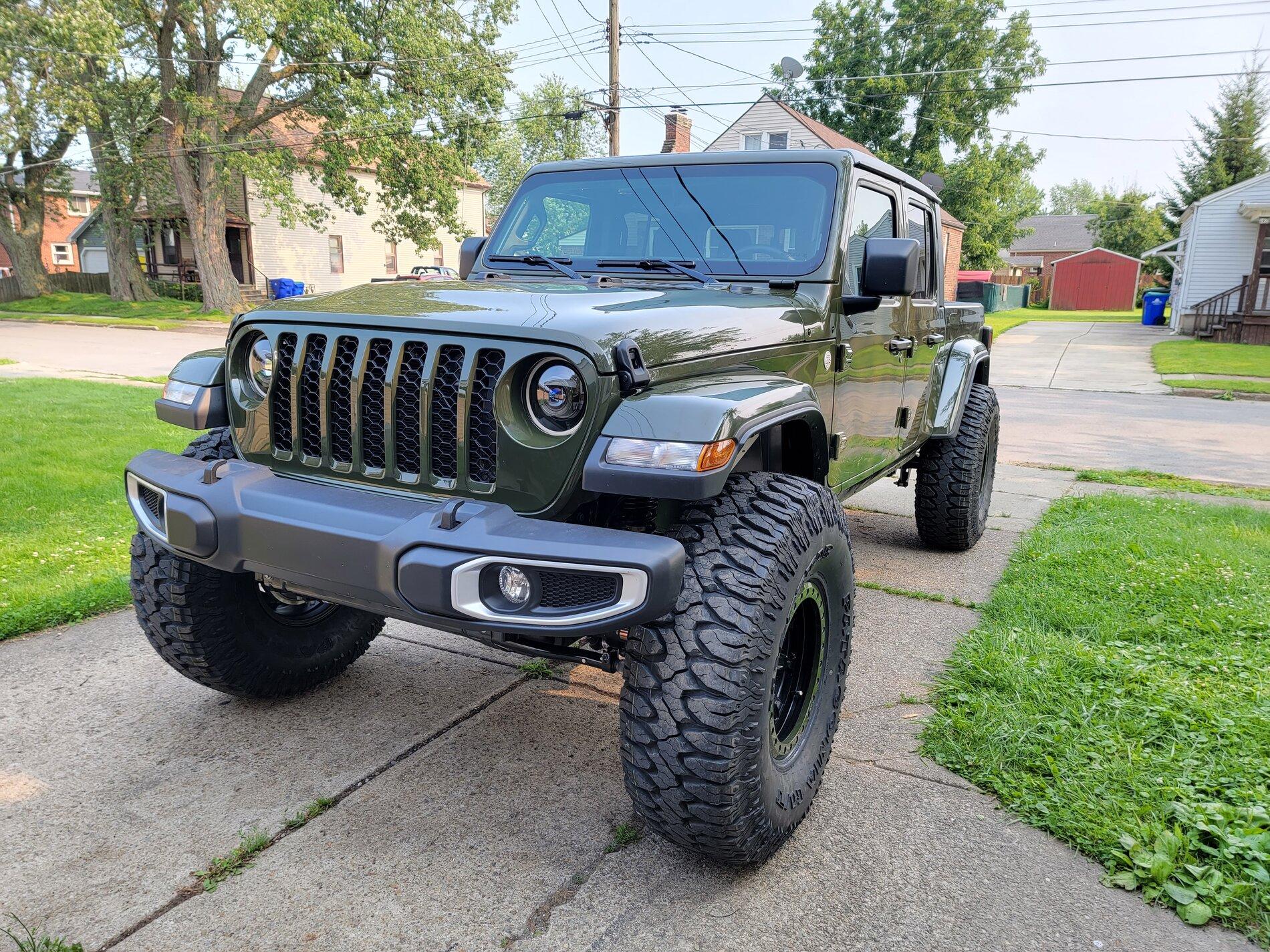

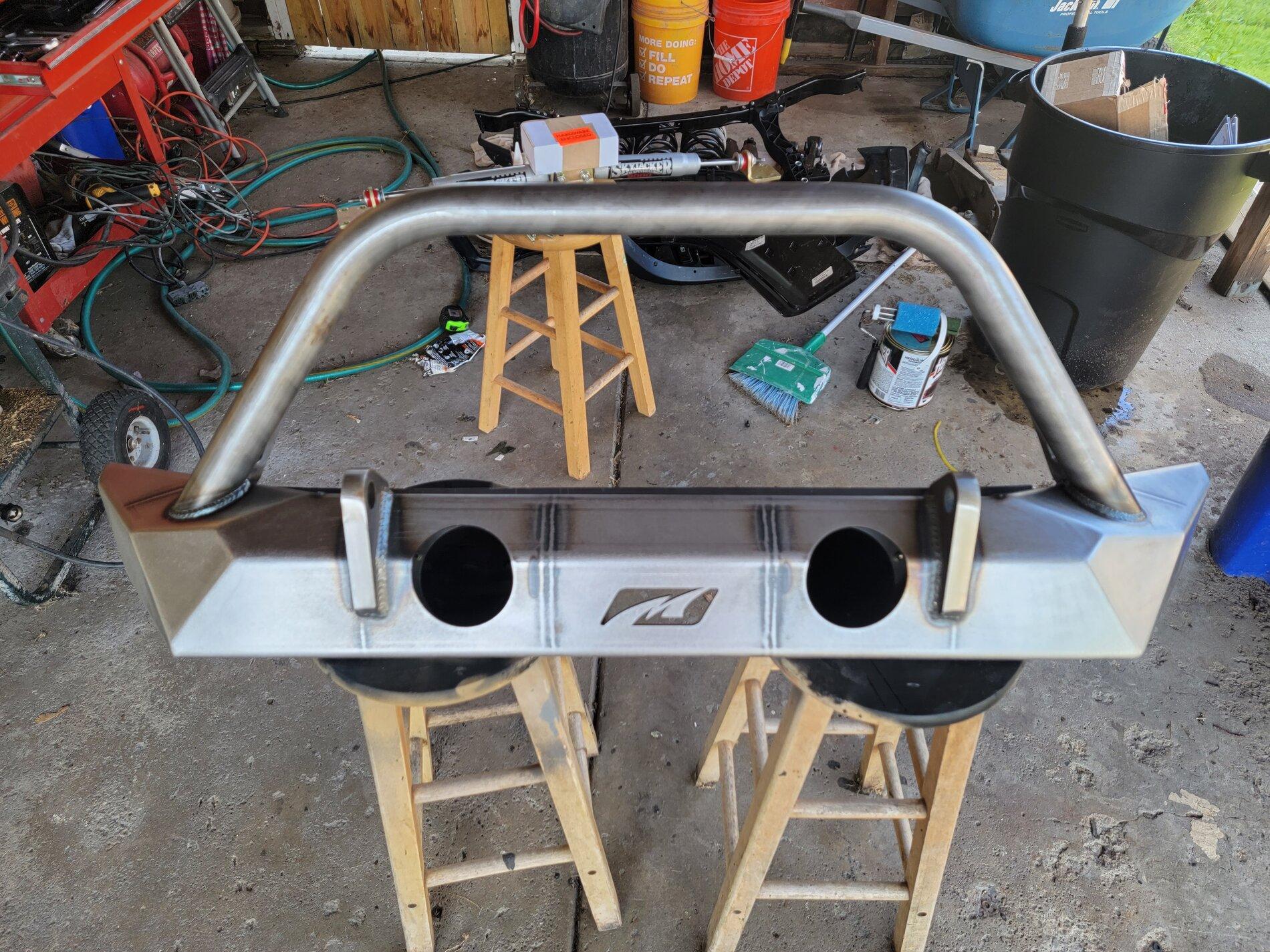

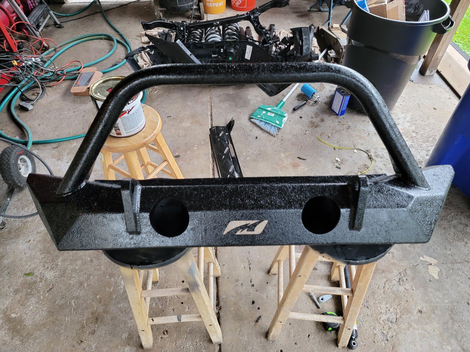

Motobilt front bumper arrived, cleaned it up with acetone and painted it with brownells aluma hyde II epoxy paint. Used this stuff on firearms for years and it's amazingly tough paint. Waited a day for it to cure out and then hit with the herculiner too.
Jeep Gladiator Sarge Green Build Thread, 40s max tow... overland etc 20210728_160257
Jeep Gladiator Sarge Green Build Thread, 40s max tow... overland etc 20210729_181513

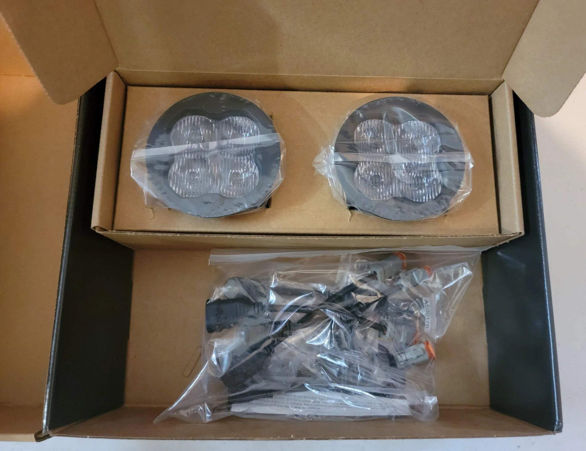

Waiting on my Diode Dynamics SS3 Max fogs to arrive before I install later today. (yeah the $550 ones) I've seen standard / pro in person lets see how good the maxes are.

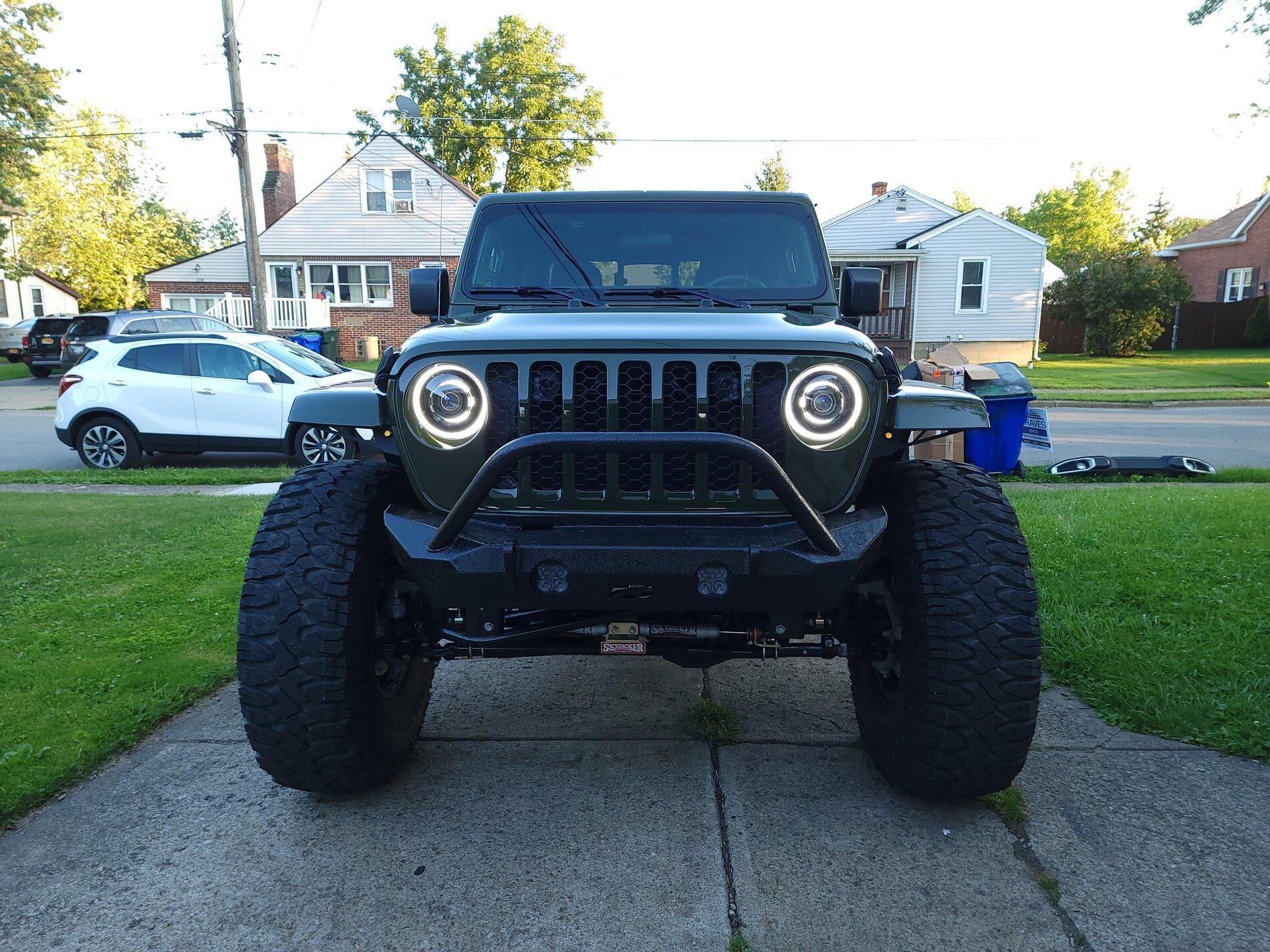

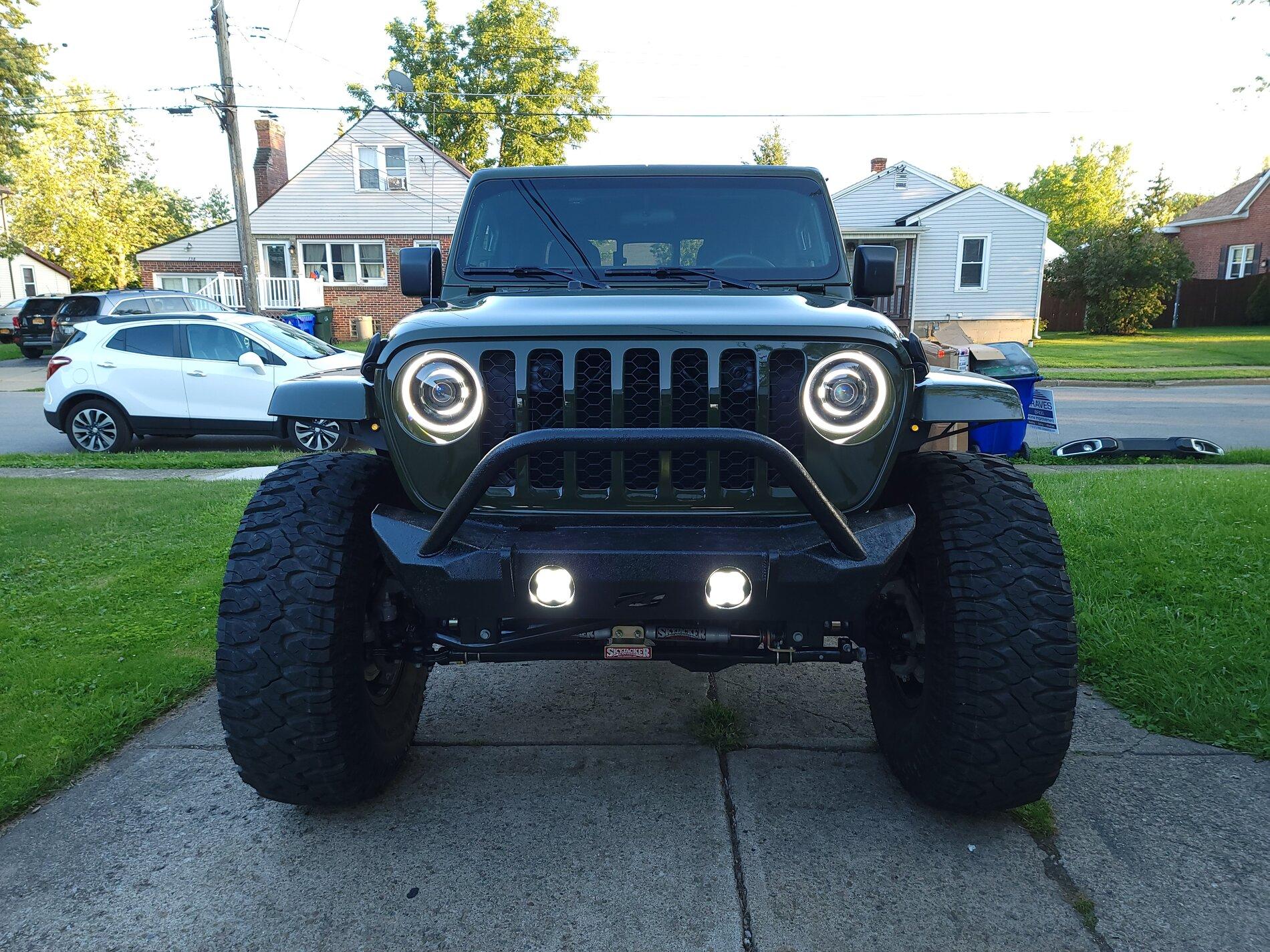

Alright got the motobilt hammer bumper mounted with Diode Dynamics SS3 Fog lights, these are the "max" tier - aka the $550 ones
these specifically have the JK style mount bracket as motobilt retained the JK fog light bolt pattern for their hammer series bumper.
Jeep Gladiator Sarge Green Build Thread, 40s max tow... overland etc 20210730_161041
Jeep Gladiator Sarge Green Build Thread, 40s max tow... overland etc 20210730_161114
I cannot wait until it gets dark out here, these are looking very promising.
I also wired up the halos for my headlights, these are switchback so they flash amber with my turn signals... oh yeah and I received my fender chop reinforcement brackets from rugged ridge, nobody likes a floppy fender!
Jeep Gladiator Sarge Green Build Thread, 40s max tow... overland etc 20210730_194907
Jeep Gladiator Sarge Green Build Thread, 40s max tow... overland etc 20210730_194948
Jeep Gladiator Sarge Green Build Thread, 40s max tow... overland etc 20210730_195019
The diode dynamics SS3 Fog lights are the same color temperature as HIDprojectors.com Bi-LED Projector headlights too!

Only headlights:
Jeep Gladiator Sarge Green Build Thread, 40s max tow... overland etc 20210730_211905
headlights + fog lights
Jeep Gladiator Sarge Green Build Thread, 40s max tow... overland etc 20210730_211901
