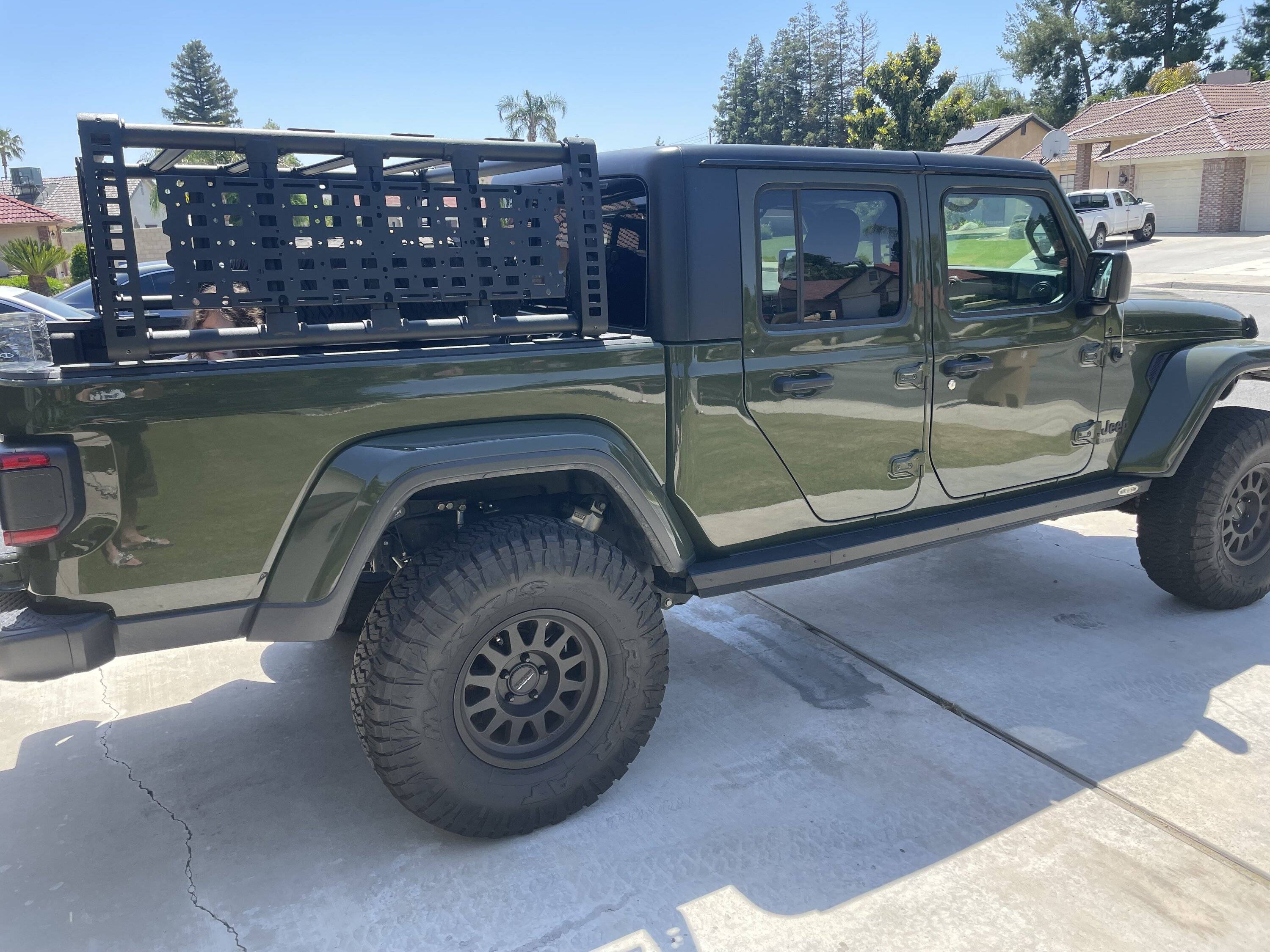

I'll try and keep this all updated with latest modifications. Going to be doing various things camping, hunting, dunes, trails here in California and where ever I can roam. Feel free to drop me a line on how anything I have listed here is working out. Cheers!

    • The sliders don't hold up to any real abuse. Mine got bent up in a few sections. Steps still work and should be able to bend things back out and install these and no more issues I hope.
  • Motobilt Tomahawk front bumper with bull bar. Requires frame chop lots of approach angle added :rock:
  • Motobilt Crusher rear bumper. Was this or the FabFours JT wanted something that wraps all the way round to the rear fenders. (install eta ???)

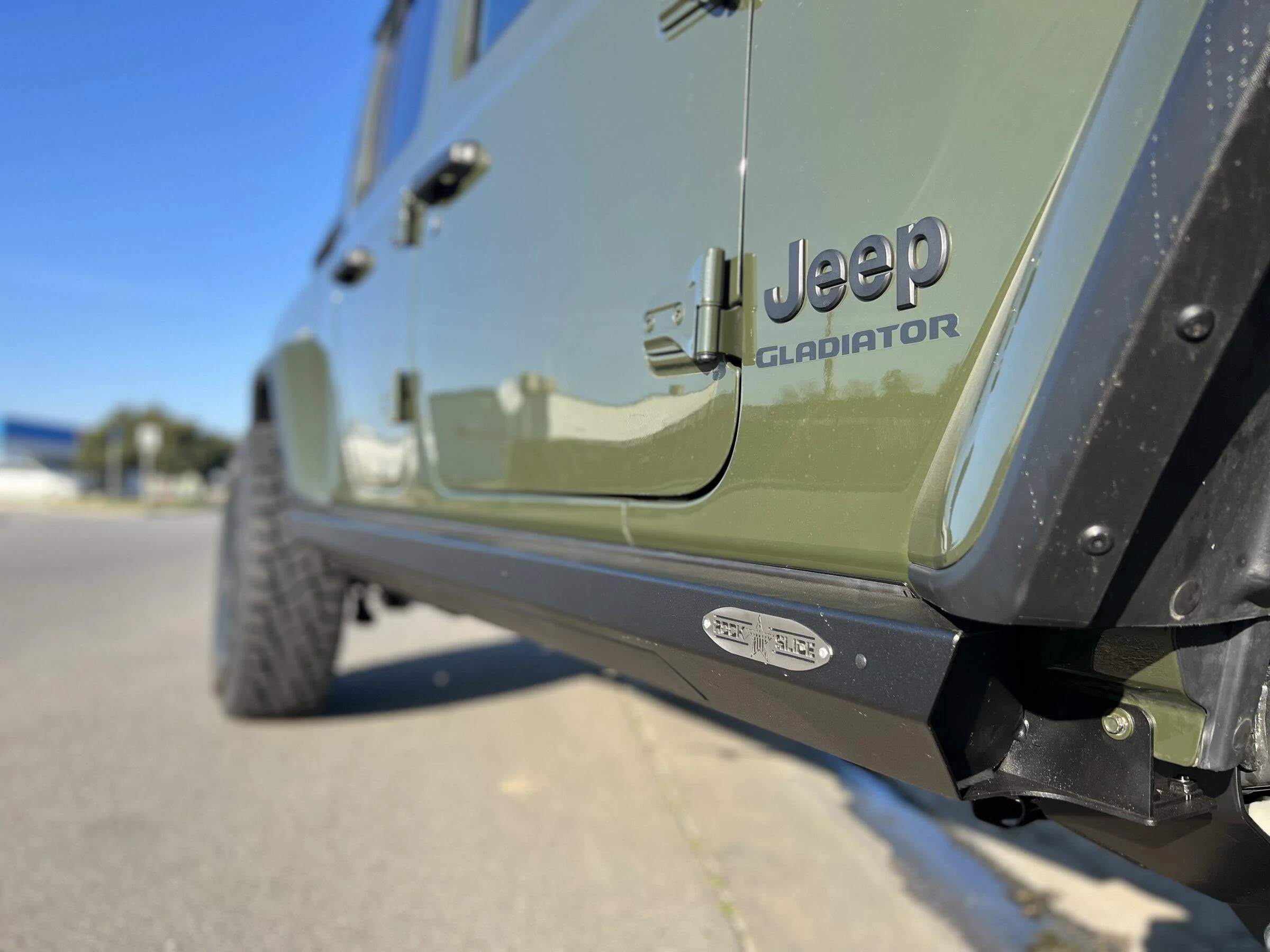

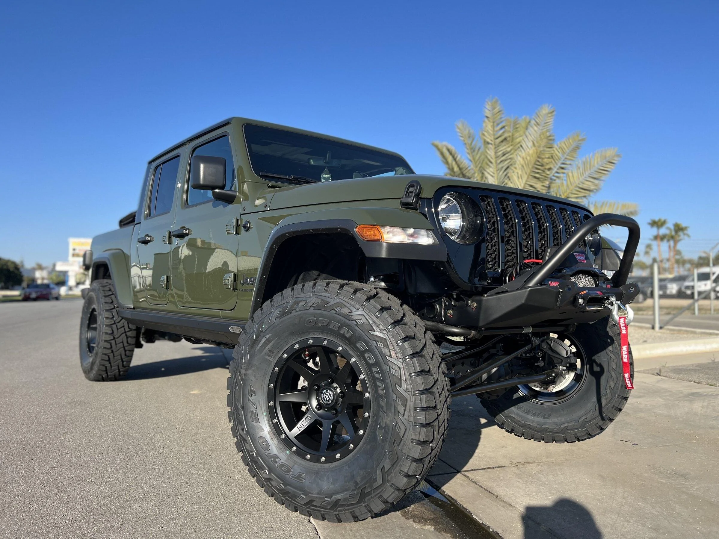

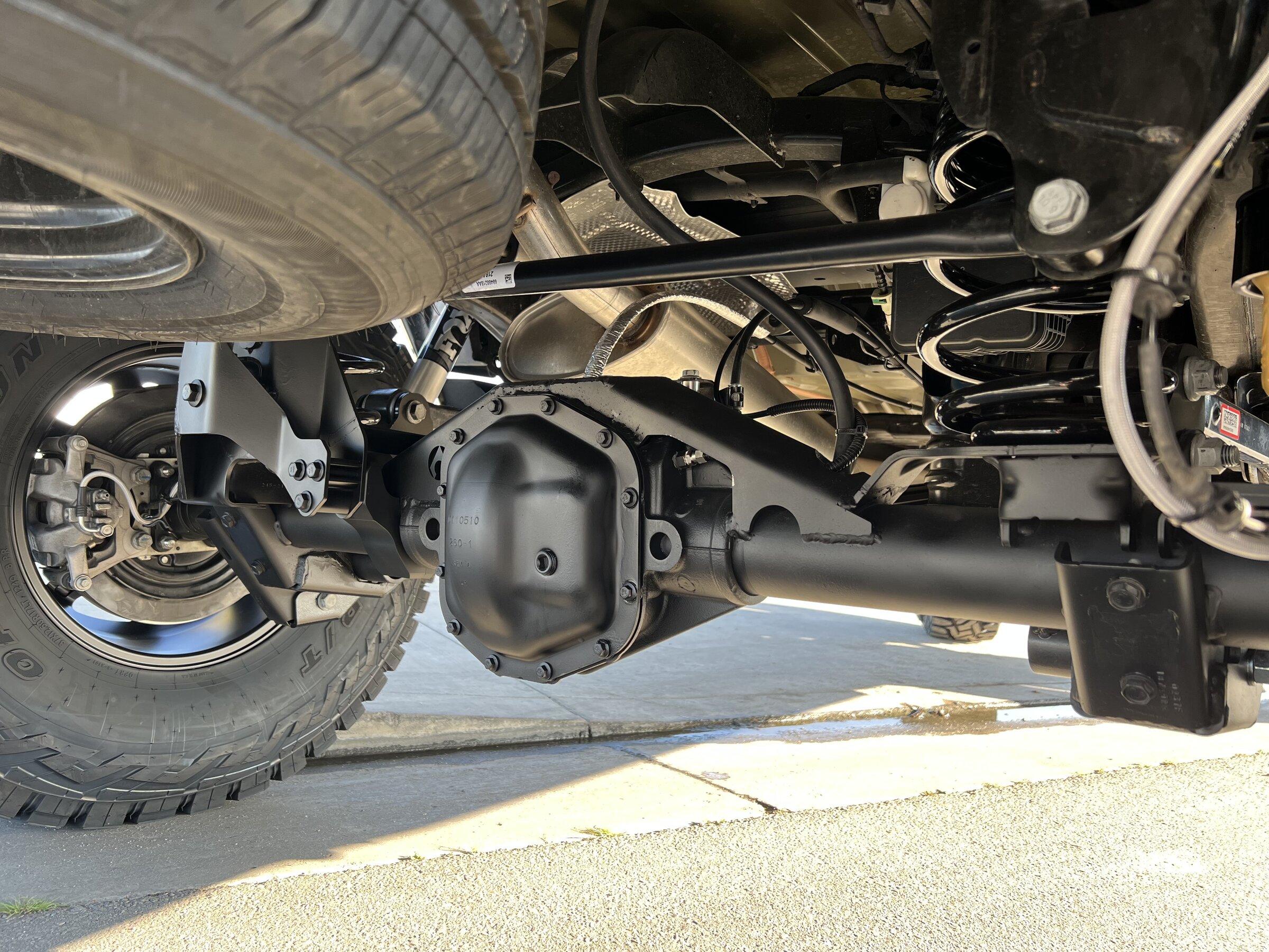

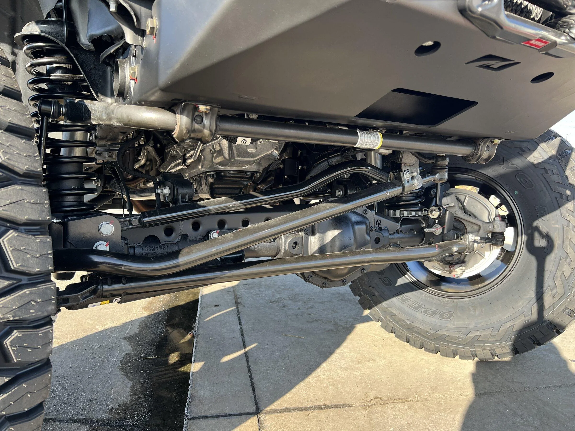

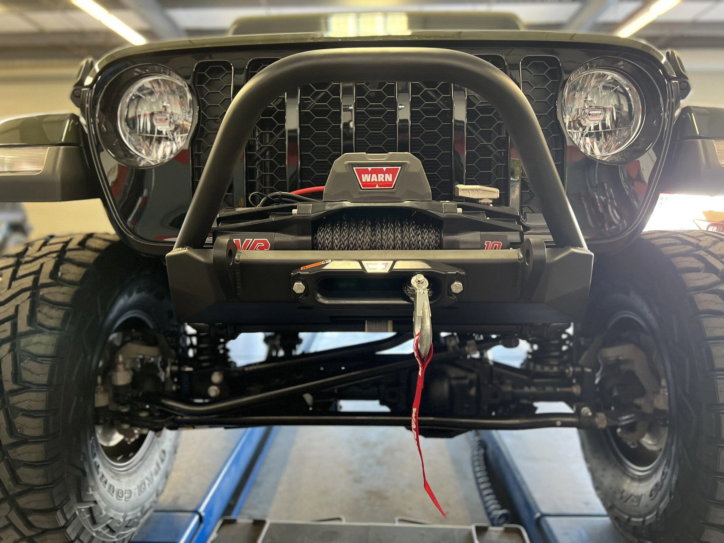

Some shots sent to me today. Out of town will pickup on Monday really looking forward to it.
