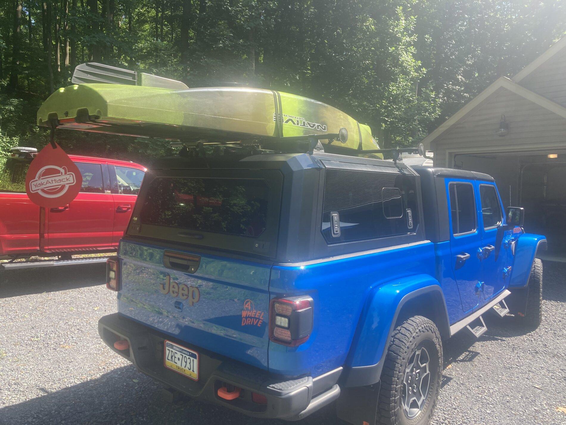

I have an RSI and love it, have Yakima round bars on the rail system both with boat loaders to allow loading heavy kayaks but more importantly, hauling two 34” wide is a real wide rack. So boat loaders can be extended out to support the side of a yak, did not use it yet but it will.
The fiberglass tops are not rated as high for weight unless getting the internal frame model. Does not seem to matter which brand they are all expensive, although fiberglass are hundreds cheaper!…..Jack
