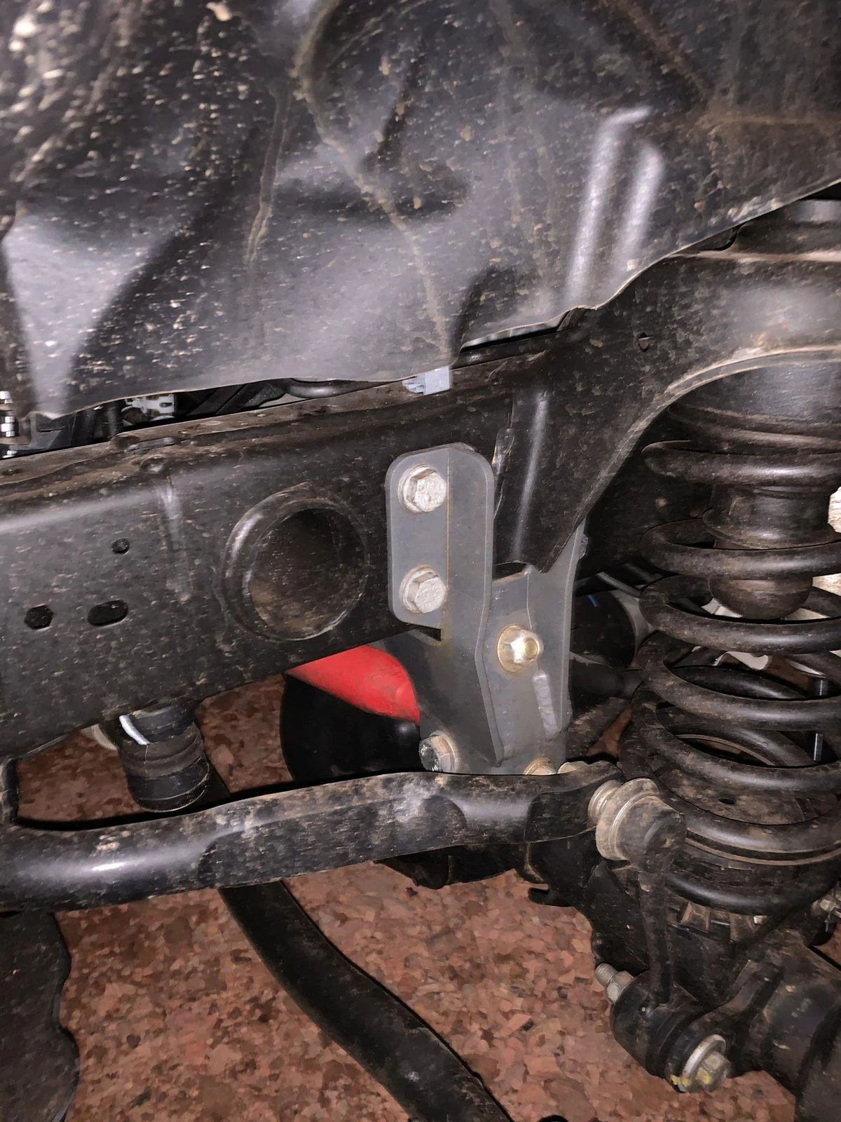

I just installed it last night and I noticed an immediate difference from 20mph and up..
I didn't have the dead spot issue that alotnof people have, but this won't solve that as that's internal to the box.
Mine was darty when hitting bumps(all speeds) and required a lot(almost constant) correction when at highway speeds. I didn't realize quite how bad it actually was until it was gone, I had just chalked it up to being a Jeep thing
Now all that darting is gone and the wheel is dead steady on the highway. The wheel feels tighter now in my hand (in a good way)
For the low cost of this I'd say it's 100% worth it
This area should have been beefed up from the factory. I wouldnt be surprised if we eventually see a recall adding a similar brace

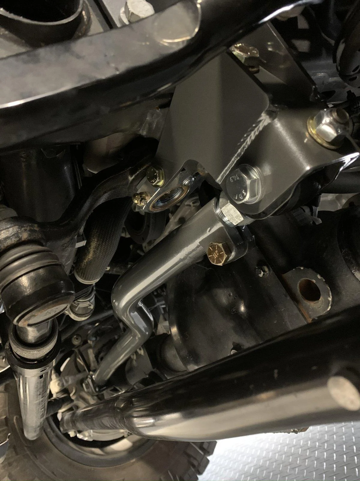

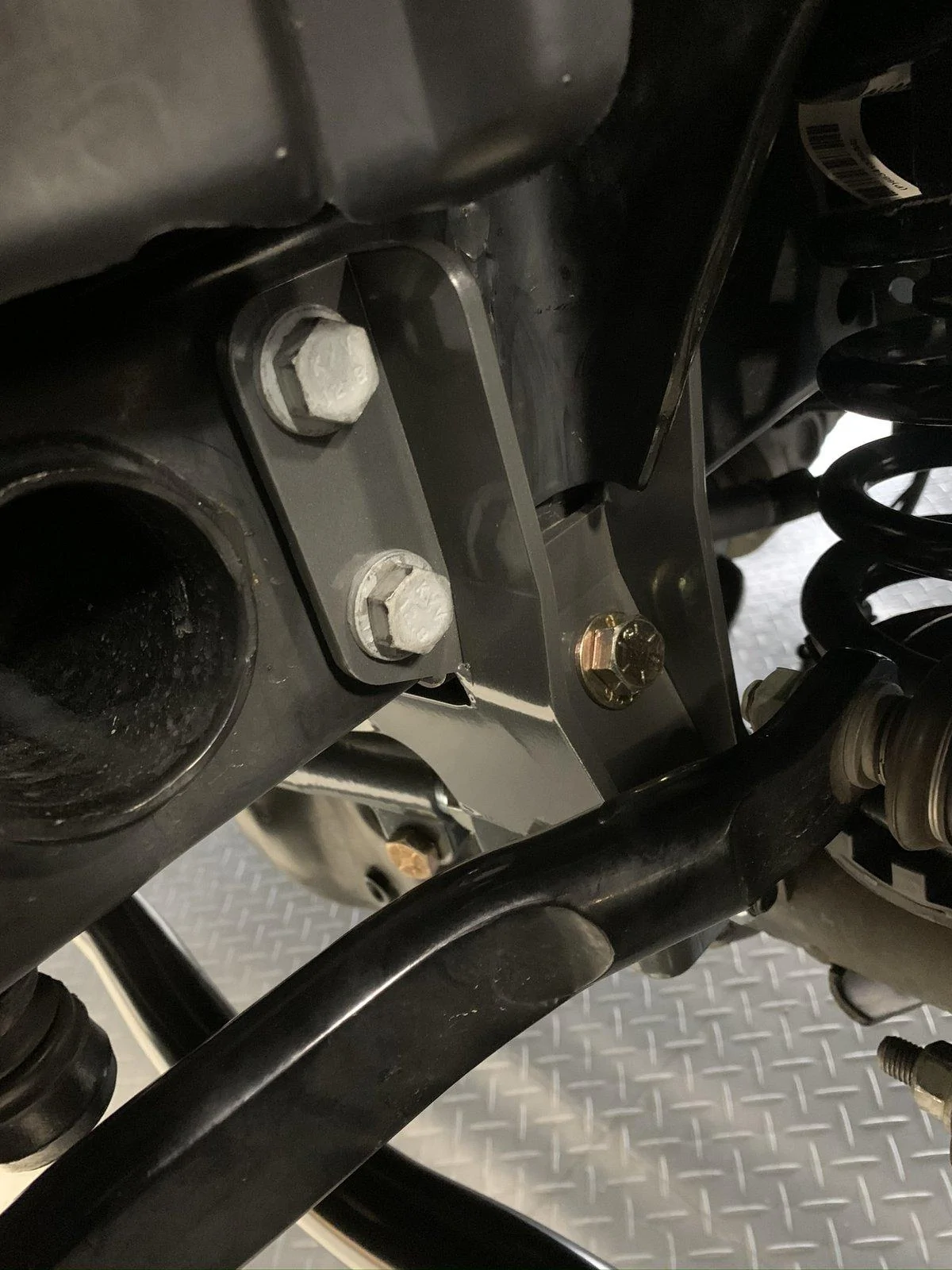

Installed the synergy brace and adjustable track bar today. 98% satisfied with the results/outcome. Tighter steering, less movement and feels more solid on the road. Also want to mention my track was off 1/4” before I started so add that to the equation as well. Gonna play with tire pressure some more (currently 33 psi) and possible toe which is currently 1/8” measured from the center of tire. May consider adjustable lower control arms to get the caster up which is currently at 4.6. Another thing I want to mention is during calm weather it actually handled fine it was mostly unsettled in certain wind and road conditions. Well worth the $425

If you already know this then ignore my comment. It’s not recommended to add just the brace. If you have the OEM track bar synergy wants you to add a 2” bump stop because the OEM track bar will/may make contact with a portion of the bracket at or near full flex or you can add their adjustable track bar and forego the 2” bump stop. I recommend the track bar route as I believe that added to the overall outcome

Couple tips if you don’t mind, it’s suggested to remove the tire and of course I’m smarter than anyone, if you don’t believe me just ask me. I didn’t do that but wish I would have as I do believe it would have been easier. Also it takes a lot of finagling, tightening and loosening to get all the bolts started/lined up which is why I think removing the tire (like they suggest) makes it easier. Good luck and please reply back on how it drives
