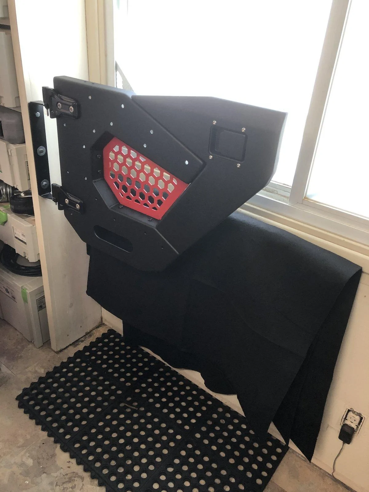

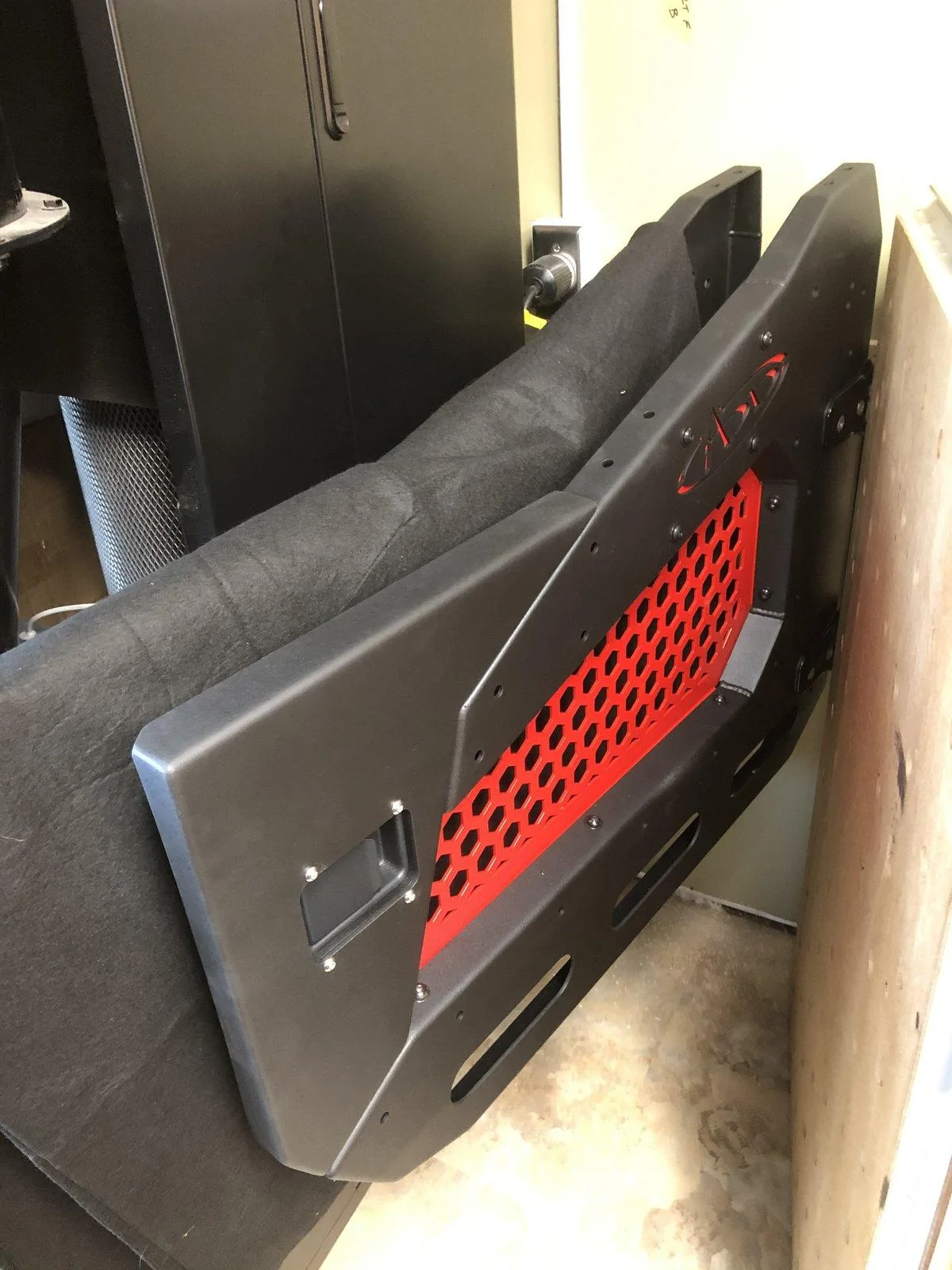

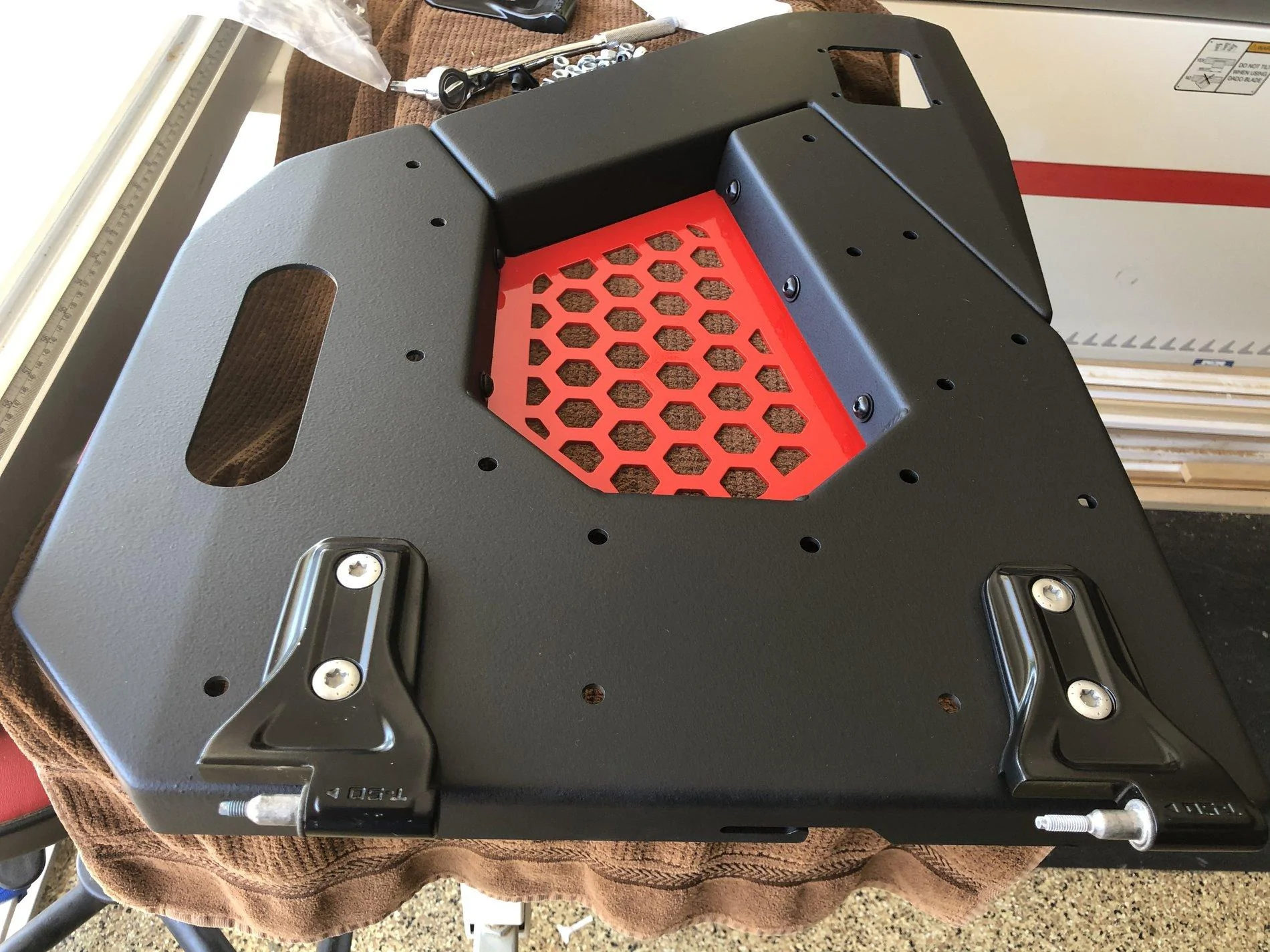

Anyway, here is a sneak peek at the ADD doors I am redoing....
Jeep Gladiator Seeing red in SoCal! Watch G.G. (Gladys the Gladiator) transform! 40AB31E6-D57E-4398-B3FE-32425ED26C10
cant wait to put them on. I also fabbed a plate to go behind their logos on the front doors which I also painted red. I think it will be pretty cool. I am REALLY anxious to get this thing dirty! Come on rock rails!!!!

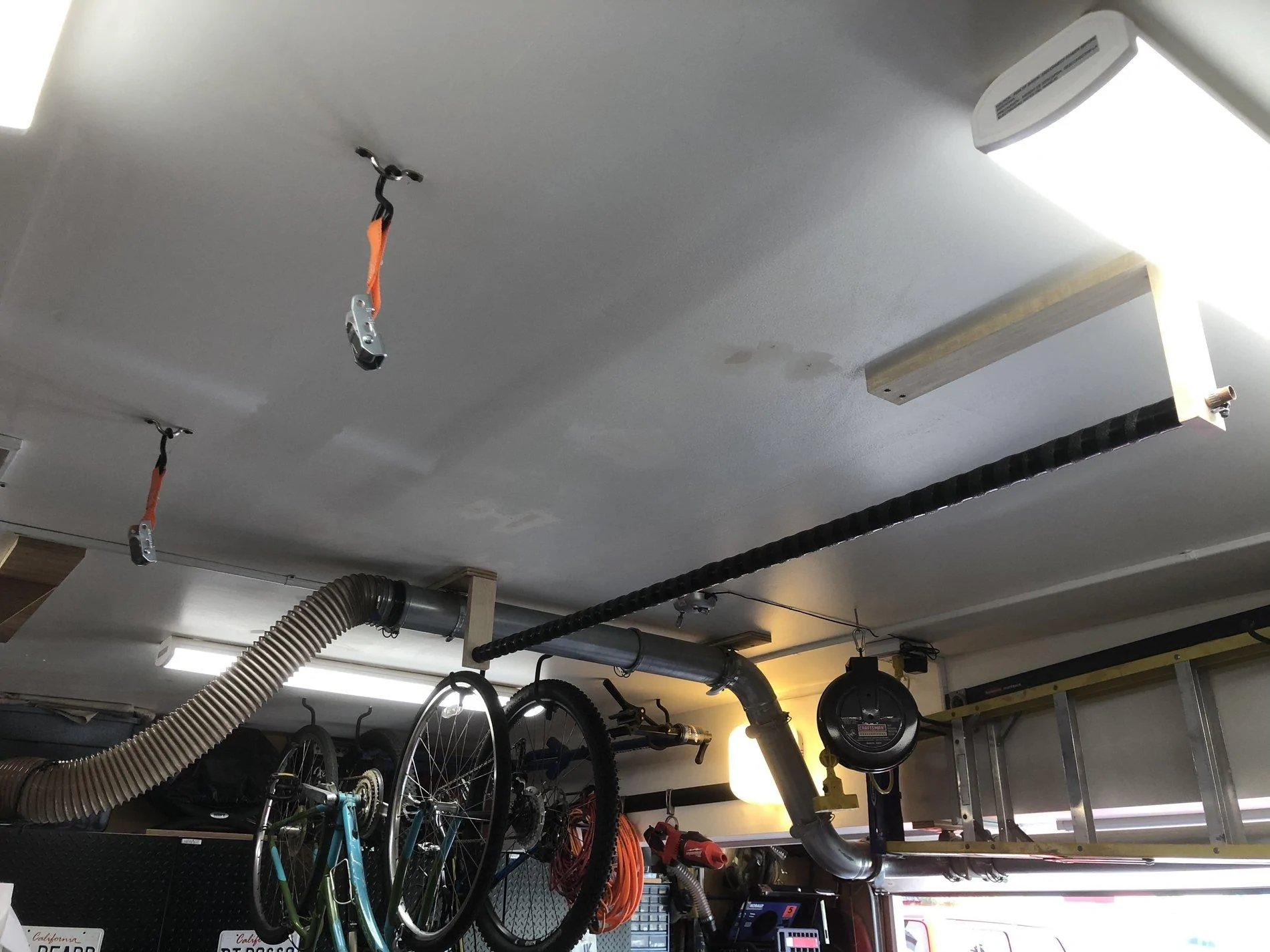

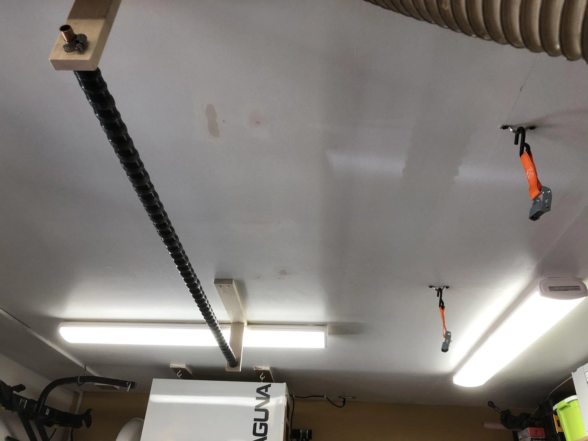

Since I am waiting on part...(JCR said my rock rails should ship by the end of next week)...I have decided to make good use of the time by setting up the storage for the top and doors. Used some door hangers (ACE Engineering) on the wall and hung some wood brackets from the ceiling to hold a 1/2” copper pipe. The tie downs will hold the back of the top. If the copper pipe isn’t strong enough I will figure out something else. I think it will work though because it will only have weight on the ends 1” from the brackets. I’ll keep you posted. Oh and here are some pics...

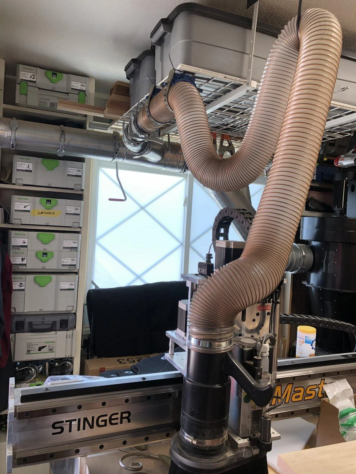

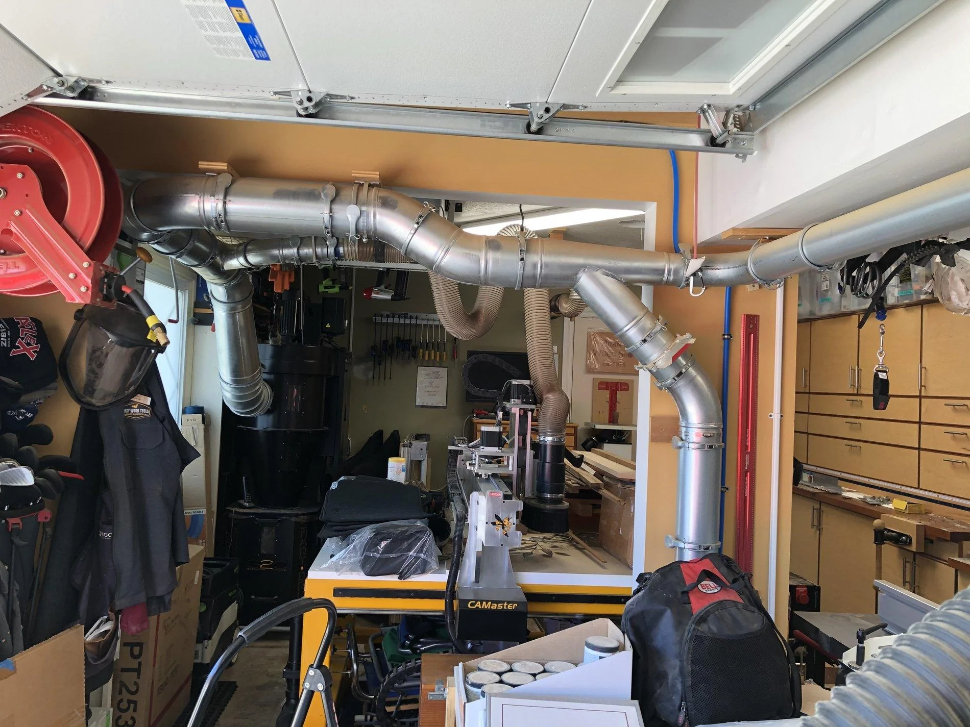

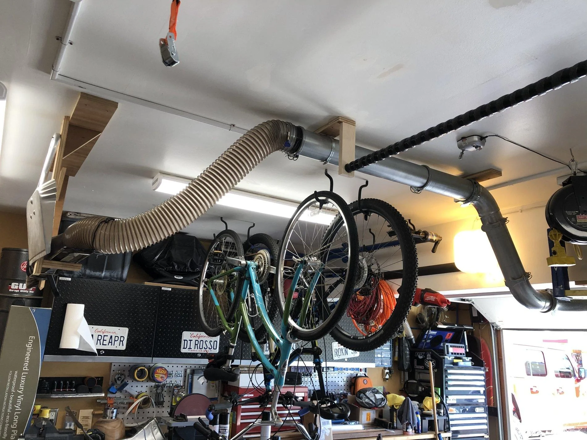

Doors are looking good. BTW, I forgot to mention, love the dust collection system!
avlamonte
avlamonte
Allan
May 17, 2020
121
154
Orange, CA
JTR

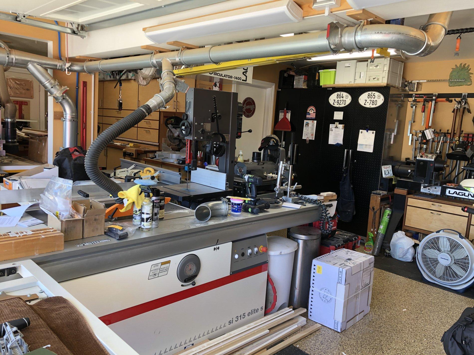

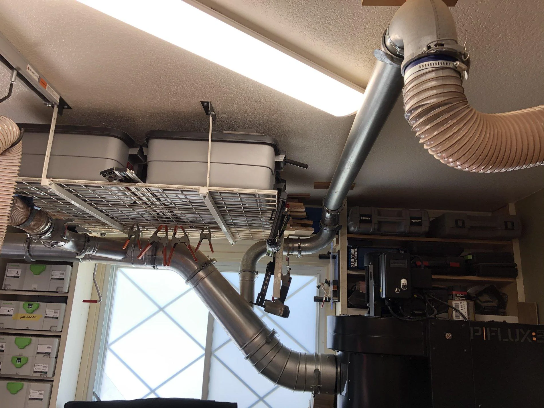

Thanks for noticing. For the rest of you who haven’t seen It...the company was great...I sent them the shop layout, locations of tools and the required size of intake and they did all the figuring for me...just a matter of connecting everything once it showed up. Here are some pics:

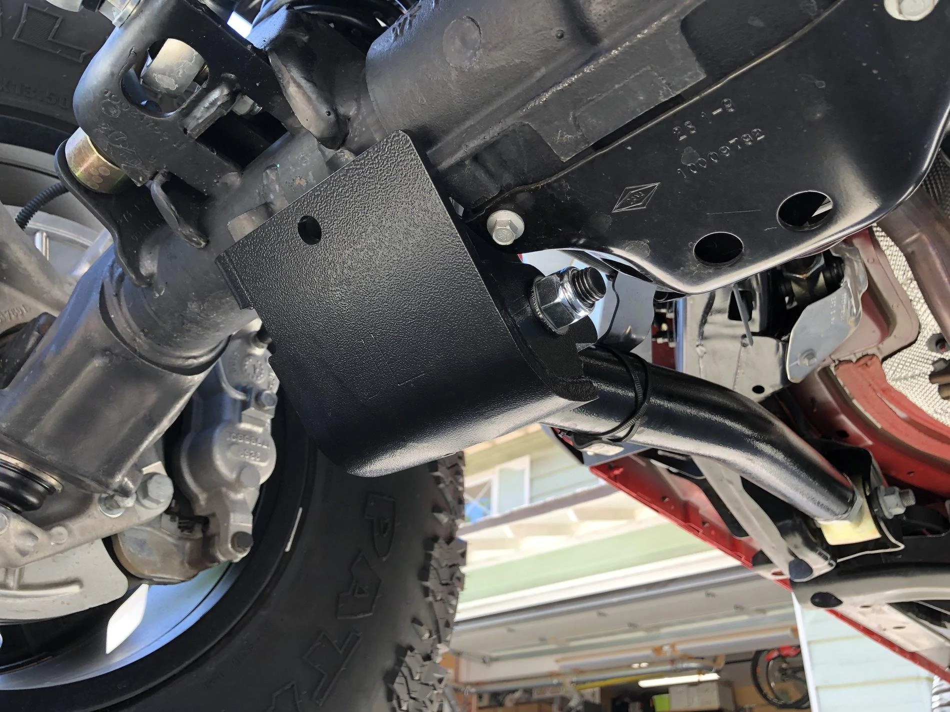

Sorry the garage is such a mess, but I have been busy working on G.G. I did install front control arm skids today...

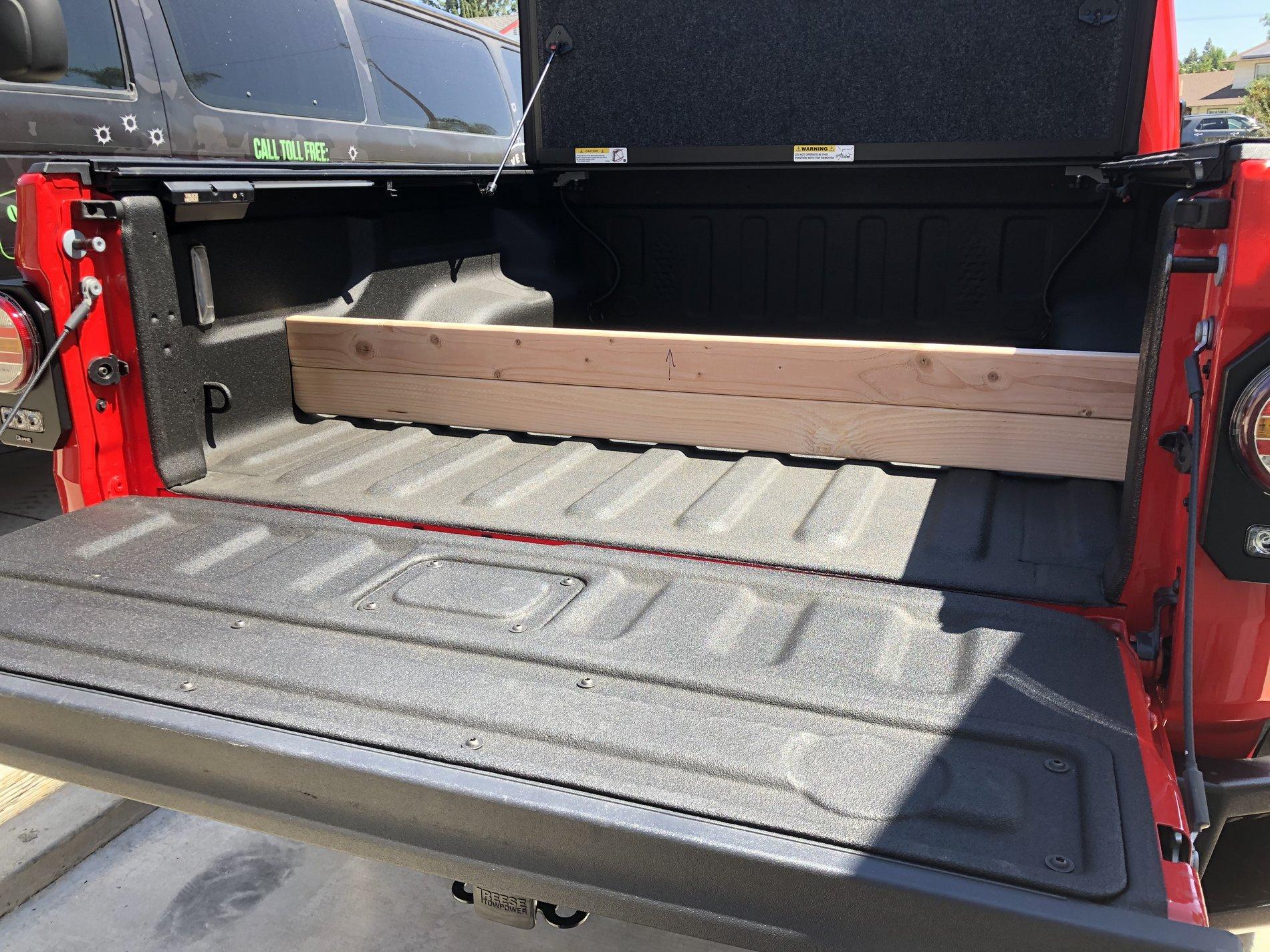

Ok. big news for today! I cut the 2x4s for part of the bed setup to carry sheets of plywood! I am a woodworker after all!
Jeep Gladiator Seeing red in SoCal! Watch G.G. (Gladys the Gladiator) transform! B07BF4A0-FF70-40F8-AB37-6C4E72C72588
Not an intuitive woodworker obviously since when I was at HD the other day I for some reason thought 2 sticks would be sufficient! It is not! :blush: Back to the store I will go for one more.
Think this setup will work great for keeping smaller things from sliding to the front of the bed as well. Bummer having to open up the tonneau cover all the way to reach those groceries that got away! PLUS, it is so rewarding to do mods that only cost $10!!!!

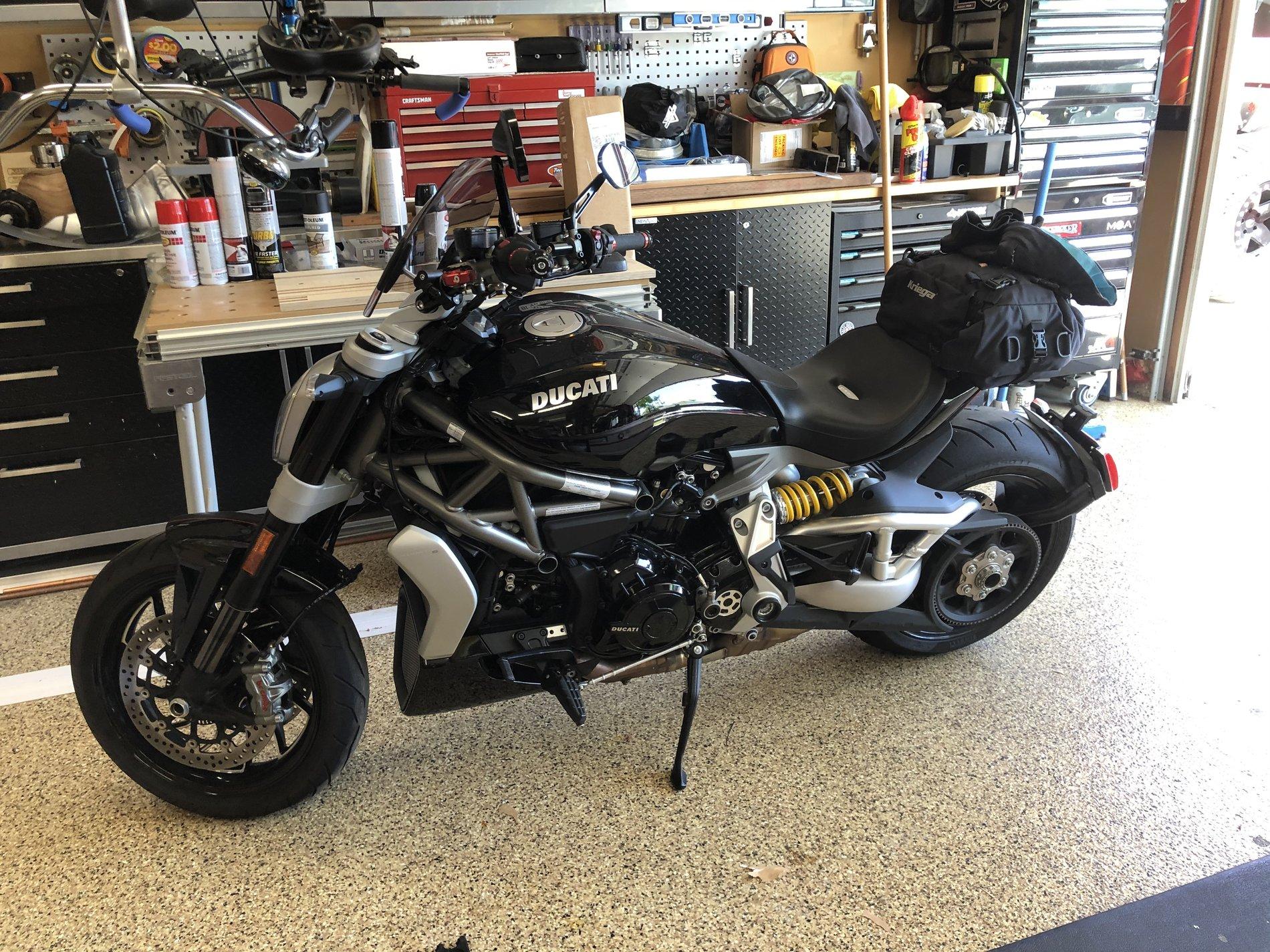

I guess I have shown you lots of pics of my go slow mistress, but none of my go fast wind in the face mistress. Here she is...
Jeep Gladiator Seeing red in SoCal! Watch G.G. (Gladys the Gladiator) transform! 75BCD0D0-F227-4DA6-BE6B-5D094E28837D
Jeep Gladiator Seeing red in SoCal! Watch G.G. (Gladys the Gladiator) transform! CB1FB6FD-AF4B-40F7-9D6F-AF5A8B0D2DBC

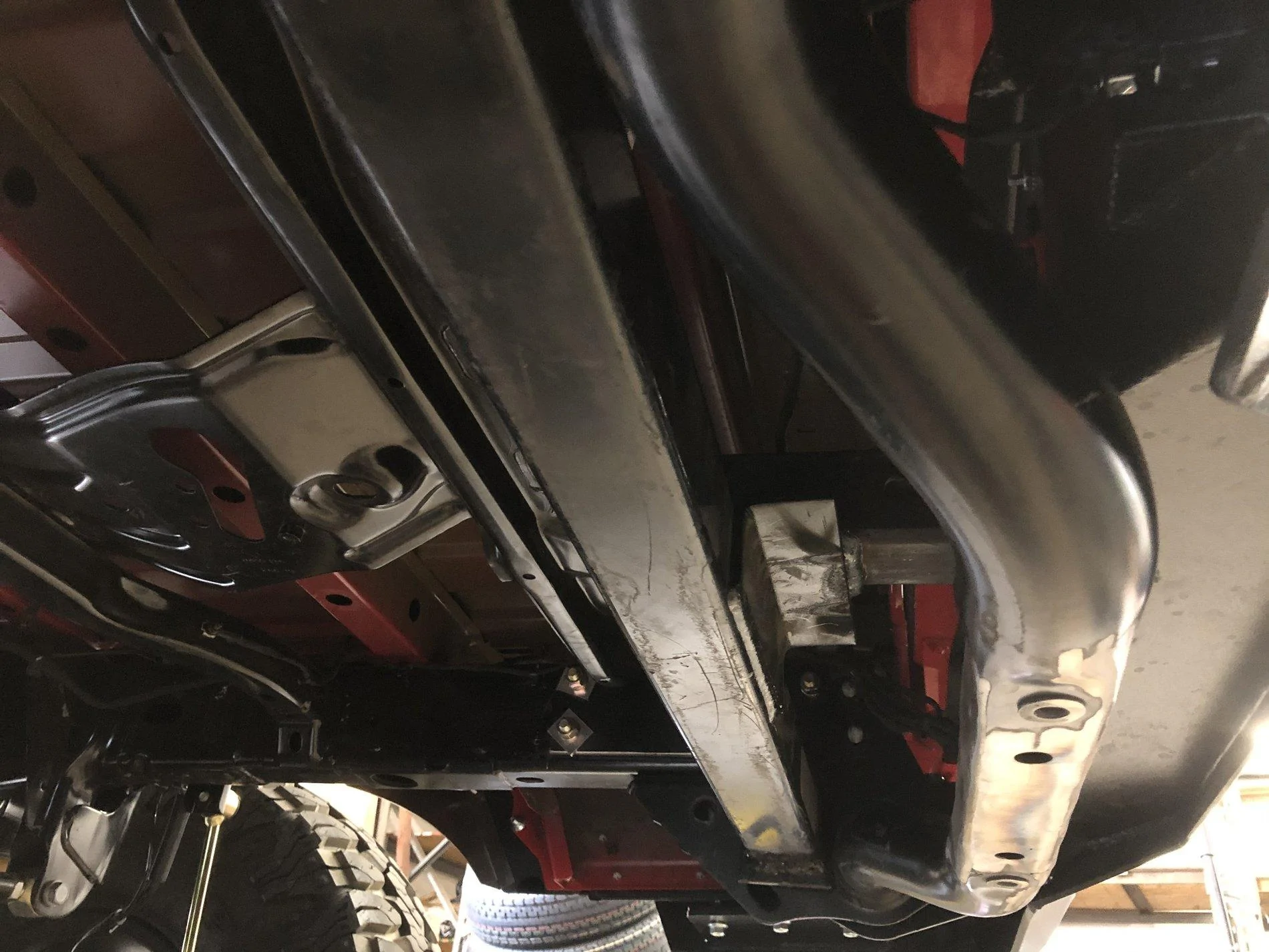

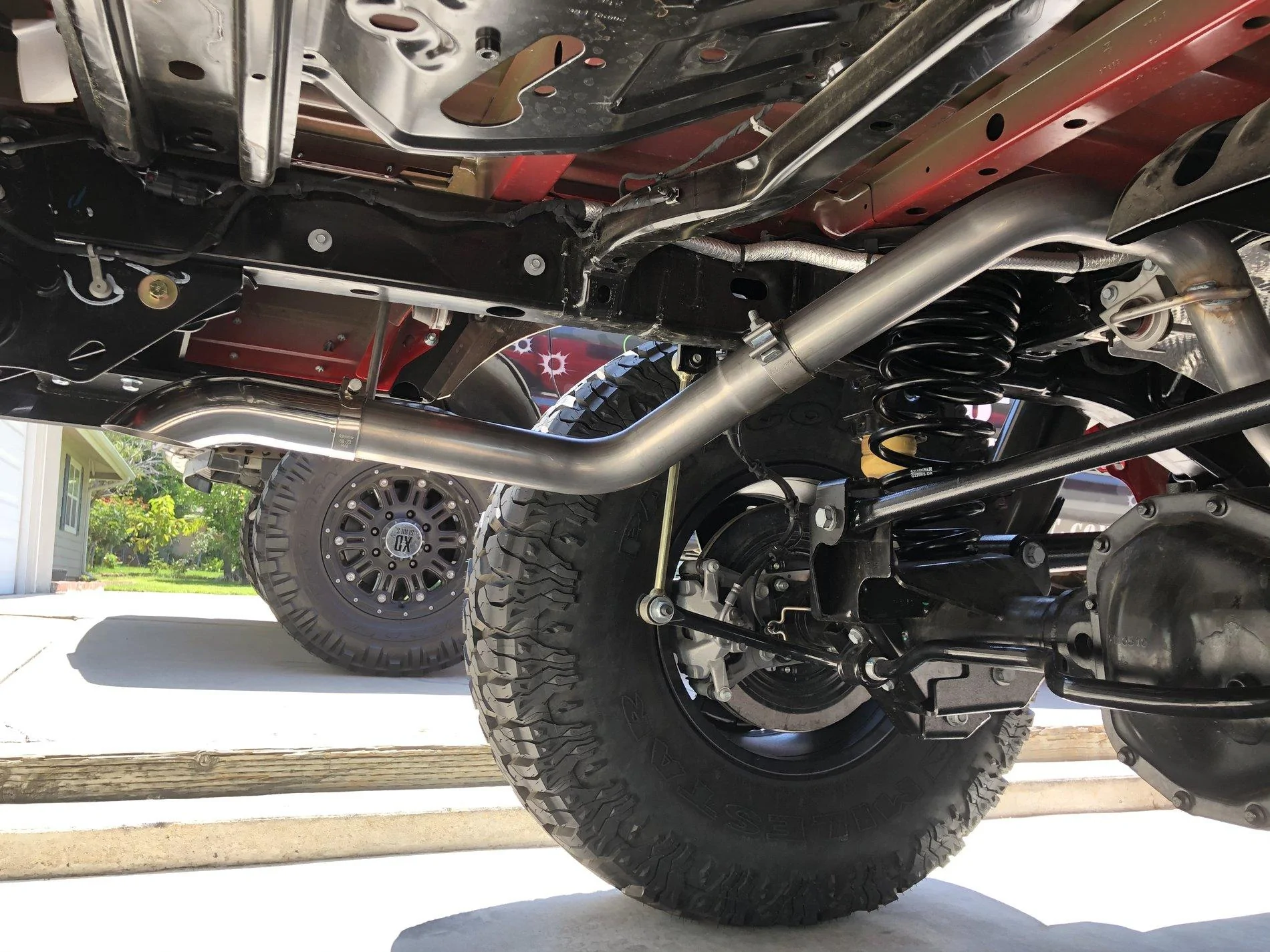

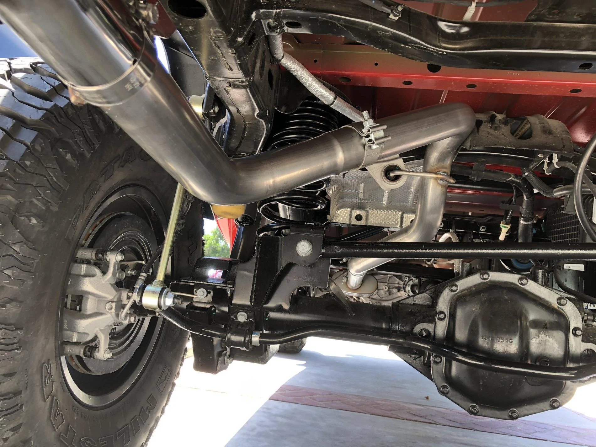

Update...I was standing in my garage wishing parts would arrive when the magic brown Santa arrived with an AFE box! Wasted no time removing the stock exhaust and installing the new one. It is tucked up much nicer.
Jeep Gladiator Seeing red in SoCal! Watch G.G. (Gladys the Gladiator) transform! 17C330B1-5C93-48F5-B298-6F73A39331C1
Jeep Gladiator Seeing red in SoCal! Watch G.G. (Gladys the Gladiator) transform! ECDBF759-FDDF-408D-8AD7-5C80D4B9393D
I am very happy with how it sounds too. Not much change at idle and it has a more aggressive note on acceleration.

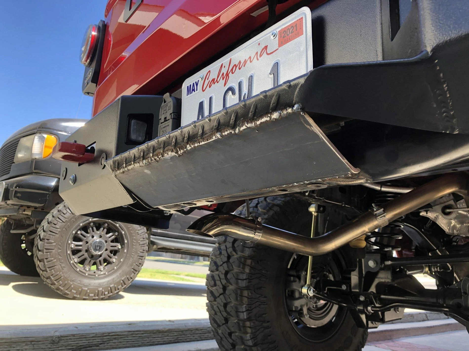

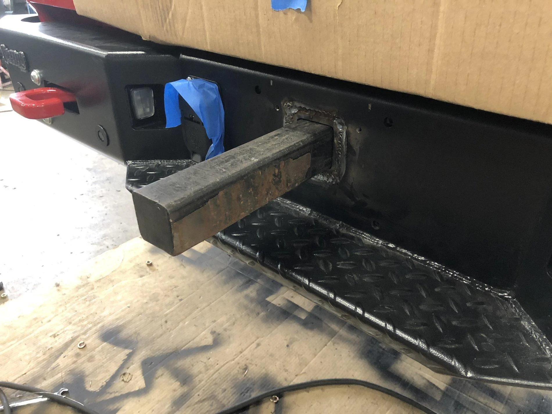

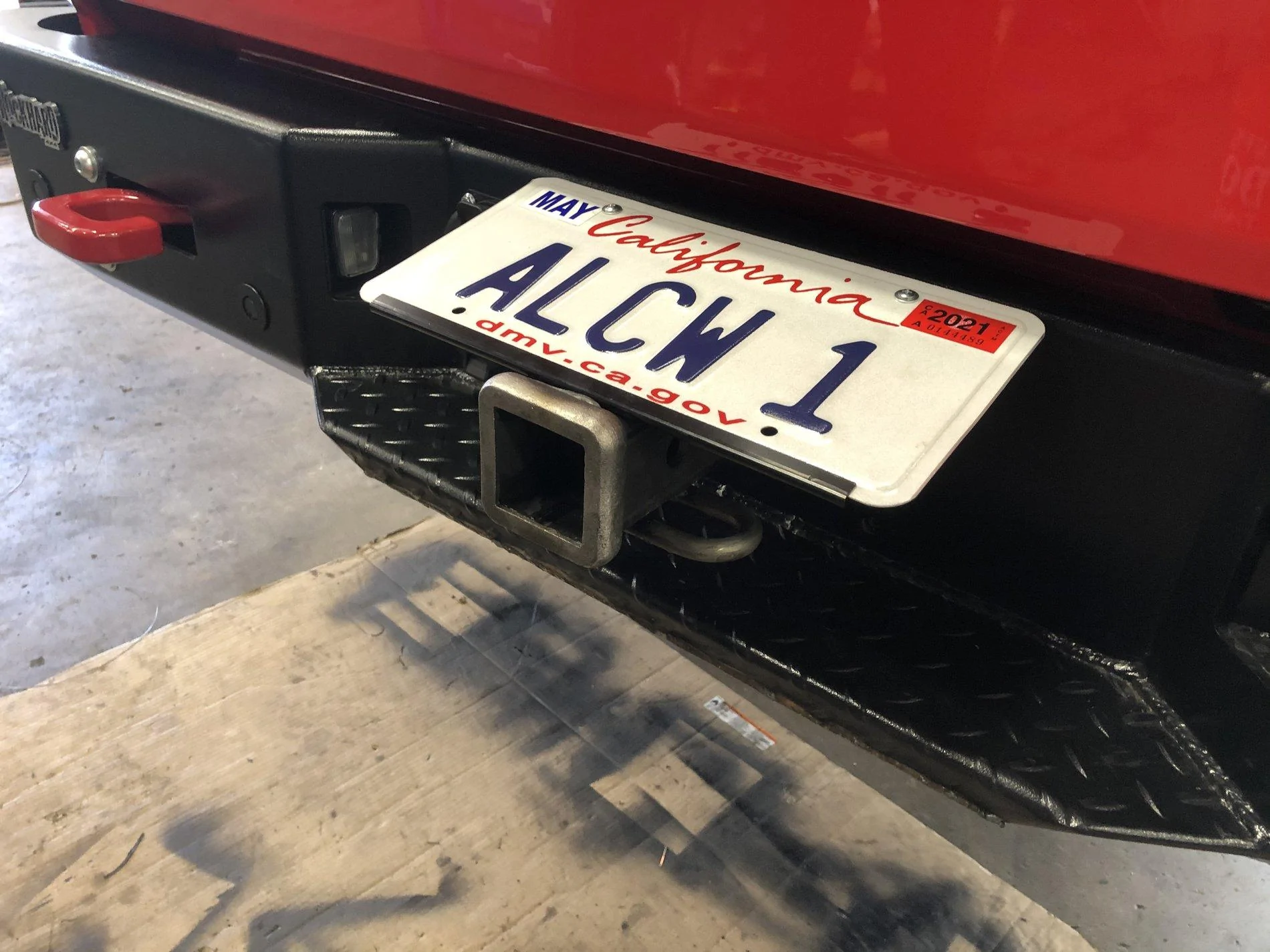

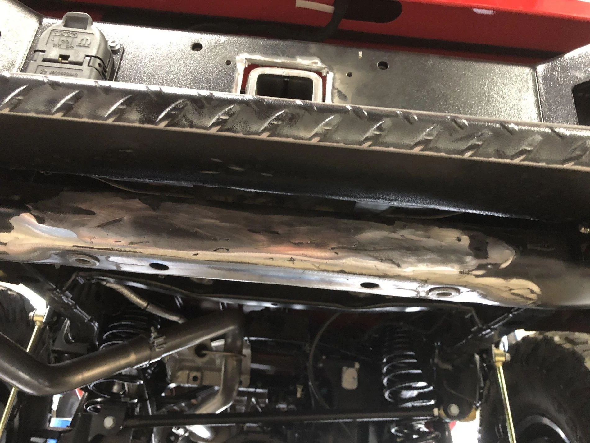

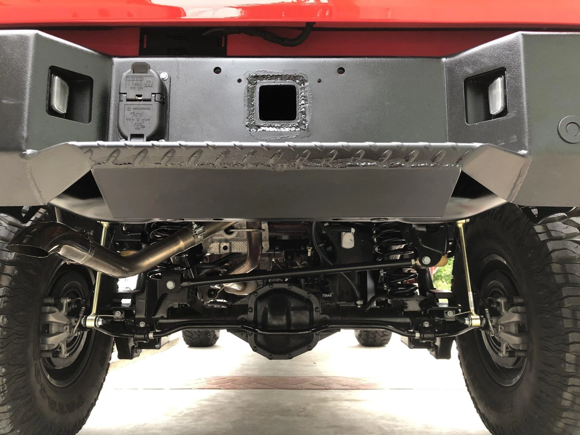

Big success today! After two and a half days at the shop I have exactly what I was hoping for...a hide-a-hitch with a skid plate between the bumper and the OEM hitch tube. Here are some details...
Here is a shot of the new hitch receiver in place:
Jeep Gladiator Seeing red in SoCal! Watch G.G. (Gladys the Gladiator) transform! 19B8F8F3-89B1-4CD8-BEA3-660ACB954AF1

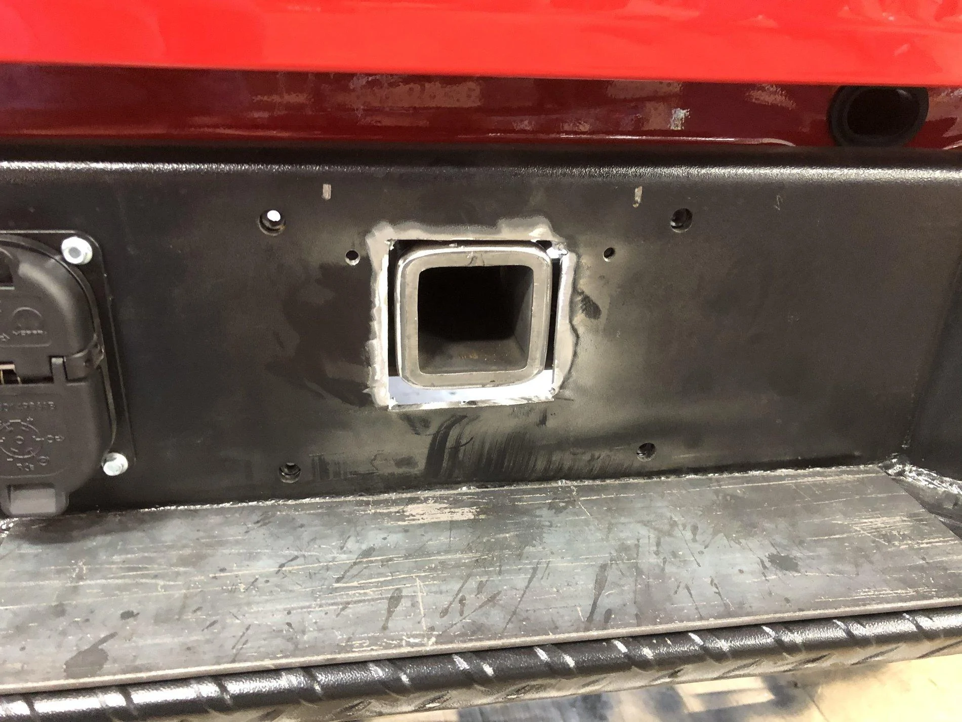

I wanted it to be flush with the 1/4” thick bumper plate and welded. I wasn’t very happy with the way the bumper was bolted to the frame and wanted to strengthen the setup.
Here is the square tube they used to create a new hitch receiver which they bolted to the frame:
Jeep Gladiator Seeing red in SoCal! Watch G.G. (Gladys the Gladiator) transform! D16AB352-B3C5-44D2-9DBC-0E580A436920
Here is a shot of the OEM tube with the hitch receiver removed:
Jeep Gladiator Seeing red in SoCal! Watch G.G. (Gladys the Gladiator) transform! F8623B96-1794-45D8-9285-C1F33BD85ED6
The next step was to weld a skid plate from the OEM tube to the bottom of the bumper:
Jeep Gladiator Seeing red in SoCal! Watch G.G. (Gladys the Gladiator) transform! 6ED1D2A1-F644-4B13-8AE5-82A1BA290EC6
They also made me a custom receiver extension which brings it out so a standard hitch can be used. The following pic shows the solid 2” square that started the extension construction:
Jeep Gladiator Seeing red in SoCal! Watch G.G. (Gladys the Gladiator) transform! D150E616-68B6-42DC-88A4-06166390D4A6
Here it is all welded up and ready for painting. As you can see, they put the chain loops on the extension so I won’t have to reach under the truck to attach them. This thing is stout:
Jeep Gladiator Seeing red in SoCal! Watch G.G. (Gladys the Gladiator) transform! D7EFB722-D618-454F-B0EE-29CD07A4B6D6
I am not affiliated with the company and did not receive a discount for this write up. I am just happy to spread the word about a job well done. If you are in SoCal and need a good hitch shop this is their info:
Orange Trailer Hitch and Repair
(714) 288-8782
Patric is a great guy who is determined to please his customers.
avlamonte
avlamonte
Allan
May 17, 2020
121
154
Orange, CA
JTR

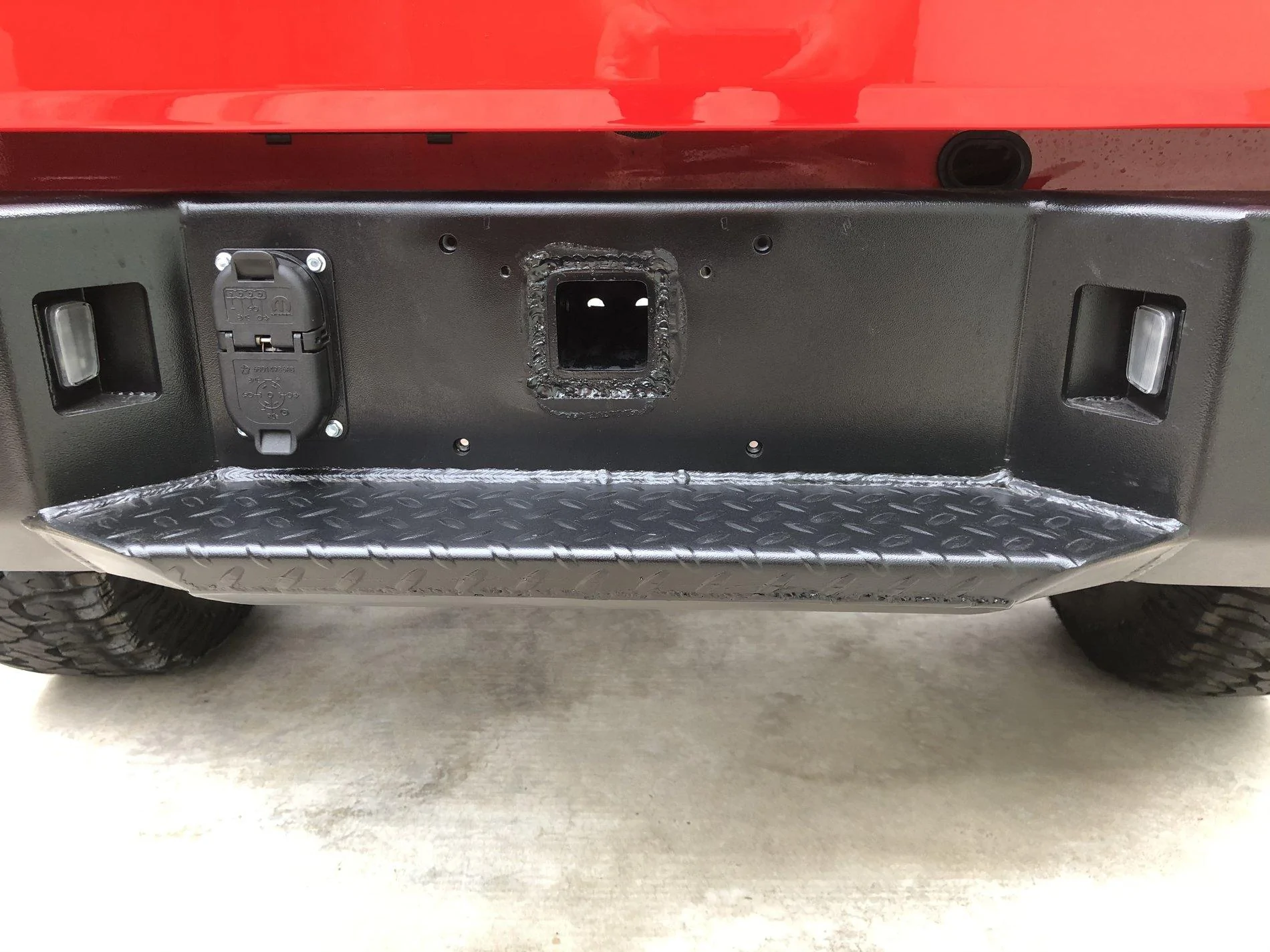

Well I cleaned up the welds a little and painted everything with semi-gloss. Very happy with the results....
Jeep Gladiator Seeing red in SoCal! Watch G.G. (Gladys the Gladiator) transform! 2A605BF2-E8BB-4884-AAEB-A5D91DBBE0D4
Jeep Gladiator Seeing red in SoCal! Watch G.G. (Gladys the Gladiator) transform! EB3AAFA8-4428-4D60-8F81-4A81F9E3A5C2

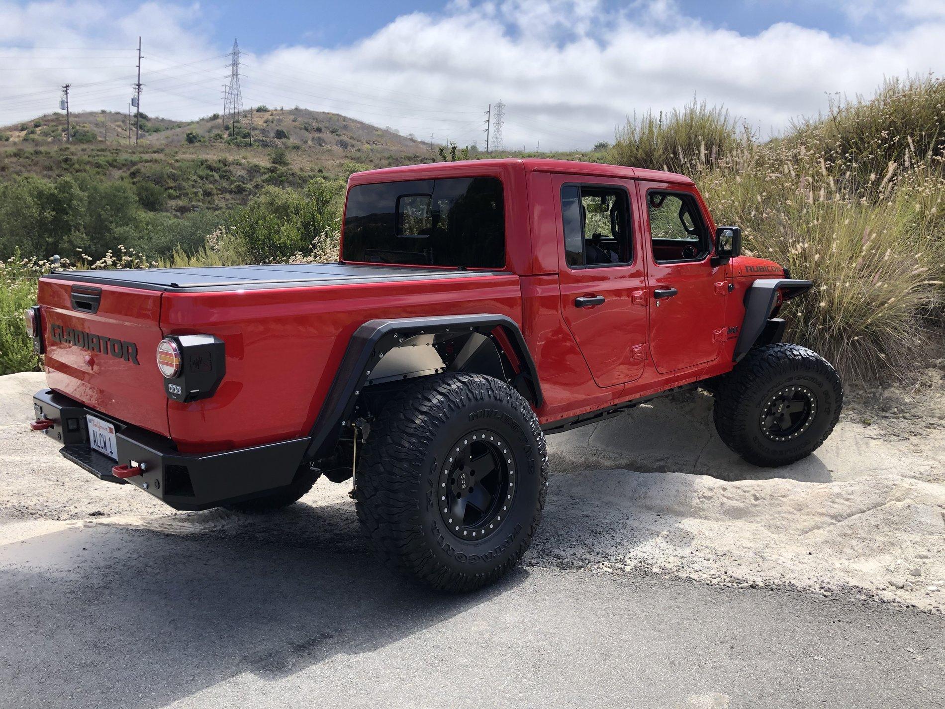

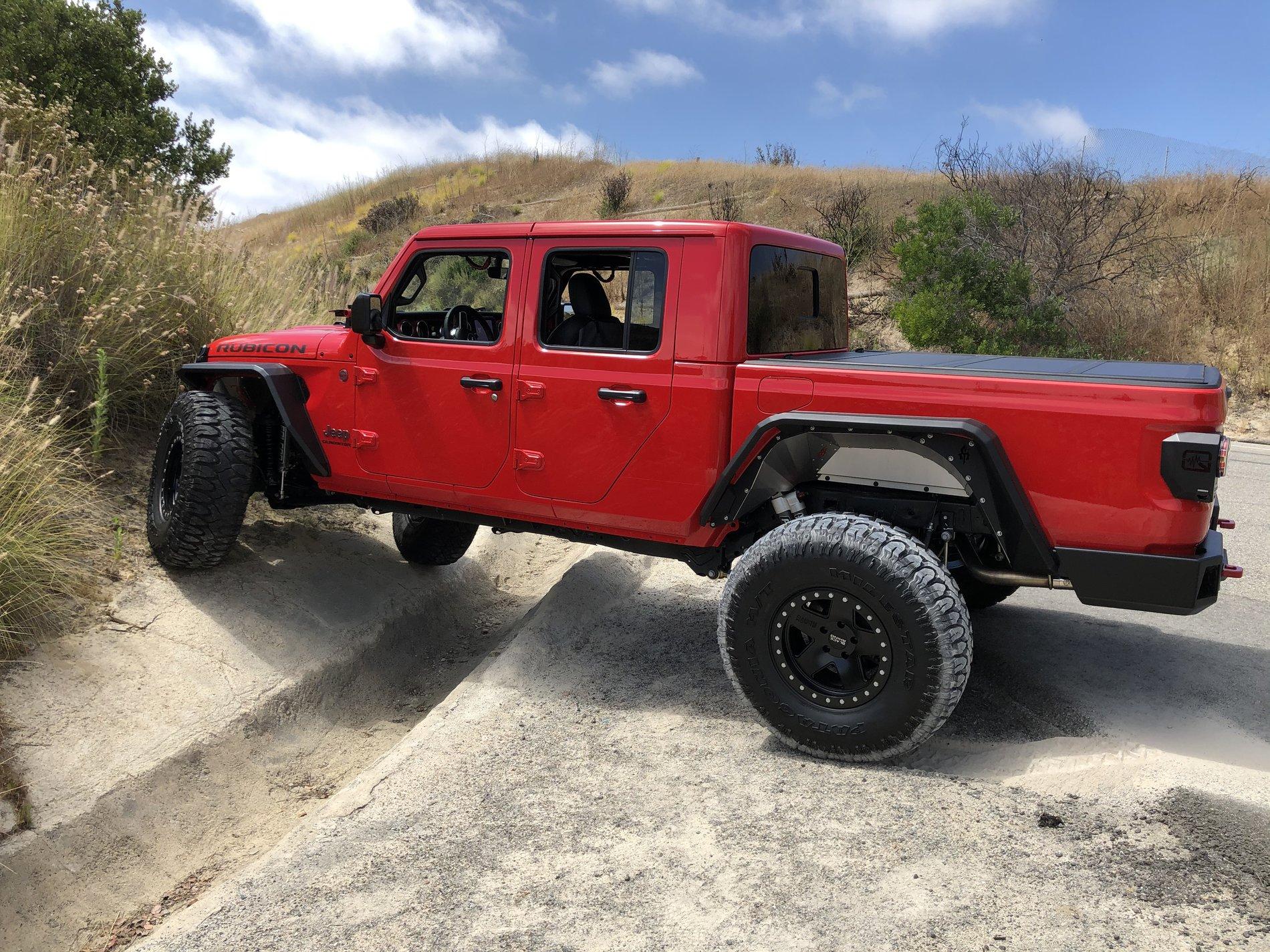

Oh...and I flexed her out a little yesterday to make sure the brake lines were long enough and no rubbing. Everything went great...
Jeep Gladiator Seeing red in SoCal! Watch G.G. (Gladys the Gladiator) transform! D041E947-4F6B-49EA-A6EF-3088842452B6
Jeep Gladiator Seeing red in SoCal! Watch G.G. (Gladys the Gladiator) transform! 873B4CBC-9AE8-40BC-81AC-4BA2AEB3499D
I was under the impression that the safety chain loops needed to be on a permanent mounted part of the hitch, not an extension. In case of a failure in the connection between the receiver and extension? Chances of that failure are probably very minimal, but I could be wrong about the requirement.
I love the fact that there is nothing hanging below the bumper and the filler-skid plate helps prevent your bumper edge from being snagged. :like:
