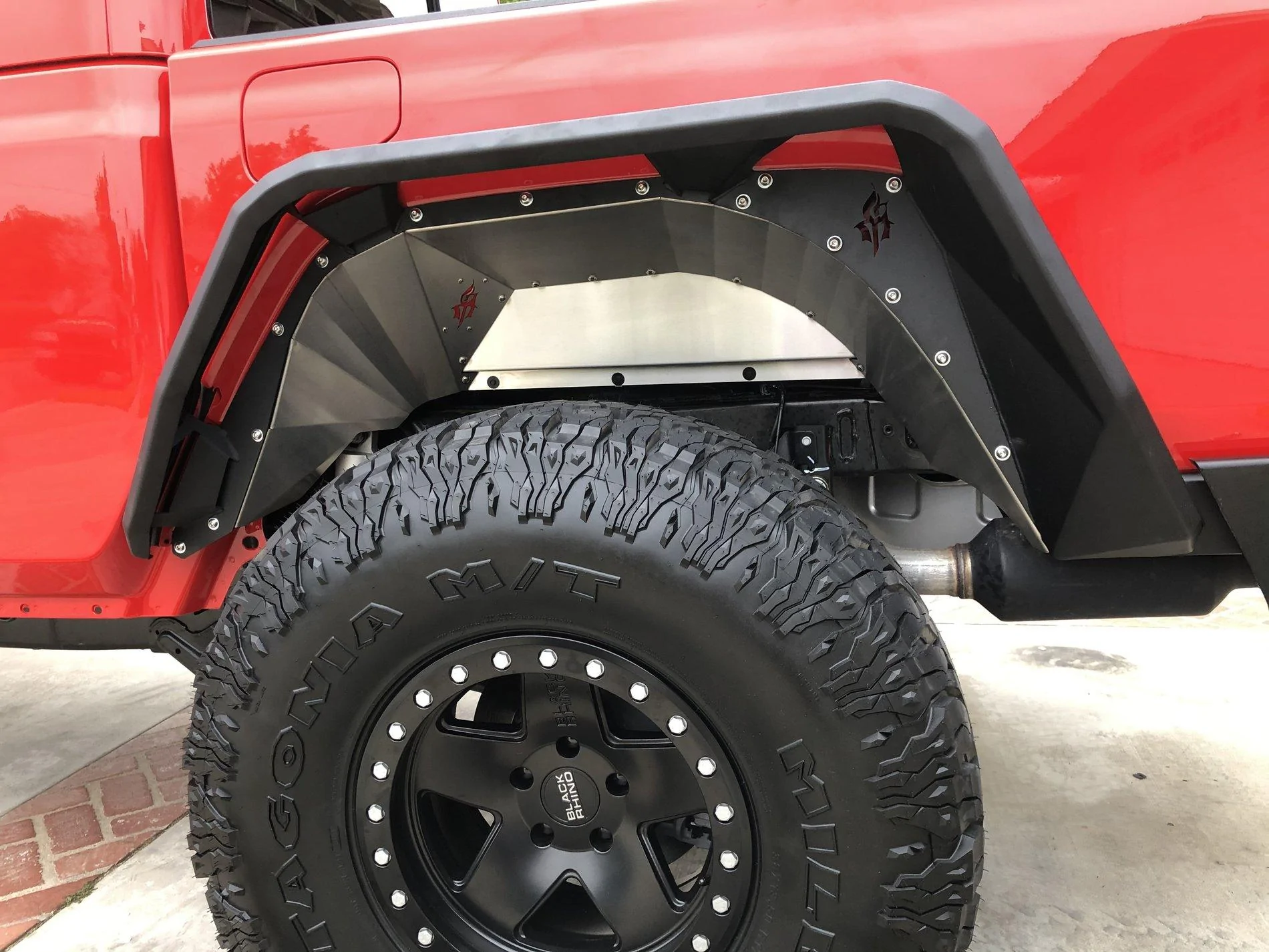

Soooo...got 4 huge boxes from Road Armor yesterday! I have been so anxious to get these. One down....3 to go...
Jeep Gladiator Seeing red in SoCal! Watch G.G. (Gladys the Gladiator) transform! E4E6EEB7-ED51-481F-8661-375112748F0F
install is a little challenging for these reasons:
1) as always instructions were incomplete and hard to follow...go figure.
2) could not be installed around the Falcon 3.3 shocks. Had to unbolt they bottom of the shock and rotate it forward to get the liner in its spot. The design of the liner is such that I will need to remove it to remove the shock if necessary. Bummer!
3) the Rock Hard rear bumper wrap around was too long and interfered with the fender install. I opted to cut the bumper to make room. Not too bad and I was able to do it on the vehicle.
4) there is a sheet of SS that is not needed if you are doing fenders and liners. That created a headache since it doesn’t tell you that!
I really like the contrast of the stainless steel in the wheel wells. Some may not, but it is my rig and I’ll do what I want! LOL.:rock:
Other than those things, I am super stoked on how they look. I am sure more things will come up when I do the fronts. Right rear is almost done too...

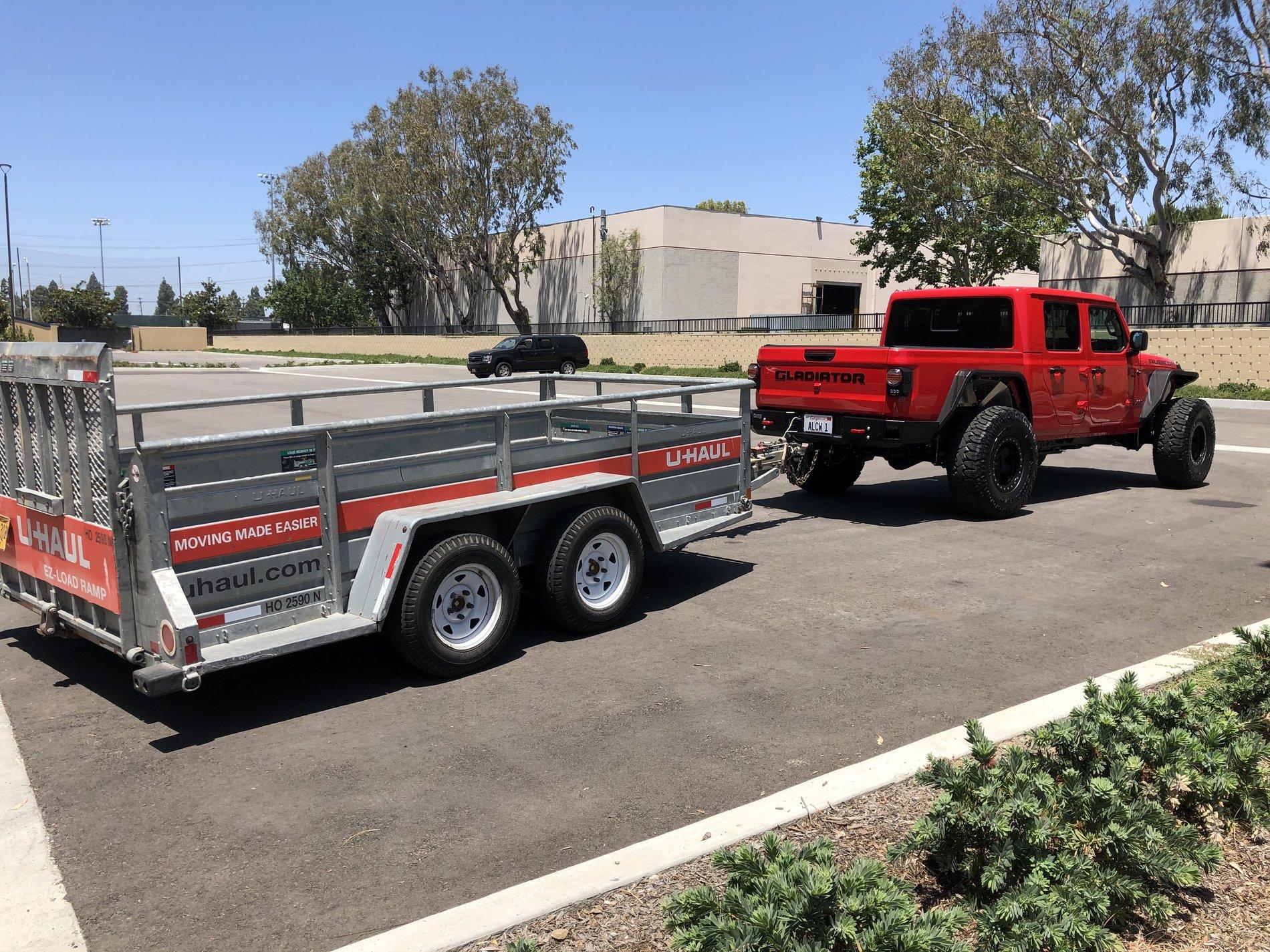

Not a build update, but used her as a truck again today...even with the trailer fully loaded couldn't even tell it was back there. Super stoked!

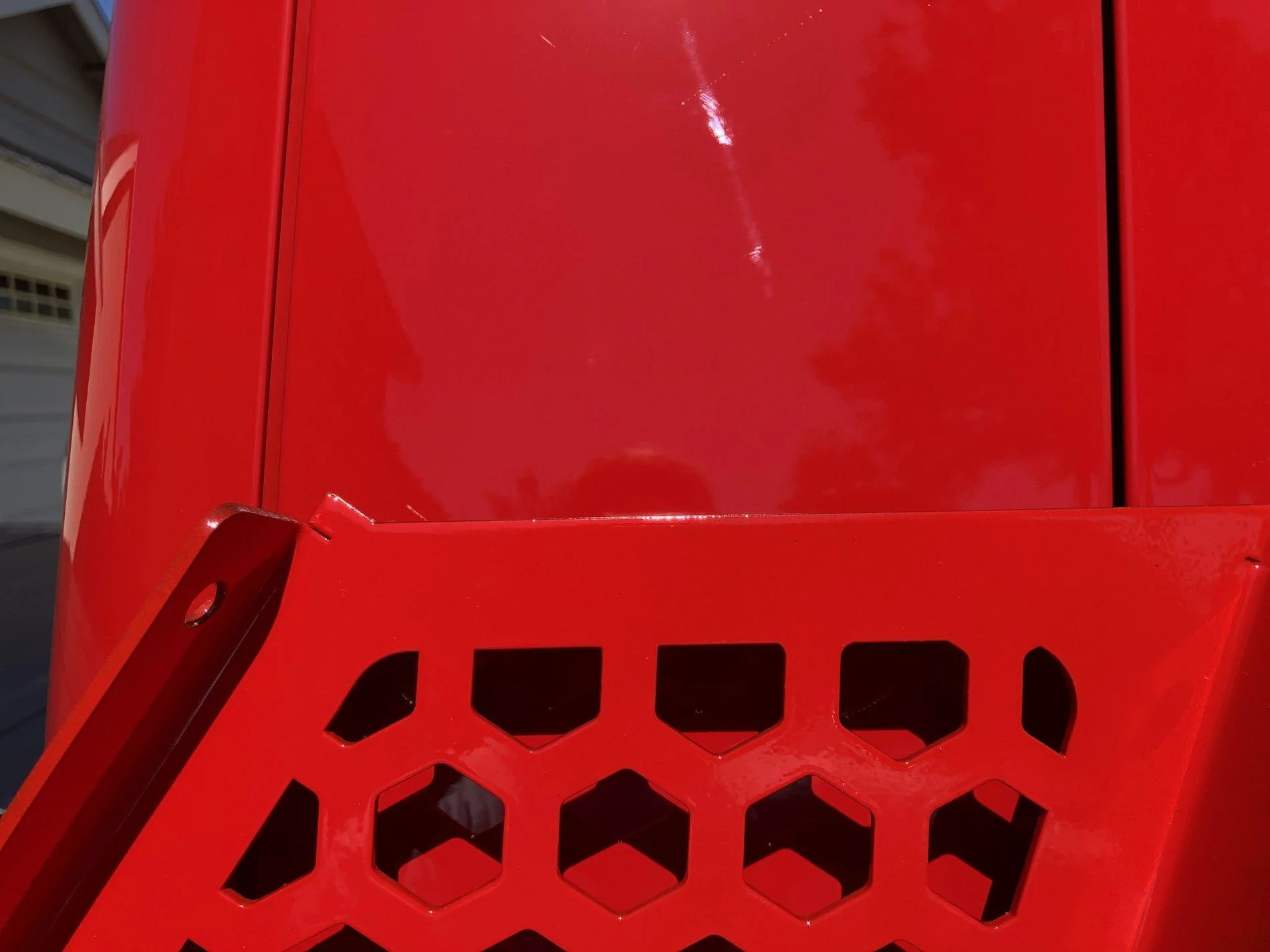

Just FYI, I found out that the Rustoleum Gloss Protective Enamel in the color Cherry Gloss is a great match to the Firecracker Red on my JTR! Here is a comparison photo in direct sunlight. I wouldn’t use it for body correction, but for little accents where it isn’t right next to body panels it rocks.

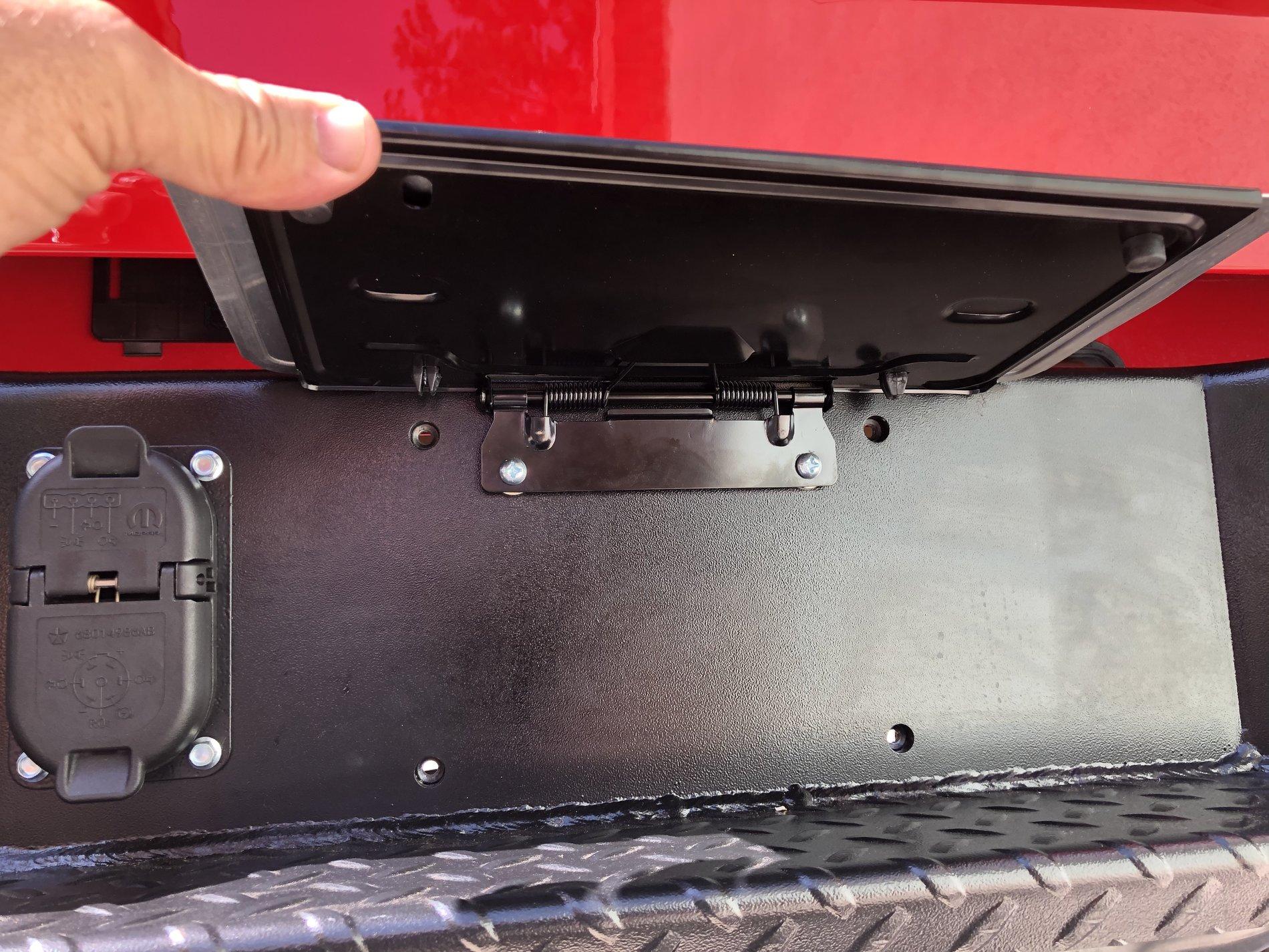

Oh...I added the fold up license plate bracket.
Jeep Gladiator Seeing red in SoCal! Watch G.G. (Gladys the Gladiator) transform! FF962ACD-CE19-431B-A0D5-793AB2CE2846
Jeep Gladiator Seeing red in SoCal! Watch G.G. (Gladys the Gladiator) transform! D27A1C1F-0865-4247-94DA-431C9F8D14E3
When it is folded up it is just a hair over the height of the bumper. It will work with the tailgate folder down no problem. :like:
