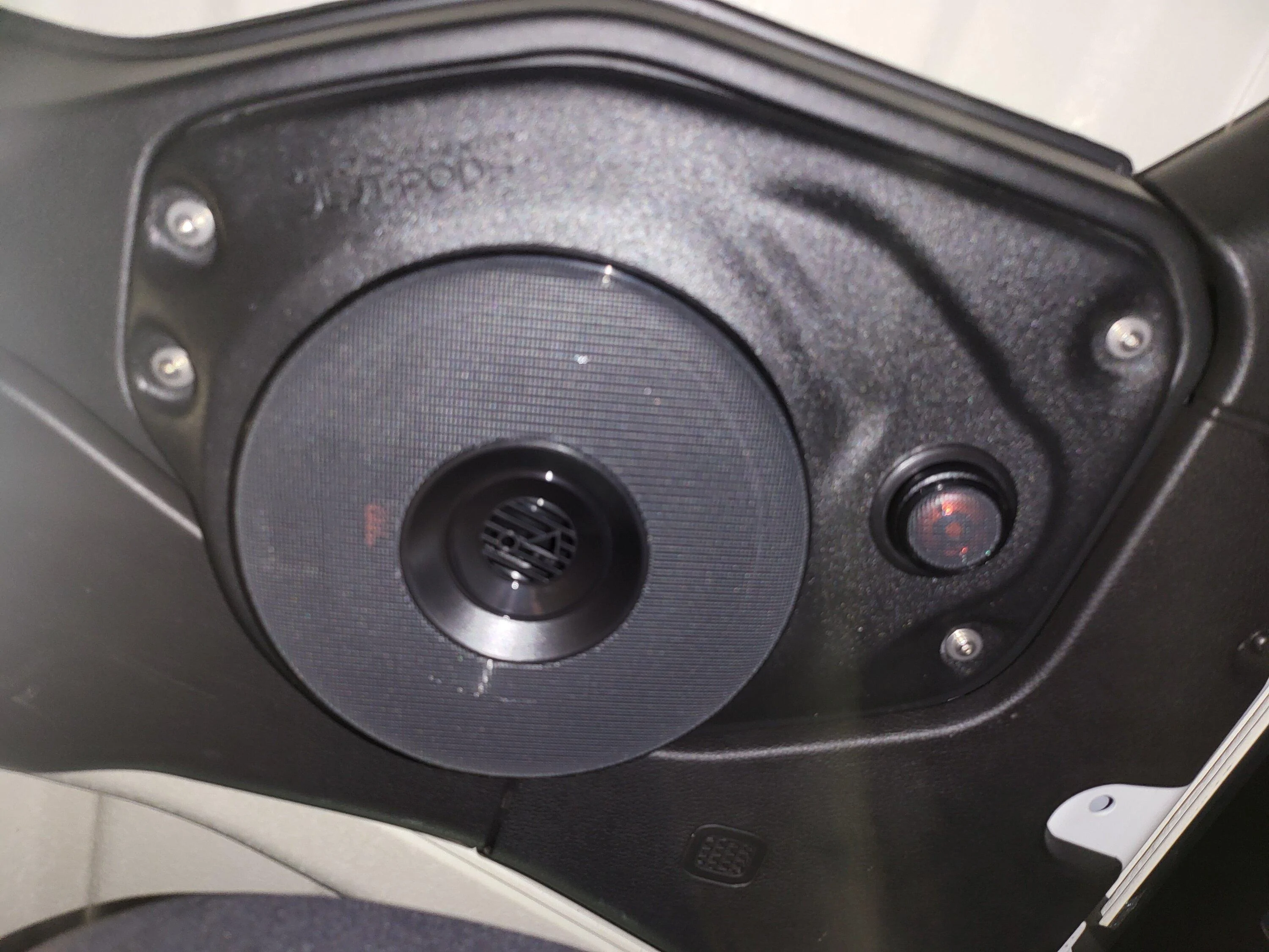

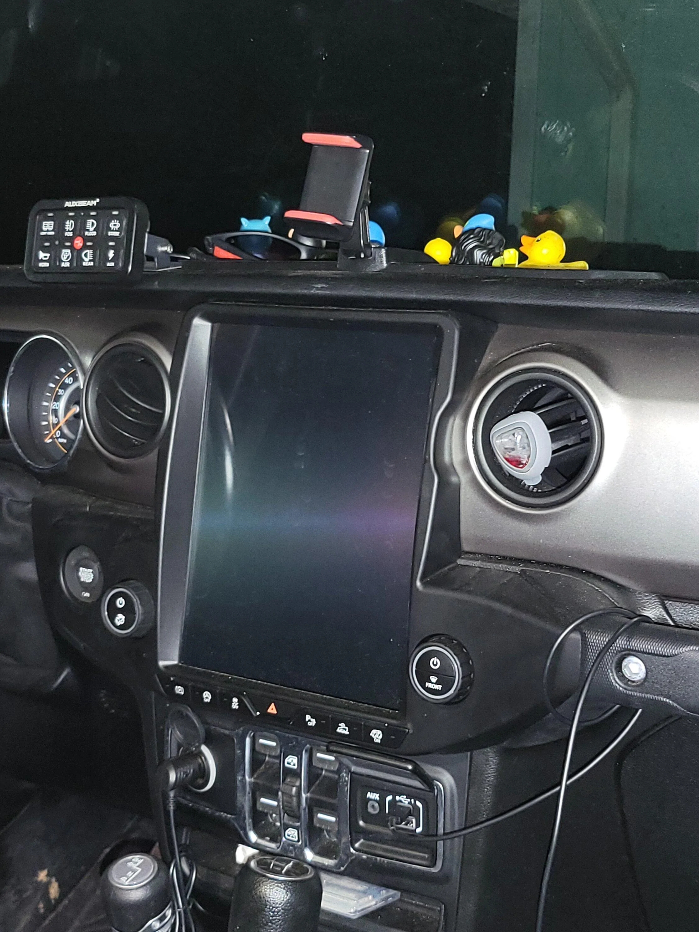

Thanks for the reply. I ended up getting the the pod kit for alpine stereo, since it comes with both sets of harnesses (used 3.5" harness up front and 4" for pods). Got a pair of jbl club 322f for dash and 602c components for pods via Amazon... waaay better pricing vs crutch (99 vs 210 for components!). Both sets of speakers went in no problem, no cutting. Crossover box fit nicely after oe speakers removed. And the sound is MUCH better now, especially with Phoenix automotive 12.1" android head unit. Much more bass with good clean sound and extra volume
Holding off on subs it's that good for now. This setup is perfect for most, unless ur an audiofile.
