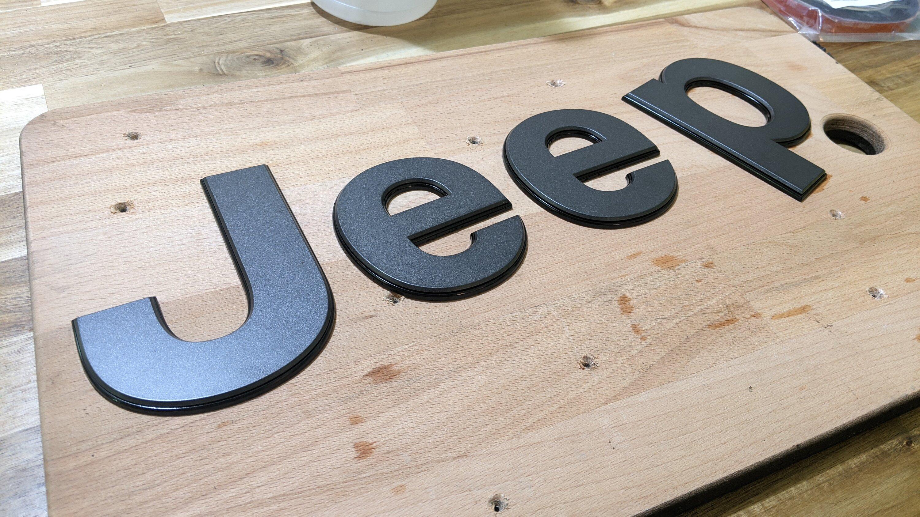

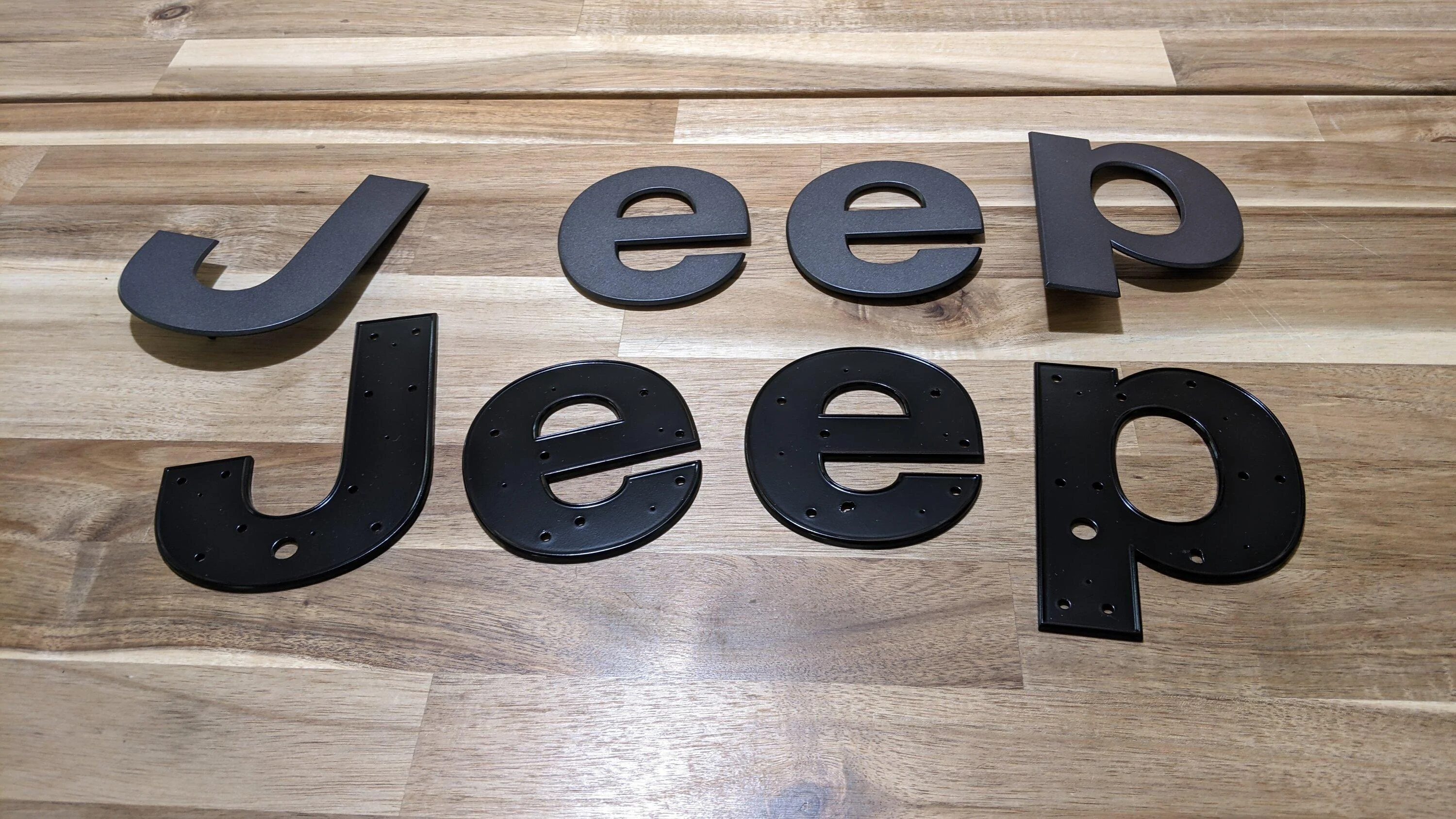

I've seen a couple people ask and some write ups already. The tailgate letters are two piece. They're not snap together, they have pins that are pushed through and melted on the back side. I used a 13/64 bit (not exact) to just take a bit of the plastic off the larger pins and the letters pop apart easy. No hard prying, bending, risking breaking or deforming. Just a minute with a drill.
Just thought I'd show how easy this process can be. No need to mar them up or spend $75+ on replacements if you're planning on changing up the colors.

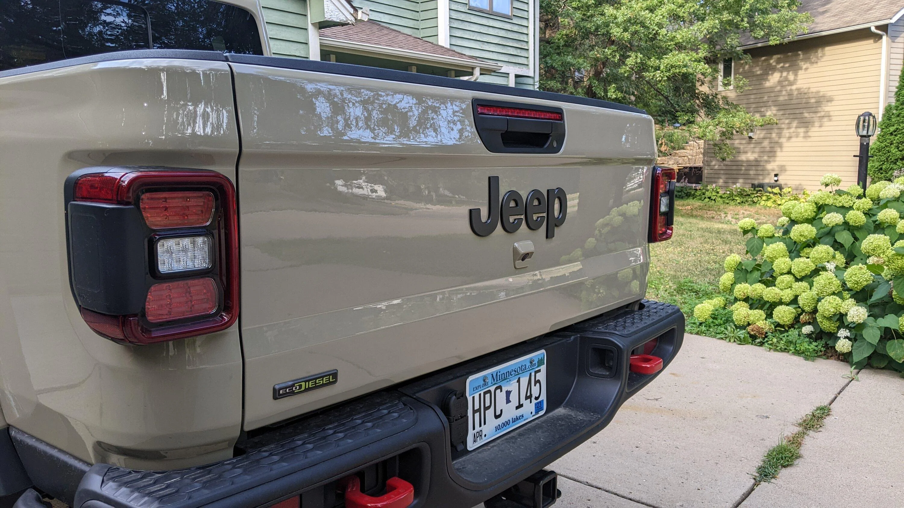

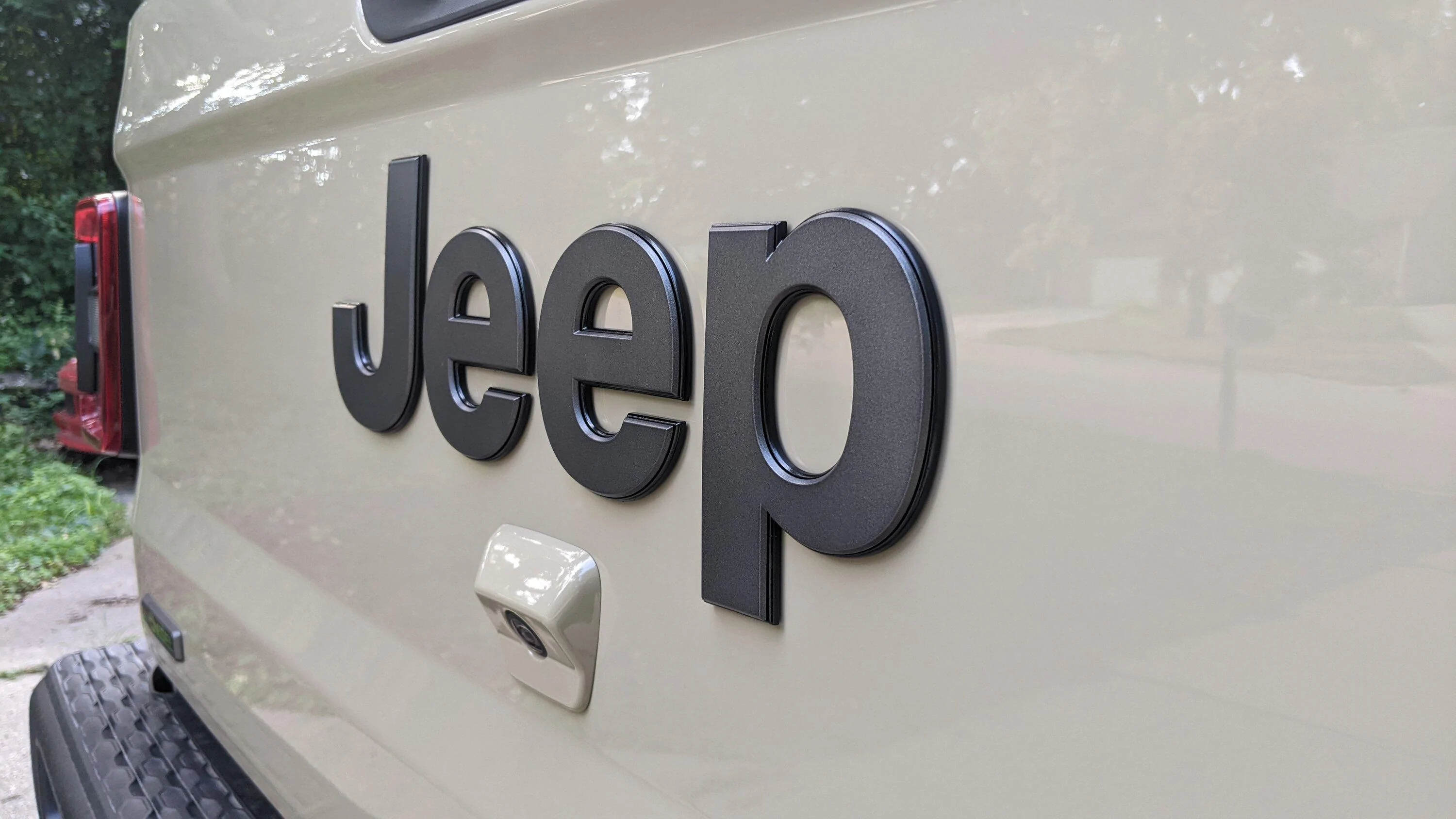

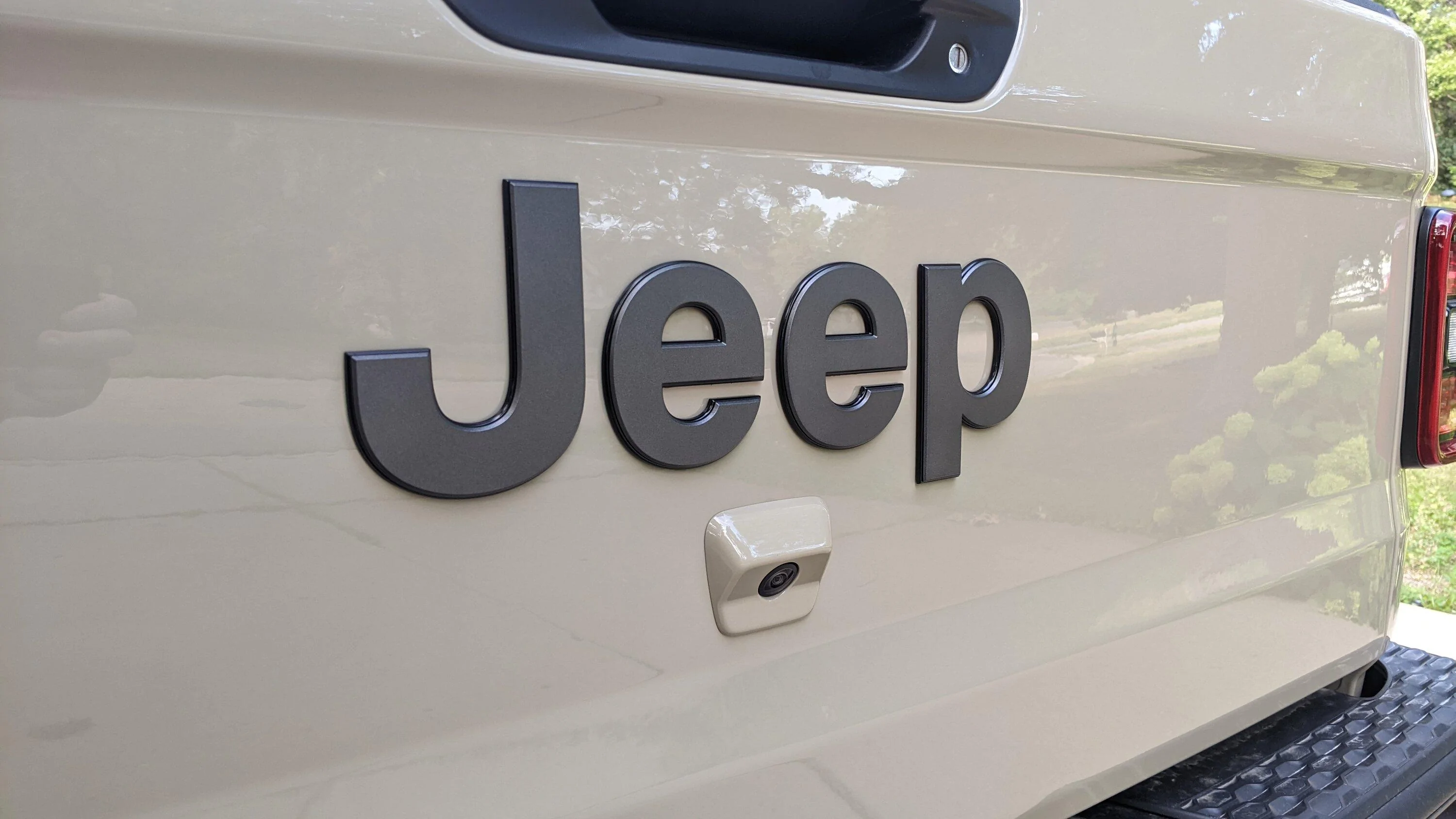

Just finished putting them back on. Results:

They did snap back together somewhat, but I wouldn't trust that on it's own. I used a few small dabs of Loctite super glue between each one. Probably irreversible at this point, if I wanted to change them up again I'd probably need to buy a new set.
To adhere to the tailgate I used 3M VHB.
