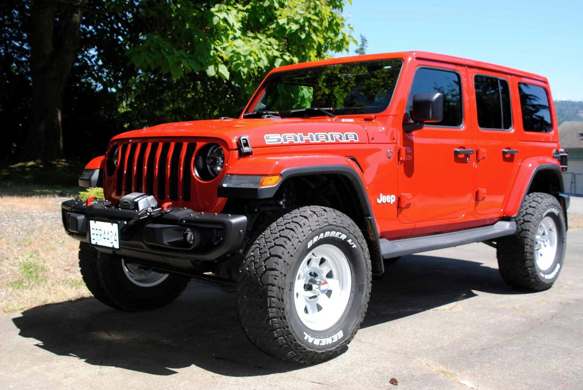

I have a Sahara with the Mopar lift and 35s. I think I can fit 36s, but not 37s.

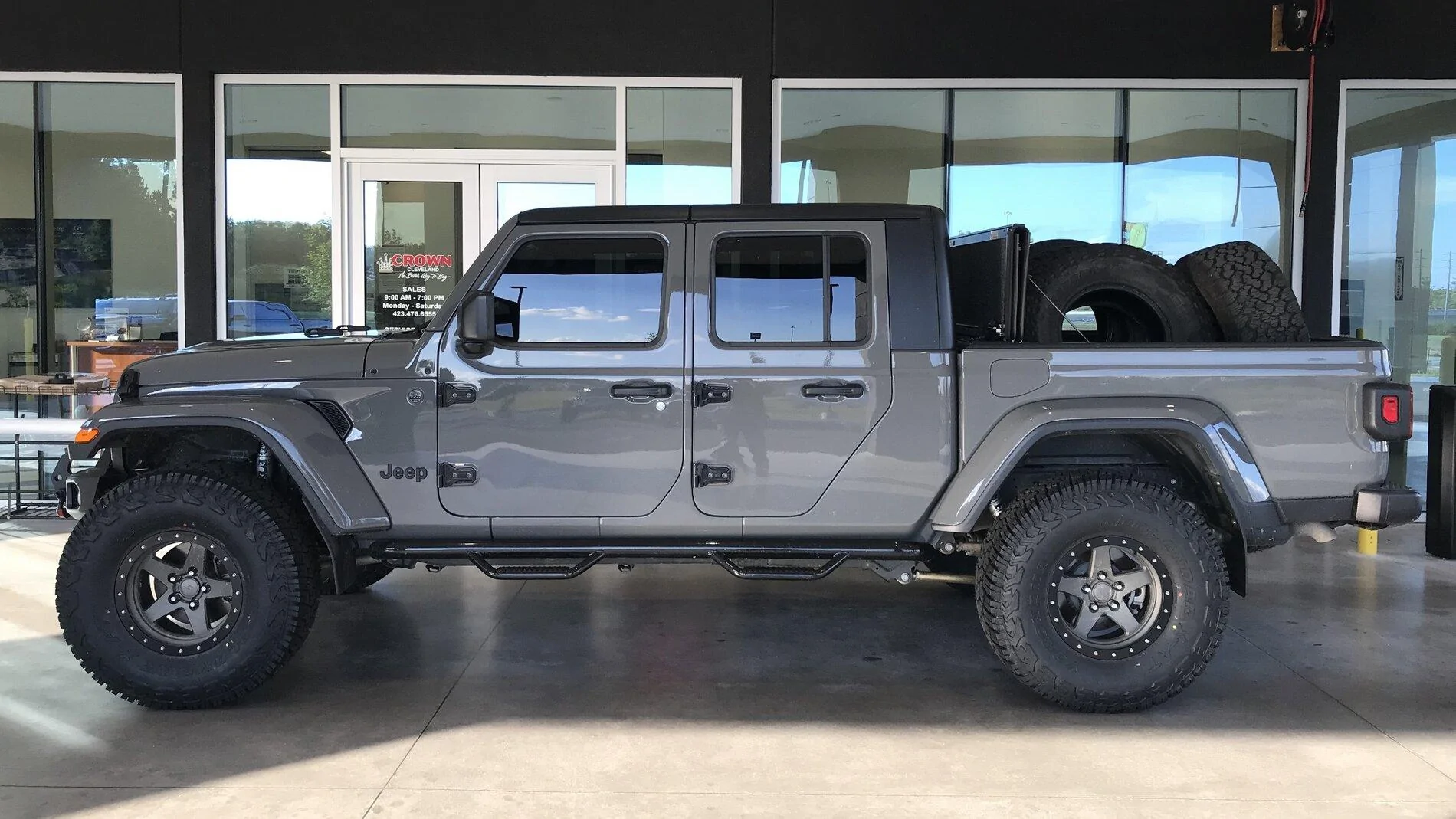

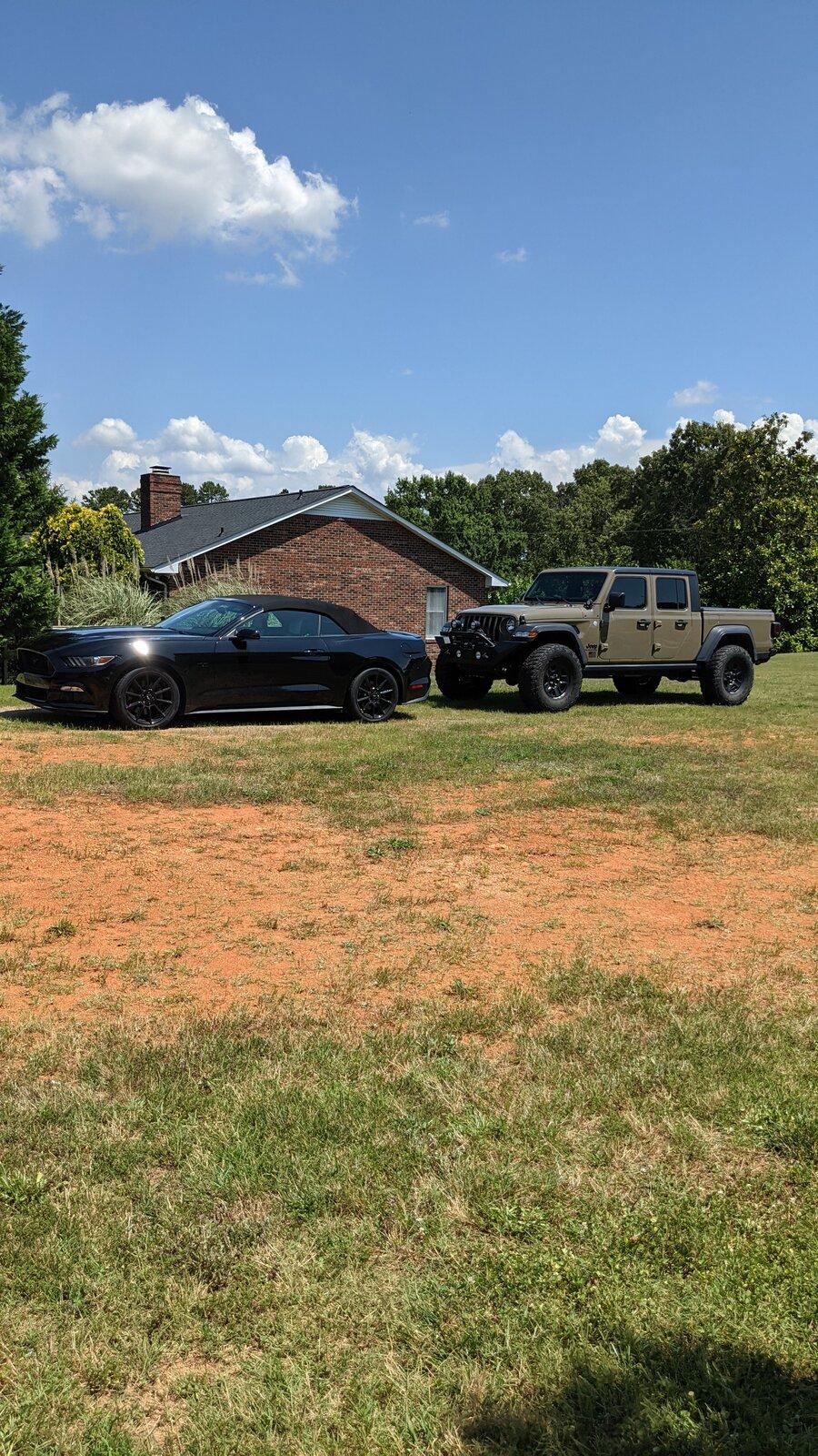

You can do 37's on a Gladiator with a 1.5" leveling kit, most definitely with a 2" Mopar lift. The problems going to be if you got a Max Tow or Mojave. If not then your going to need wheel spacers or wheels with more back spacing. I had 35's on my max tow sitting stock with zero lift. All I would of needed to fit 37's was about a 1" lift.
Sitting stock on 35's
Jeep Gladiator SHOW ME 37S 2 INCH MOPAR LIFT ON A NON RUBICON IMG_20200213_183121
Here's a video of one for the doubters
Here's mine with a 2.5" spacer lift on it on 37's which is close to what you get with the Mopar 2" lift, I could fit 40's on mine.
Jeep Gladiator SHOW ME 37S 2 INCH MOPAR LIFT ON A NON RUBICON PXL_20210715_190501559

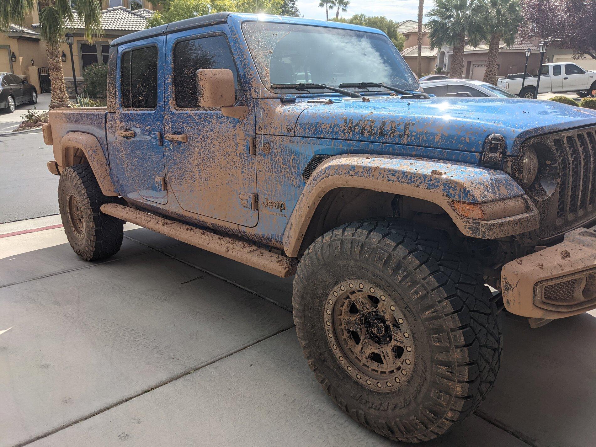

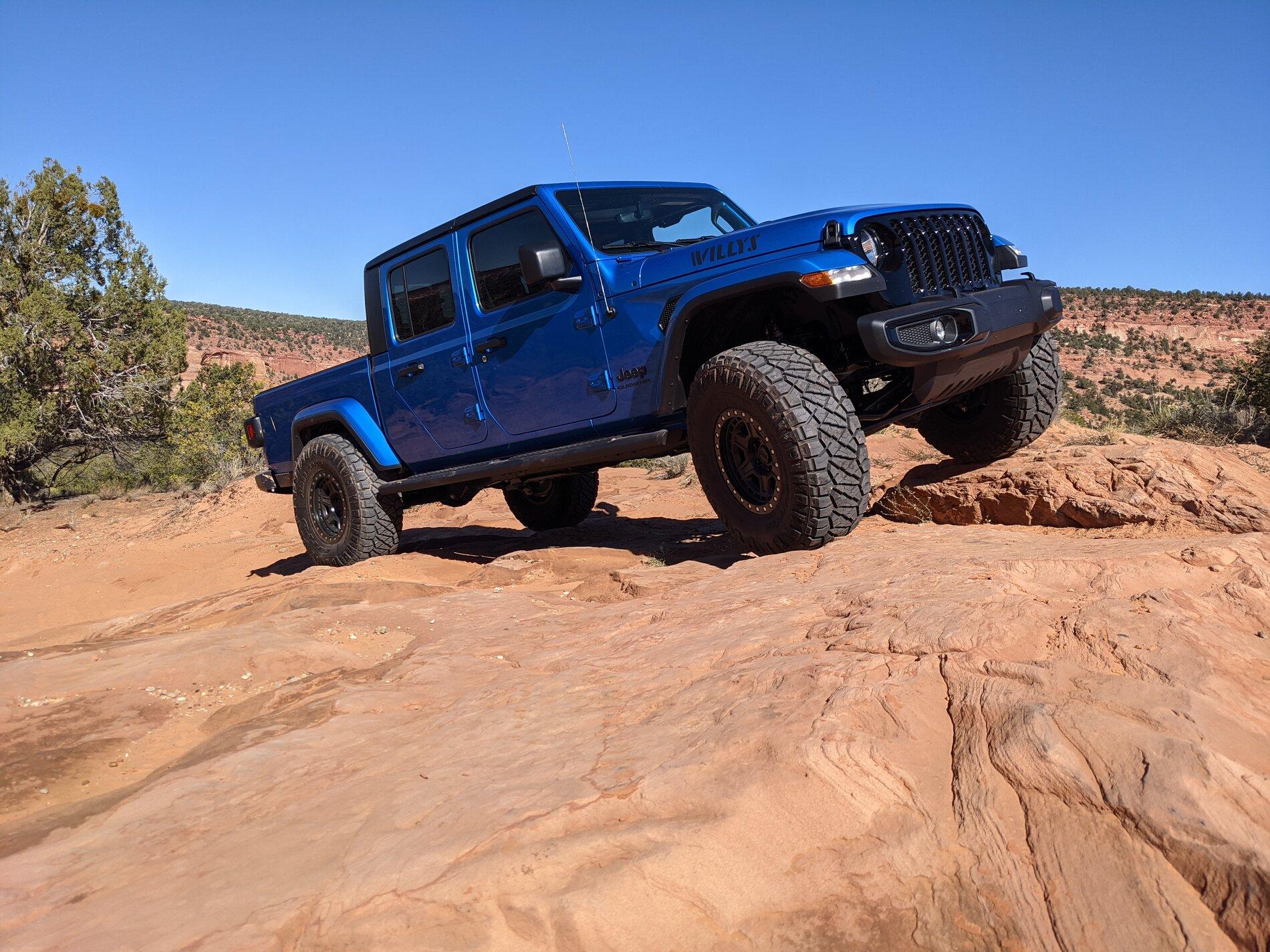

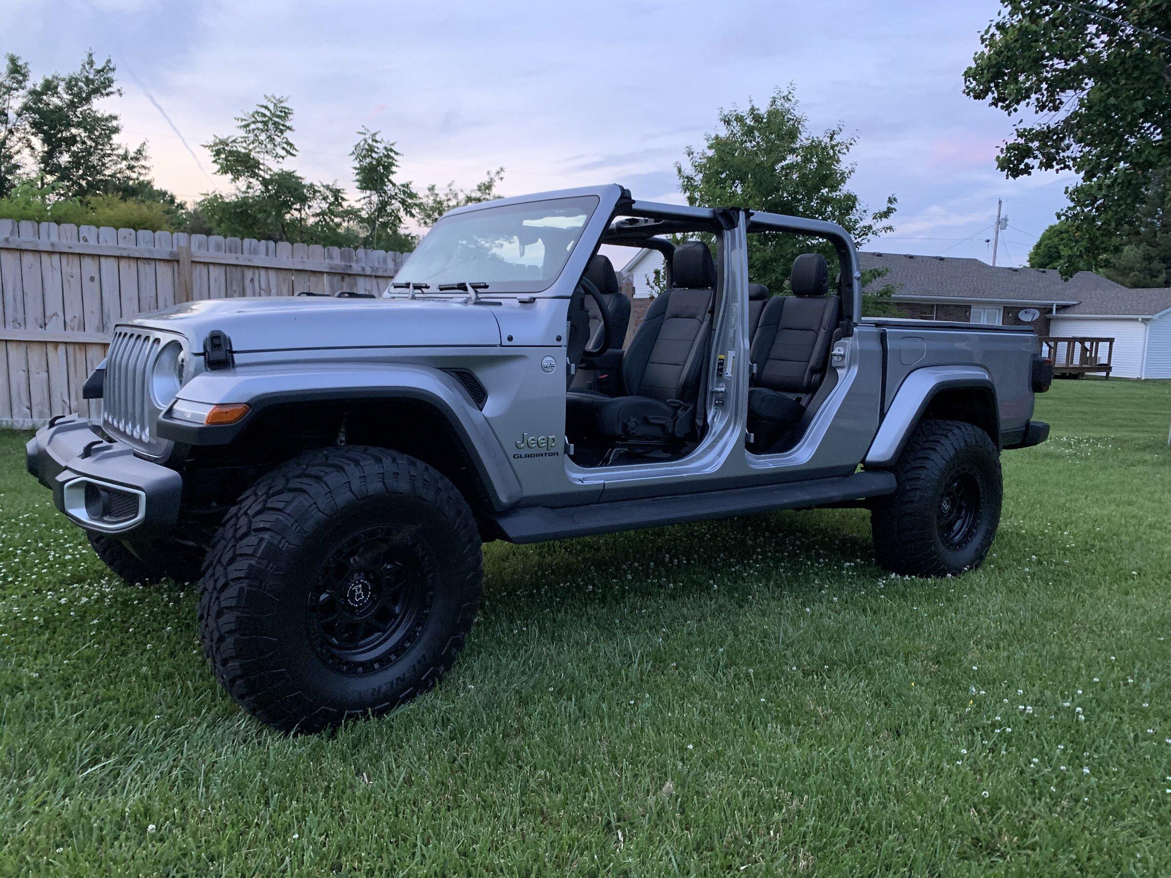

Here is mine with dealer installed Mopar 2" and 37s. Slight rubbing at full lock when flexed, otherwise no issues. To be fair, I've had a week and haven't done any serious wheeling yet though.

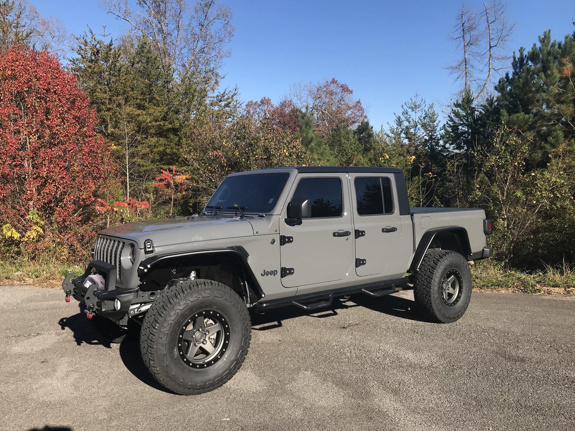

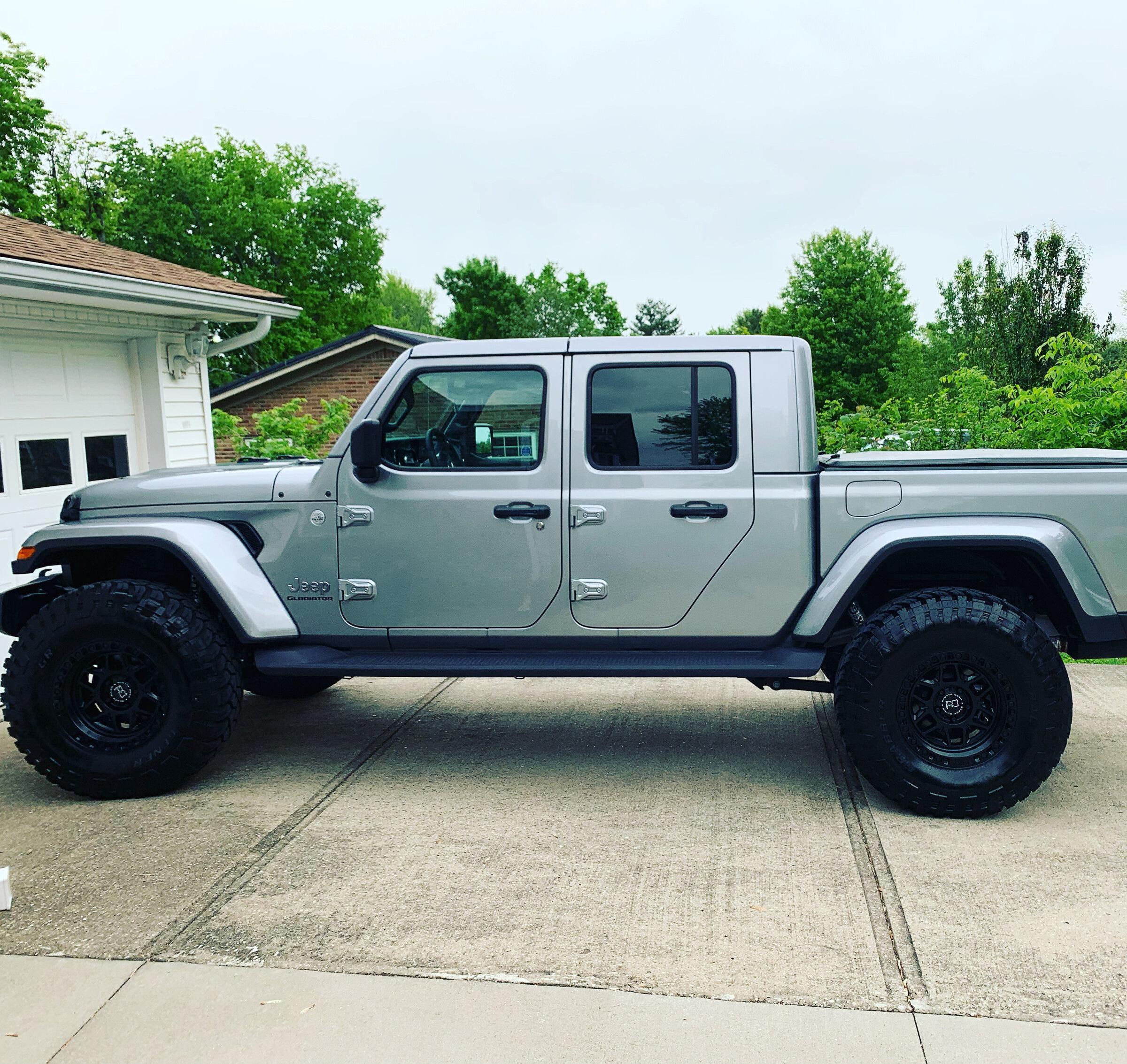

Christian
Dec 9, 2021
Kentucky
2021 Gladiator
RN
Accidentally included one not of me. Mopar lift, leveling puck, 37” General Grabber X3s.

Are you running fender liners? Any rubbing?
I’m running metalcloak inners also. What little I have been able to take it Offroad it has done good with no rubbing.
Thanks for the info. Trying to decide on a similar set up after telling myself i wouldn't go bigger than 35s. When you are offroad are you disconnected (front swaybar)?
