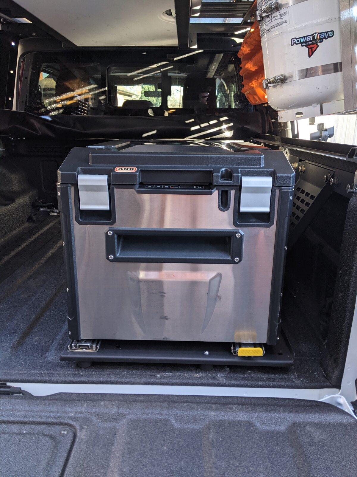

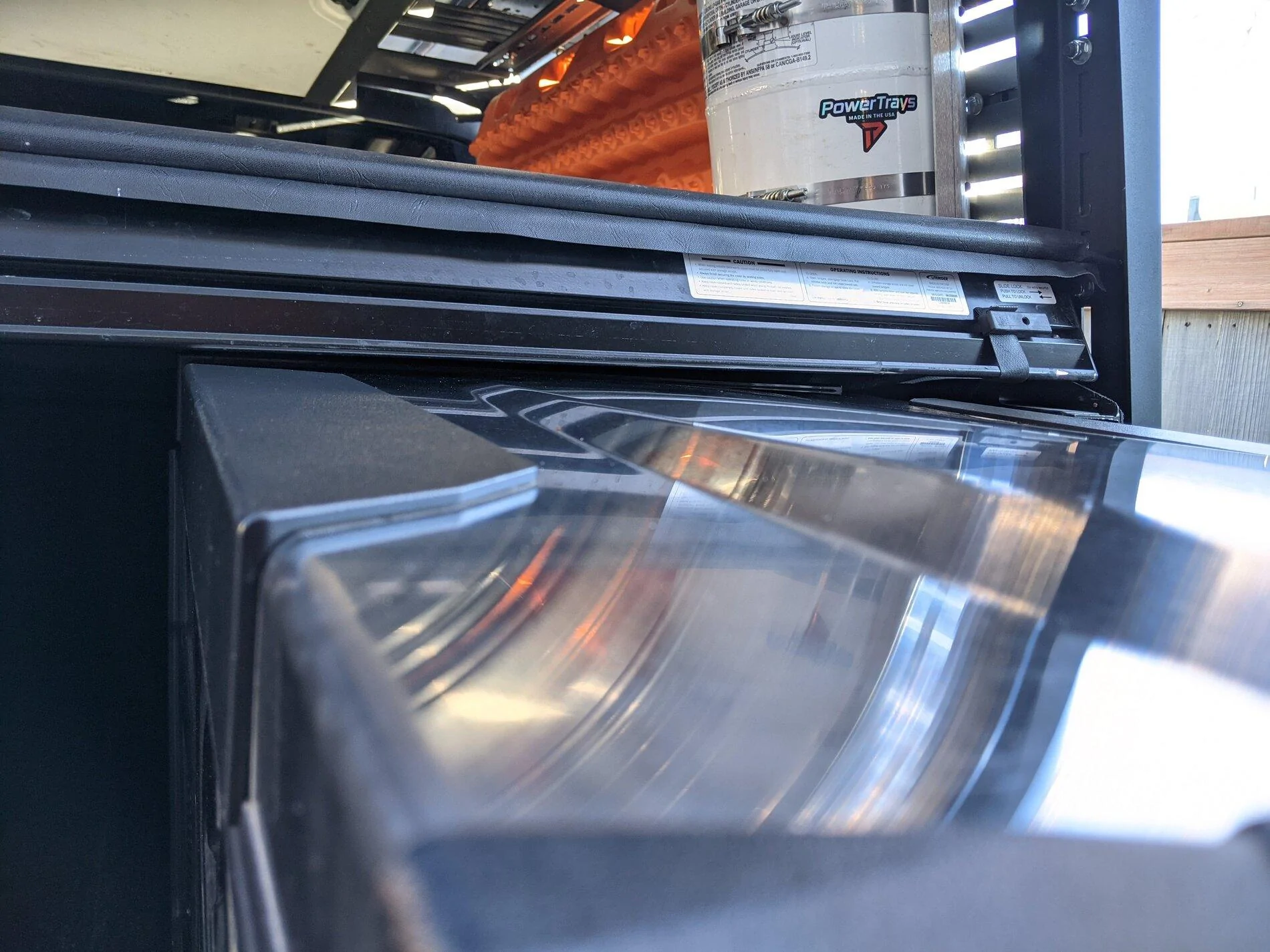

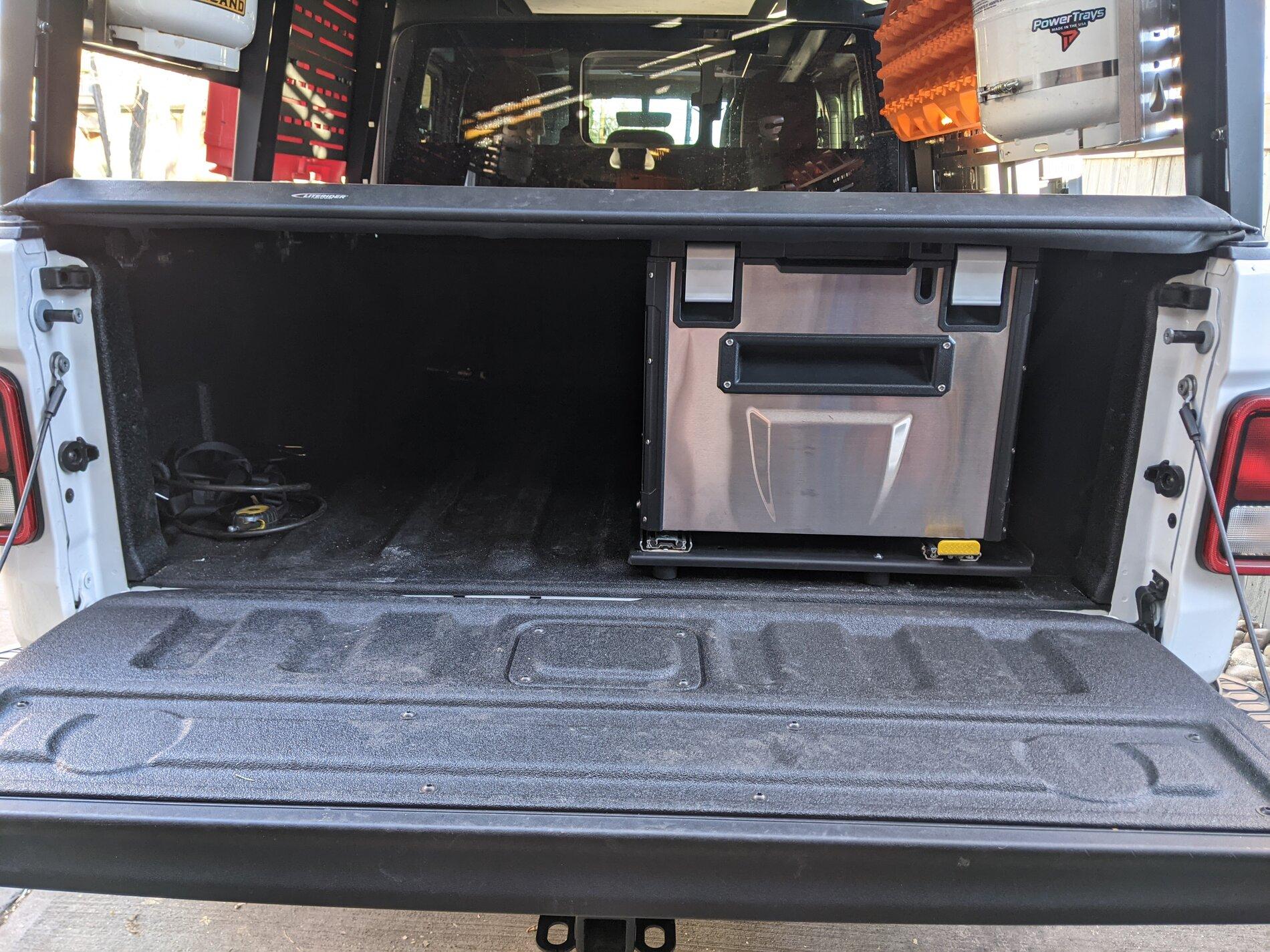

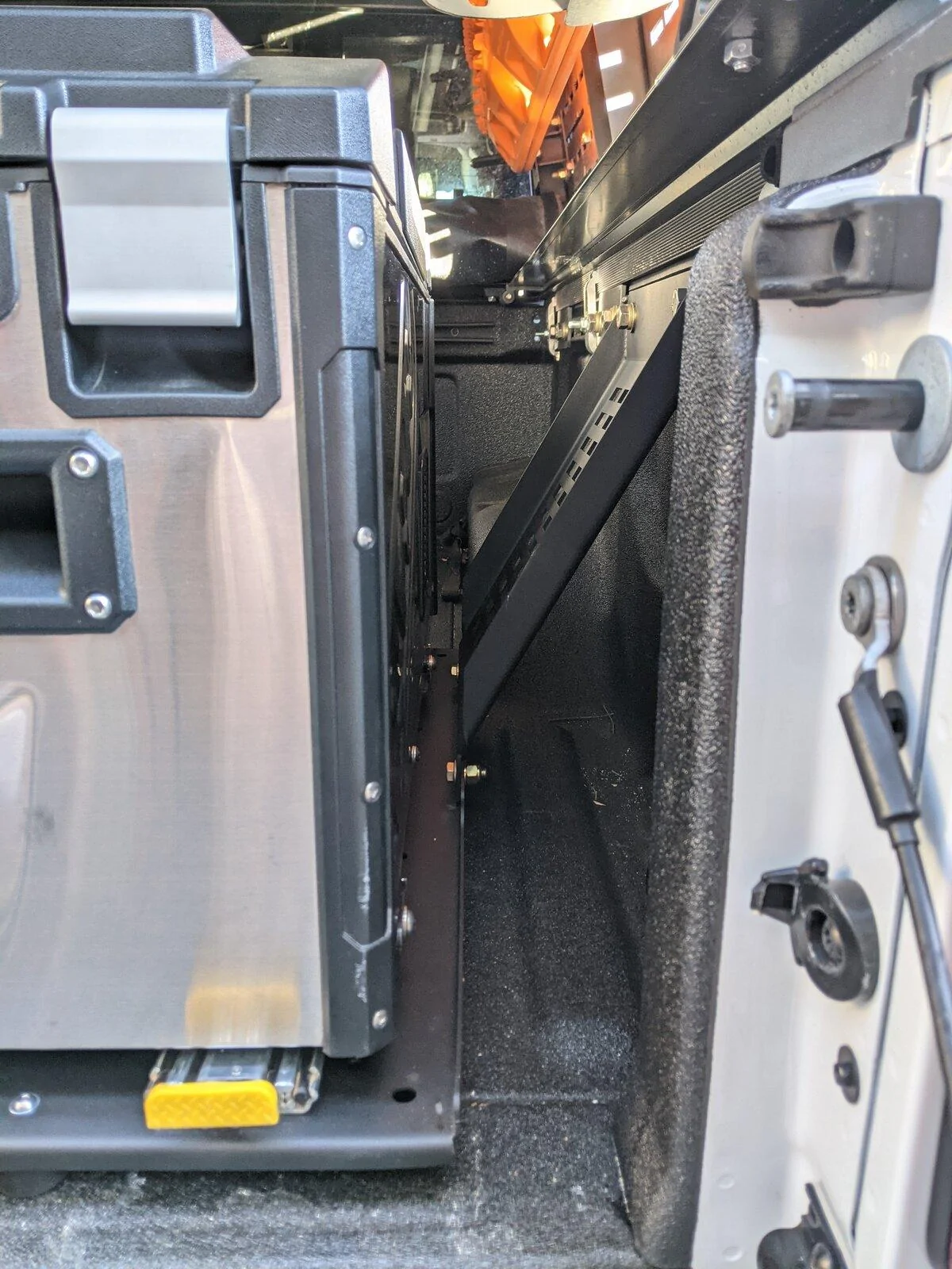

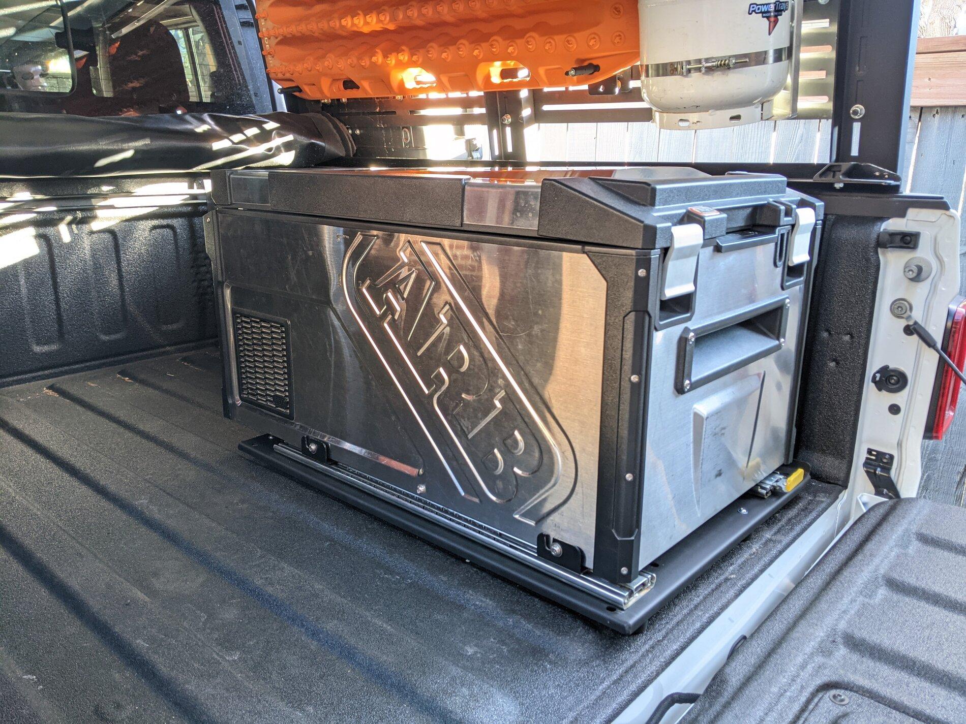

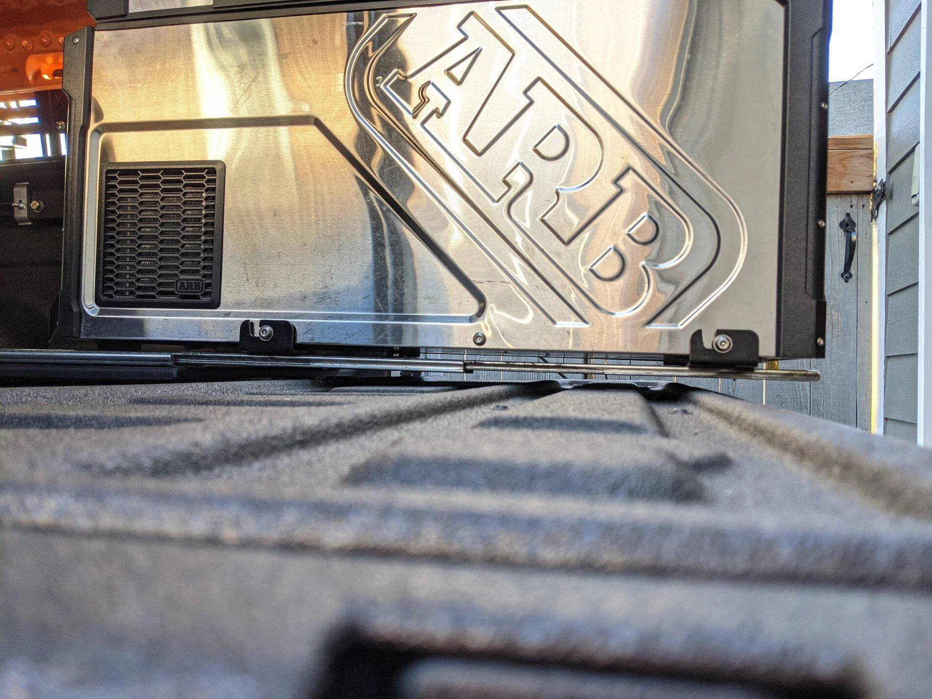

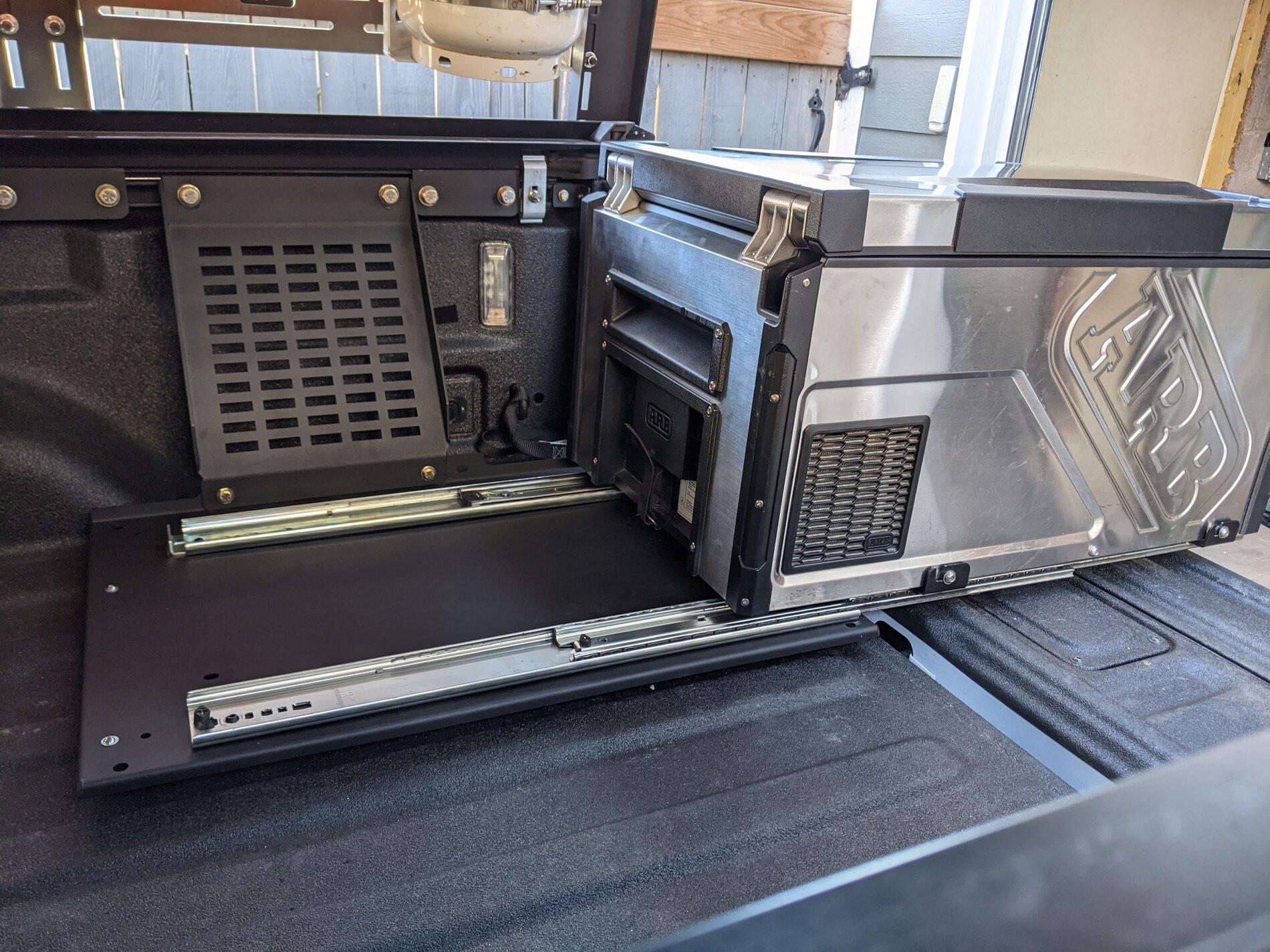

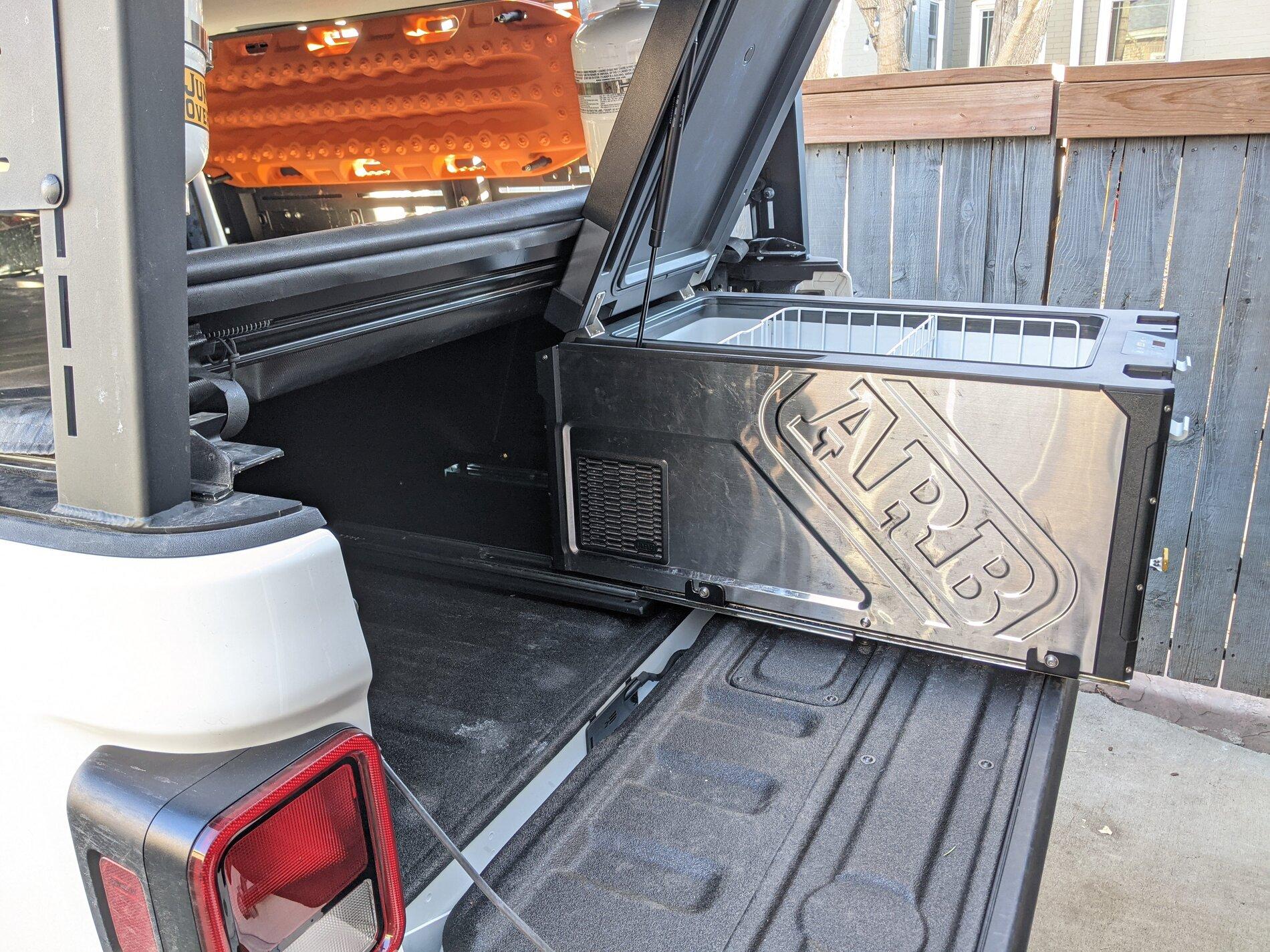

There's another thread that kind of covers this topic (search fridge slide I think) but here's mine. Fits just fine with soft cover, but you didn't mention if you had a soft or rigid cover.

^thats exactly what Im looking for.
i do have a soft cover That i need to convert to track set up like you have. Thats exactly what Im looking for. Do you have all your specific parts listed in that thread? If so ill dig it up there

Found the other post, here is what he used to do that install.
Just don't know what sliders he used?
As it sits and slides right now, here's the how-to...
1) ARB 63qt fridge attached to the ARB Fridge Solid Mount Kit #10900039
2) Solid Mount Kit attached to Accuride sliders
3) Accuride sliders attached to Xplor fridge mount plate
4) Removed the (2) round aluminum support bars from under the Lite Rider soft cover
