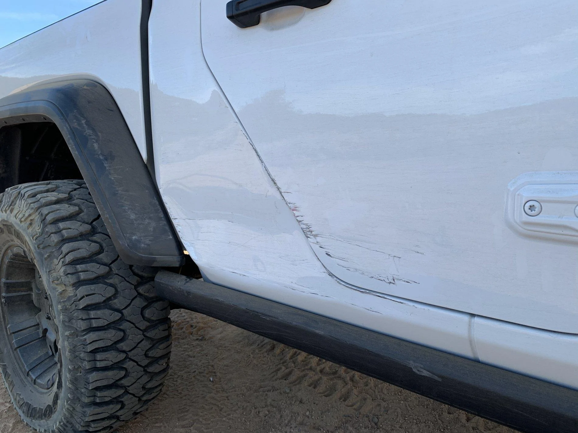

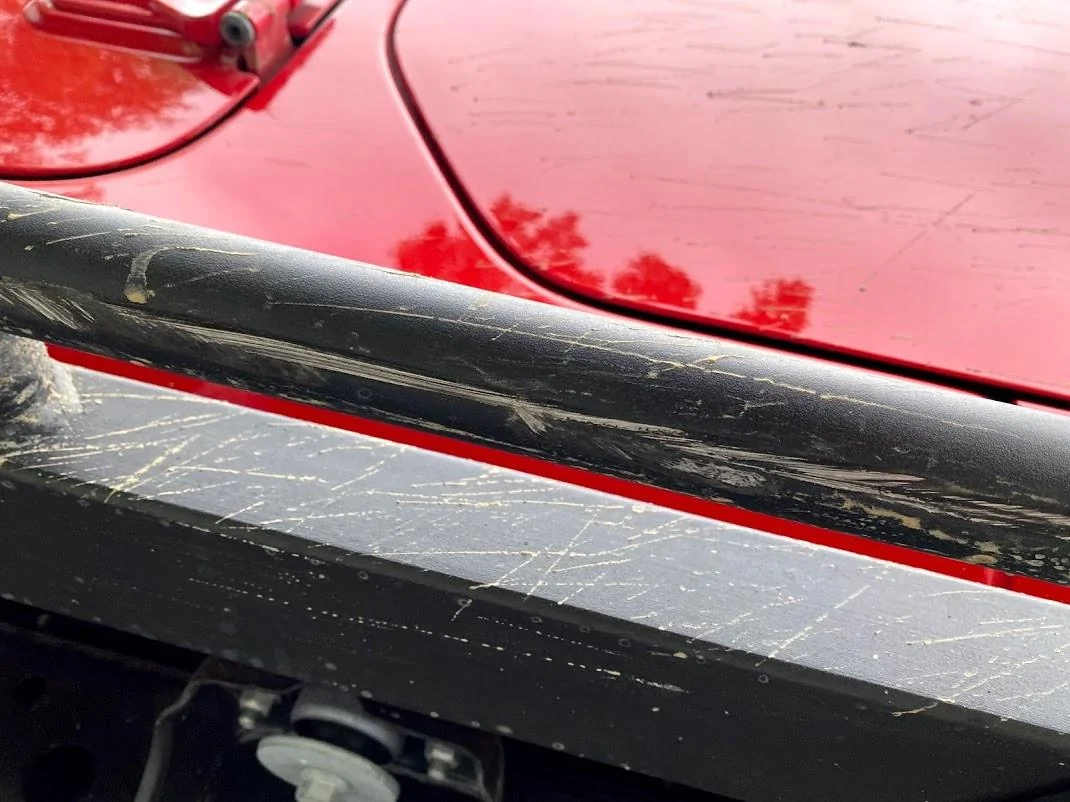

Every single outing more marks. All looks to be pinstripes of clearcoat damage. Cant be helped, trails in KY are mostly overgrown and disrepaired county roads, branches stick out.
How are your rigs holding up?

Those scratches look like they will come out with a buffer and some very fine, or fine polish.

They will. I just need to get the materials/tools and learn how to do it. Concern is I'll mess up the clear coat worse than the pinstripe. If that is a real risk, I'll just take it to get detailed

I use Rupes gear for all my cars from autogeek. You must work in the shade. If you use the ultra fine (white cap) or the fine (yellow cap), you will not go through your clear coat unless you really, really get super careless. You do not seem like that kind of guy. Start with the ultra fine and the buffer and go over it - back and forth for a few seconds and see the result... If you are worried, you can stay with the ultra fine until it looks better. The fine (yellow cap) is also not dangerous and will not go through your clear coat. Personally, I use fine (yellow cap) to get out scratches in the clear coat.
Just take your time, buff it for a few seconds, wipe it down, look at it, buff it again if it needs more, wipe it, look at it.... etc... If you do it step by step like this, you will not screw up. Then, when done, put some nice wax on it. If I tell you the wax I use, you will think I am crazy, but, I love it and use it on all my cars. It is by far the best wax I have ever used, and the shine is out of this world, nothing like it -- Wolfgang Fuzion Carnauba Polymer Estate Wax.
Note: If I remember right, I think autogeek has a ton of videos on their site to show you proper procedures and technique.

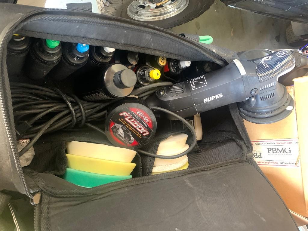

Hard to say, you can go into a black hole on this... Here is a pic of kit with some of my equipment. I have 2 other boxes of pads and polishers. I use a Rupes big foot 21, and I do recommend it. My brother has the Rupes pneumatic version, which is much lighter and works off an air compressor, but, obviously it is not portable. This one is also great. You also can buy cheaper units, I used a cheap one for years -- they vibrate more in your hand and are more fatiguing than the more expensive Rupes, but, they get the job done.
If you want the basics -- get a polisher, Rupes yellow fine polish, yellow pads, white pads, and wax or paint sealant. I like Rupes brand for polisher and polish, and Wolfgang brand for Paint sealant and wax. The other heavier pads and heavier polishes are too coarse for your new paint job.
Note: the white spot on the "after market" smaller pad on my Rupes 21 is a visual so I can see that the pad is still turning and I do not have too much pressure on the buffer. A little trick. Never push hard, just use the weight of the buffer.

Looks like it will have to wait for now, being on sale for $350!

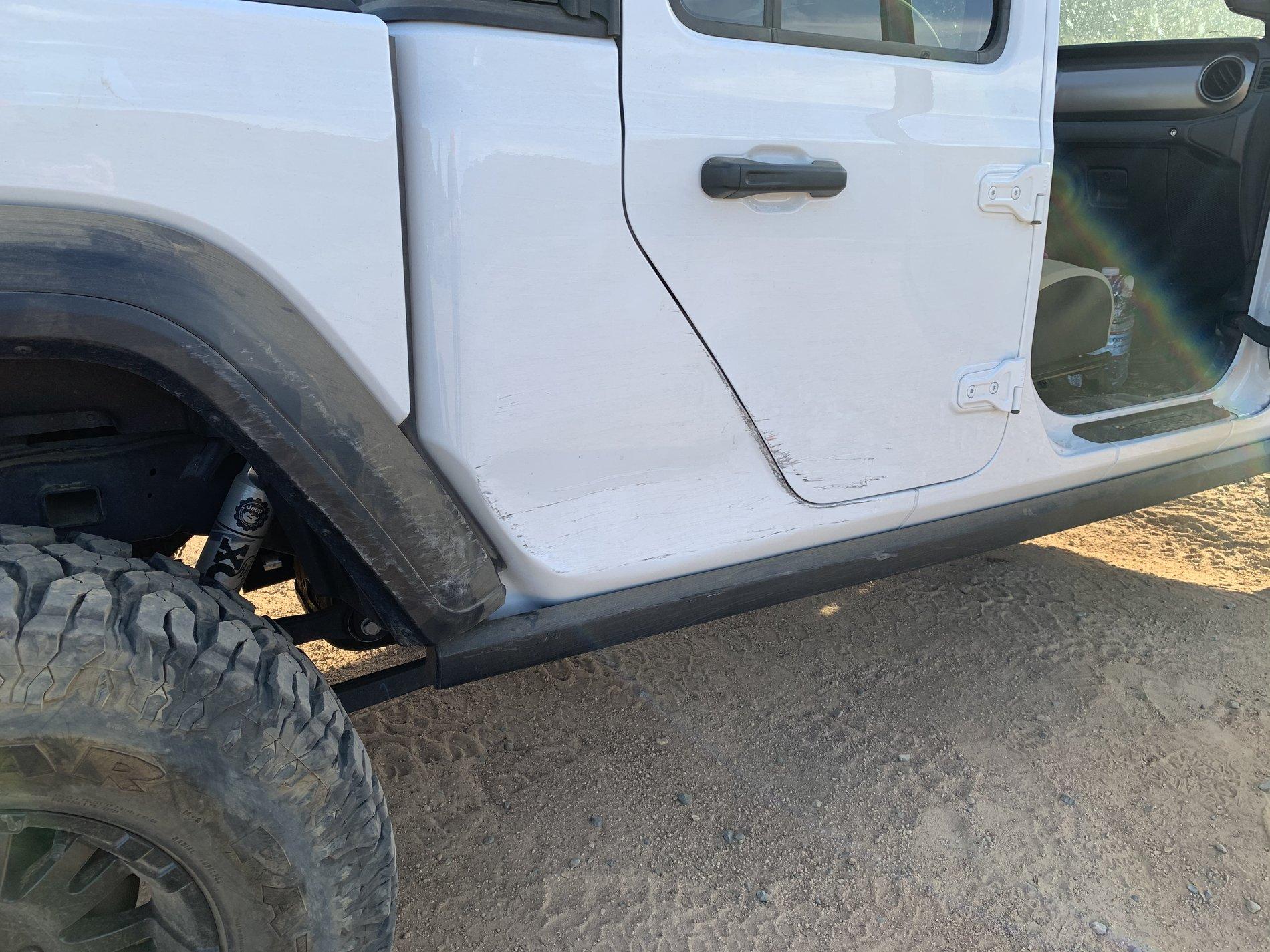

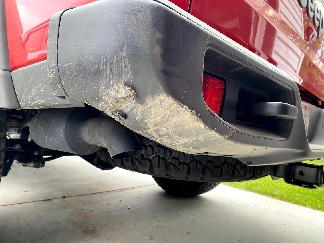

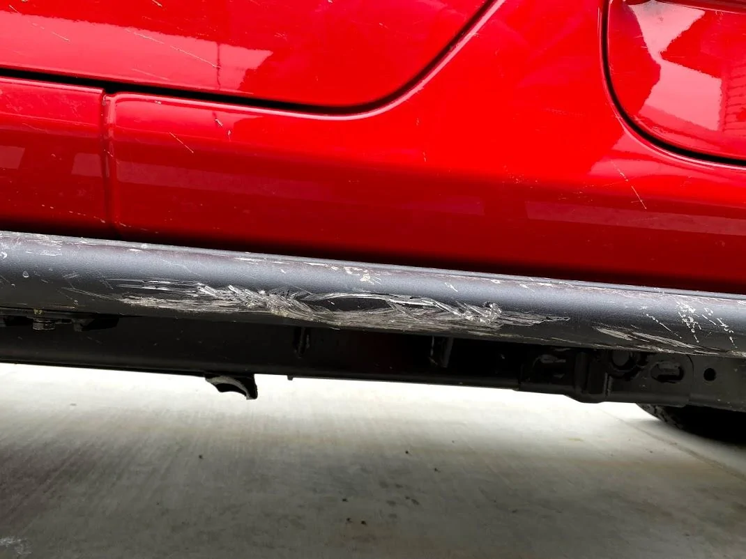

Jeep Gladiator Show me your trail damage 144FC4D3-8F2E-419F-BD85-C94BE001A6C3
Jeep Gladiator Show me your trail damage FC0FF025-FBD5-4C95-94F3-CE655EFF833A
Jeep Gladiator Show me your trail damage C782B86B-F94E-4011-9E84-0FC8455482BD

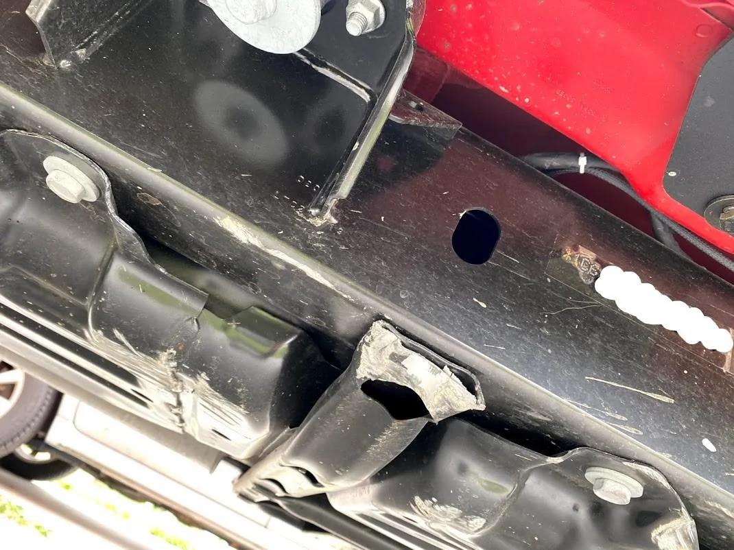

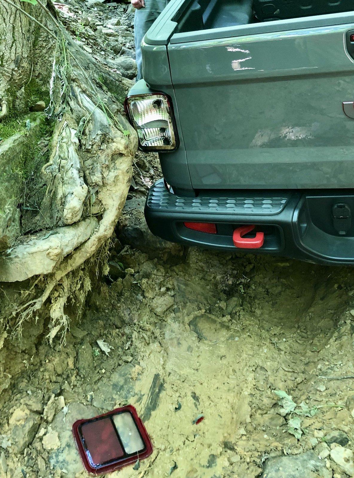

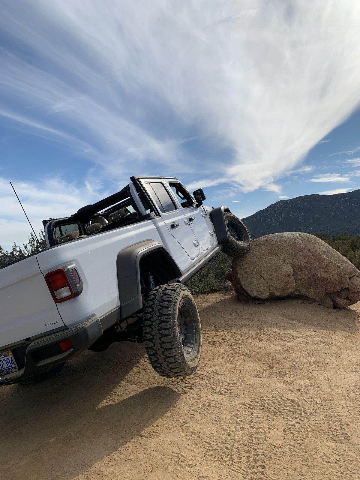

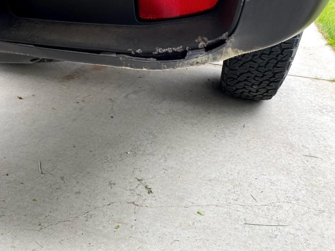

Before and after biting off more than she could crawl over. May just hit it with some rust prevention and cover with armor. Any thoughts?
ps. The first pic is just for fun. Damage happened a couple trails later.
