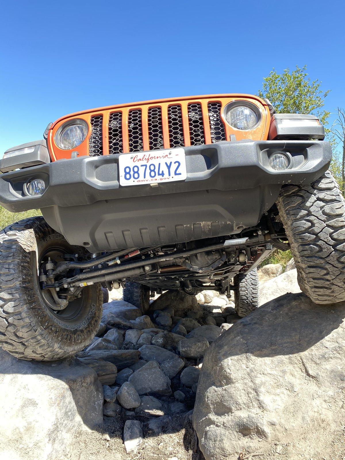

It has steel skids, and a sufficient amount. The only skids I recommend are the rear shock mount skids from rock hard. The rear hitch also benefits from a skid. Ask me how I know ;)
Jeep Gladiator Skids plates for JTR 1BE454A6-BC67-45A0-8B6F-946CF024B72A
That looks awesome! Will be there one day soon.
