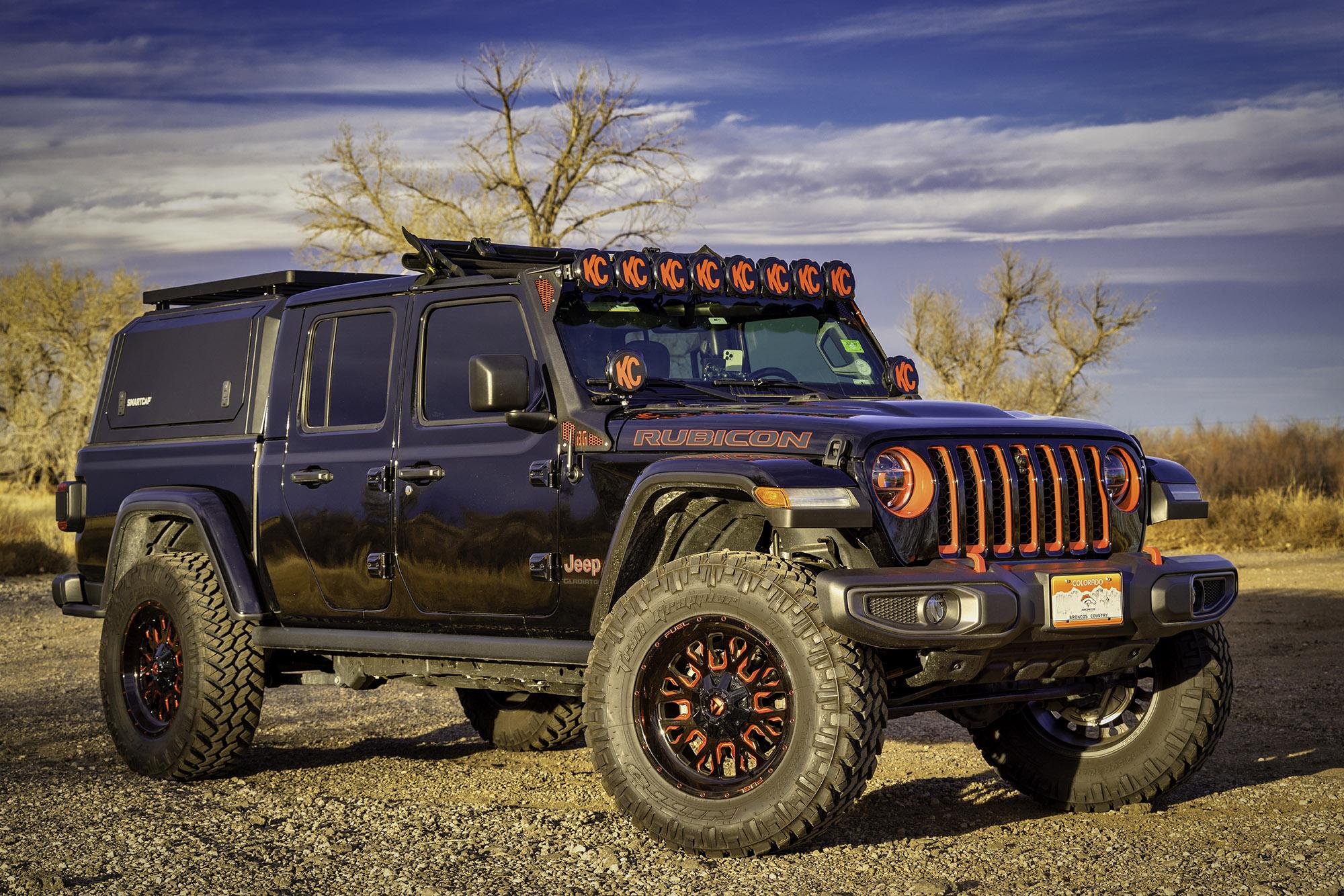

Trail Jeeps recommend that I add a JKS J-Venture 3-3.5” lift. I have 37x20 tires / rims. Nitto Trail Grappler MT tires. I re-geared to 5.13’s at the same time. Rides as good or better than stock, even with larger more aggressive tires, steering is much better, wind doesn’t bother it anymore or passing Semi-trucks. It’s a fairly level kit. Posted a few photos of it on my showcase gallery. Fox performance 2.0 shocks, Yeti steer smarts brace, J-Link etc. I feel I made a good decision. Even with 37 x 20 and no lift I didn't get any rubbing on road or turning etc. You'll get 3" of lift on the Rubicon & 3.5 on the sport. My 37's x20s work fine I have plenty of space in the fenders so your 38's should not be an issue at least on the Rubicon model, I think they end up being the same height sport or Rubicon. If you were to go 40's then the 4.5" lift would be better but at 40's you'll need to replace axels & possibly more.
