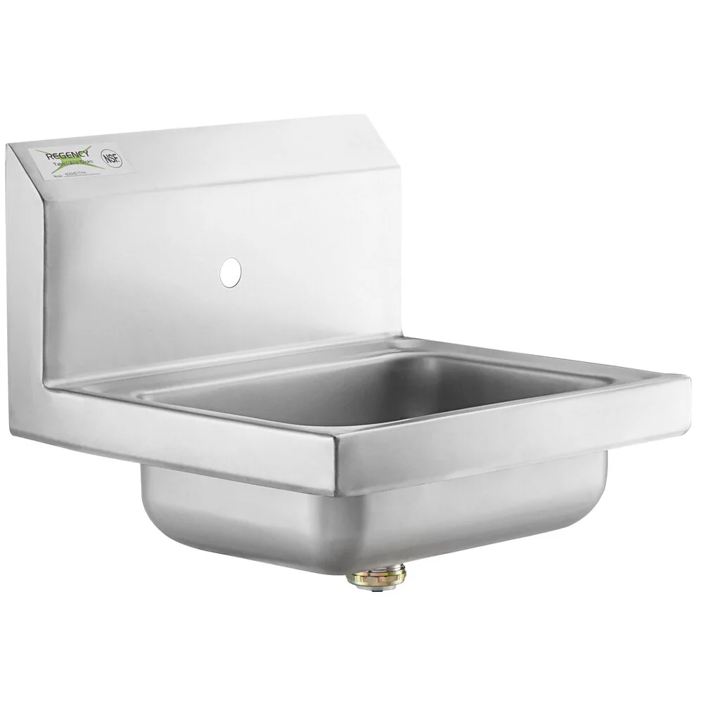

This is the Regency sink I'm thinking about, 17" wide by 15" deep, 10"x14" ,5" deep bowl, can be had with left and right addtional welded back splashes also. I'm thinking about mounting it sideways with the back splash mounted to a 12" wide drawer cabinet, with slides bolted to edge of sink, then Partner stove support plate mounted to the same slides in the "front" of sink. Sink will probably be about $100 deliverd.
Found at Resturant store.com.
Still in design phase but like that perhpas the whole thing will be aluminum or stainless and only wood might be the drawer cabinet, stove has to be fartherest from cap or tent material......Jack

Picture a faucet coming out hole n backsplash for sink use and a kitchen style srayer with counter weight coming out of top of backsplash about where the label is, when putting away just pull sprayer up and put in sink....Jack
