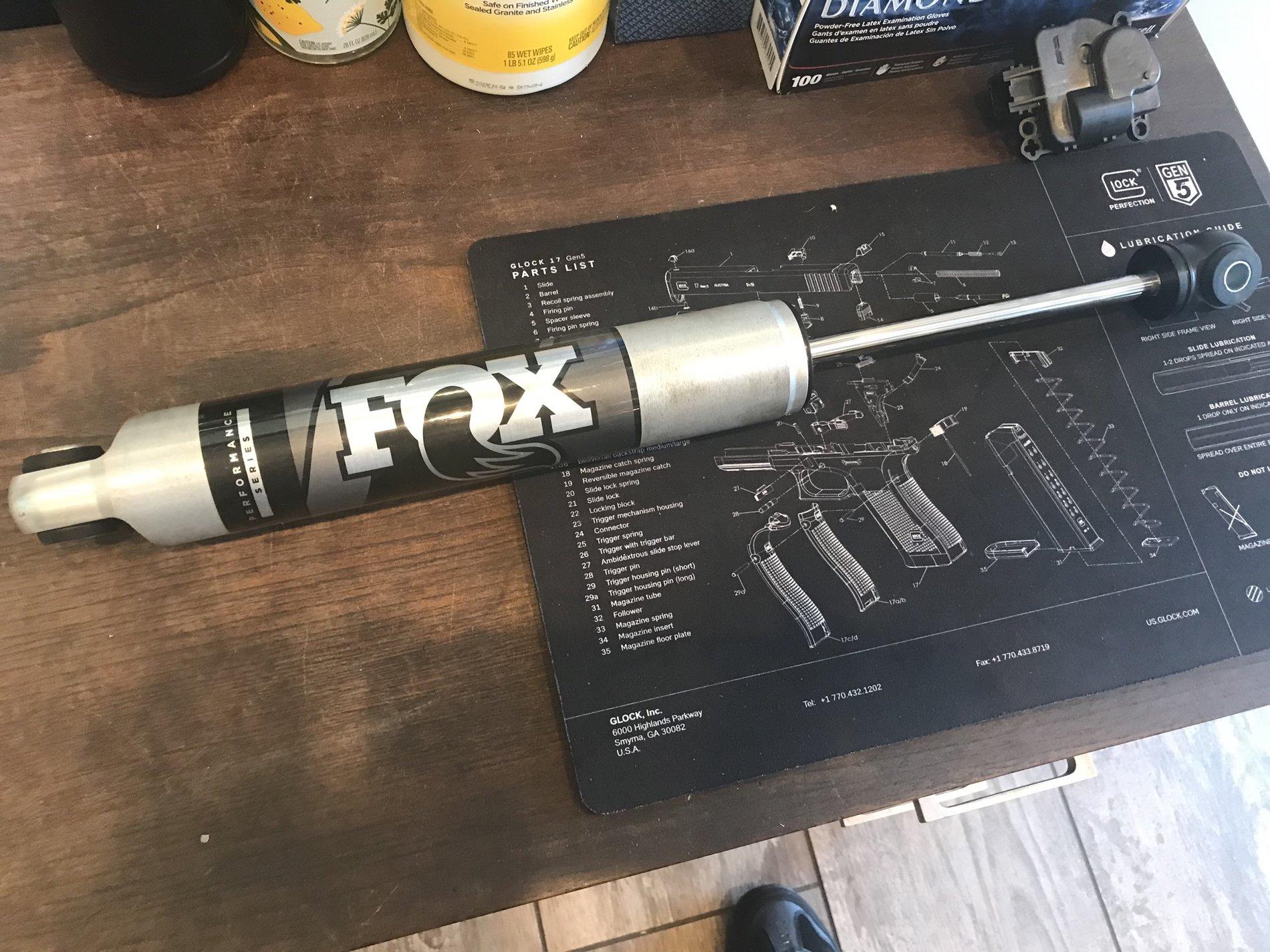

So I just swapped out the stabilizer and it drove straight as an arrow!!
only issue is I hit a couple big bumps and got a shimmy out of the steering wheel. How do I clock the 2.0 stabilzer? I tried youtube but didn't find a good video.
only issue is I hit a couple big bumps and got a shimmy out of the steering wheel. Which stabilizer is this one? I can’t find the receipt. Is it the one that has to be clocked?
Jeep Gladiator Slight pull to the right...can't figure it out. 7EA2862E-88B2-4561-9BC9-A9E841B4294C
There should be a part number on it but that is not the through shaft version....the through shaft has a shaft extending out of the other end and comes with a different bracket
