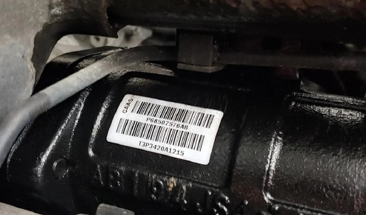

Anyway, my question to the group is... After what build date were the steel steering boxes put in as stock on the Mojaves? I would like to know if mine already has the new box. I'm probably going to get the through-rod stabilizer and see how it changes the feel.

2021s should have it - here's the number you should see on your steering gear -
68507576AA (or AB now)

Thanks for the info! Mine's a July 21 build, but I'll double check it today.
The goofy thing is that some of us had ours replaced - and I assume the others got the AA version, I got the AA version, and it was fine for a while, well, better, anyway. Then over a few months' time, it got worse - in fact worse than my original. I took it to my dealer, asked them to check alignment per the latest TSM and check for loose stuff. I simply told them it wandered worse than before.
They are the ones that told me they needed to replace the steering gear. This time I got the AB revision. And it's been fine.
