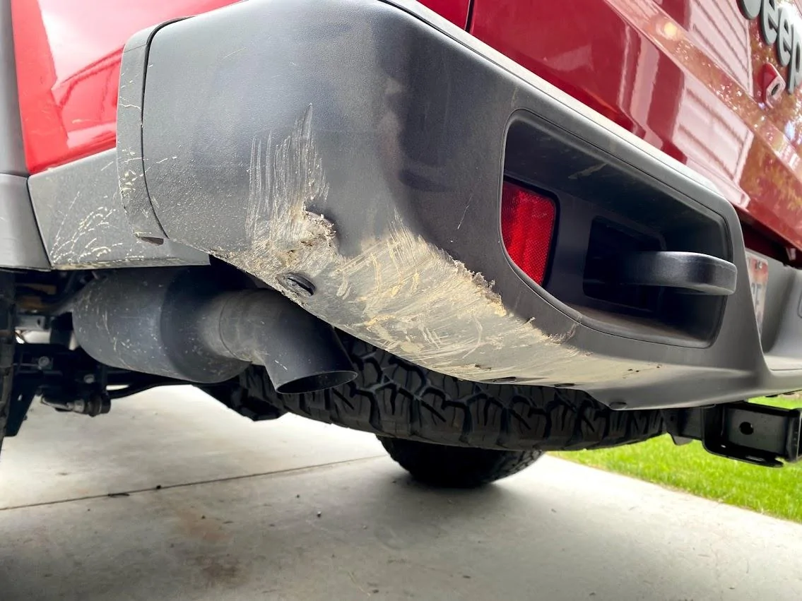

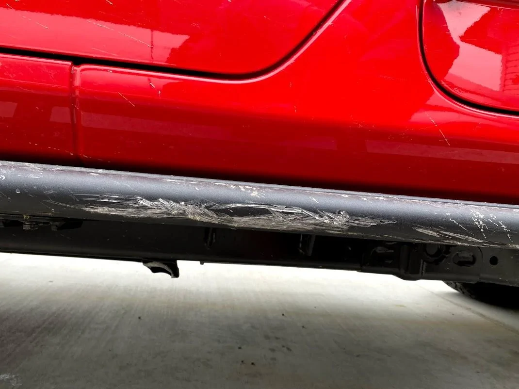

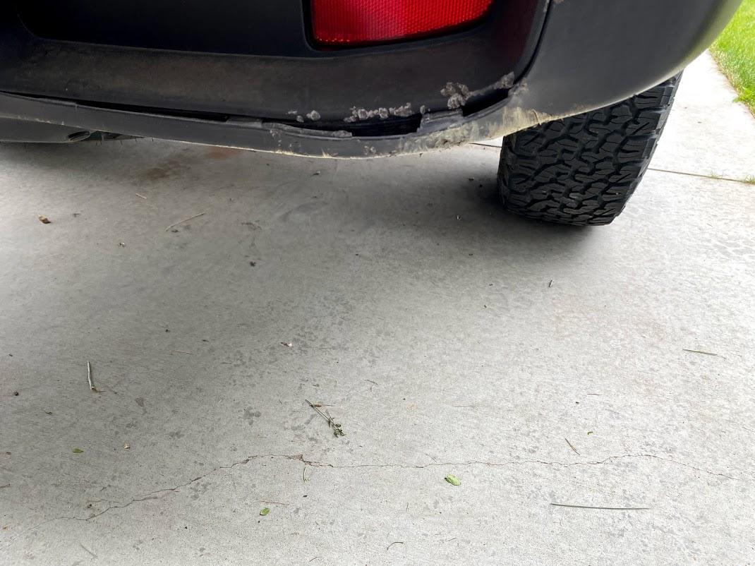

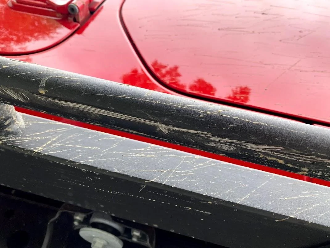

First time out.. I am leveled (1.5" up front & stock rear) on 35's & I scraped a TON.. Got home & ordered a full belly skid. Rear bumper got a bit fucked as well. So glad I had sliders on to prevent any real damage.

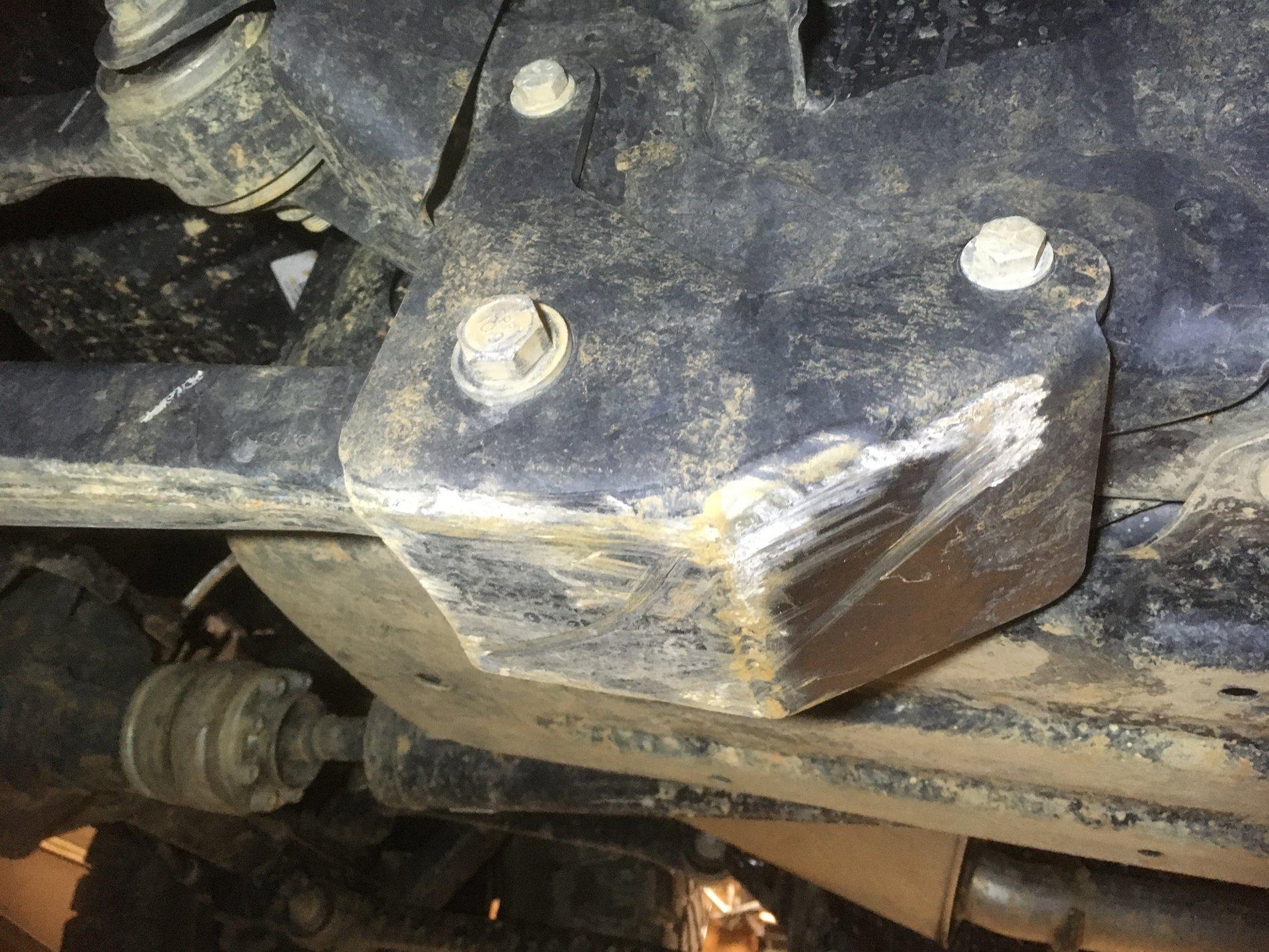

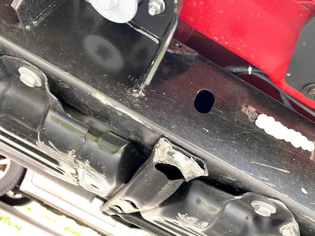

Rusty's. It the best $90 I've spent on this thing, after nearly flattening one side of one of the rear mounts.
I'll have to get some of those later on. I picked up an entire suspension from another Max Tow, including control arms, for $50. Once the arms get too damaged (if at all, none yet that I can see), I'll swap out and add skids. I'm very conscious of Gladys's weight
will post pics of scrapes later
