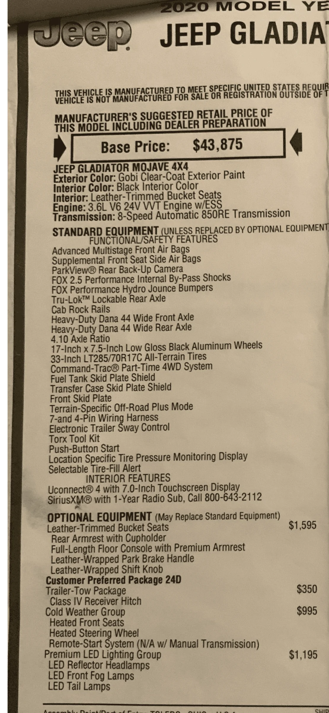

So I have been reading on the max towing package. And my build sheet says towing package but not the max package. But from what I can tell the only thing mine doesn’t have is the coolers. Has everything else the max package should have. So is it or isn’t it.

Not on the Mojave. You're missing the stiffer progressive rear springs.

I believe the Max Tow package has a tow rating in the upper 7K range. My Mojave with the Class IV is in the low 6K range. I don't have the specs in front of me but that is what my dealer told me.

If it's not a SPORT with the text stating MAX TOW, no it is not and no you can't possibly just add parts to make it one. That's been discussed at great length over hundreds of posts in many threads.
There's a lot more to it than the parts - center of gravity, weight of the truck and other factors along with the progressive springs, tire size, etc.
Mojave wasn't made to be the tow champ of Gladiators, it was made for other special purposes.
Summary -
No Mojave, no Rubicon, no Overland can have the max tow package and rating.

Thank you. That’s what I was wanting to know.
