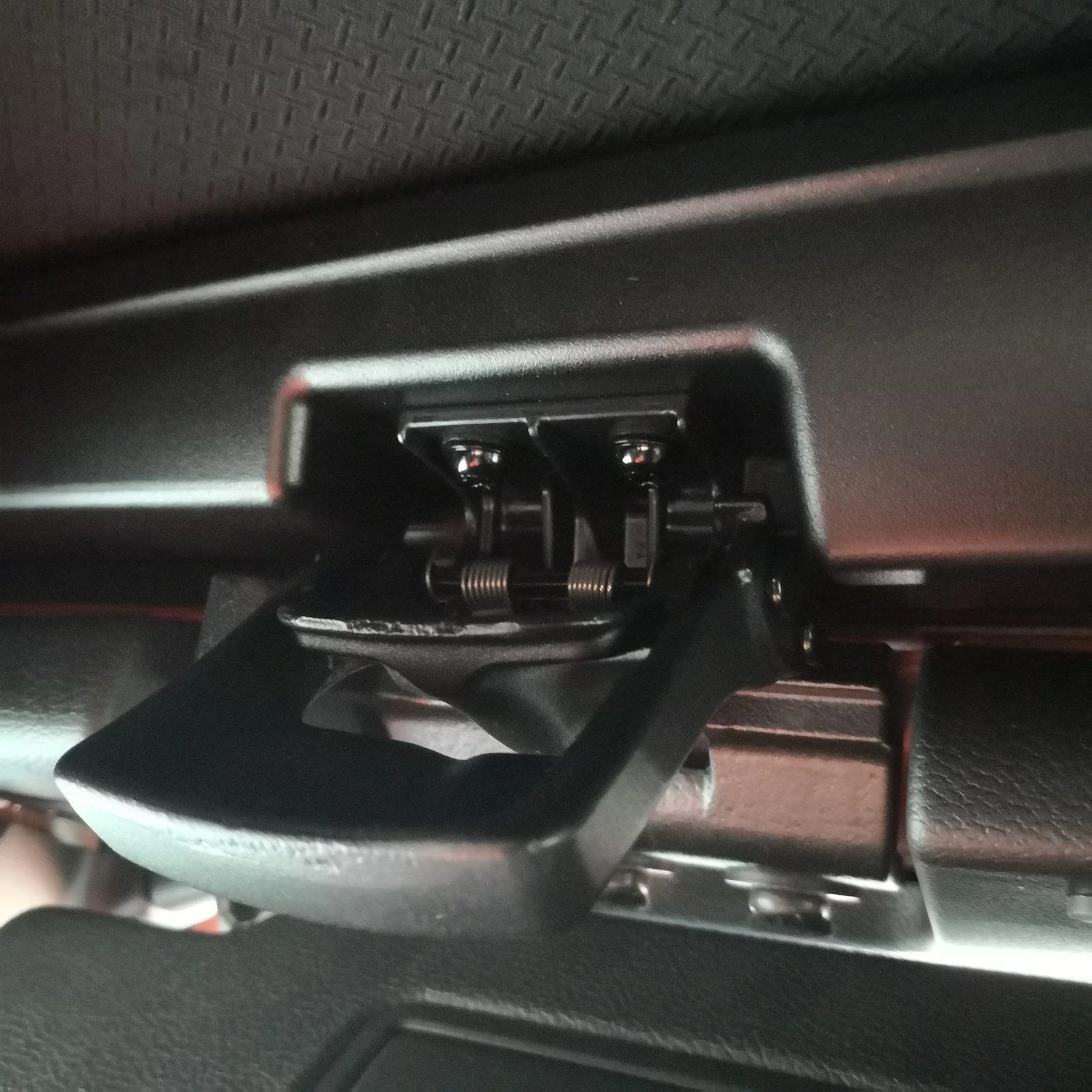

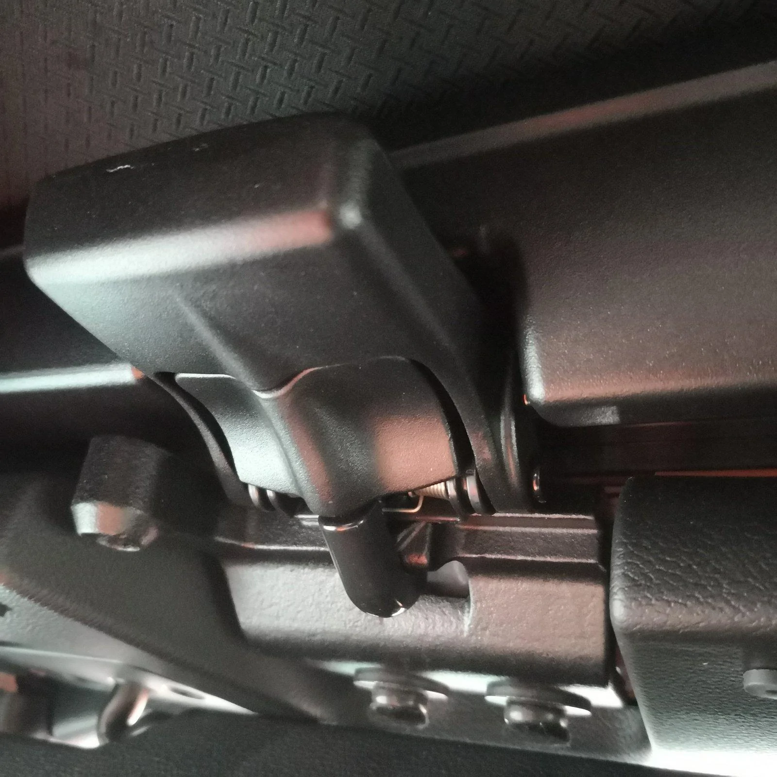

Any way to tighten the latch? Driver's side is extremely loose compared to passenger side. It has popped open a few times driving on the highway. Freaks me out everytime!

I took it to the dealership for my first oil change... the advisors had a similar situation so they were familiar with it. They ordered me a new latch and replaced it. According to them there is no adjustment to them and since itā€™s under warranty itā€™s easier to just change it out.

Mine was the passenger side, my dealer said they adjusted it, it seems tighter now but they still seem to open pretty easily. if it happens again Iā€™ll Ask for replacement latches. Mine is the premium softop are the rest of yours that one or the base top?

I had mine into the dealership today for something else but had my softop open twice on the highway.
They adjusted the clasps, said they were way out of alignment.
