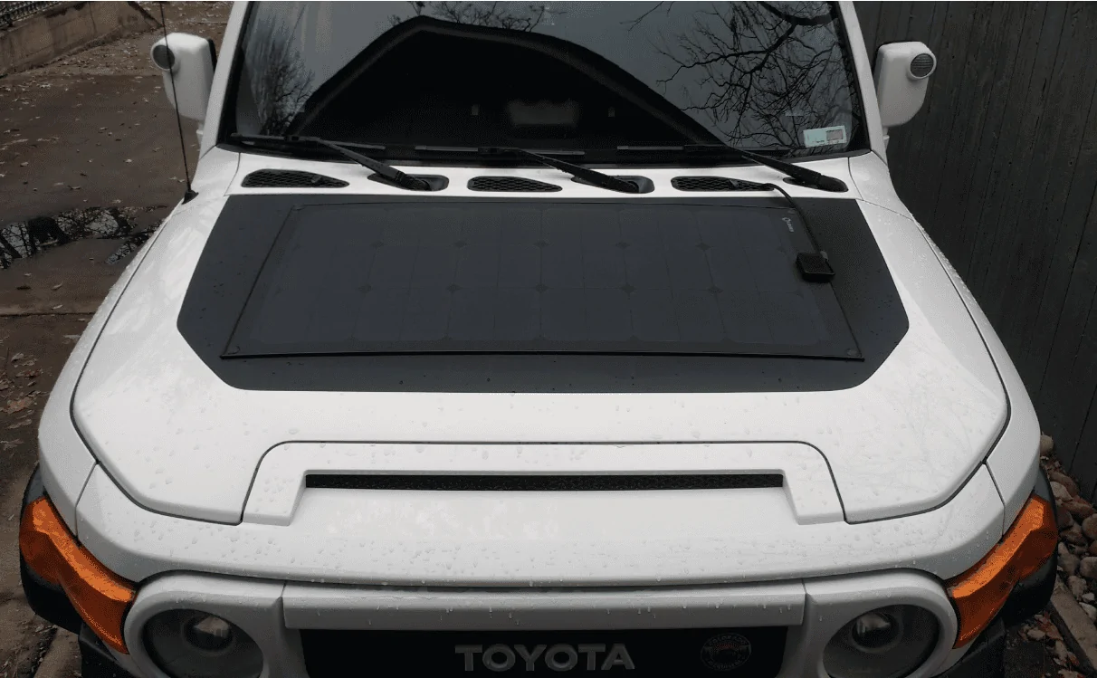

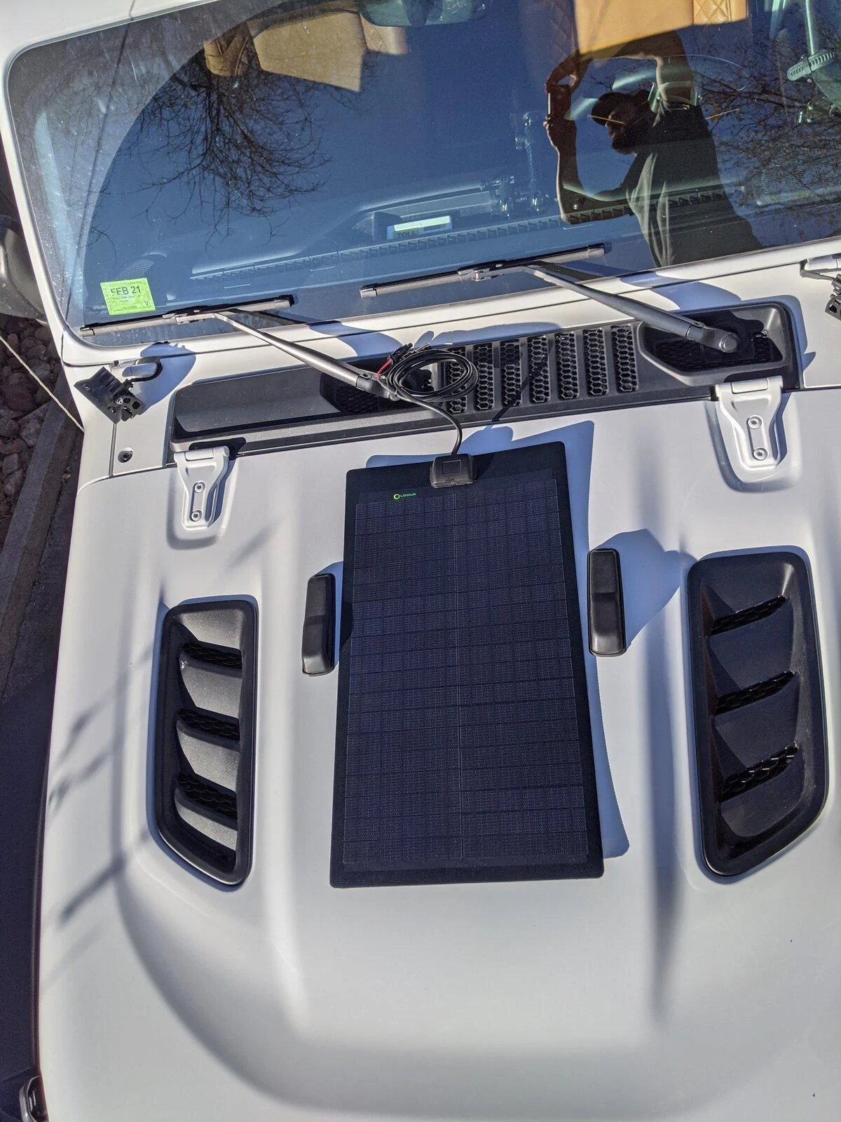

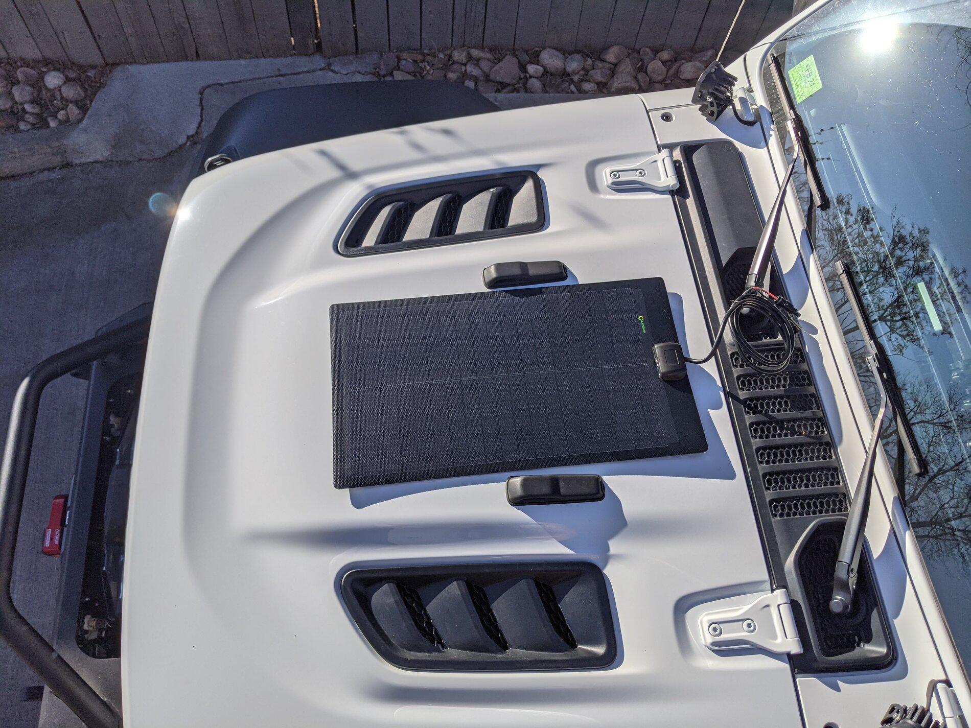

darkhorse13
Jun 4, 2020
40
602
877
Castle Rock, CO
2020 JTR
Data Analyst
@NHyde I ran an 80W hood solar on my FJ to keep the dual batteries topped off with my ARB 50QT... it was plenty.
I plan on doing the same with the JTR but unfortunately the power bulge hood limits us to 30-40W panel size.

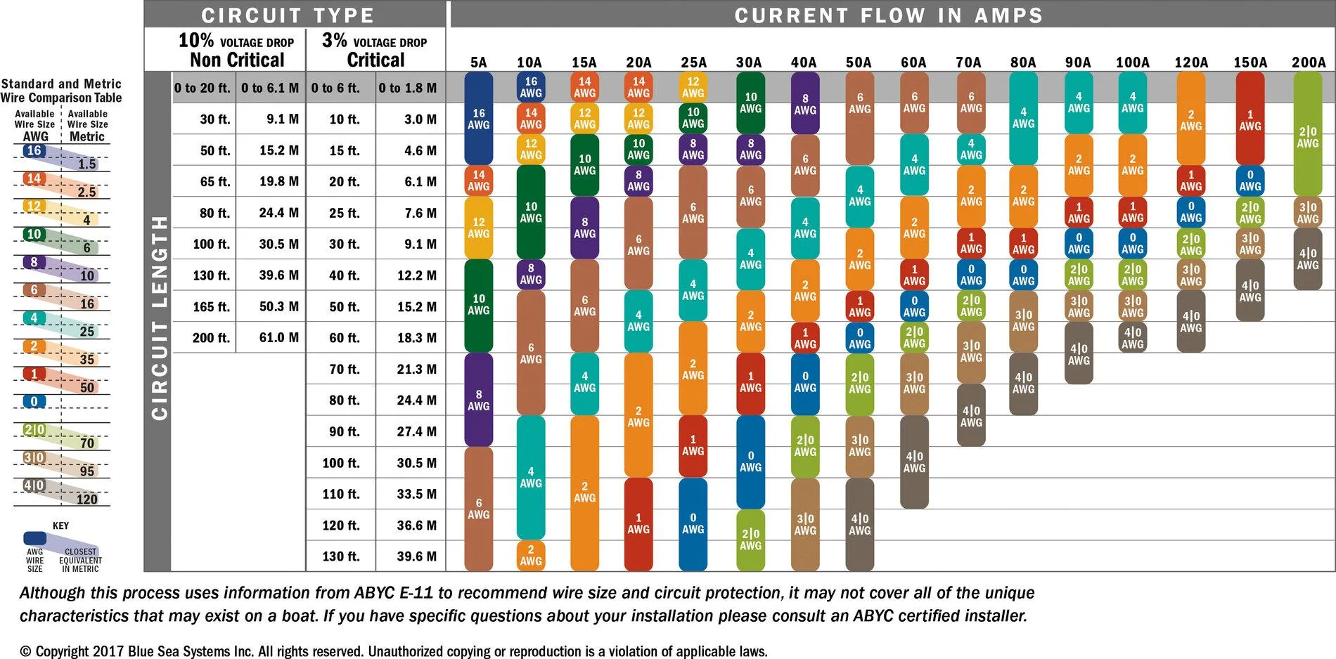

Would it be hard to mount a solar panel above your rear roof panel? You could incorporate it into a rail mounted roof rack for wheeling trips and store it in your attic when you are in town. Be sure to include an Anderson disconnect for easy removal and installation. 5 minutes on or off so you can remove at hotels on trips. Good position for Sun exposure and centrally located for front or rear dual battery. 10 ga wiring should handle a 100W panel easily and there is room on the roof if you aren't already using it.

8 ga. wire for a 10-15 amp load?
I'm not an electrician and was just doing it off the top of my head because I knew it was plenty. I changed the post to 10 ga.
