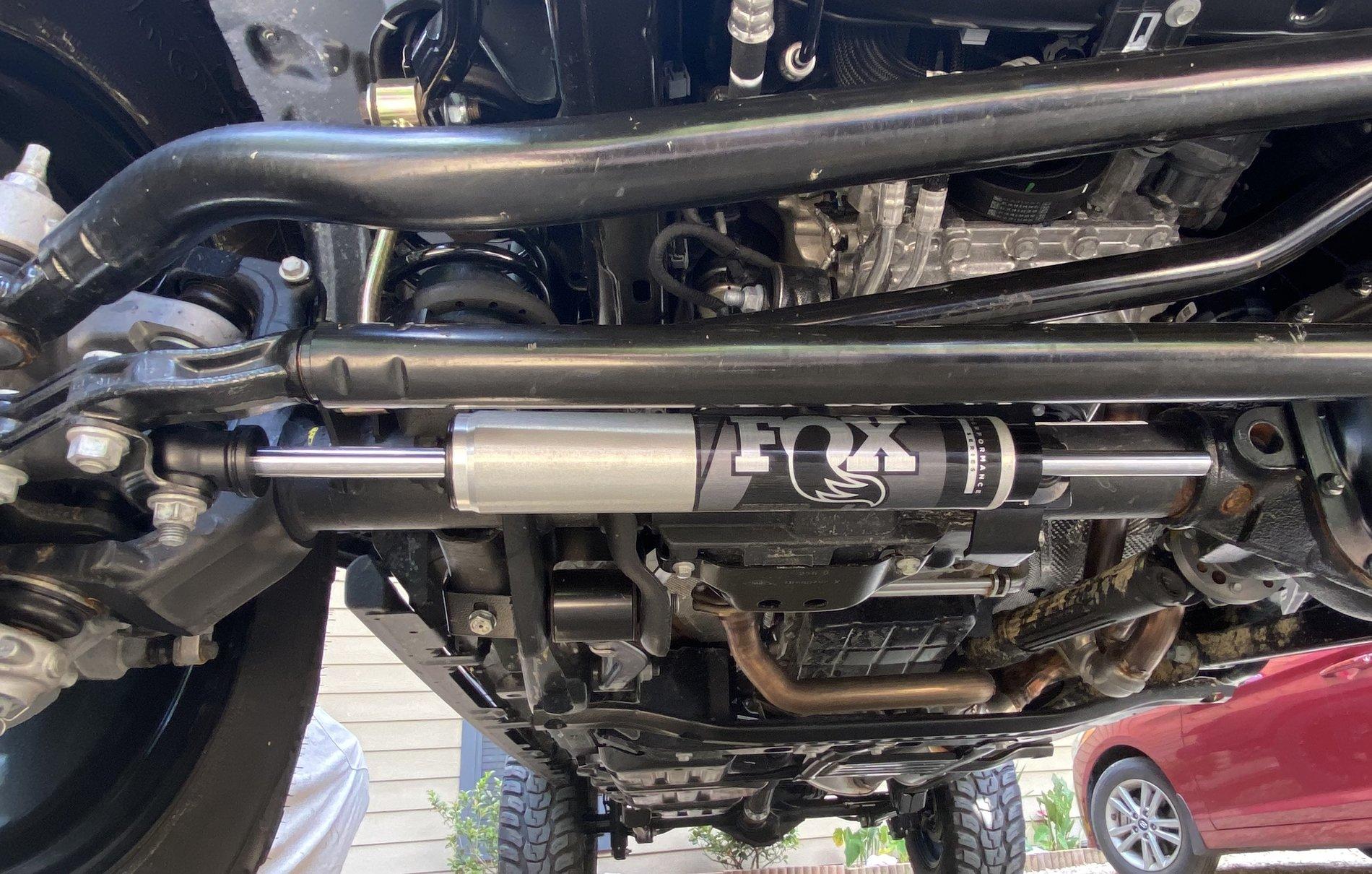

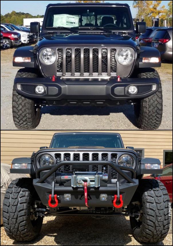

Wide aftermarket offset wheels with wide tires, and a Fox TS 2.0 steering stabilizer helped mine tremendously. The skinny stock tires & wheels and stock steering stabilizer was horrible. The first night I drove it home from the dealership it was a nightmare on the highway...Hell it was bad going 55... It was horrendous at 75-85 MPH... Now tracks straight as long as the road is. But it does still follow ruts and grooves bad, but I think that's attributed to the fact it's a Jeep. I think that's one of those "It's a Jeep thing" things. Having to drive it to work and back for 2 weeks on the highway at 75-80 MPH for around 200 miles a day, was really a "get to know me" session with my Jeep. I only had about 2,000 miles on it prior, and now it's over 4K. So, a lot of seat time in a relatively short period.
Here’s a before & after of my JTR. Which one do you think would track straighter based on the contact area and track-width? ;)

Adding one of these helped tremendously, too.
