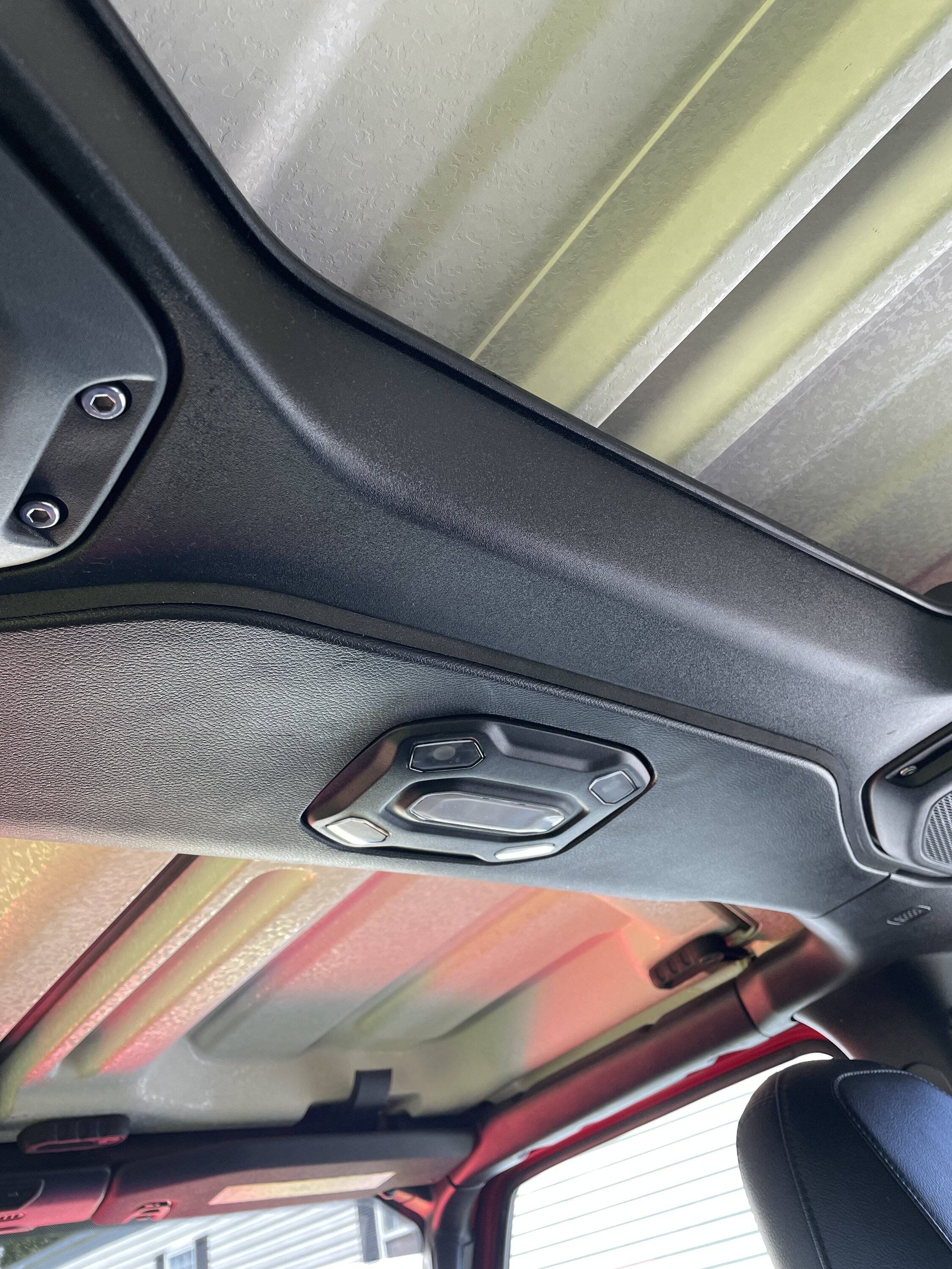

I have had my gladiator (2021 Willys) since May and have had a problem the whole time with a rattle when playing music with any bass (even podcasts with a deep voice). I think the rattle is coming from the plastic piece that covers the metal bar above the rear passenger's head, slightly behind the overhead speaker. The screws seem to be tight and I can't figure out what to do. Anyone else have this issue or have any solutions? Thanks.

I finally fixed my speaker rattle and Iā€™m now very happy with the premium sound system where before I was completely disgusted with it. My drivers side sound bar speaker would rattle with any music with a little base. As others have mentioned I could press on the speaker grill or stick my hand above the sound bar and it would stop. Finally I had had enough of it so hereā€™s what I did. On you tube there are recordings of various frequency ranges. I played it until it reached a frequency where the rattle was completely obnoxious. I started removing the trim just above the back door. Some was held on by torx screws and some just snapped into place. Once I had enough trim removed to where I could see the bolts that hold the sound bar on the problem was obvious. One of the bolts wasnā€™t tight and the washer on it would spin and vibrate violently causing the rattle. I tightened the bolt and now I can turn the volume wide open with no rattle. This was super easy to do so donā€™t settle with wedging bubble wrap above the sound bar to fix it. I only wish I had done it sooner. The you tube recording made it really easy without having to wait for a song with the magic frequency to cause the rattle.

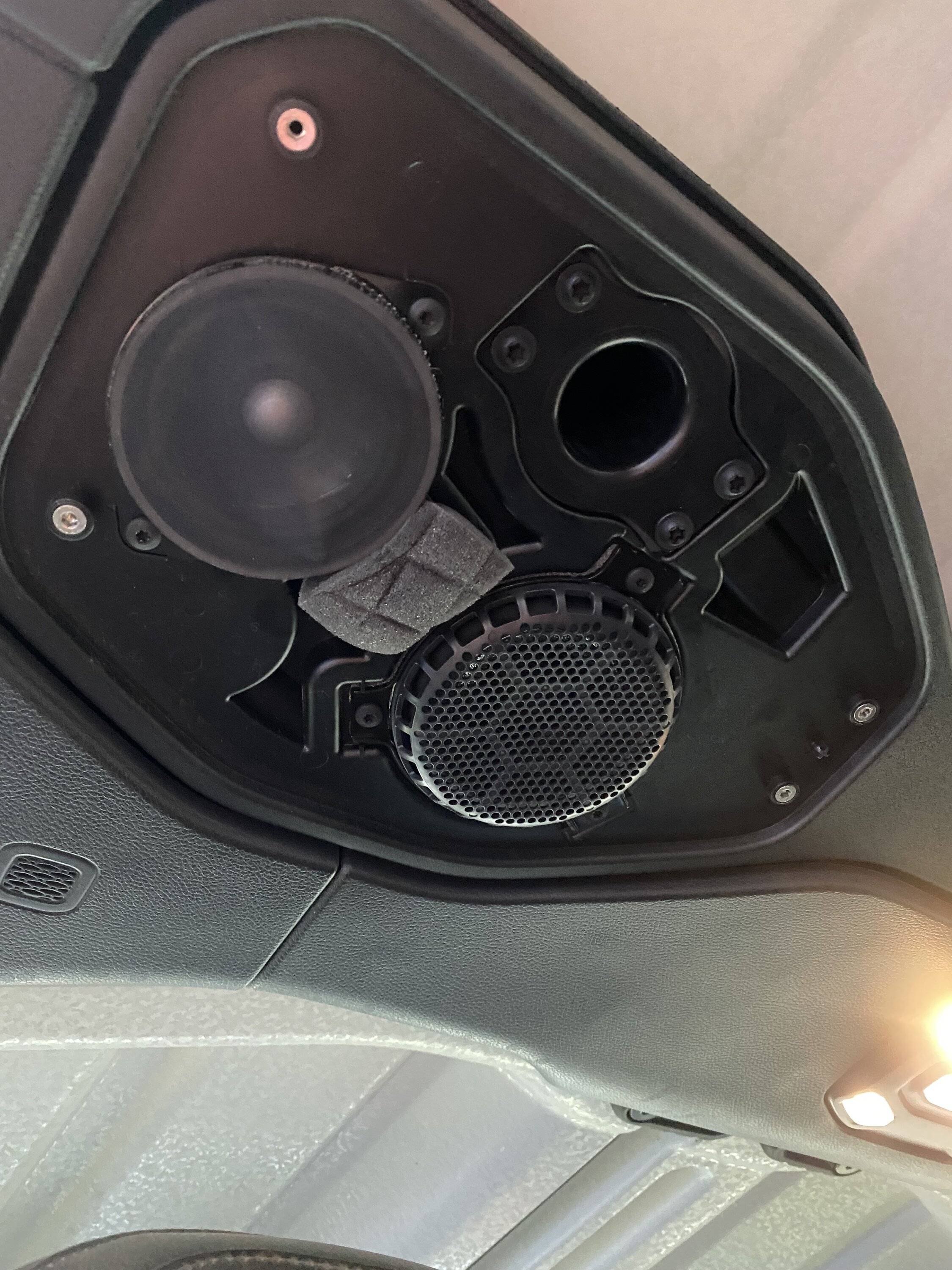

Adding to this thread in case anyone else has an issue with vibration. I was experiencing this and started to follow above direction locating a you tube video with different frequencies. Then started disassembling the trim. Note the piece of trim to the front of the roll bar has a plastic button holding it in in addition to the torx screws. So maybe had an extra on hand. My sound bar screws were tight so no issue there. When I removed the speaker cover I discovered the issue. One of the screws securing the inside speaker behind the cover had come loose. All good now.
