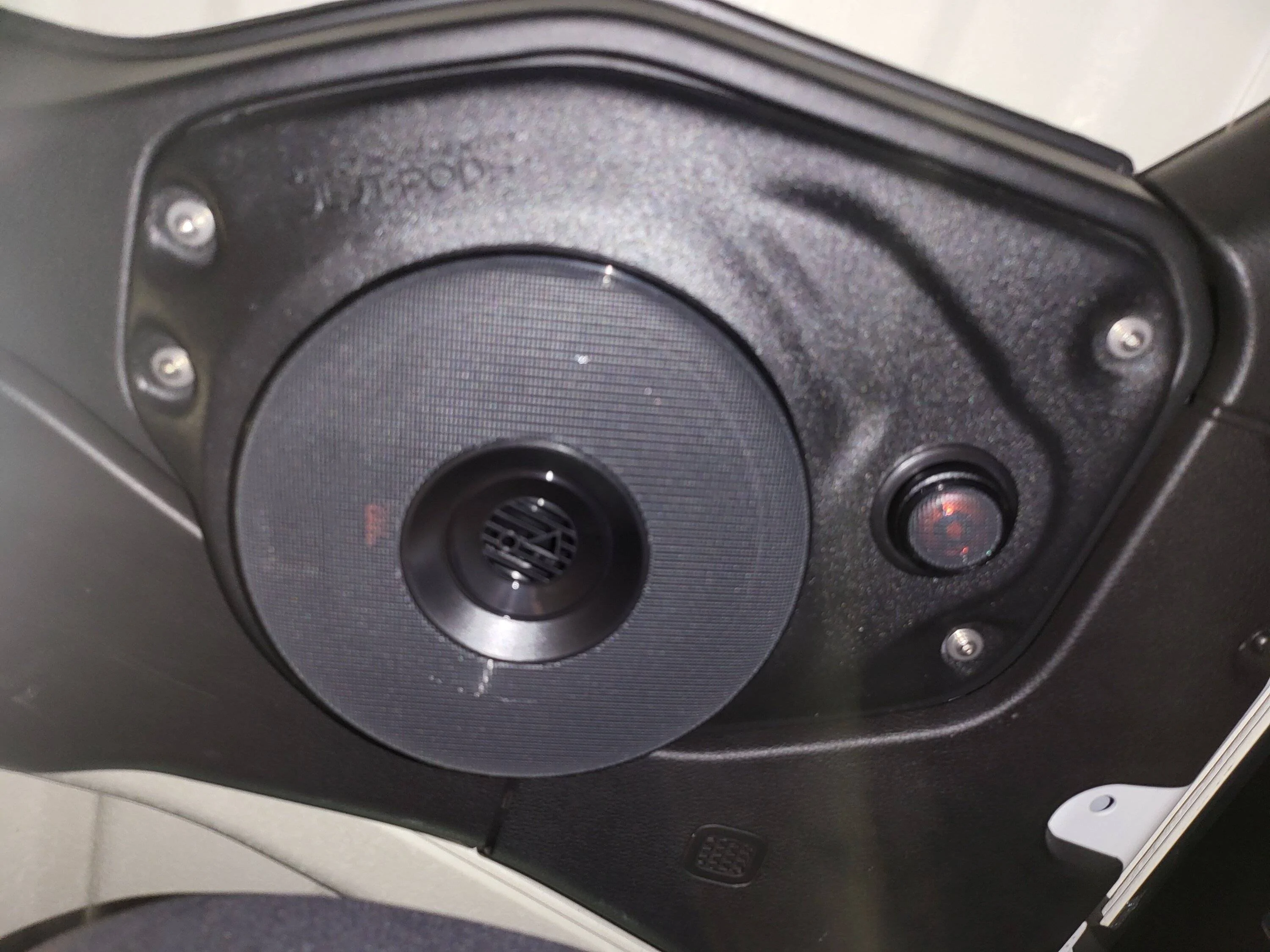

The only direct fit for the 4" speakers are kicker ks, which are supposed to be a descent upgrade. Almost any 3.5" speaker will swap into 3.5" locations. Tabs will be square vs triangle, but cover should still fit over. Many have used the kicker dart speakers with good results as they are truly plug n play. The rest require Metra adapters, which may come polarity reversed. Best prices I seen were on Amazon. Got my jbl clubs on there for way less than anywhere else, new and unopened. I also did 6.5 components in rear with select increments pods (alpine version so I didn't need to buy extra 3.5 harness for dash speakers)
