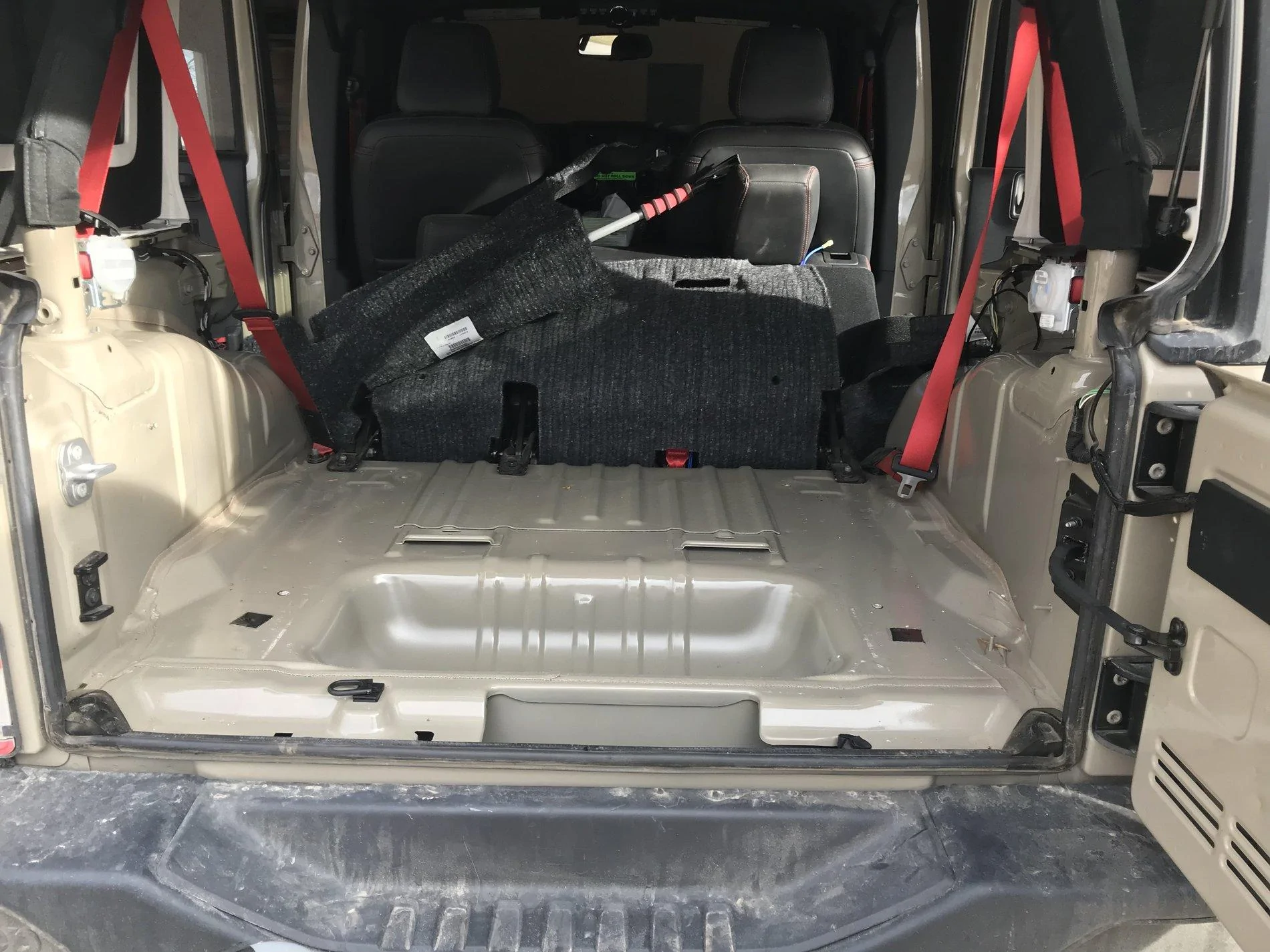

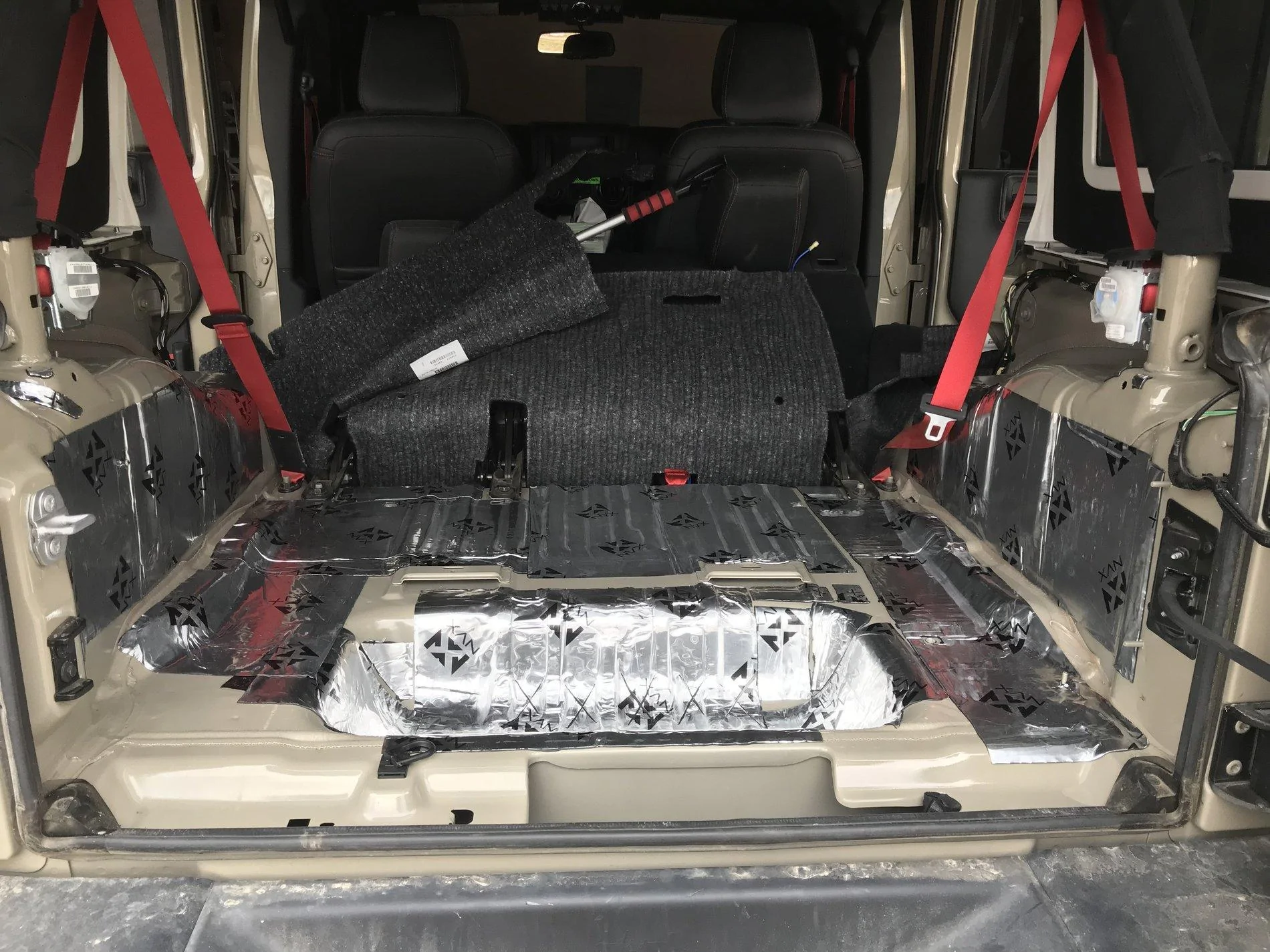

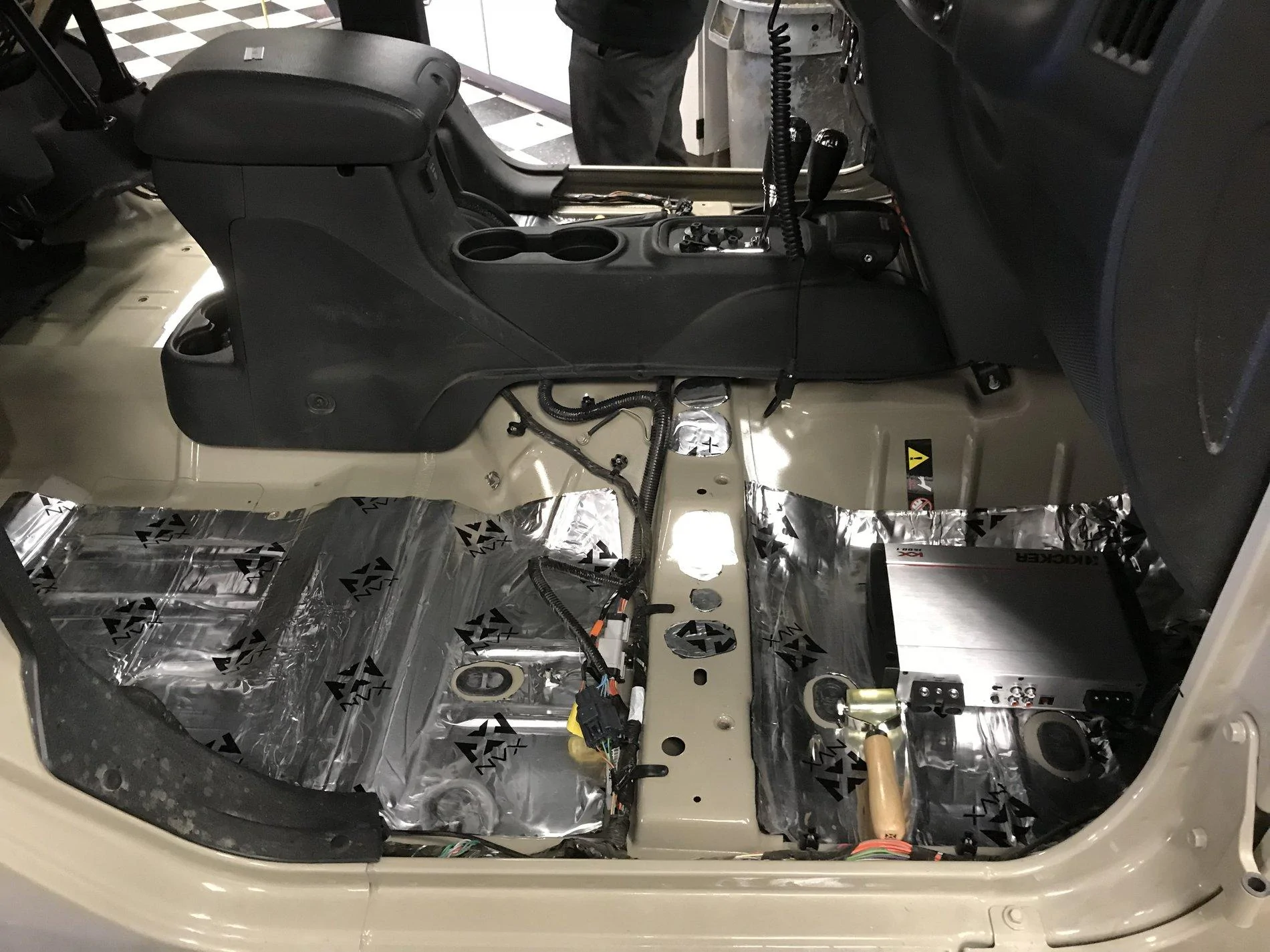

There is nothing in the doors or floors. I used SoundSkin Pro (4 roll kit will do it all) in my JT doors (all 4) and floor boards. Lowered about 4 decibels overall on the reading and improved the stereo sound. Put Hushmat and polyfill in the roll bar and that also improved the Alpine Premium stereo sound.
Also noticed an improvement in cab interior insulation or temperature control.
